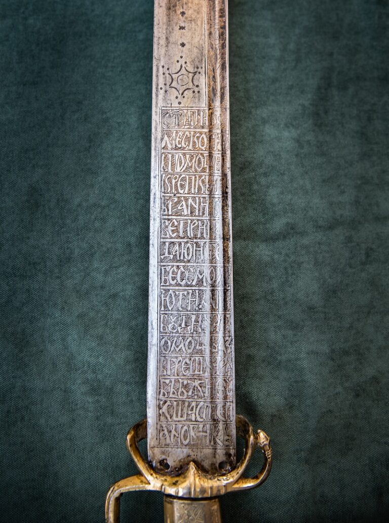

Originally Posted by serdar View Post
Thank you on answer TVV.
I was puzzled the first time i saw sword from Perast, becouse of the handle and guard, i didnt know that style of handle and guard that it originated in Italy, i thought it was a put together piece with a nice tale atached to it, like it is a famous saber of Vuk Mandusic in Criatia, husar saber from 18 century it is atributed to a fighter and public hero from 17 century.
Yeah, this one is quite interesting. Re:
Are there any closeups of the sword, and particularly the hilt?
Old 20th September 2025, 09:34 PM   #33
serdar
serdar's Avatar
Join Date: Feb 2023
Posts: 254
Yes, online, in museum it is positioned in that way that it is imppsible to take picture of the sword....
And description of the sword, translaten from Croatian.
"That sword belonged to Dragon - Fire Wolf, a descendant of the despotic Branković family, and with the marriage of Katarina Branković, it became the property of the Zrinski family. According to this tradition, Petar Zrinski gave a sword to the people of Peraštan on 05/23/1654. year after the great victory of Peraštan over the Turks.
However, it is also assumed that the sword was made by craftsmen in one of the workshops in the Boka Kotorska area. This is corroborated by the coat of arms of the Rajković family of Perasca on the blade, to which the Stjepanović family also belonged, and according to some sources it belonged to Vukša Stjepanović from Perast."
I saw those style handles across italy museums, not many.
Sword has text on latin, and old church slavic language.
serdar is offline   Reply With Quote

A very cool and interesting sword. I like that it has a straight backsword blade. And a wide one, too.
I knew that the nimcha/saif hilt style had not changed much since the 17th century from the Michiel de Ruyter one and similar examples, and I had heard about connections with the storta and other Italian sword types, but I was not aware that the hilt was such a 1:1 copy.

Yes it is, very nice sword.
Blade is gorgeous, when i first saw the sword i thought it is a nimcha handle i didnt know italians made those handles, after trip thru the italy and their museums i saw swords with the same hilts that are italian made.
Obviously italians made them and then they were also made elswere.

The very interesting sword from Perast serdar shared with us is Montenegrin under Venetian control. The scabbard is reminiscent of schiavona scabbards.
The hilt is very similar to nimcha hilts and is from approximately the same time as De Ruyter's trophy nimcha and some other nimchas captured by the Spaniards in Oran. It is therefore difficult to tell with an absolute degree of certainty who copied who when it comes to the hilt.
The same hilt style also existed in Southern Arabia, where the Italian maritime republics had no real presence, and the most plausible explanation is an Ottoman connection.

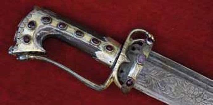

Concerning this model I cant find something very algerian here...
I mean, close style but not same. Never gems on algerian guards (sometimes a bit of coral on quillon tips, but thats it), and not as much on a handle.
I really dont know whats is that sword, if its actually italian, it could be a good way to understand inspirations... But still have to determind an age, because if it is something that is sometimes hard to accept for us europeans (even for me...) is that algerian (or north afrian, and widely the world..) could also have inspired such models, by the "legend" of algerian pirates at this era throught europe, or even the willing to have a sword like those tooken from algerian shipman, as the one of Tromp, De Ruyter, etc.

Originally Posted by fennec View Post
Hi mate, and sorry again for the time to answer (dont hesitate to send me an email in case someday you want to ask me something "important", sometimes I'm more reactiv...lol)
Well, it could be, I mean, at first look I would say that, and I was about, but actually I have serious doubt. The only thing that would made it moroccan for me is the origin of the blade, but even those ones where mount on algerian nimcha (trading, or tooken during battles). The hole on the pommel (I know I know, that could look funny as a factor of algerian origin, but this is very reccurent) and the guard lead me more to an algerian one.
Compare your sword to those ones. First picture, that was upper, you see that nimcha, for most of people, this could be a moroccan one, if we had no scabbard. Hopefully it is, and those models are good to proof that those geometry (handle, but also blade shape) was also common in algeria.
When looking back at the sword I showed, if you look at the band under the guard, it has floral motives of a style we find on koummya scabbards, hence my Moroccan attribution.
I also would not rely on a scabbard for attribution, as scabbards were replaced more frequently than hilts.
