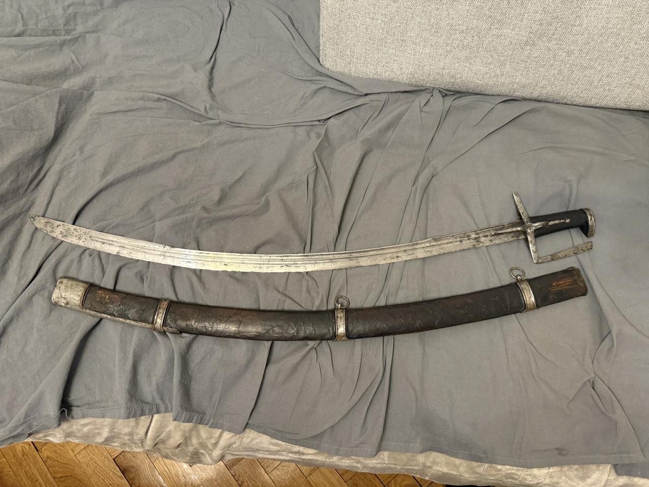

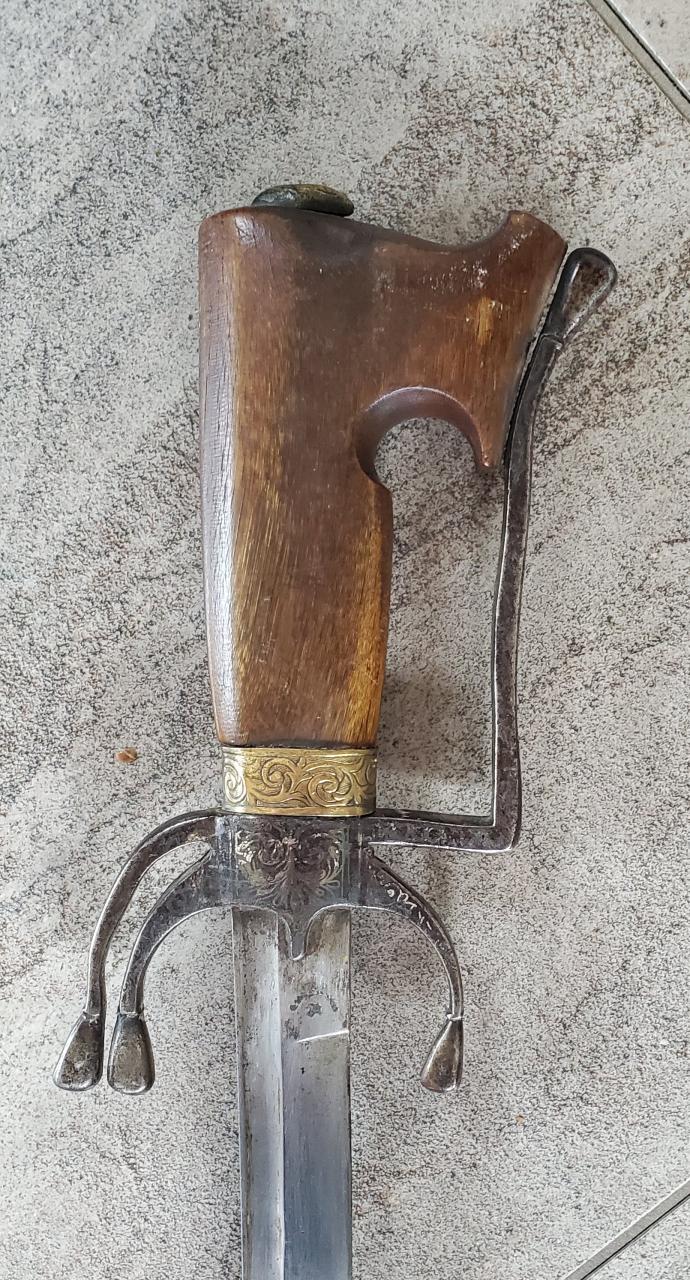

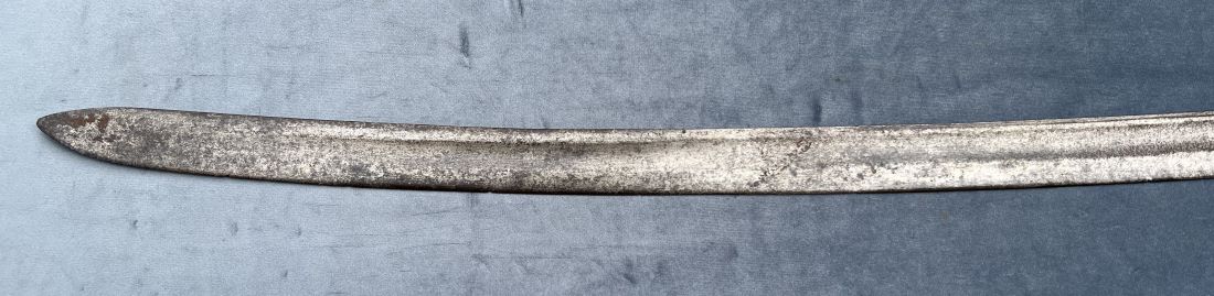

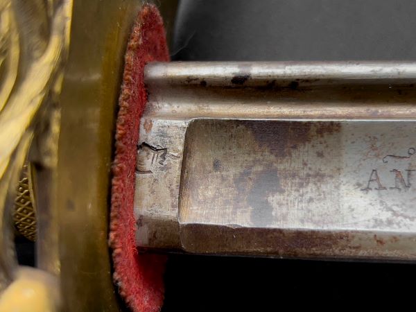

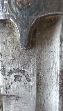

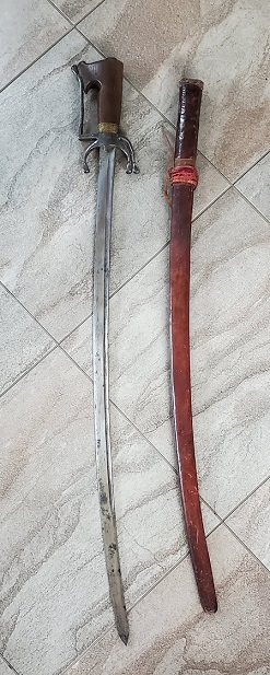

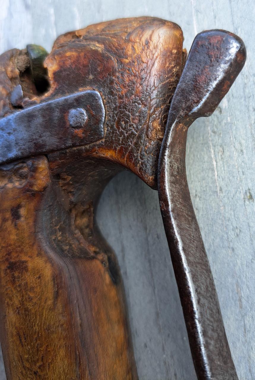

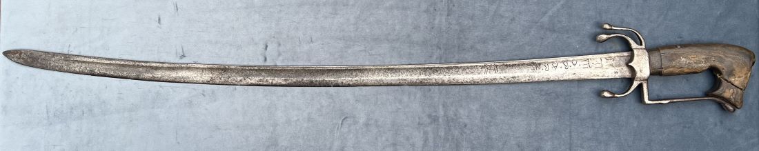

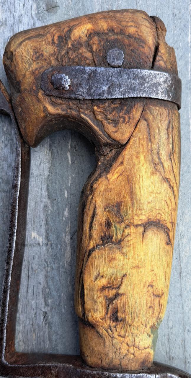

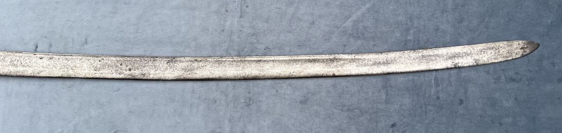

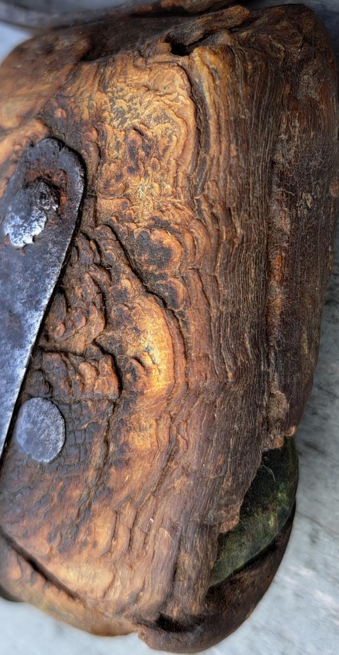

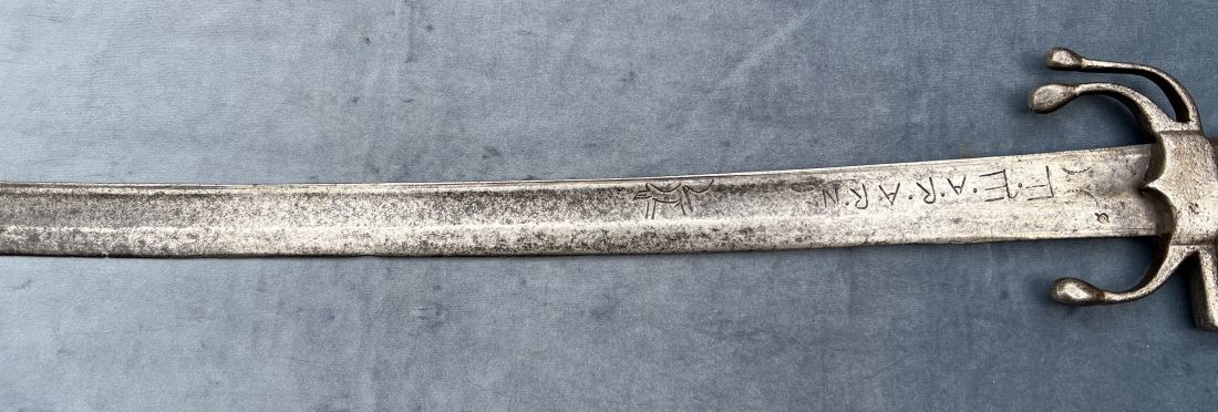

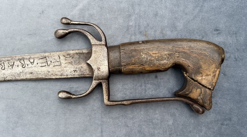

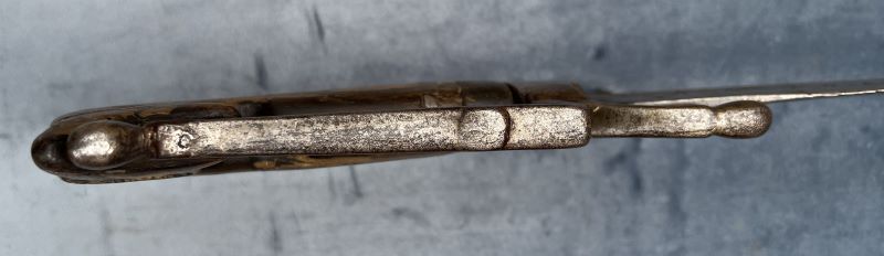

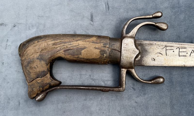

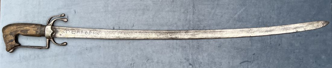

I got this curious specimen.
The blade has imitation marks of ANDREA FERARA, wolf of Passau, Genoese "gourdes" and probably a trade mark of a European supplier (shop).
Imitation marks of famous marks are also often found on takuba blades. But here the local blacksmith generously put everything he knew and saw into this blade.
Total length 945 mm, blade length 795 mm, width at guard 34 mm, thickness of the butt at guard 6 mm, weight 824 g.
I will be grateful for any thoughts and comments.
Yuri

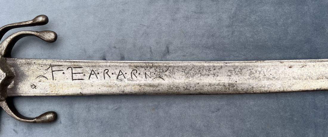

I want to know who Arn was and why I should fear him.

Well noted that this clearly desperate attempt at the fabled ANDREA FERARA inscription is far from the mark by a native individual in one of the countless trade entrepots across the North African littoral once known as the BARBARY COAST.
It is important to note that while it seems invariably that these distinctly recognizable and ubiquitous sabers are mounted with many variations of European cavalry blades, many later examples of 19th did not carry the kinds of markings long appealing to these native people.
With these familiar markings, which usually consisted of the 'running wolf' of Passau/Solingen; the 'sickle' marks (dentated arcs) of Genoa; the powerful name ANDREA FERARA and others........typically held for centuries as marks of quality in Europe...........with native people, they viewed these in far different light.
Despite the Arab predominance and of course the Muslim Faith, the folk religions and superstitions prevailed, and much as with the complex systems of symbolic devices, these distinct markings were seen as imbuing the blades used in these swords with magic and power..
Interestingly, though most of the blades coming into North Africa by the 19th century were of course German, however with notable diplomatic and trade connections between England and Morocco through 17th century well into 19th, the diffusion of English blades filtered into the Maghreb.
This was the conduit which brought in the numbers of ANDREA FERARA blades (which were actually Solingen made for the Scots).
These kinds of traditionally recognized awareness of these earlier markings led this unknown trader to embellish the blade on this example nimcha accordingly, and NOT to deceive but in the belief that these markings all held talismanic significance. The compounding of these together presumably would add even more potency.
Though naturally I would expect disagreement with my perspective, however IMO it is certainly compellingly plausible.
While these nimcha are typically regarded as from Morocco, Stone (1934) noted them as Algerian, but ALSO used in Morocco. Briggs (1965) who was situated in Algeria used examples he acquired locally in his study on Tuareg blades.
Though this example is likely from early 20th c. the blade is quite possibly from the many European blades circulating through trade centers in the North African littoral from earlier years. It would be hard to define use distinctly to region or whether Arab or Berber as these were so widely used for centuries overall in these regions.
This is a rugged example which is of the type used by the notorious Barbary Pirates from Morocco through Algeria, Tunis and as far as Libya throigh the 19th c. and even by Berber tribes in the Rif Wars in Morocco in the 1920s.
On a more specific note, blades with the 'Genoan' sickle marks that are remarkably similar to those seen on many nimchas, have been found in areas of Black Sea coast. The Genoan presence there in trade since medieval times brought those sickle marks into the Caucusus (there called 'gurda') and Styria (Austria).
These areas were the source of many blades found in North Africa through Arab trade, as these blades were enormously popular there.
While this may be seen by many as 'simply another nimcha', those of us here who have been intrigued by them for many years see the complex history behind them. They have become increasingly harder to find, so this is a wonderful acquisition.

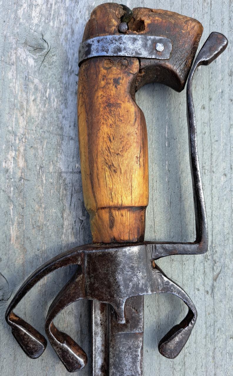

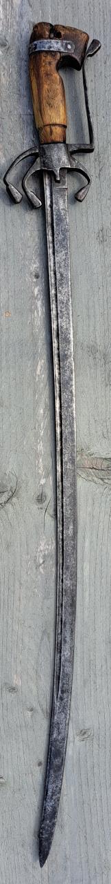

Hi,

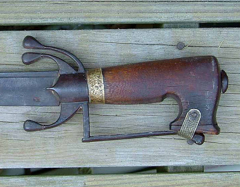

A fine looking Nimcha (in my eyes, though it is not my field of collecting, so my knowledge of these is far less than some others here, like Jim).
Though I am intreged by the history of the Barbary coast 'pirates', I recently bought a rather similar Nimcha as yours. It has a different marking in the blade though.
When first handling it, I was surprised of it's length and weight. It has a great balance too!
Mine had an incredible patina of use, and I cleaned the dark blade superficially.
It aso has a native restore at the (bovine?) hilt.
I hope you don't mind me interfearing your thread, as that is not my intention. But because mine looks like a similar type as you have, I thought it would be ok to discuss both nimchas in one thread.
Maurice

Maurice, perfect entry!!! and of course not at all 'interfering' !! The idea here is discussion not just of one example, but of the form in general to see and learn from the scope of examples shared.
As can be seen, while the 'nimcha' style hilt with its distinct quillon and guard system was widely used throughout the Arab world, and while some examples remain in remarkable condition, many had long working lives throughout the regions of North Africa.
In my view, examples like Yuri's and yours are most exciting, as they were indeed worn, and perhaps used over long periods, and often within various groups as they changed hands.
With colonial actions and intertribal warfare along with trade and many types of interaction through the 19th century, well into the 20th, these swords were not simply traditional fashion, they were worn to be used as required.
Evidence of this is seen with the bolster strap holding the hilt together on Maurice's example.
These hilts were indeed made of horn of some sort, but I'm sure it varied, and while rhino was of course much desired, it was not as readily available and expensive. Horn itself was durable and surely had certain values in the sense of the traditions and nuances of the culture itself.
Going to certain elements on these nimchas, as a form, I notice on the example shown by Maurice, at the forte there is a stamp which comprises what looks like a dentated arc (as seen on Genoan sickle marks) and a star.
This seems to be seen on certain Moroccan examples (as seen on my example attached) and is tempting to suggest it is some sort of 'state' mark of Morocco, but cannot say for sure.
In Morocco, according to Tirri (2003, p.19) it is noted there were numerous weapon making centers in Fez, Meknes, Marrakesh and Rabat where there were apparently favored designs for daggers. Also centers at Tetuan, Taroudent, Ras al Oeued and through Little Atlas there were centers for guns and assembly. Any of these might have been sources for established supply of arms which may have included these swords.
It is noted as well that there was extensive use of imported weapon components (which has been well established), and via the many trade routes, might have come in through any number of the entrepots receiving foreign blades.
This is the reason it is so hard to establish the regional classification of extant nimcha examples. The 'Barbary Coast' (the exonym previously used and derived from 'Berber') extended entirely across the North African littoral from Morocco to Libya. The 'Barbary Pirates' refer to these outlaw raiders who were active throughout roughly 15th c. well through 19th, but as with historic periods, there are no specific limits to exact times, any more than defining the age of piracy itself.
Often it seems surprising that full length swords would be used as a 'pirate' weapon, with shorter stout blades being expected for close quarters on deck fighting. Here I would note that typically, these 'pirates' would transport in their galleys, but raid ashore, thus the full length swords.

Our nimchis have similar characteristics, but yours is a bit longer and more massive.

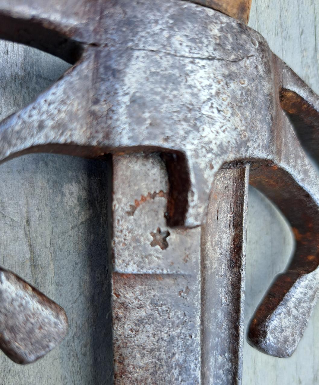

I would like to raise the question of the blade's origin once again.
From the very beginning, I assumed from the photo that the blade was of Maghreb origin due to the abundance of stamps on it.
When I received it, it seemed to me that the blade was stamped, not hand-forged.
Was it possible to stamp these stamps on a finished European blade? I do not have an answer to this question, my knowledge in this area is limited.
I ask for help from forum participants on this issue.

Keep in mind that the blades used on these were invariably from many sources, most typically those entering the North African sphere as trade commodities. As with most ethnographic swords, there were local preferences regionally as far as hilts, in fact there were likely certain shops or artisans producing hilts for the mounting of blades by armorers in varied areas.
Once mounted with the blades on hand, they were traded intertribally for ongoing use.
Since the blades used were typically intended toward specific use patterns, the variation of blades used adjusted accordingly. In earlier times, as you note the 'pirate/cutlass' type blades were likely as they may have seen use on larger vessels which might experience deck combat. These heavy blades on vessels served also as utility items, just as cutlasses served as machetes ashore in tropical areas.
From what little I know of metallurgy, blades could be heated and 'cold stamped' with markings etc. long after being originally forged.
The 'trade' blades coming in over virtually centuries of course had different characteristics reflecting not only the national trade centers where they originated, but changes in blade profile, cross section and fullering which changed over time.
Many blades circulated in many areas and were often carried elsewhere via the complex trade networks and intertribal trading across North Africa through generations and centuries.
I recall seeing a European blade from 15th century in a Tuareg takouba which turned up a number of years ago.

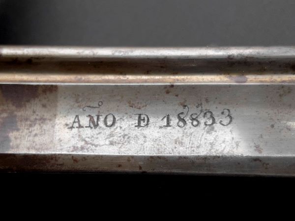

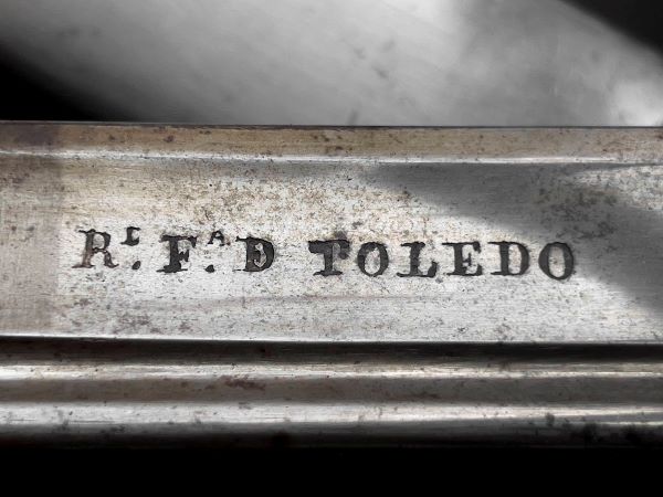

Jim, I also think that the marks were stamped on the blade blanks.
It is difficult for me to determine from the photo whether the Maurice blade is stamped or hand-forged. The blade on my nimcha is clearly stamped. If this is so, then it is reasonable to assume that due to the abundance of imitations of marks of famous European manufacturers, the blade is of local, Maghreb production.
If we date the blade to the end of the 19th - beginning of the 20th century, then we can say that in the Maghreb countries at that time there were productions similar to Solingen and Klingenthal.
P.s.
I have an example - an officer's sabre of the Royal Guard of Spain M1825. The blade is imported Weyersberg, Solingen, and the inscriptions R.F.D TOLEDO and ANO D 18833 are made by engraving.
Pertinax is offline   Reply With Quote

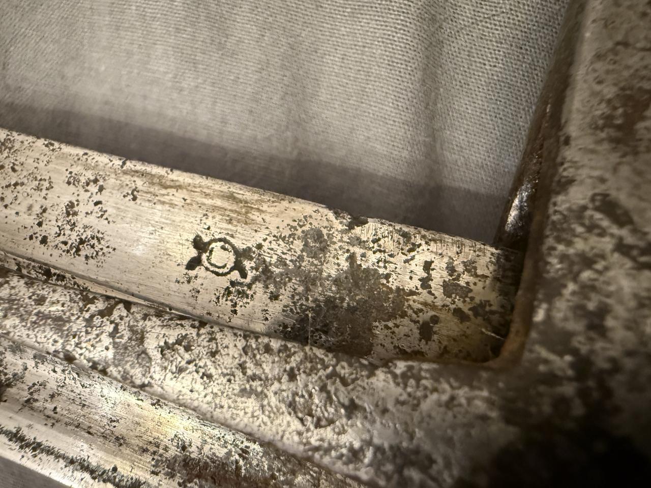

[QUOTE=Jim McDougall;297170]LOL! good one werecow
Hi Jim!
On the European Arsenal forum in the topic "Hussar sabre, real or not?" the serdar showed the sabre.
On the blade there is a stamp "germ" similar to the stamp on my nimcha, which is typical of this location, they are identical.
It can be assumed that this is the marking of an unknown European manufacturer.
I do not undertake to judge the authenticity of the hussar sabre, it is not my topic. But if we believe the curator of the museum that the sabre is from the end of the 17th - beginning of the 18th century, then we can reconsider the age of the nimcha.
What are your thoughts, Jim?
Yuri

As noted, European marks were copied profusely, and often added to the European blades already filtering into North African entrepots. In my view these were added to add imbued talismanic or other 'magic' properties to the blade, not any effort to purport certain European makers made the blades.
Clearly English was not the first language of the inscriber, and the ANDREA FERARA blades were known in circulation among trade blades in the networks. Often other marks were added in the same convention, adding further magical support likely along with other familiar European marks, the sickle often seen for example.
I found this mysterious oval mark with the four appendages in Wallace Coll. (p.274) as found on a German blade c. 1560s-1600 in this case bracketed by these dentated arcs (sickle). It is my impression that this is a lesser known mark likely Italian that ended up being spuriously used much as the sickle, twig etc. were used in Styria and Germany. (attached)
Also added the hussar saber with late 17th c blade (prb. Styrian) from discussion on European forum, and with this curious oval mark.
Bravo Jim! You are, as always, on top, hats off!
Now we already know that the oval sign with four appendages is found on European weapons.
Perhaps one day we will find out who it belonged to.

Old 12th May 2025, 09:43 PM   #18
Posts: 10,852
Thank you Yuri It is always fun to solve (or try) mysteries. It is doubtful anyone has records of these often variously configured markings as to what meaning they might have had. Makers tended to have distinctive trademark punzones which were placed singularly in one universal location on the blade, typically the forte.
It seems that although many blades had no makers marks.....typically well established makers had shops, and often other workers making blades, which presumably were not marked as those of the master.
This was the case with the Ferara brothers (your ANDREA FERARA mkg) of Belluno in the regions of Milan in Italy. They worked in the shop of another master forger, and VERY few blades are marked to the Ferara brothers.
How the name became such a ubiquitous mark of quality is a matter of notable debate, but has become the stuff of legend.
Looking at references with these twig, marca mosca, sickles etc. they occur in weird configurations and multiples on the Italian blades, which further indicates that though not isolated to one maker....it is possible that certain combinations might be so used. There have also always been suggestions of the guilds having something to do with these varied devices.
Old 14th May 2025, 04:14 AM   #19
Posts: 6,421
Wink Do Clothes Make the Man?
Is a backsword blade in Nimcha dress still called a Nimcha?
All of the Nimchas in this thread have curved blades.
Is it welcome in the Brotherhood?
Old 14th May 2025, 07:36 AM   #20
Posts: 10,852
Nimcha is just a collective term for these Maghrebi sa'ifs, not technically correct, as often the case with the terms collectors and writers describing them over a century. The term nimcha supposedly refers to a small sword but the proper etymology is a bit unclear.
These are simply Arab swords from Maghrebi regions (Algeria to Morocco) and locally termed sa'if only. As blades were typically European, and of them mostly straight cavalry or hanger blades, it seems most collectors regard them as a form distinguished by the familiar hilt and guard system, at least these are my understandings. The use of curved blades was simply incidental just as were the straight blades, availability.
The Brotherhood? of course!

Posts: 10,852
Thank you so much Yuri! I could not open this due to restrictions, but Im familiar with the work of Lenz from ZWHK.
Interesting note on the term 'gurda' which I am familiar with as the term for the 'Genoan' sickle marks copied on Chechen sword blades in the Caucusus.
These and other markings were copied on these blades, likely from Genoan trade ports in the Black Sea.
The subject of markings as applied by distinct makers in Italy is daunting as there was a great deal of spurious use by others, and the variations of some of the more ubiquitous Italian marks seem to be used in unusual configurations and pairings. The marca mosca, and 'pi' marks seen in the plate you show do not appear to belong to a particular maker.
Genoa was primarily a port of export, and the so called 'sickle' marks, though used by various blade making locations in North Italy, again sometimes in unusual variation, became deemed 'Genoan' as that was where they came from. These and many of the other markings noted became copied on blades in Germany and Styria, as well as other locations, and often it is hard to determine a blades origin by focus on markings.
Often makers worked in the shops of other makers, such as the noted Ferrara brothers, who though working in the forge of a maker in Belluno, with the name of Andrea Ferrara becoming legendary. The consternation regarding this is well known, but as far as known, no blades by him and marked as such are known (obviously there have been some suggested).
Another conundrum are the blades of CAINO. Again widely copied, it is unclear if by two makers named Caino (separate locations) or perhaps the city of Caino (near Milan) . Blades have the name Caino and various marks (M over an S, or over a mark).....but most distinctively typically have strange groupings of letters, often sequenced, that seem to be acrostics or some coded letter combinations.
These are a few of the mysterious markings, names etc. that turn up on blades that have entered the trade networks which have supplied many cultural spheres, and have circulated for generations if not even centuries.
This is what makes these ethnographic weapons so fascinating, and thank you for keeping this thread so interesting.
