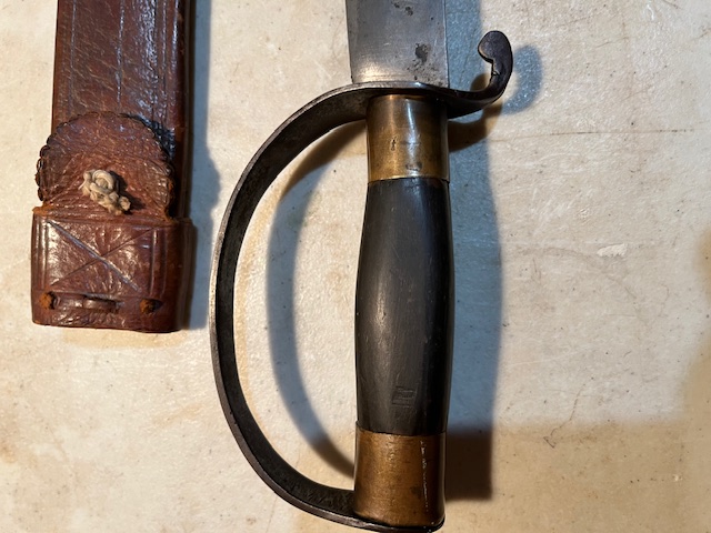

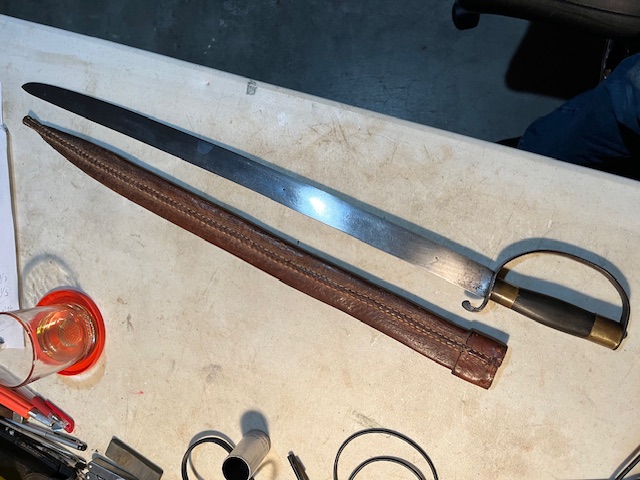

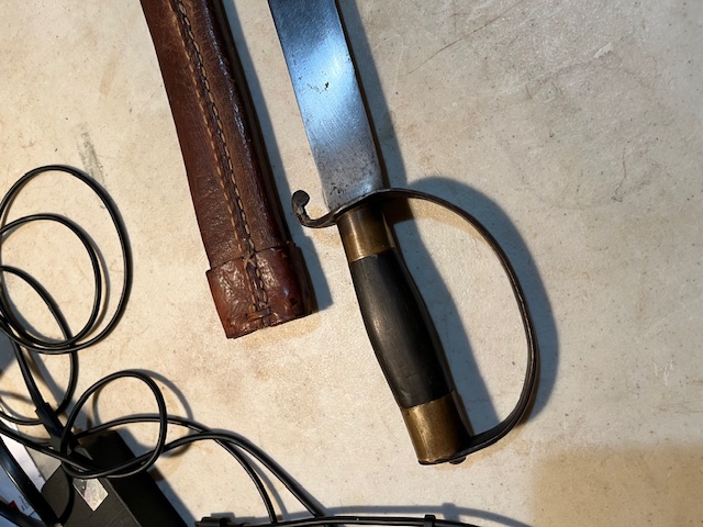

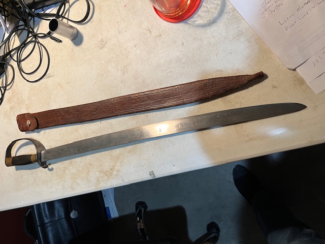

I recently acquired this long sword at a military show. Supposedly a bring back from the Philippines. I believe it came from the Luzon region, with the leather scabbard. The hilt and guard are somewhat European in style. The handle grip is hardwood, with brass on each end. The guard is formed from iron. The blade measures 23 inches (58.43 cm) in length, and overall length is 27-1/2" (69.85 cm). The blade is fairly heavy with a thick spine.
I am wondering what the age of this sword is. Could it be from the Spanish-American War or Philippine Insurrection era? Thanks for any information!
Andrew
AHite is offline   Reply With Quote
Old 16th February 2025, 12:56 PM   #2
Beautiful sword! And yes, I would agree, Central Luzon. Age guesses from me mid. to end of the 19th century, so it could have been used to the time of the Spanish-American war or also at the Insurrection era IMVHO.
Old 17th February 2025, 02:12 AM   #3
Posts: 4,736
I also think it is from the late part of the Spanish Colonial period or shortly after. Nice sword.

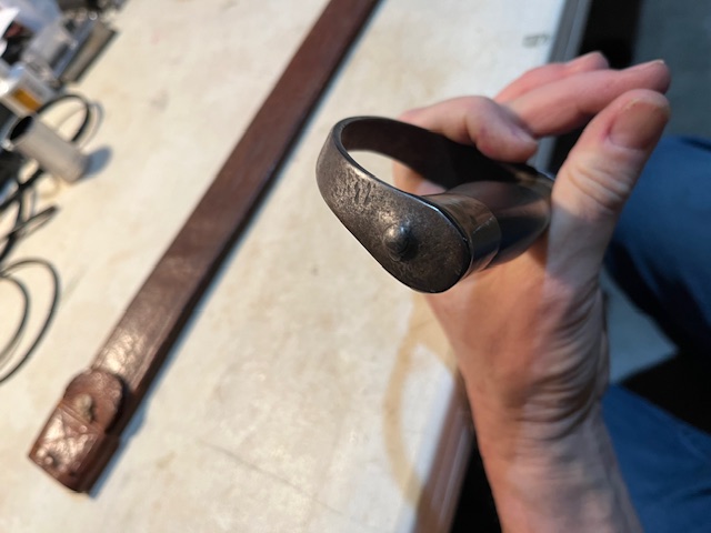

AHite,
Very nice sword you have there. Is the tang threaded into a nut or peened over?
Sincerely,
RobT
Old 22nd February 2025, 09:19 PM   #6
AHite
Join Date: Dec 2022
Posts: 67
The tang is peened over.
Old 23rd February 2025, 12:06 AM   #7
RobT
RobT's Avatar
Join Date: Mar 2005
Posts: 644
Default Thanks Anyway
AHite,
I have a Philippine sword with a very similar hilt and guard (the blade is completely different though). Because of the hilt and guard similarity, I was wondering if there may have been a roughly standardized insurrection hilt form carried by the fighters of a particular resistance organization. Since my tang is threaded into a nut and yours isn't, I doubt that they represent a type.
Sincerely,
RobT
