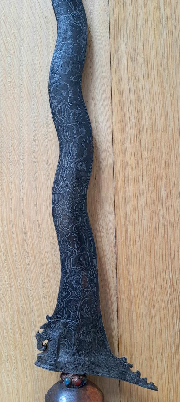

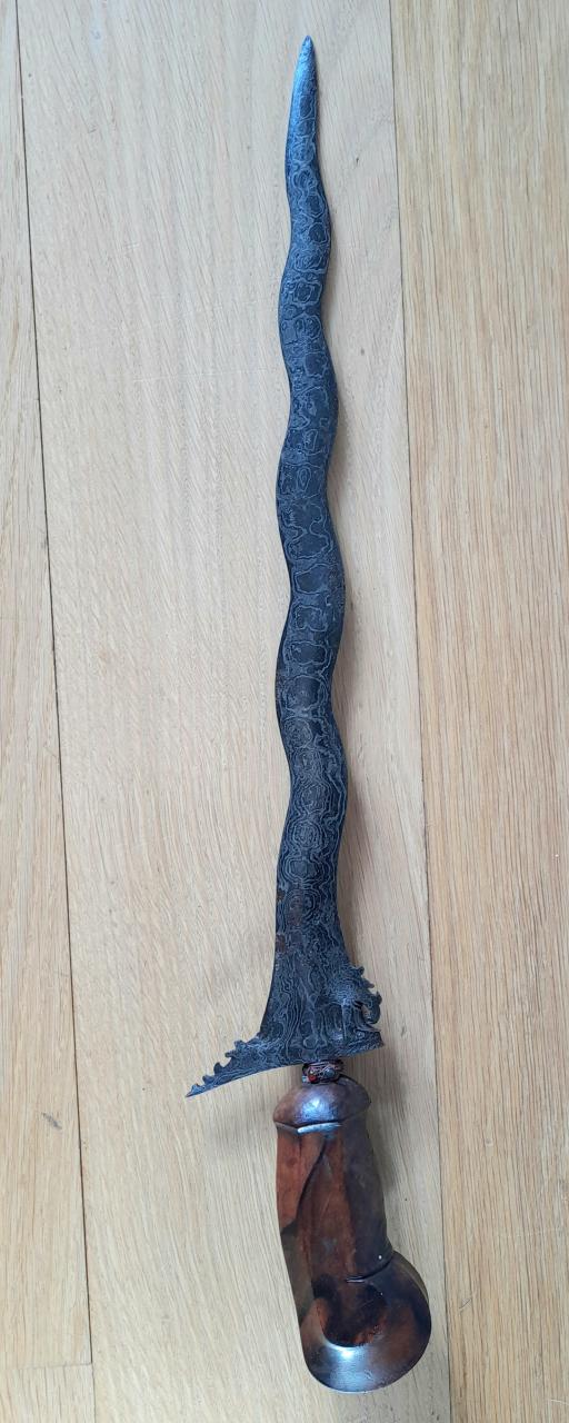

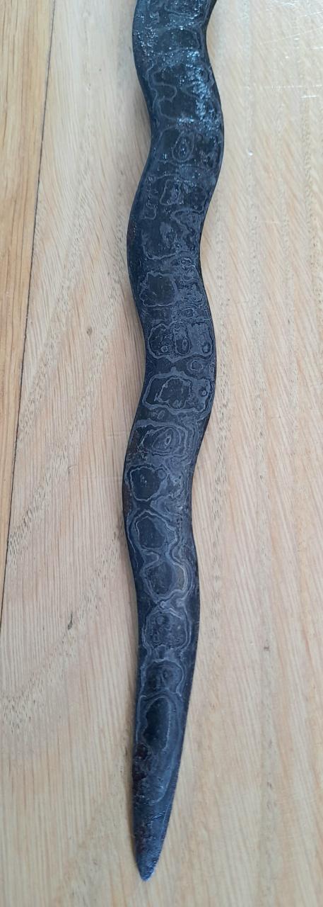

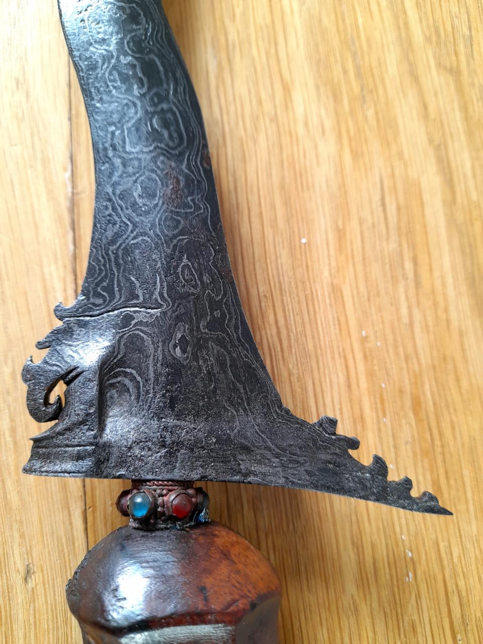

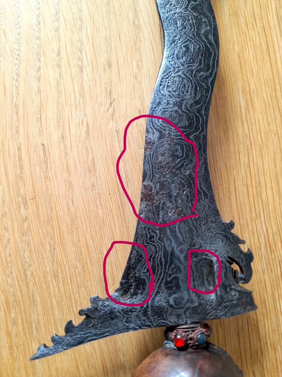

Further to my previous post, I would be grateful for your views on the likely age and merits of this Bali gonjo iras 9 luk keris. I restained the blade as there were areas of rust. The horizontal line above the trunk is interesting. Is the pamor uler lulu or bendo sagodo? Blade is 40.5cm. Thanks

I will let the experts comment but I'm impressed with the stain assuming you did not use traditional methods with arsenic or realgar. How did you do it?

Realgar and lemon juice. I can't access lab arsenic sadly. But it turned out well.

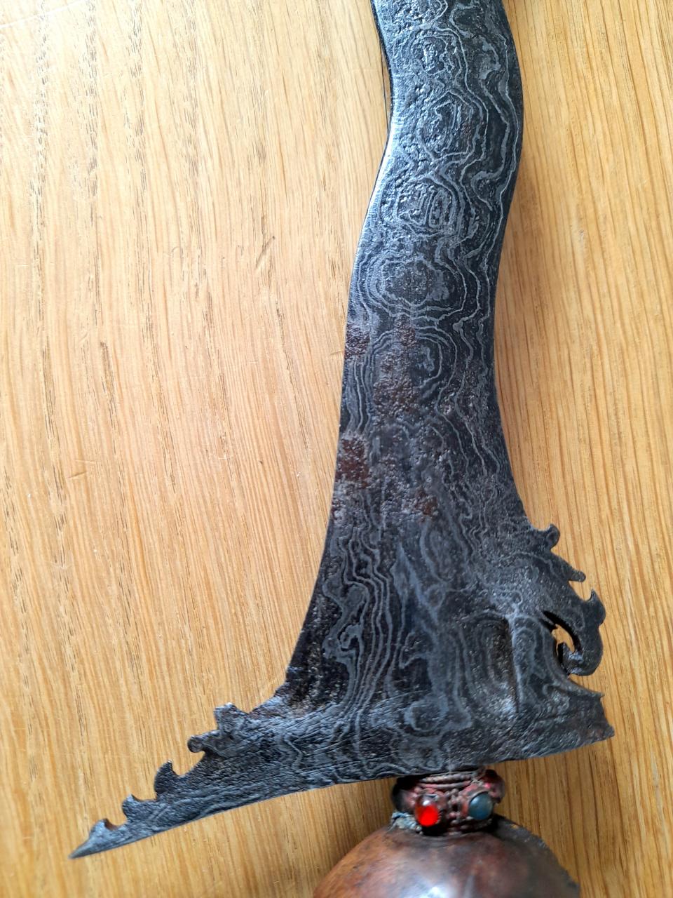

Hello Sid,
Good result of the staining! But you should redo it but first make sure that you have removed all rust, I still see a lot of rust, see pic.

Yes I got impatient and wanted to see if I could bring out the panoramic. I will work on loosening the remaining rust.

Posts: 7,117
Sid, the reason that I have not commented is that if I cannot say something positive I try not to say anything at all.
Going ahead with a stain job in the absence of the essential blade clean beforehand is really not a good thing to do, it simply makes the job longer & harder.
You did ask three direct questions:-
1) age of the keris, I take that as blade only, it is probably 19th century, possibly earlier, not later, additionally it is probably Lombok/Bali, not Island of Bali.
2) comment on merits, I can see nothing in particular that would set it apart from the average run of older Balinese keris, except of course the lack of a separate gonjo, there is some loss of detail in the carving, which is the reason I opted for the "possibly earlier" comment in 1).
3) is the pamor motif bendo sagodo or uler lulut? I would give it as bendo sagodo, but in Bali it would most likely be given as pamor santa, both bendo sagodo (bendha sagada) & uler lulut are Javanese names.

Very grateful for your thoughts as always. Noted re cleaning well before staining. The stuff that remains is a very hard encrustation. I'm soaking the blade in mineral oil in the hope it will soften this enough to be scraped off. I don't have any wd40 at hand but will get some if the oil fails. The keris aesthetic in terms of form feels very harmonious to me for want of a better term. It has an elegant grace to the proportions in its simple ordinariness and I cannot identify any areas of harshness in this regard. Please do let me know if you see otherwise. I am perfectly content with negative views. It's nothing personal to me and aids learning about assessing keris.
Sid, i know it is never satisfying to post something and get limited responses, but often people choose not to respond when they don't feel they have anything of value to add to the conversation. So i wonder what more you are hoping for at this point. To be clear, i like this keris and if it crossed my path at the right price i would probably try to add it to my collection. That said, we are not looking at a high end piece of Balinese/Lombok keris art here. The proportions are not bad, but i might stop short of using the word "elegant". Ricikin such as greneng, sekar kacang and jalen all seem rather rough and not particularly well formed.
I would agree with Alan that pamor santa would probably be the best name for this pamor and that 19th century Lombok is a likely origin. I can assure you that real members of our forum have indeed been viewing this thread, but i am not sure what more engagement you were hoping for.

Sid, to remove those hard encrustations we use a scraper & a hard pointed tool, I use a saddler's awl for the pointy thing, and for the scraper I use an old worn out three sided file that I have ground a radius onto.
You scrape and pick at the rust & then re-immerse in the cleaning medium. For spots such as you have, I would use hydrochloride acid dabbed onto the scraped spot and watched while it was working, & then repeat as many times as needed. Then I'd finish the cleaning with brief soak in vinegar, say, about a day.
After that, polish with sink cleaner & steel wool, in Jawa we use coconut husk & abu gosok.
After you get the blade white you can stain, not before.

Good to know the right way to do it. What do you mean by grinding a radius in the presumably triangle shaped file please?

By a radius, I mean a curve, a part of a circle.
So, using a grinder you grind a curve into the small end, not the tang end, of a three sided file, a 6"-8" file is about the right size.
The curve runs from one of the sides to the opposite edge.

Sorry, still trying to visualize this. Is the radius to blunt the point in order to widen the scraping surface to avoid gouging?

The radius is to create a scraper cutting edge.
It is such as is found on a mechanic's bearing scraper.
