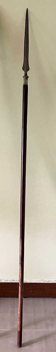

Hi All,
Can this be a Javanese Tombak? Can anybody identify the dhapur?
Cheers
oariff is offline   Reply With Quote
Old 20th July 2024, 04:01 AM   #2
Posts: 7,229
If we were to remove that fluted addition to the metuk we would have something very close to a Pajajaran/North Coast Jawa metuk, and the body of the blade could pass for Surakarta, but I do not think this is a Jawa tombak, the motif on the brongsong is a lung-lungan style, but not Central Jawa, the shaft tapering to a small diameter butt & lacking a tunjung does not look Javanese.
I have no firm opinion on origin.
Old 21st July 2024, 05:37 PM   #3
I am with Alan here, it's not Javanese. Could be from Sumatra or Sulawesi, I just don't know.
Old 21st July 2024, 06:22 PM   #4
I personally find it difficult to place Indonesian spears.
Here are a few of my collection, some of them were discussed here, maybe the threads are helpful for you.
http://www.vikingsword.com/vb/showth...identification
http://www.vikingsword.com/vb/showth...donesian+spear
http://www.vikingsword.com/vb/showth...an+spear+brass
http://www.vikingsword.com/vb/showth...tombak+sharing

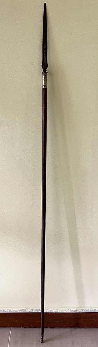

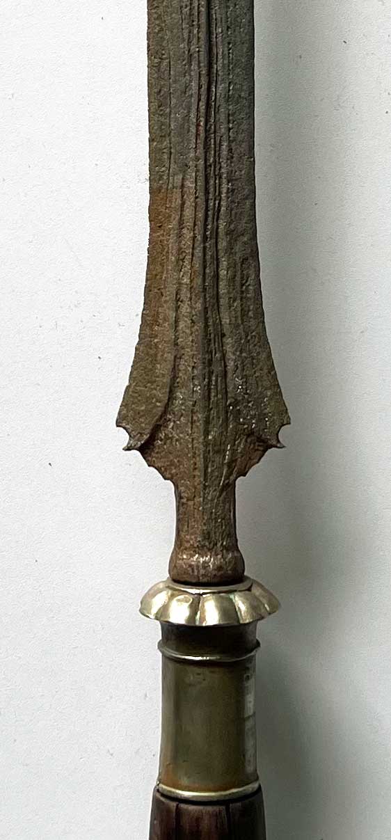

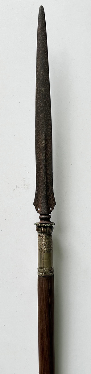

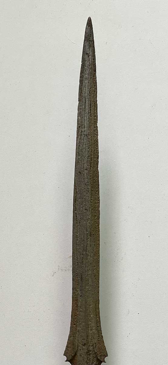

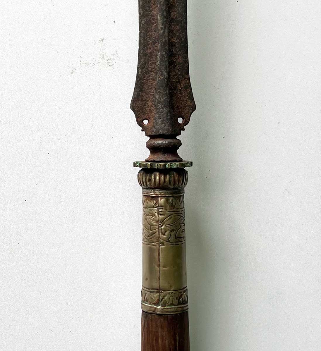

[QUOTE=Sajen;292237]I personally find it difficult to place Indonesian spears.
Thank You very much Detlef and Alan for the info.
Please find attached 2 more tombaks for your comments.
Cheers
