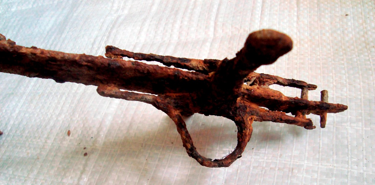

In this photo, you can see that the crossguard was additionally attached to the pin. My guess is that it has just come loose.
Photo of a Cossack sabre from excavations on the battlefield.

Yeah, I think Lee is right. It basically makes the crossguard function like a rain guard.
