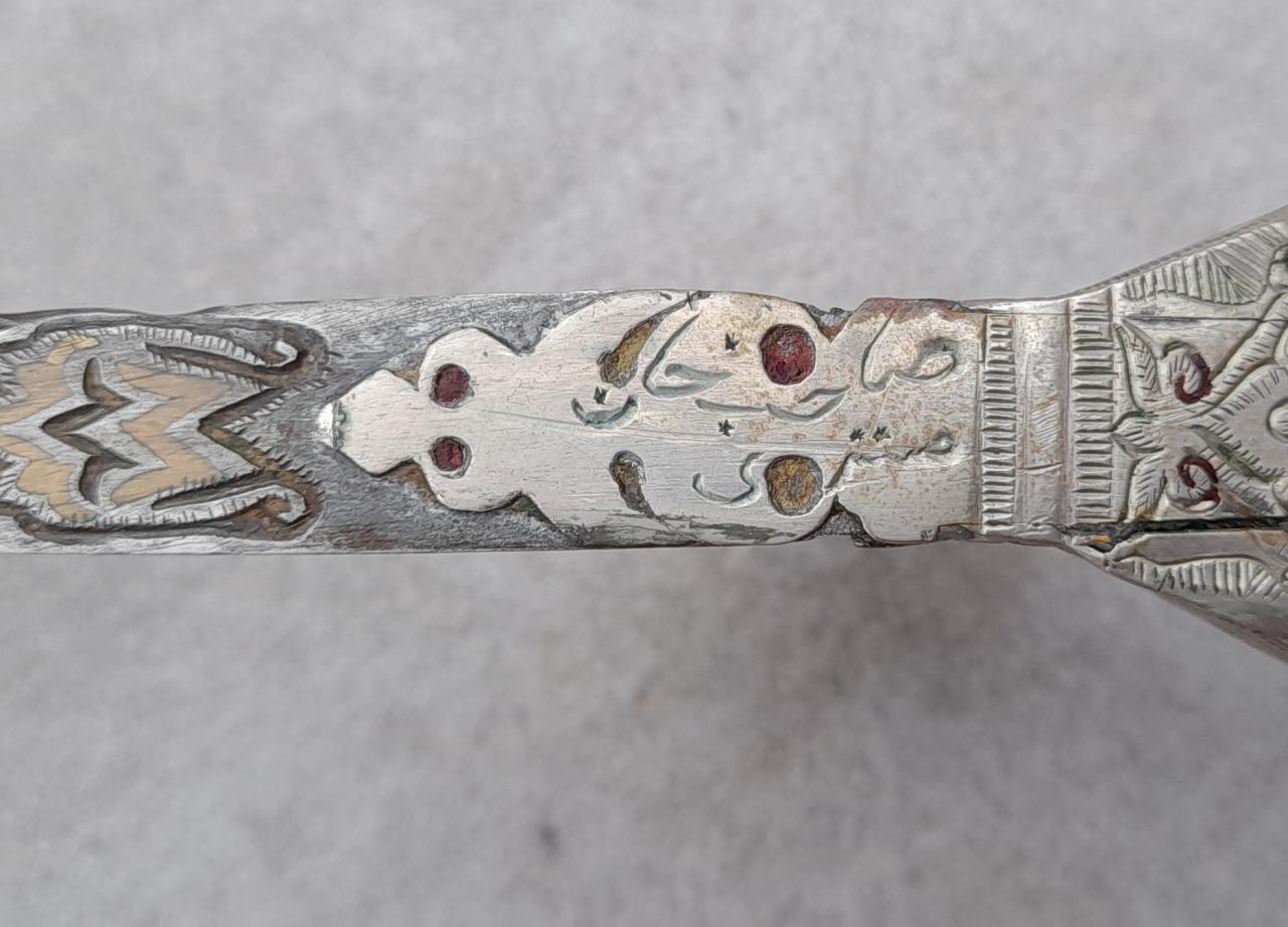

Hi all,
I posted pics of a choora on the thread " Show us your choora" in which the difficulty of dating such knives is discussed.
On my blade, there are some inscriptions in Arabic or Persian that I can't read.
Can anyone tell me if it's a date, a place or a maker's mark?
Any comments will be greatly appreciated.

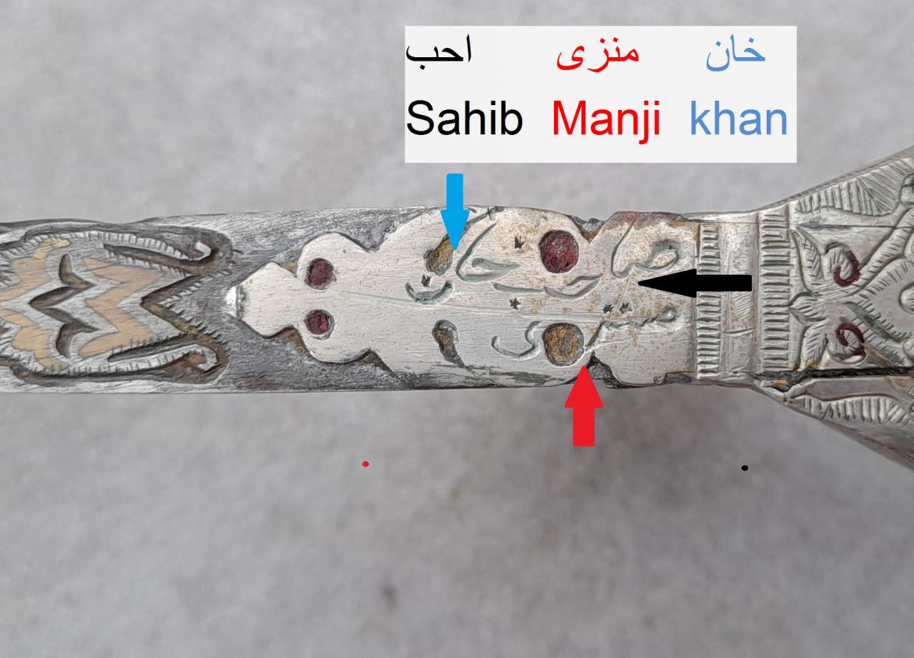

Hello. The inscription is most likely the name of the owner:
"صاحب منزى خان" (Sahib Khaan Manji)

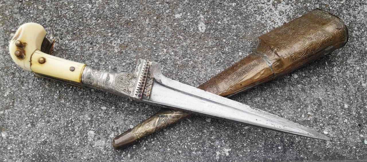

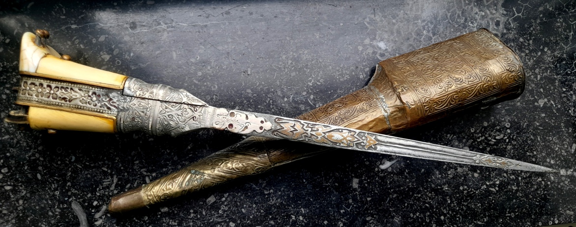

It would be nice to have a side view of this knife for the records.

Welcome to the Forum and thank you for posting your question. If you check the sticky notices at the top of the Ethnographic contents page, you will find one that describes the information required for a translation request. It includes a request that you post a picture of the entire item as this helps in the overall appraisal and translation.

Ian,
Whoops I didn't pay attention ... shame on me ... I promise to do better next time.
Here are pics of the entire knife and of course I always enjoy my visits here.
Hi Turkoman.khan
Thanks for translating the inscription.
I'm wondering about "SAHIB". Is it a "given name" like John or Bill ?
I read it was used in the past to give respect to someone you talk to, as a polite manner to adress or as a title.
Can then be deduct this knife was a gift or a present to a "KHAN" a leader or a chieftain named MANJI ?

Originally Posted by Hagard View Post
Hi Turkoman.khan
Hello, Hagard
I think your version is correct.
Best Regards

May I ask you f the colours of the translated words are correct?
Hi Turkoman.khan,
I was just hazarding a guess ... nothing certain of course.
I found another choora on the site with "similar" writing on the blade but sadly the pics are unclear. I'll try to contact the owner to get some close-ups.
Hello, my friend. Yes this is correct
