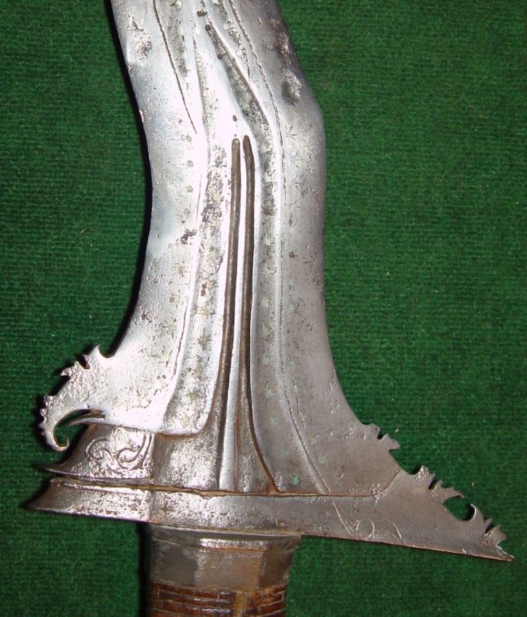

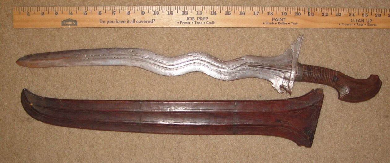

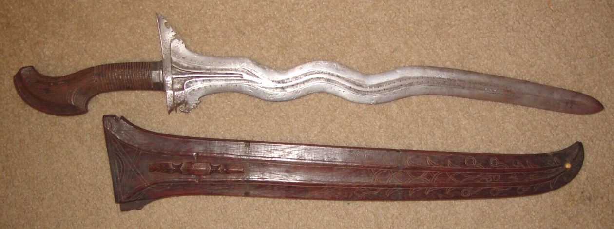

This is an interesting old sword. It is a high end, pre-1800 Moro blade with an old Waray scabbard and hilt. The scabbard is in a style seen on old garab, including the fluted carving and the small round insert near the toe on both sides. The mouth has been widened to accept the flared gangya area of the blade. The hilt is also of a style seen on some old garab.
The blade was a very good one, although much pitted over time. The central panel does not appear to be twist core, however the sinuous design with many small "stars" inset at regular intervals down the blade suggests that the central panel is depicting a centipede. IIRC, the centipede was an important creature in Maguindanao mythology.
The carved area at the base of the blade follows Indonesian keris from the late-Majapahit period, and is similar to that found on a 16th C Bugis keris that was discussed here.
Better pictures will come after it arrives.

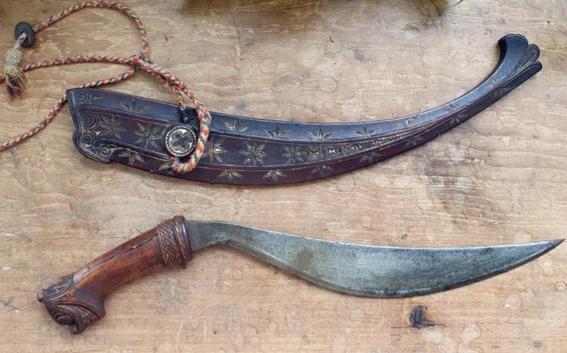

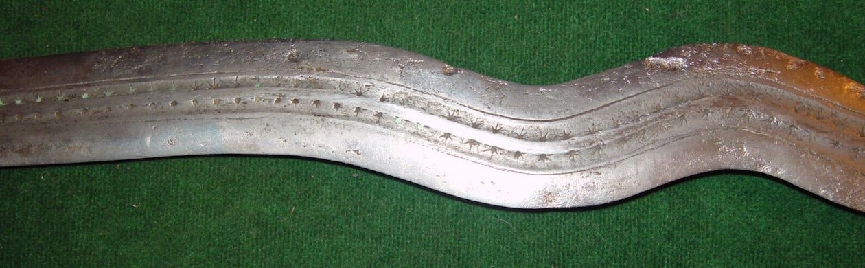

Are the star patterns on the blade unusual? They remind me of the patterns on this Visayan knife scabbard.
Old 17th June 2024, 03:55 AM   #8
Very nice garab, Jeff, congrats!
The motif on Moro blades (like Ian's here) is usually a bit asymmetrical. Thus, I believe they might be different.

Hello Ian,
Very nice blade, indeed - congrats!
It is obviously old. However, what features do you base the pre-1800 dating on?
Gorgeous fittings!
I'd have assumed that the scabbard got made for this blade? (There seem to be losses at the opening.)
This inlaid motif is commonly seen on Moro blades; centipedes are sometimes inlaid, too, but tend to be less stylized. Do we have any information from within the cultures for this interpretation (i.e. connecting this motif with centipedes)?
Actually, there are significant differences between the features exhibited by these 2 blades. Granted, there seem to be more keris features extant than in some later Moro blades. IMHO, we need a much more detailed discussion for establishing time lines. (BTW, mid-17th century is a long time after the end of Majapahit and with the Mojo power already declining for an extended time before its final demise.)
