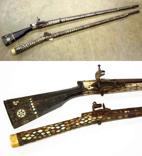

Posts: 1,492

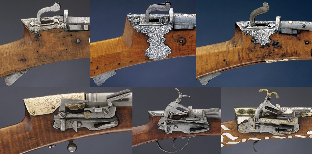

Originally Posted by eftihis
The first one looks a bit ottoman in design, what do you think? (the one with the goat hairy skin). The other looks like re-stocked ottoman barel?
Eftihis, the first one does have an Ottoman shape to it. The barrel you posted looks Ottoman to me, it seems to have all of the inlay removed.

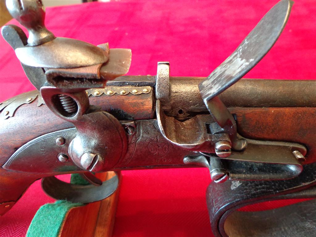

Old 10th December 2015, 03:14 PM   #33
Pukka Bundook
Join Date: Jan 2007
Posts: 803
David R,
I have heard exactly the same reason for the long usage of the matchlock in India.
Eric,

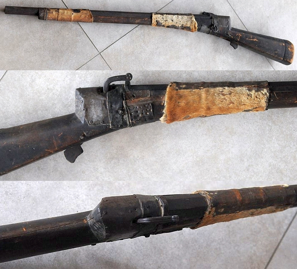

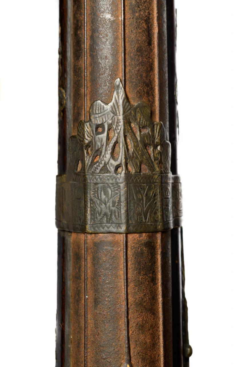

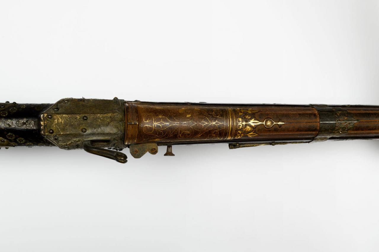

The photos you posted of the breeches at the bottom of page 1, show new 'tin' attached on some of the miquelet examples. This Must be to cover up the slot for the former matchlock serpentine. The new tin-work is not up to the standard of the rest of the gun, so must be there for this reason.
If I had one of these conversions, I'd be prying said tin up a bit and having a look!
Eftihis,
You barrel does look like a re-used Ottoman barrel, tired but still Ottoman. :-)

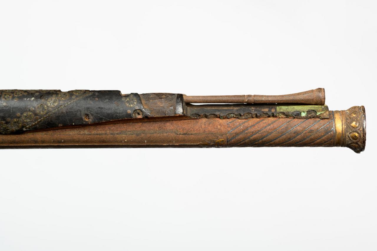

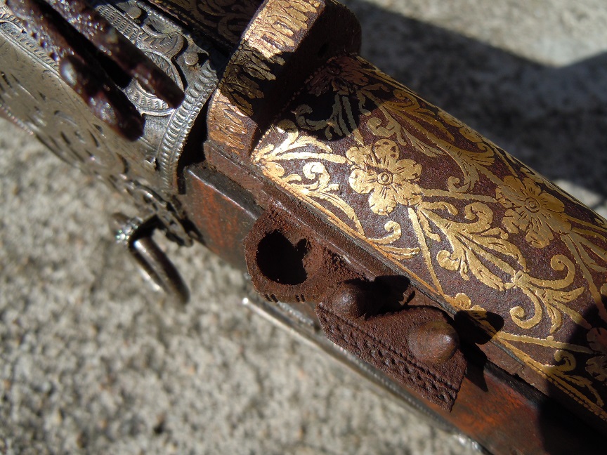

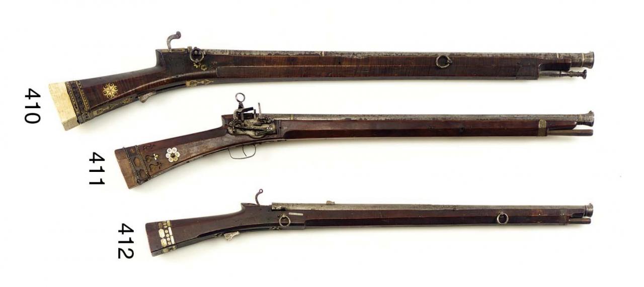

When you compare the matchlocks to the miquelets there is a big difference in the locations of the triggers. The matchlock triggers are way farther back, if one of the miquelets were a converted matchlock there would have to be an empty slot were the matchlock trigger was previously located. The old matchlock trigger slot would have to be filled in or covered with a plate, seeing something like this would indicate a matchlock conversion I would think.

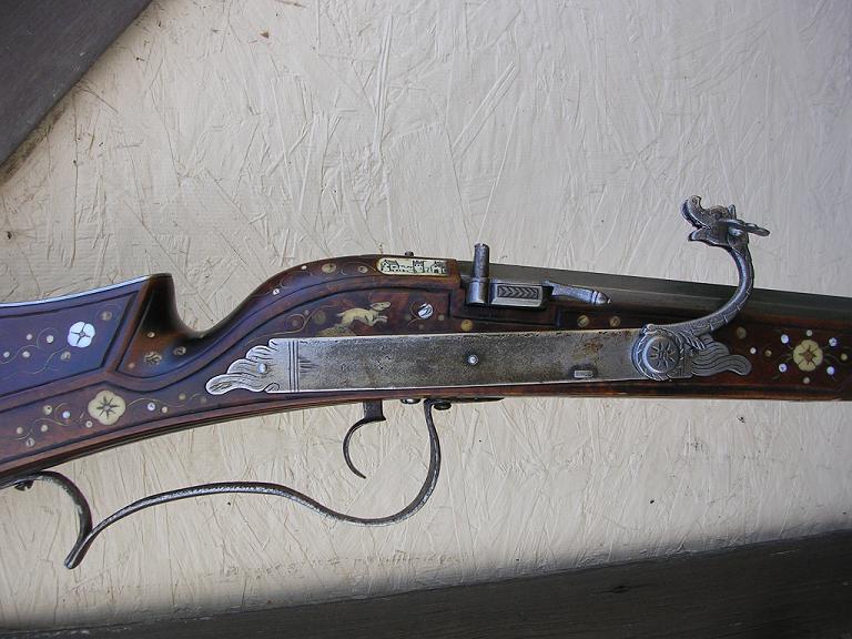

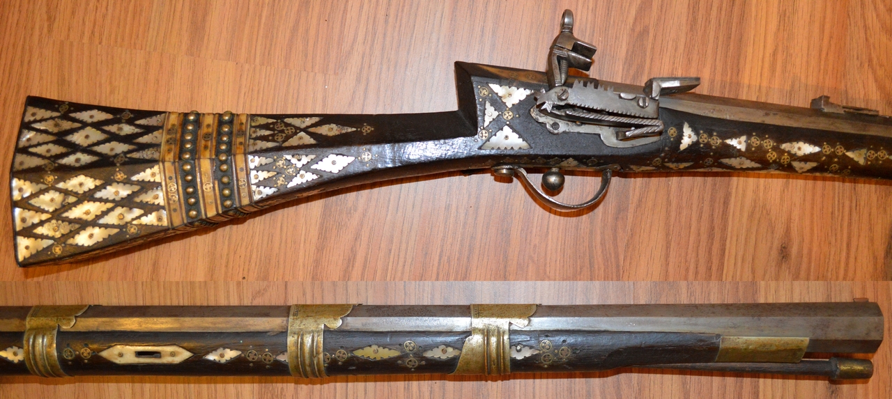

A few more examples.

Yes, the scear is further back on matchlocks, but took it for granted that many of these arms have inlays on the lower buttstock as well, and such could easily cover up the changed trigger position.

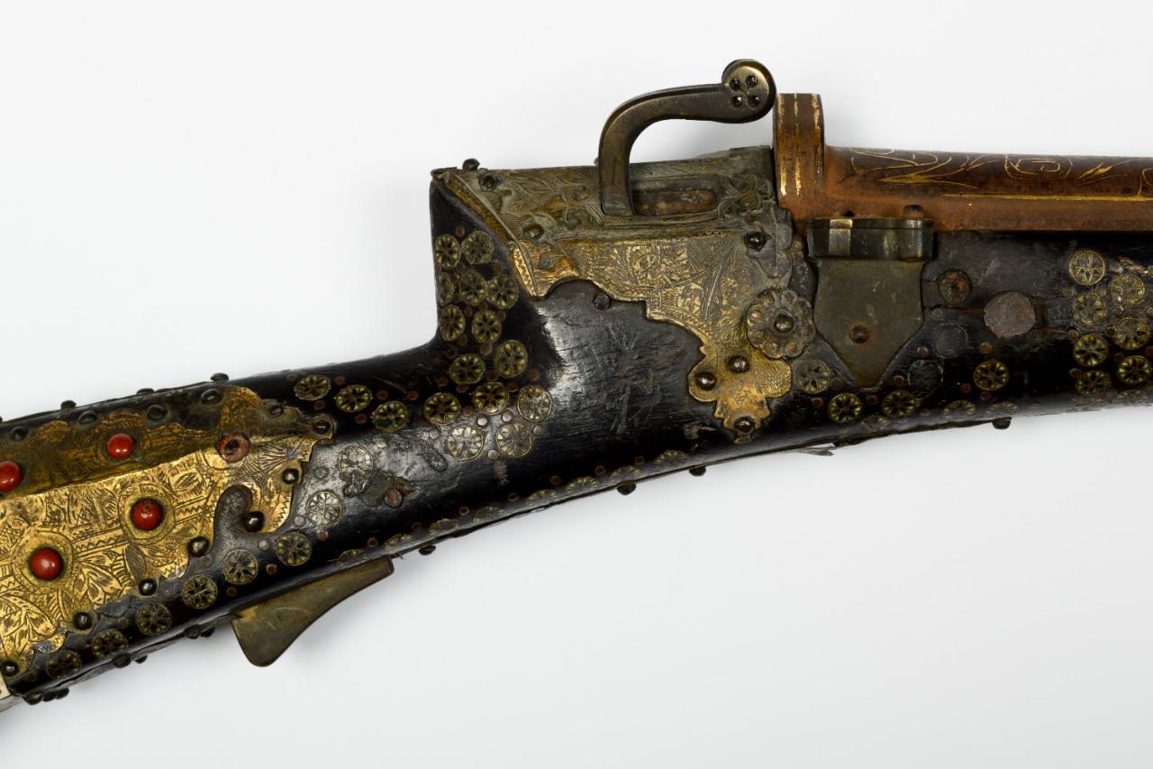

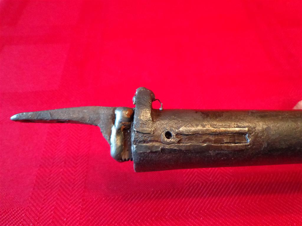

I agree, there would have to be a metal cover plate or inlay etc to cover up the slot left in a matchlock conversion. You can barely see some inlay on the miquelet you thought may be a conversion so it could have been a matchlock at one time, unfortunately there are no direct images of this area. At least we know that if someone does have an Ottoman miquelet that is solid wood underneath were the trigger is located that is was not a conversion.
Here is an image of the one with the tin plate that you thought may be a matchlock conversion. I also checked the Ottoman miquelet that I own, it is not a conversion as it is solid wood underneath.

Even on these that are Not conversions, the barrel could well be older, and re-stocked.
So difficult to pin down, and no good for me to generalise!
The one you show above with the tin plate;
It (the tin) certainly isn't original, but that's all I can say!

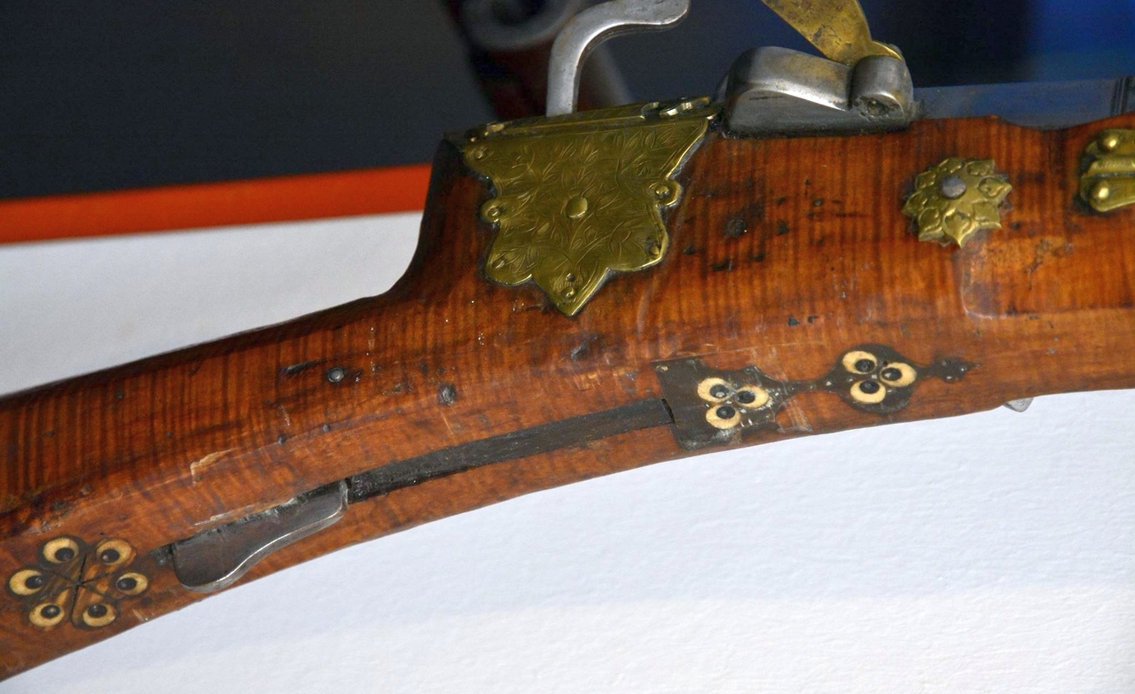

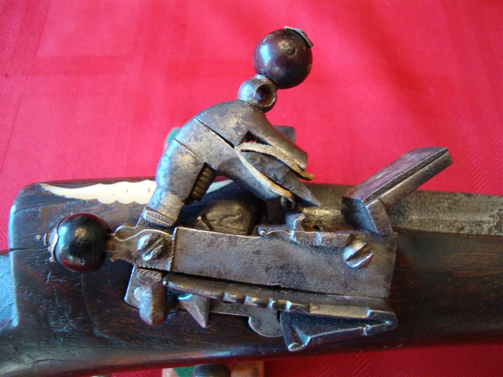

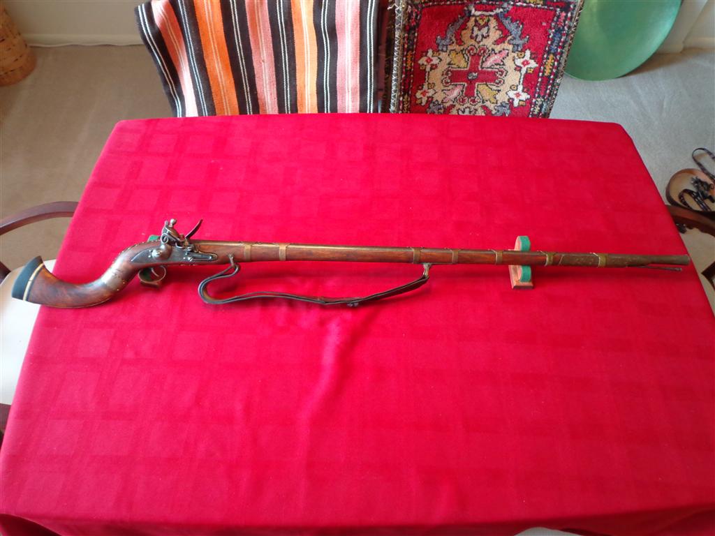

I posted these guns earlier this year, but thought I would just add this to the "conversion" mentions here in this Thread.
First is a typical Ottoman rifle. What's interesting is the gun originally had a slightly larger miquelet lock. Possibly due to damage the lock was changed to a slightly smaller miquelet lock back in the period. And wood was added to fill the gaps, but was professionally done. You can hardly tell.
Second is an Afghan Jazail whose barrel started life as a matchlock. The matchlock pan was removed, and the gun re-stocked using a flintlock.
So many of these guns were likely in a constant state of repair and re-furbishing.

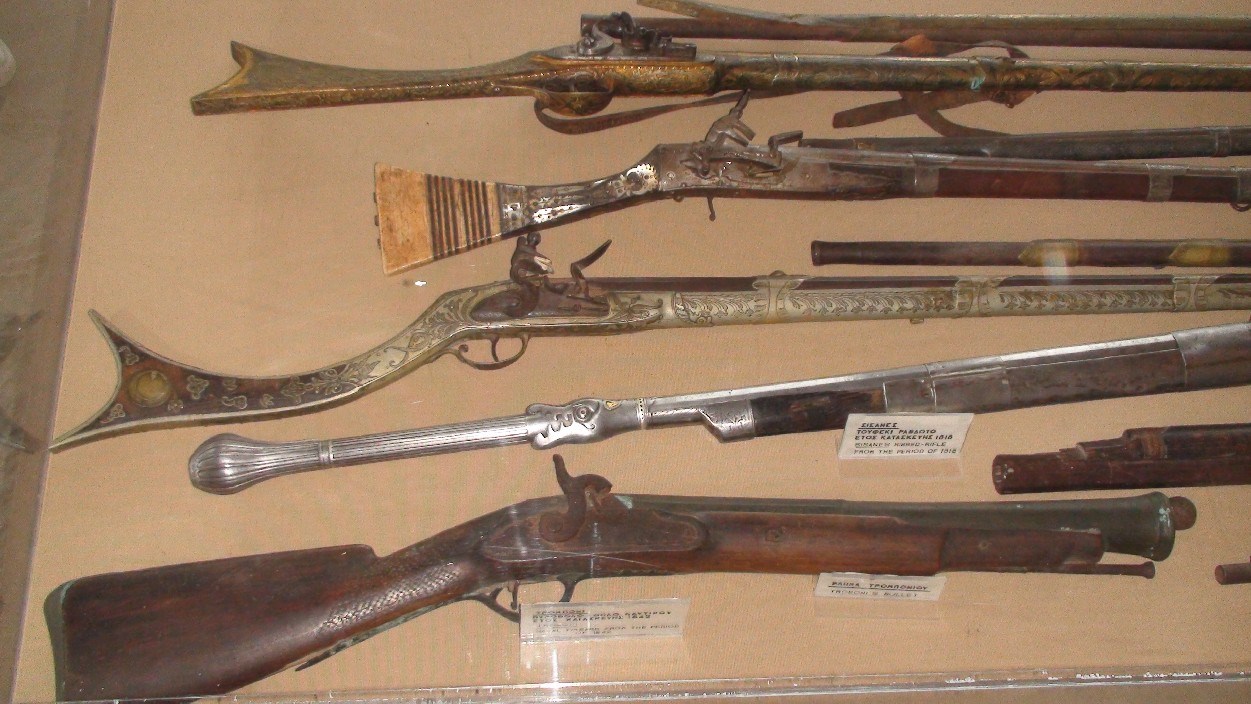

Old 21st December 2015, 11:09 AM   #43
eftihis
eftihis's Avatar
Location: Chania Crete Greece
Posts: 515

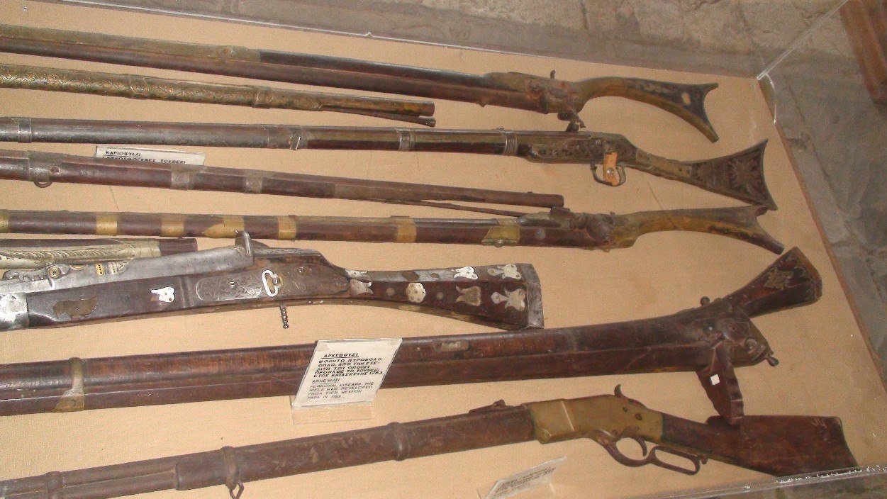

A very old example from the Greek museum of Jannina (north Greece)

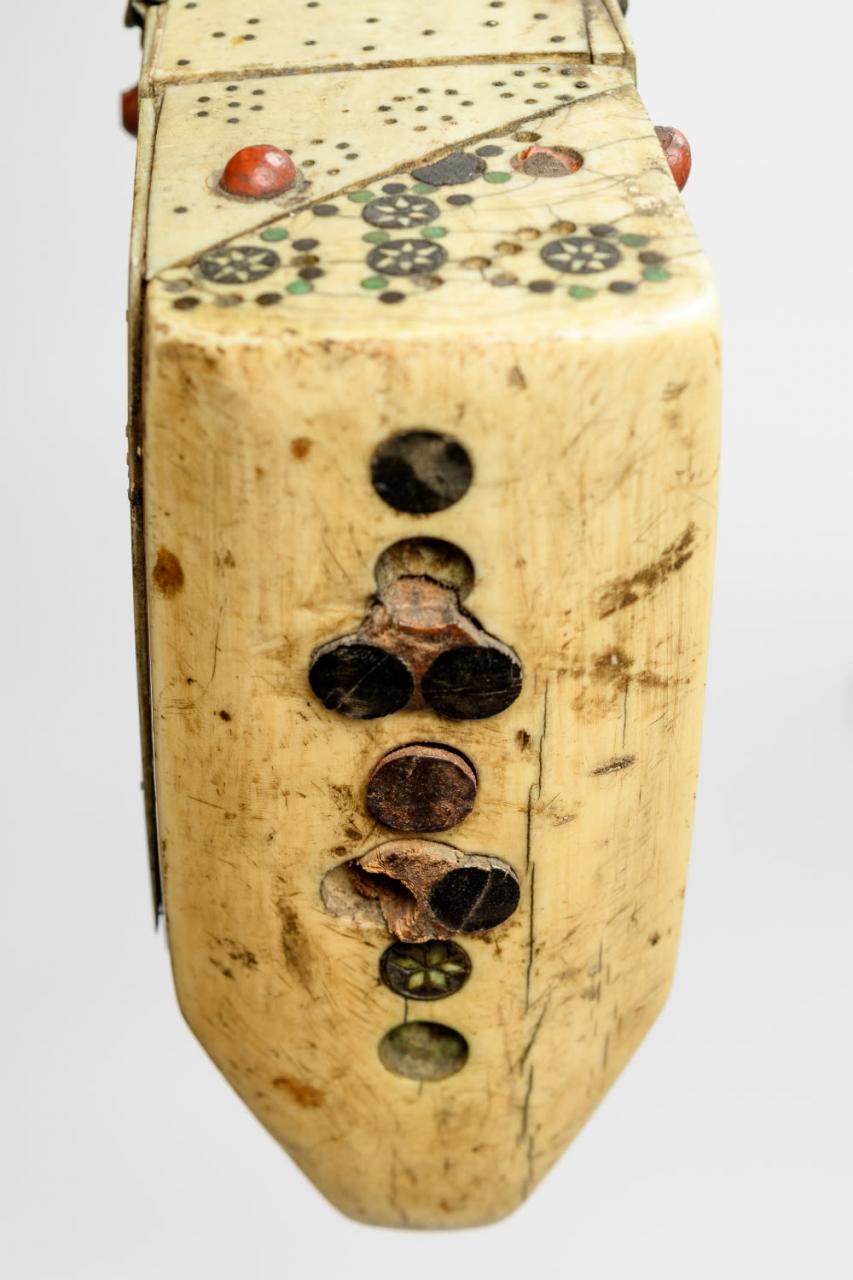

Old 6th February 2016, 10:15 PM   #48
archaeologist
Join Date: Aug 2013
Posts: 3
Default butt form

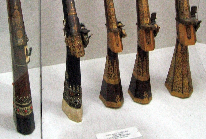

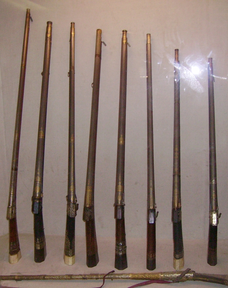

Does anyone have info or comment on the butt form - rounded cross section vs octagonal? When/where do we get that transition? Am I right in thinking the octagonal butts are typical of slightly later Turkish flintlocks?

I believe you are right, in that the faceted butt appears to be a Turkish design. As for dates, it appears we can find Turkish stocks of this style going back a very long way, into the 17th century at any rate, and up to the 19th C.
I think the round or oval stocks are more Persian, and these too were made over a very long period, and up into the 19th C.
My understanding (very imperfect!) is that the two stock types co-existed over the same time period, in different areas.
Then of course we get into the "Spheres of influence" and as these spheres came and went, fashion in arms would change as well, and not at all helpful to us!
I stand ready to be corrected in the above, but at present that is as it appears to me. :-)

Old 8th February 2016, 10:22 AM   #50
estcrh
estcrh's Avatar
Join Date: Jun 2012
Location: USA
Posts: 1,492
Unfortunately images of early Ottoman guns are rare, in fact this is as far as I know the largest collection of such images ever discussed. From what I can see, the early Ottoman matchlock/flintlock butt was not nearly as flaired out as the later ones, that is just a personal thought based on the images I have seen.

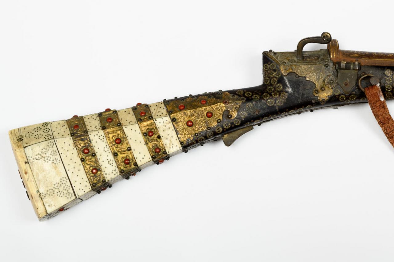

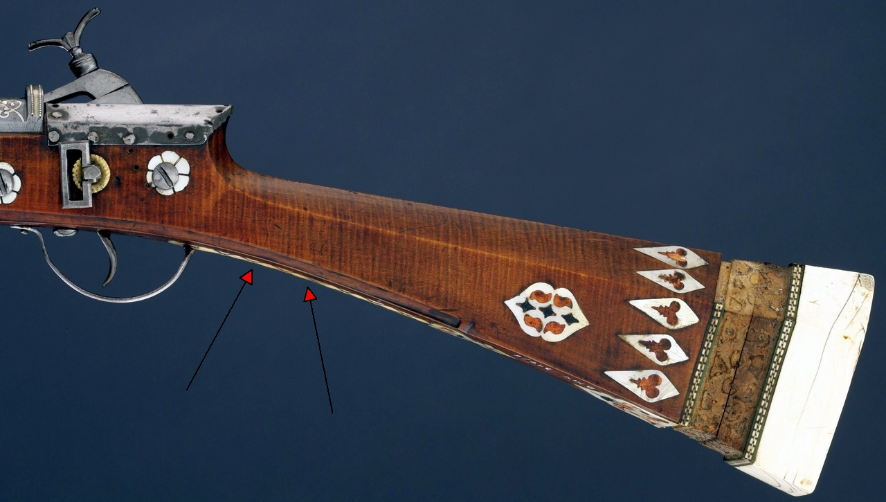

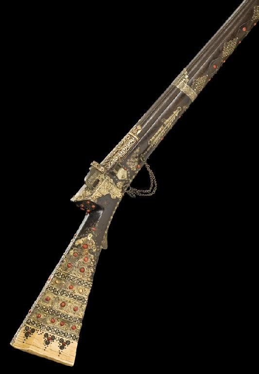

Richard, when looking for Ottoman matchlock images I found that Persian examples were even more rare, I do not remember seeing a Persian matchlock and only a few Persian flintlocks. I believe this image shows an Ottoman gun next to a Persian one.

I believe you are right in your assessment of the last photo, one Persian, and one Ottoman.
I believe that Manouchehr has photos of Persian matchlocks in his series on Persian arms, in "Classic Arms" magazine.

Posts: 25

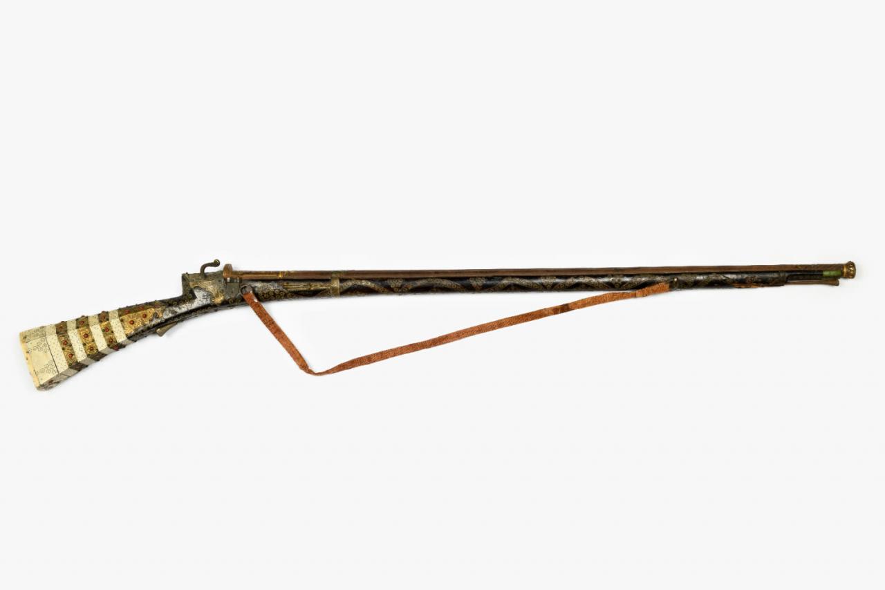

here is also from my archive.
bobi13 is offline   Reply With Quote

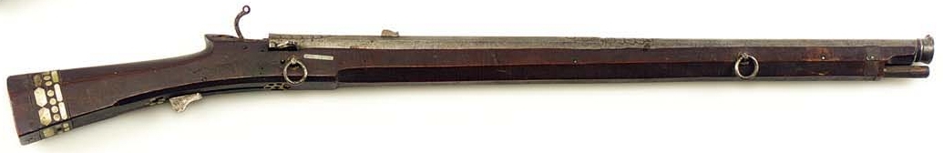

Posts: 25
Here is also from my archive.

Posts: 97

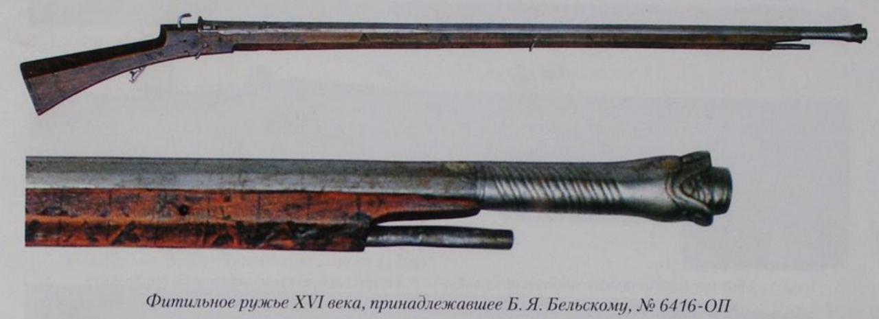

One with provenance: A 16th century example that belonged to Bogdan Yakoblevich Belsky
