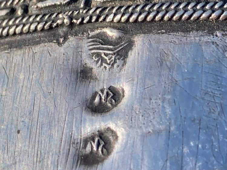

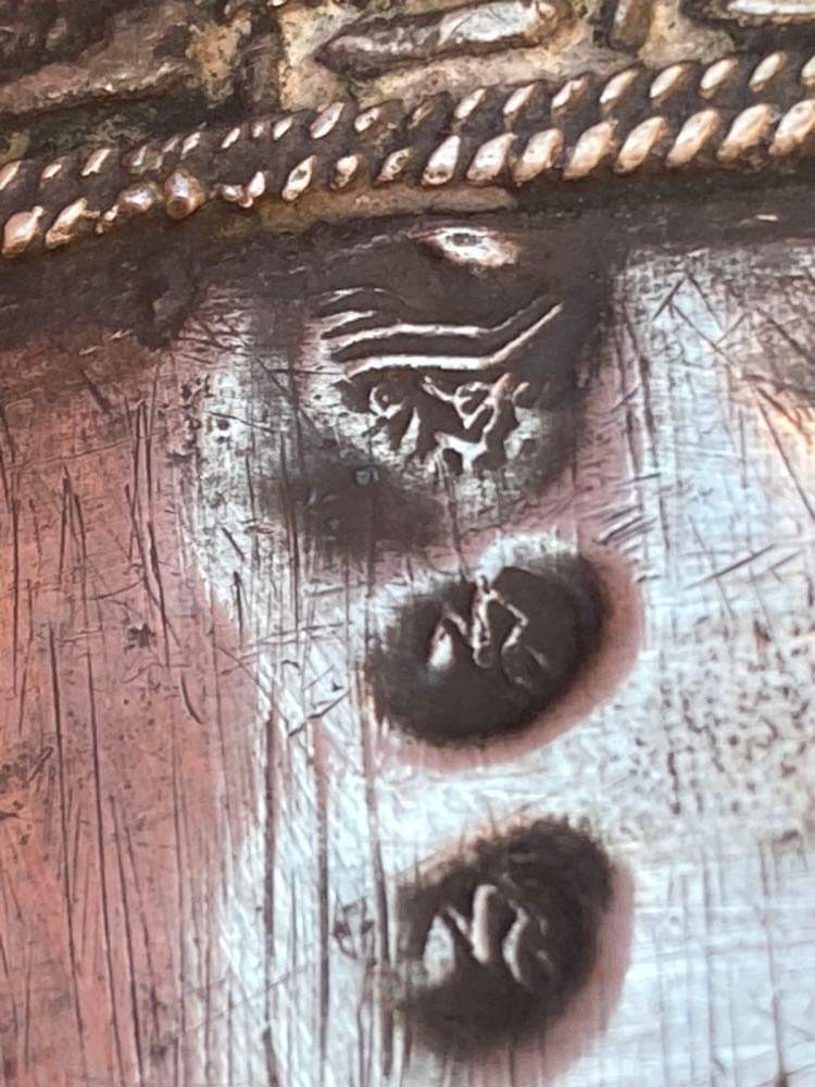

Ottoman/Albanian Khanjar scabbard markings. Is anyone able to read or identify any of these markings that came out when I cleaned the scabbard today?
Possible Turkish Tugra?
Thanks.

About identification...I am curious what is the reason why this type of daggers are designated as Albanian?
About the marking...The first is the sultan's tugrah is placed on silver objects certifying paid taxes to the treasury.The rest are the master's stamp

Thank you. Any idea which Sultans Tugrah this might be, to show its age?
I’m not sure why they are designated as Albanian. Is it because this type of grip was more in Vogue up there perhaps?
The possibilities are two, maximum three Mahmud II or Abdul Hamid II. It is highly unlikely to be Selim III.

I believe the designation of these daggers as Albanian or Balkan is completely wrong!
The turgha stamp on this one points towards a TURKISH origin, and not Albanian.
Moreover the style of these daggers has nothing to do with Albanian traditional motifs.
Last, but not least, Albania had no tradition in producing weapons and there are no known historical examples of this type of "albanian daggers" or anything similar BEFORE the Turkish Ottoman occupation.
So, I am convinced this is a TURKISH hançer, either made in Turkey (most certainly because of the Turgha punch mark) or made somewhere else in the Ottoman empire by a Turkish swordsmith.
I have seen many other types of swords, daggers, or even yataghans atributed to Greece, Albania, Bosnia or generally "the Balkans" that are typically Turkish. I believe this to be a major error that continues to be propagated and amplified through anecdotal means.
Even Elgood in his book "The Arms of Greece and Her Balkan Neighbors in the Ottoman Period" presents many typical Turkish weapons as being Greek or from the Balkans simply based on anecdotal evidence. Namely because the owner of the blade said so... Completely unscientific, unprofessional and misleading!
So, is a yataghan that was made by a Turkish swordsmith that moved along with the Turkish army and was stationed in Greece, Greek?! Or can we say that the yataghans produced by him are Greek?!
Because this is exactly what happened in most cases. The massive Ottoman army was accompanied by many Turkish swordsmiths when it conquered and occupied Greece and the Balkans. And these Turkish swordsmiths established some production centers in these occupied regions and continued to supply weapons to the Ottoman army stationed there.
While there are some, very few, typical Ottoman weapons like yataghans or kilijes that have clear stylistic particularities that allow them to be confidently attributed to Greece or the Balkans, the majority are not, and should be considered as Turkish, if there are no clearly distinguishable features that distinguishes them from the ones made in "mainland Turkey."

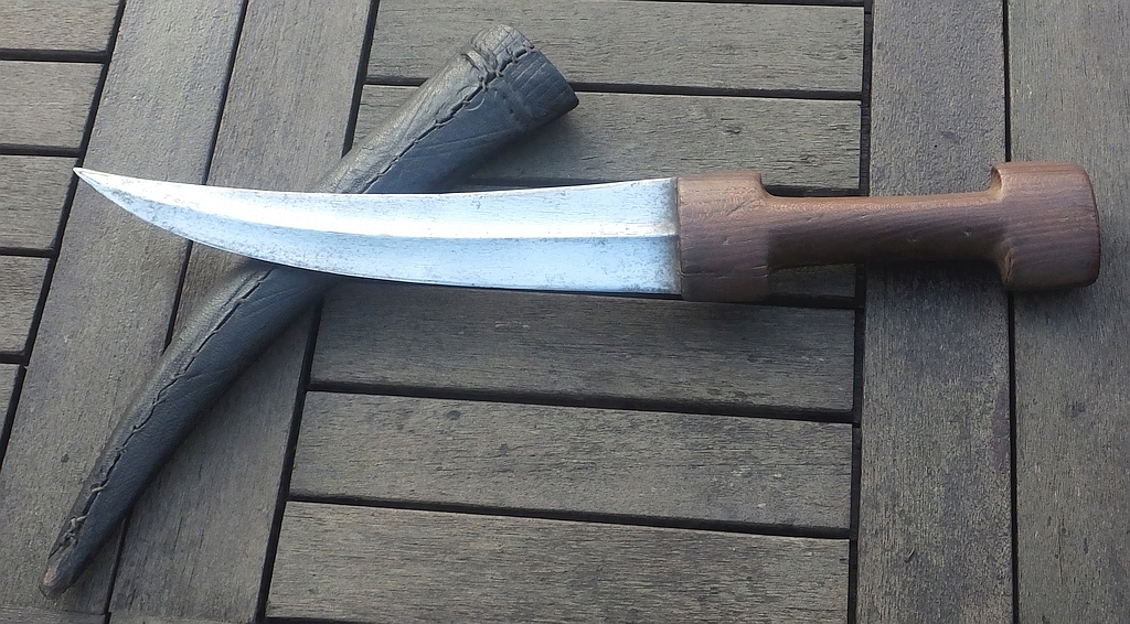

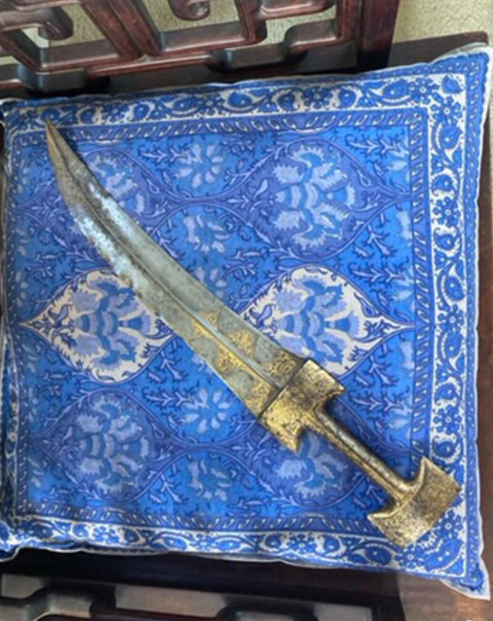

Yes, I do also find it odd that this could be attributed to being Albanian, when all the markings show Turkish provenance. At least to my limited level of knowledge on these types of bladed weapons.
Here are two pics of the blade.
I have two, similar with yours.
They both have wootz blades. This is enough to completely invalidate its "Albanian" attribution as wootz was not produced in Europe at that time (with the exception of some Turkish smiths).
It is quite likely that yours is wootz too so you may want to clean and check the blade for wootz.
I was looking at the medial ridge and koftgari thinking the same thing. I can't see the finer motifs and/or inscriptions. Odd thing I did notice that I will have to look at other examples and see if it is a common occurrence is that if you look at the two halves of the koftgari as a whole it looks like the vessel motif.

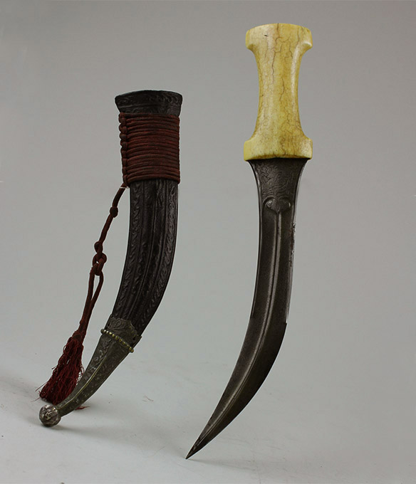

I still think it's Kurdish. Kurds occupy a rather large part of eastern Türkiye, as well as in Iran/Iraq.
My Ottoman Kurdish jambiya/khanjar, it's wootz, by the way:
Yours is just a bigger fancier version.
My friend, you are wrong. Of course, Kurdish and Ottoman khanjars are somewhat similar. But this is a very distant "kinship". I had several richly decorated Kurdish daggers. They are decorated in a completely different style.

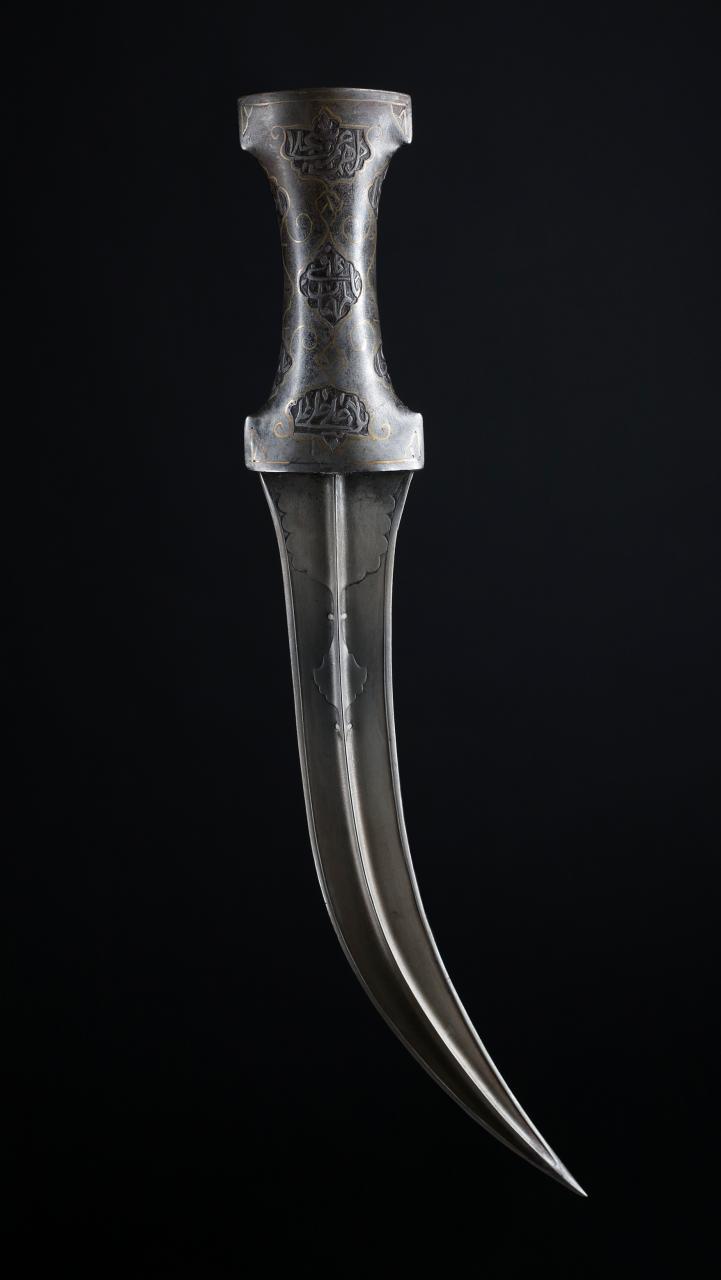

Of course there are similarities between your Kurdish dagger and the one above!
But even more similarities are between your Kurdish dagger and a classic Persian khanjar. Yet your dagger is Kurdish, not Persian because of the very few, but distinctive differences.
The same goes with this dagger. It is Turkish, not Albanian, nor Kurdish, because of the few but very typically Turkish differences... without mentioning the presence of the Turgha punch mark that would be inconceivable on a Kurdish dagger.
And I believe the Turgha punch mark proves this dagger was made by a smith associated with the Ottoman imperial court, as to my knowledge, only few smiths were granted the right to use the Turgha stamp, namely those closely associated with the imperial court. That's why I also believe the place of manufacture of this dagger was in Istanbul area.

Very logical approach, but it ignores the cultural context entirely. Apart from the location of where something was produced or assembled, the cultural context matters.
I am attaching an example. The weapon in the attached photo derives from the Italian storta, especially in terms of the blade and the guard. The blade itself was made in Europe, quite possibly Italy as well or Central Europe. It is hard to say who fashioned the grip, which is decorated in Ottoman style. If I had to make an educated guess, a descendant of Jewish migrants from Iberia seems like a plausible option. Its intended user was almost certainly a corsair of either Turkish origins or a Dutch or English renegade.
If we follow your approach, then this is really an Italian cutlass or an Italian/Ottoman hybrid. And yet, Eric Claude would call this an Algerian nimcha, even though apart from being assembled in Algeria, its parts, makers and users were not Algerian per se. He does so because these nimchas were regionally specific to Algeria, where they were used by corsairs operating out of Algerian ports.
When I refer to a weapon as Albanian or Sudanese or Viking, it is a cultural and regional attribution rather than a claim on ethnic origins. The latter is usually very difficult to lay an absolute claim on anyway.
