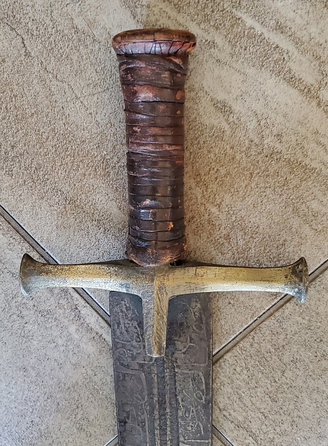

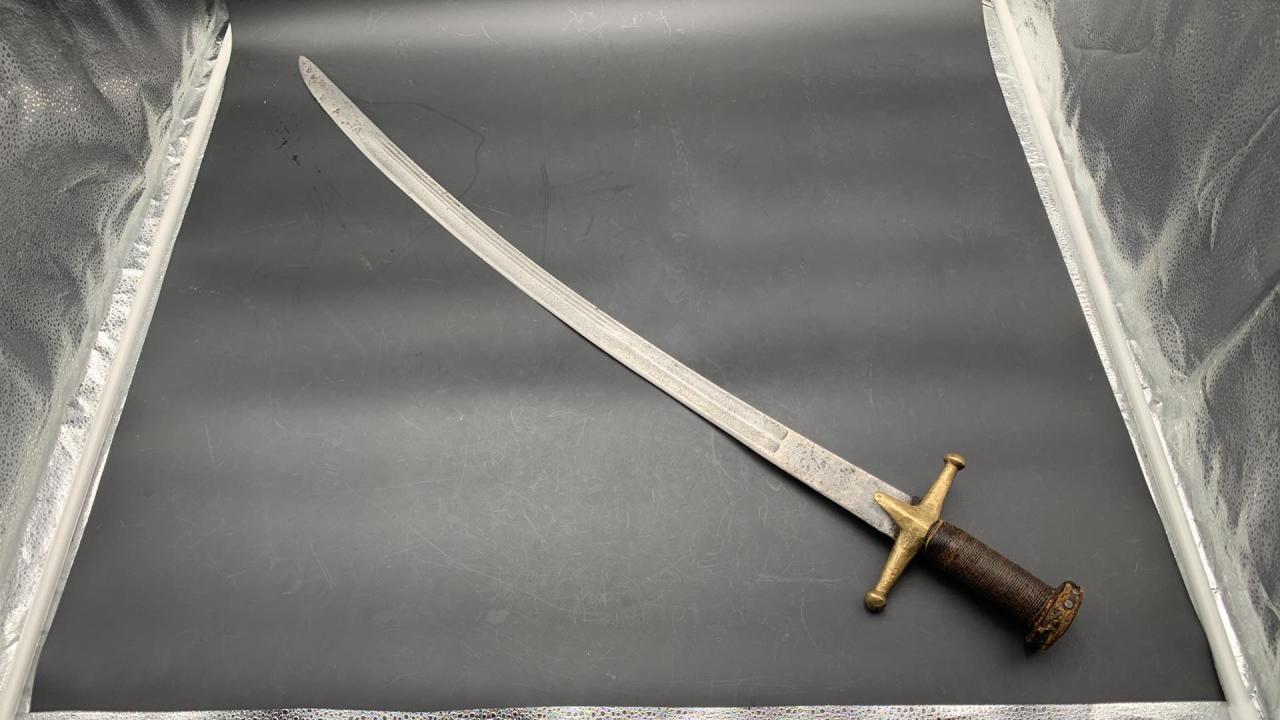

Dear lovers of African and European swords, I add a kaskara with a european blade. It is unusual because it has a curved blade that is unsuaul for a kaskara. There is a maker mark at the forte that depict what to me look like a Roman soldier. The blade has a one and 1/4 cutting edge. The blade looks quite old and I suppose that an expert of XVIII to XIX century military blades could establish from where it come from. The brass guard is slightly different from the guards of the kaskara of the end of the XIX centuryx. It is hand made. The handle is covered with leather and it has a leather covered pommel. I hope to find the origin of the blade although it could have been married with the rest in later age. I think it is at least from the end of the XIX century.

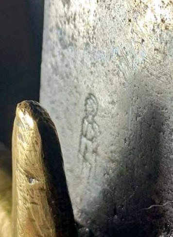

Very nice sword Mauro, thank you for sharing with us. The knight marking is of Clauberg from Solingen. Blades by this maker were very prized on the Arab peninsula, based on info A. Alnakkas collected at local souks. I would not be able to tell you what years the mark without any writing around it was used, but if someone can then it might give some insight as to when the blade was produced. 19th century seems like a very reasonable estimate on age.

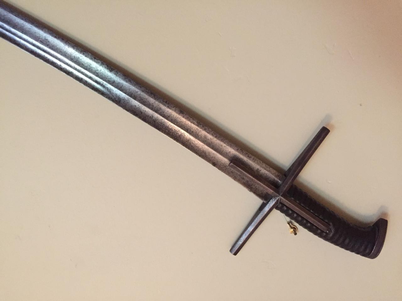

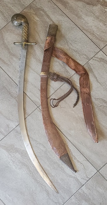

Posts: 10,860
In the original post, Mauro was hoping to find the probable origin of the blade on his unusual Sudanese saber. As Ed has well noted in his post #6, by proper classification this is clearly not a kaskara, which is by definition a Sudanese broadsword.
In my post #4, I noted a saber I have which has distinctly Sudanese characteristic elements, and as such I have deemed it a saber which is probably Sudanese.
While the discussion of these other saber blades from Aceh etc. is interesting it has little to do with the original question by Mauro.......how old is the blade on the most unusual saber he has, and the most salient element , the standing knight marking on the blade.
If I may reiterate my notes from previous post, the marking of the standing knight actually was fairly well known on Sudanese kaskaras (broadswords) but here is the point.......as far as I have known not on a saber blade in a kaskara style hilt. It is, again as noted earlier, the mark of Wilhelm Clauberg of Solingen.
Here it is important to note that Gen. Gordon while Governor General of Sudan in 1878 invited Rudolf von Slatin of Austria to become the Governor of Dara in SW Darfur. Slatin arrived there in 1879 to take that post.
In this time there was considerable trade in these regions which included of course Austria and Germany . In 1882 as the Mahdiyya had begun, a rebellion of Rizeigat tribesmen in Darfur took place in support of the Mahdi, and Slatin was captured. After the death of the Mahdi in 1885, he became the prisoner of Khalifa Abdullahi, until his escape in 1895.
In his book "Fire and Sword in the Sudan" (1896) Slatin notes that the Mahdi himself had a sword with a blade with markings and inscriptions clearly indicating its Eastern Europe origins. This would suggest that these blades were notably present and of high esteem in this period (1882-1885).
In references it is noted that the sword blades made by Clauberg appear to be from the period before the end of the Franco-Prussian war (1870), so this blade would appear to be from a cavalry saber pre-1870.
Whether it was mounted in the 'kaskara' style hilt in that time is unclear, but that it arrived in Sudan sometime around 1880 or slightly later seems most likely .
Mauro, I hope this might shed some light on the likely circumstances of your most interesting saber.
I have attached your photos from original post of the saber and marking we are discussing.

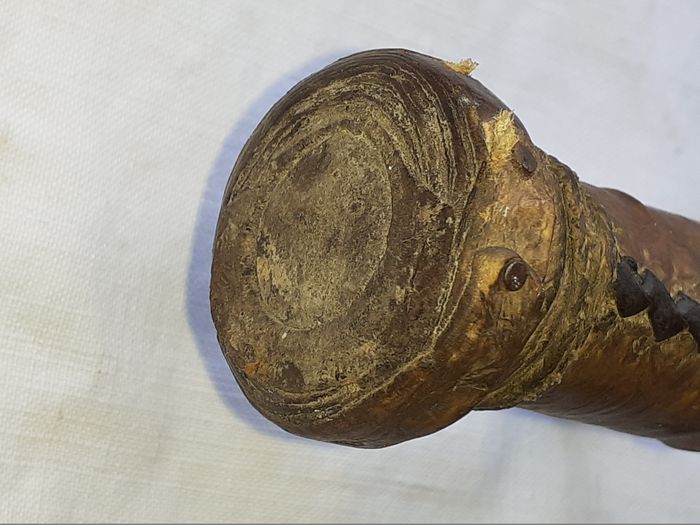

Certainly the "pommel", if we can call it that, looks very Sudanese - at least the side of it we can see in the pictures, including the little nail that is holding the leather together (compare to the one below from a more typical kaskara). It is interesting to me how that pommel alone gives the entire sword a "kaskara" feel even when the rest of it is not entirely typical.
EXACTLY!
That is the thing with weapons, they do not always follow exact patterns, nor necessarily adhere to distinctly matching elements. As various weapons filtered into different spheres through trade routes networking through many tribal spheres, it is reasonable to presume certain workers or shops might alter their designs or methods according to other influences.It is interesting that there were apparently European workers in some degree in these shops who had been in Khartoum from Gordon's time.
This saber I have, which reflects of course Ottoman influence, has a shamshir style blade which is of a Turkish form of damascus (I'll leave that to the experts here). There is a 'kaskara' feel to the hilt combined with the bulbous Ottoman hilt, the lozenge cross hatch is mindful of such motif on the Darfur hilts of the so called Ali Dinar period in early 20th c. and the Kassala style hilts.
As Ed has noted, scabbard style may add to classification, note the distinct Sudanese style with flared tip.
On a side note to that I have always found it curious that the Manding sabers of Mali have that same flared feature on their scabbards. I have brought that up any times on these pages without response.
