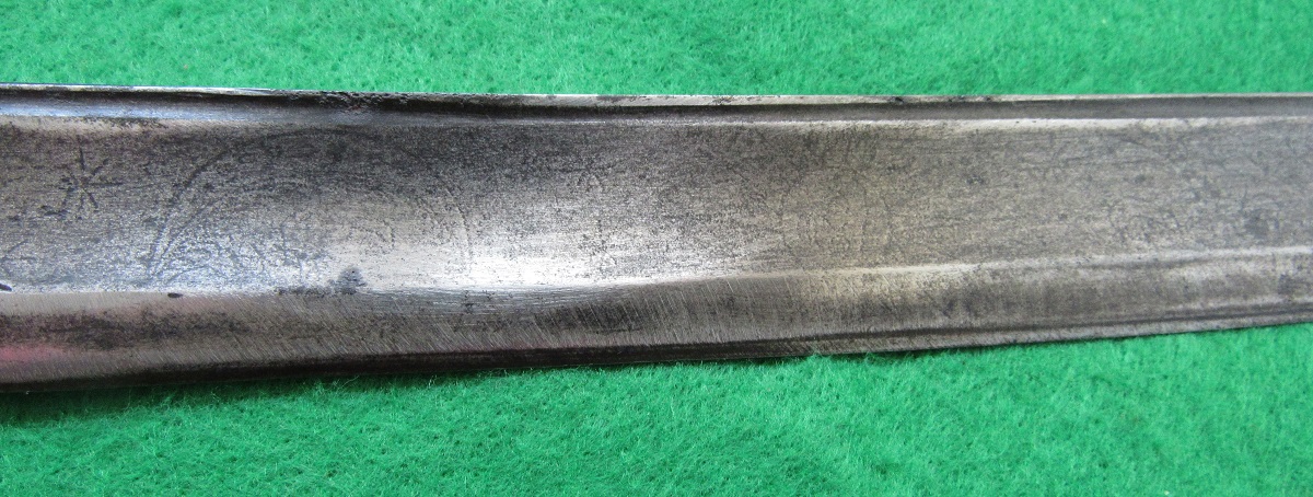

Hi All,
Can anyone tell me anything about this sword?
Only one edge is sharp which I believe makes it a backsword?
The handle is wooden.
It has a sun etched into it.
Appears genuinely old (to me).
Thanks a lot!

The blade looks old but also cut down. Don't know about the sun etching. The double fullers look similar to those on this British 1788 pattern heavy cavalry sword. https://www.militariahub.com/wp-cont...YCAVTROOP2.jpg
So I would guess late 1700s to early 1800s.
Regarding the hilt... no idea.

It's a reused blade in an ethnic hilt, possibly Berber, try it in the ethnic forum.
Old 22nd January 2023, 04:49 PM   #5
Posts: 10,867
This is indeed a cut down cavalry blade of 1780s-90s possibly French, certainly European, could be British. This type of wood hilt is typically associated with regions in Tunisia and environs. It is hard to say how long this blade circulated in this sphere, but backswords do seem to be seen on these types .

This is a Berber sword, most of these are attributed to Tunesia. The hilt is made of horn, which sometimes looks like wood. Many local and European import blades were used. Often with a self-made leather scabbard. Many are decorated with European marks such as crescent moon and eyelash marks which originate in Germany and Italy. It dates from the 19th century.

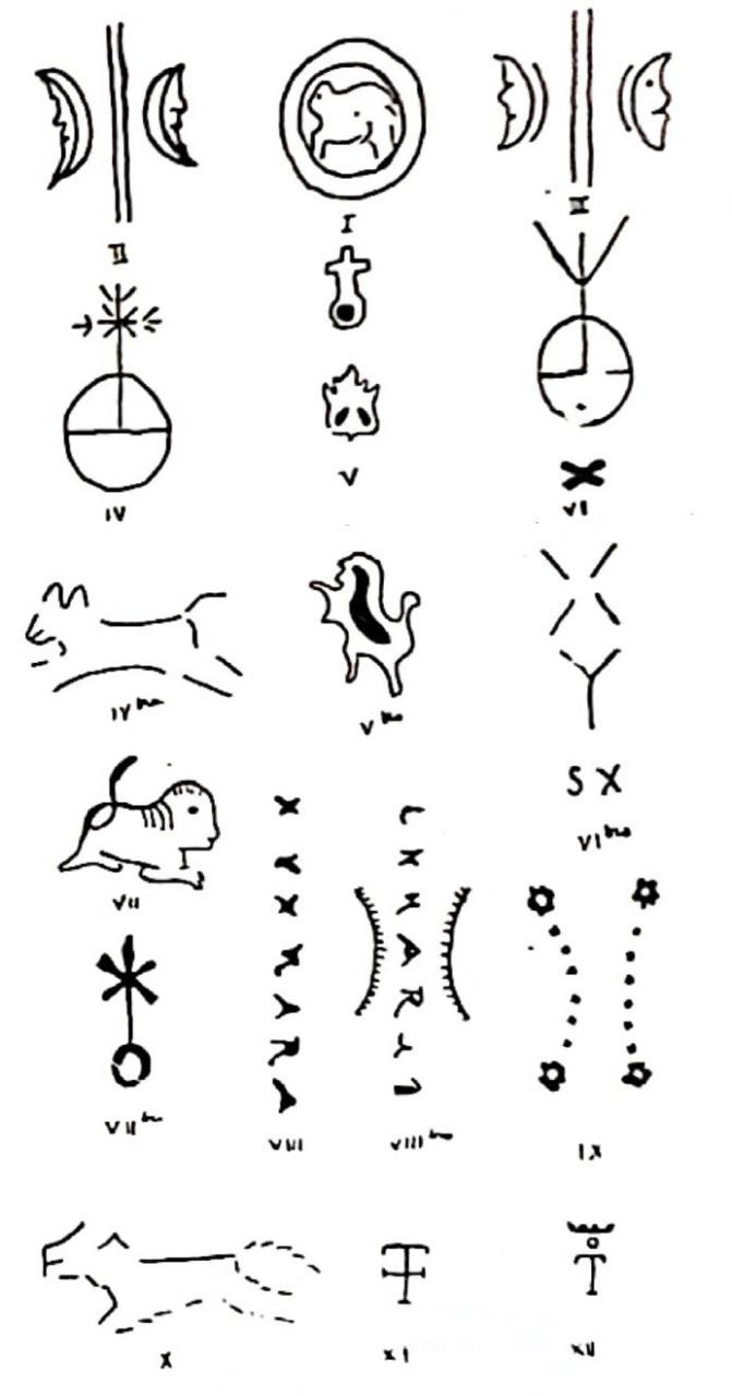

In 1954, Henri Lhote writes the following in his book ‘Note on the origin of Tuareg’s sword blades‘:
”II and III- Genovese marks, but also done in Germany, in Solingen, by Clemens Stamm (circa 1590); in Italy, in Padua, by Pietrus Antonio Furmigano (circa 1565); in Spain, by Juan Martinez from Toledo (circa 1565) and also by Pedro de Belmonte, of which we already spoke. The Tuareg craftsmen, who call that mark ayor, the moon, or télit, have imitated it frequently.”
He referred to an illustration which I will try to add. Another photo is added of an arms dealer in Tripoli selling a similar sword.

This is absolutely brilliant insight Peter! Thank you so much. As someone long fascinated with Saharan swords, I very much appreciate this added detail, especially the material from Lhote, who was an important writer on these weapons and Tuaregs.
I am curious on the 'moons', which long ago I found these referred to as 'dukari' (I think it was Rodd) and tried to find European parallels to these placed in pairs on the Tuareg blades. In Briggs they appear on 'Hausa' kaskara it appears.
These makers listed are important as sources for the European blades which must have inspired the native blade makers.
