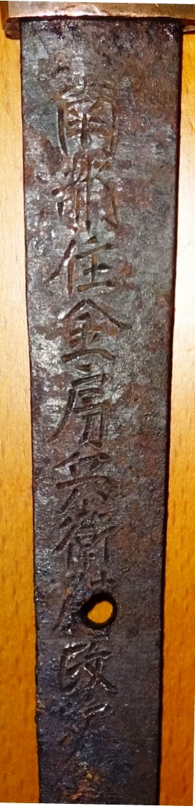

Unfortunately, I can't translate the signature, but I really liked the calligraphy. Beautiful, strong, confident handwriting!

Unless I missed it, no one has translated the signature of this blade. With the clearer image that is possible. And it let's me correct my earlier assessment.
This blade is signed Nanto ju Kanebo Masatsugu. (MAS1654)
He was a smith who made polearms in the Yamato district (call it Nara) in the early 1500's
I had assumed that it was later than that. and naginata that date before 1600 are both RARE and GOOD.
