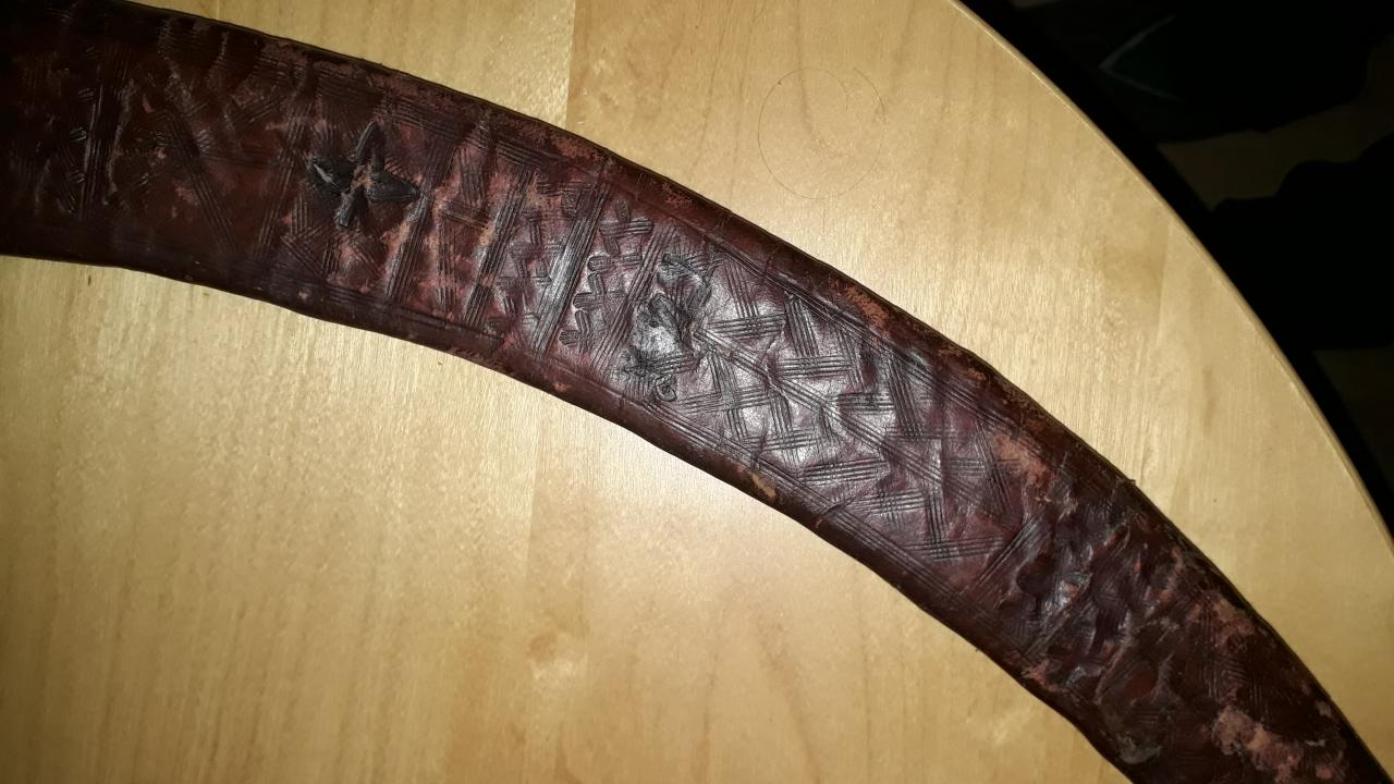

Thanks to all for the very informative observations. I also thought that the scabbard was unusual and picture worthy(even though I didn't know why). The stitching also looked a bit out of the ordinary as well; am I wrong?
Old 17th October 2022, 03:44 PM   #12
Posts: 10,872
To me the scabbard is one of the great features here, and it seems Ive seen that stitching method before, I thought on the curious types shown in "African Arms and Armor" (Christopher Spring). It shows Ethiopian gurade with similar scabbard but with vertical handle at tip to hold as blade withdrawn.

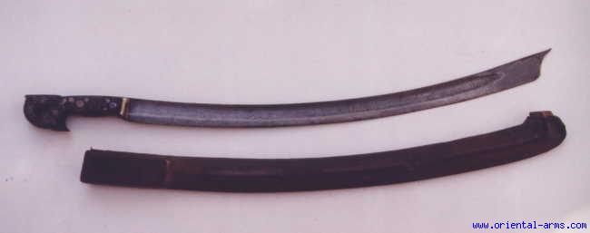

It seems that Tirri(2004) noted that these 'Berber sabers' were examples from the 'Rif' wars in the 1920s. However there is no specific mention of why these machete/sabers from the Caribbean regions would be in the Spanish protectorate or colonies in Morocco. I cannot cite a source for the suggestion of conscripts or volunteers, but it was something I recall hearing or reading.
Alain Jacob in "Les Armes Blanches du Monde" (1985) includes one in the Hispano-Moresque chapter. It does seem most references concur with your Dominican attribution, but these do seem to have circulated in other Spanish locations.
It is a good point about why would forces going to Morocco take their own weapons, unless they were indeed volunteers. While these Caribbean regions were independent, there were notable populations of Spanish immigrants from what I have understood. It would of course take more research on these events in the Rif to learn more on the forces. While these were clearly 'machetes' , which would seem odd to carry to these Moroccan regions , if irregular forces they would have used what they had.
Returning to the original topic, why would a scabbard feature from Morocco end up in Ethiopia or vice versa?
Page from Tirri, and Oriental Arms describing these as Moroccan 'Berber' sabers.

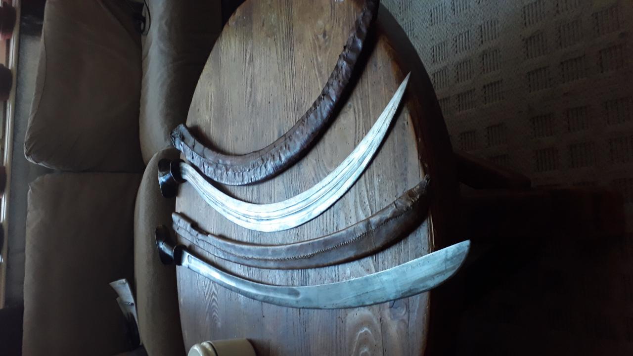

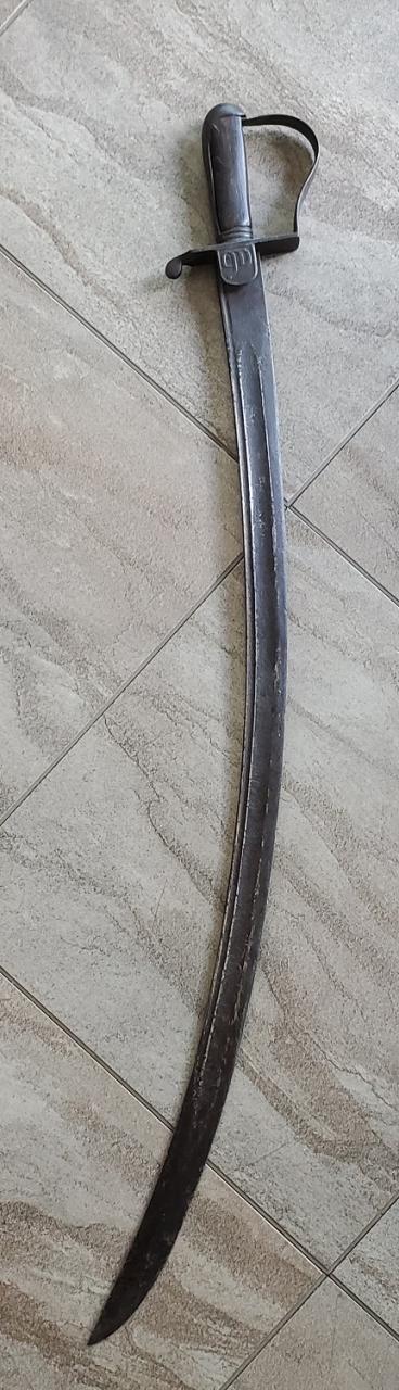

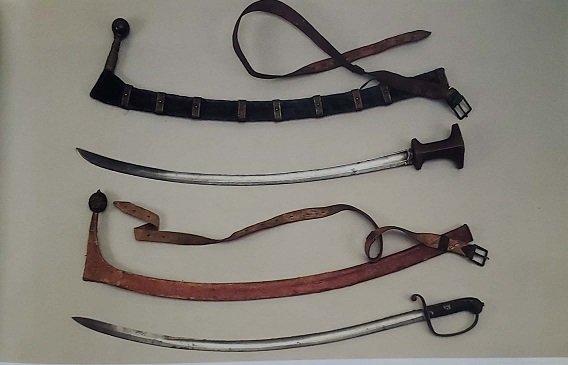

Actually, now that I've put the gurade and the 1796 (at least I assume it is one; there is a barely visible JJ Runkel signature on the spine) side by side they're clearly very different; the fuller on the gurade is much narrower, shallower and shorter, it doesn't flare quite as much, plus the gurade has something like an "Indian ricasso". And as noted, the distal taper is not as abrupt. Not sure why I never noticed all those other differences before.
Perhaps the gurade's blade is local manufacture?
I really need to get a better camera, but for now here are the pictures. I added in my Shotel and the 1796 for good measure.
I've noticed that both the gurade and shotel are set into the grip at a slight angle. Presumably this is to aid edge alignment?
And also, both of these swords and a modern made Afar gile that I have are impossible to get into their scabbards. I barely got them out when I first received them. Is this a common problem? The gurade's is very tough, I think it's hide. Not sure what that odd cutout is for at the top.
Finally, what is the hole right beneath the flare of the pommel for? Presumably it has something to do with the construction, but it's at the wrong side for it to be a rivet.

I recall seeing an old early 20c B&W film clip on a website dealing with African weaponry that showed two unarmoured Abyssinian warriors with shotels and large thick oval hide centre grip shields, mostly used to hook around each other's shields similar to the first video above - but the shields were much larger. It may have been recorded during their war with Italy. Sadly can't find it now.
Old 21st October 2022, 06:31 PM   #24
werecow
werecow's Avatar
Join Date: Sep 2021
Location: Leiden, NL
Posts: 688
Originally Posted by roanoa View Post

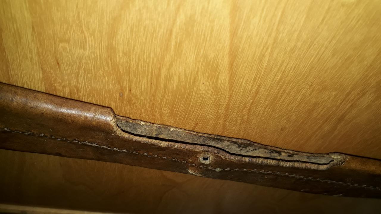

This particular shotel has a grip made of buffalo horn, hence the "circular hole" at the bottom (again, this has been part of previous discussions).
Ha, when searching for "the hole" I seem to have found an earlier discussion of the same gurade from before it was in my possession that I had previously overlooked. So I guess it's a naturally occurring phenomenon then. And actually the way it tapers and is not quite round and a bit tilted should've probably given it away. It gives me a glimpse of the tang.
The "cut" at the top of the scabbard (very nice conditions, by the way) is to allow the proper fitting of the curved blade. Scabbard with split top part are often found in indo-persian, arabian and even European swords with extreme curvature.
I think the thing that throws me about the cutout in the sheath wrt helping with the flared tip and curvature is that, unlike in the case of Indo Persian and Arabian swords, the cutout does not extend all the way to the top.
Perhaps it's just me being clumsy, but the tip can sometimes get hung up on the cutout bit when inserting the sword into the scabbard (or, well, trying to do so, and getting stuck halfway through because it's too tight. ).
Ethiopian scabbards are made of raw skin that shrink over time and become very tight for the blade. This problem can be "solved" by coating the blade with a lot of leather softener/conditioner. After many tries and applications it seems to work.
Thanks for the tip!

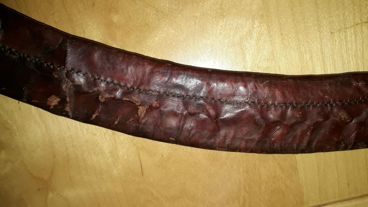

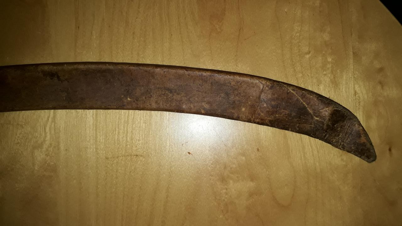

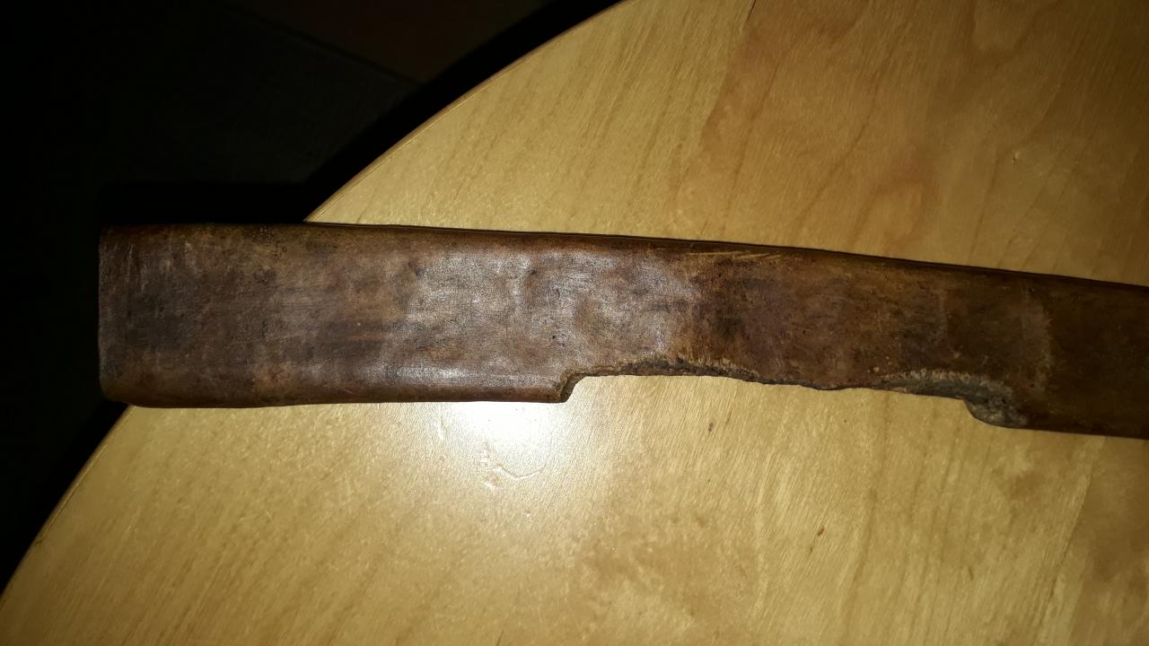

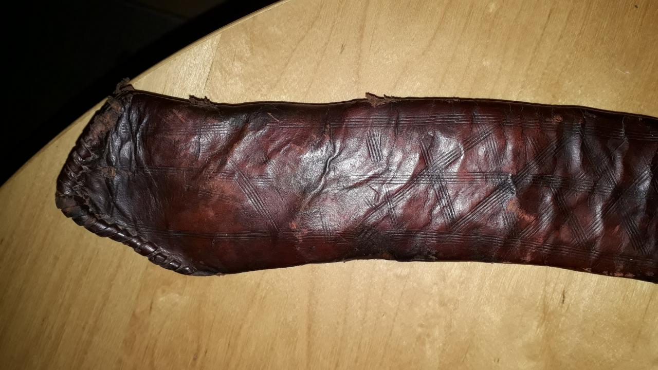

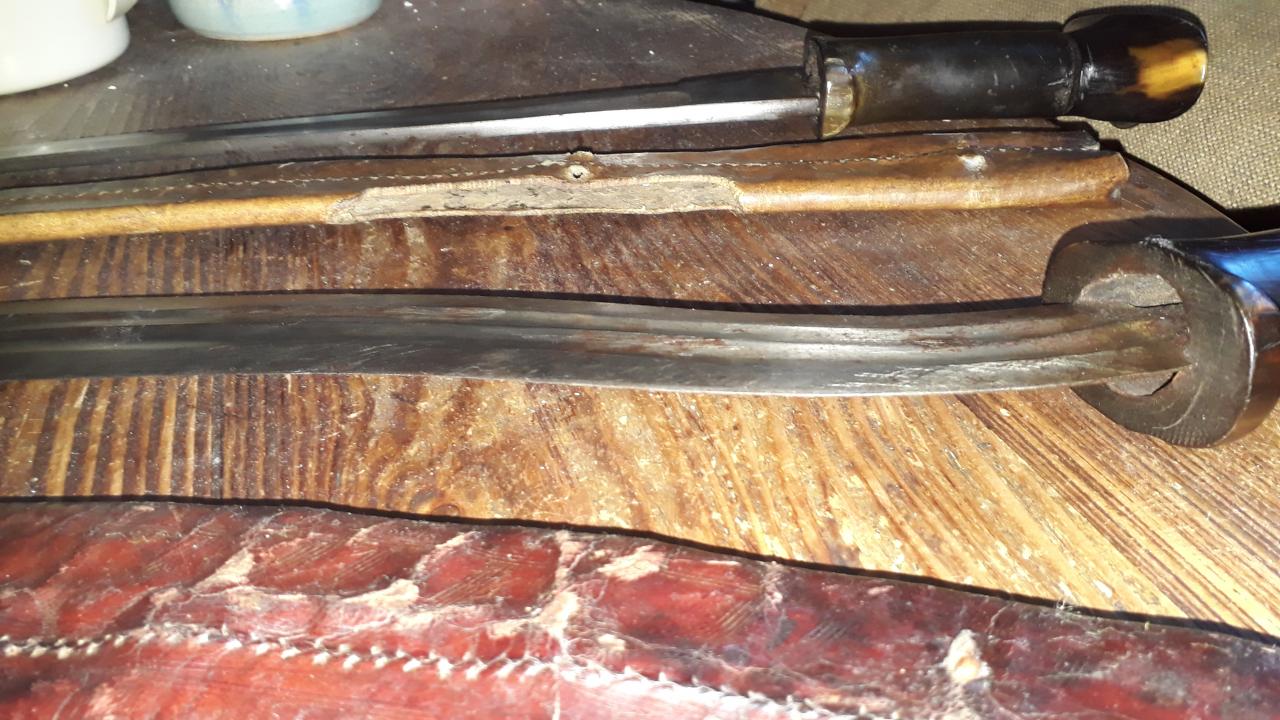

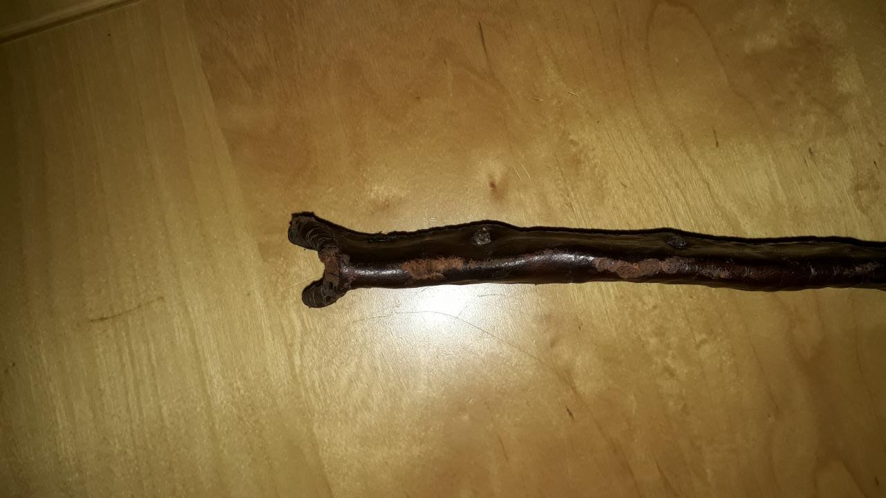

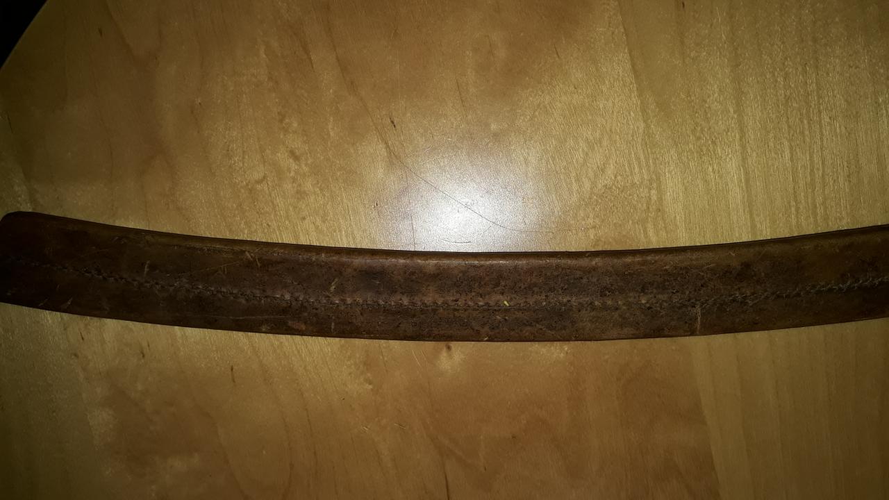

Yes indeed, I meant the scabbard for the gurade. There is actually no cutout in the one for the shotel (I expected there to be one before I actually got it), though it flares out a bit near the top.
I'll add some detailed pics of both scabbards in case anyone is interested. First the gurade's, which is pretty straightforward other than the odd cutout. Will add the shotel's in the next post.

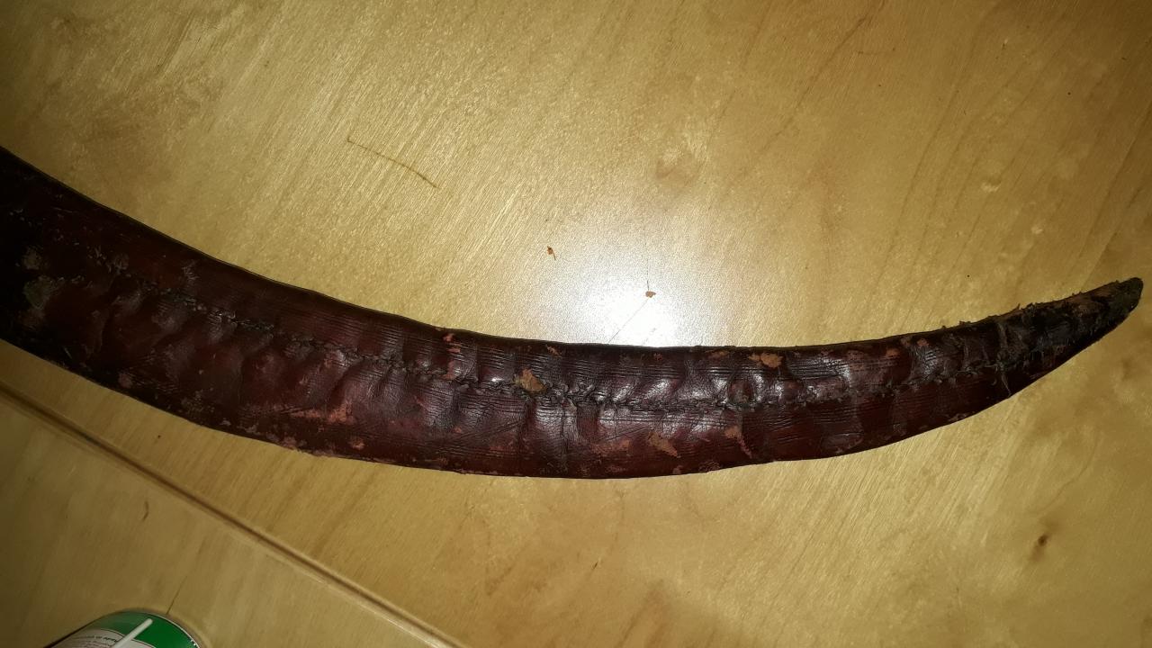

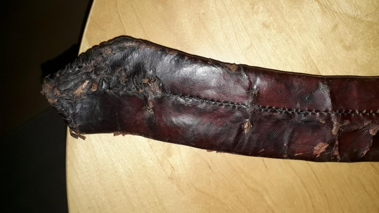

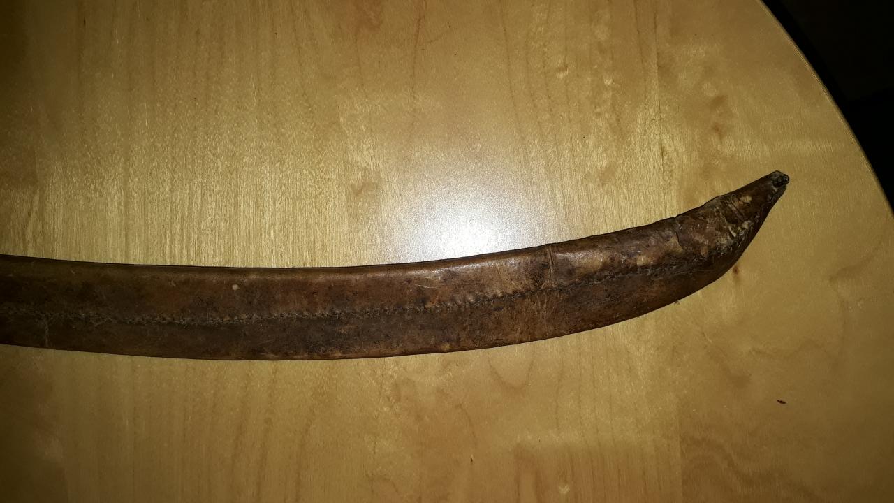

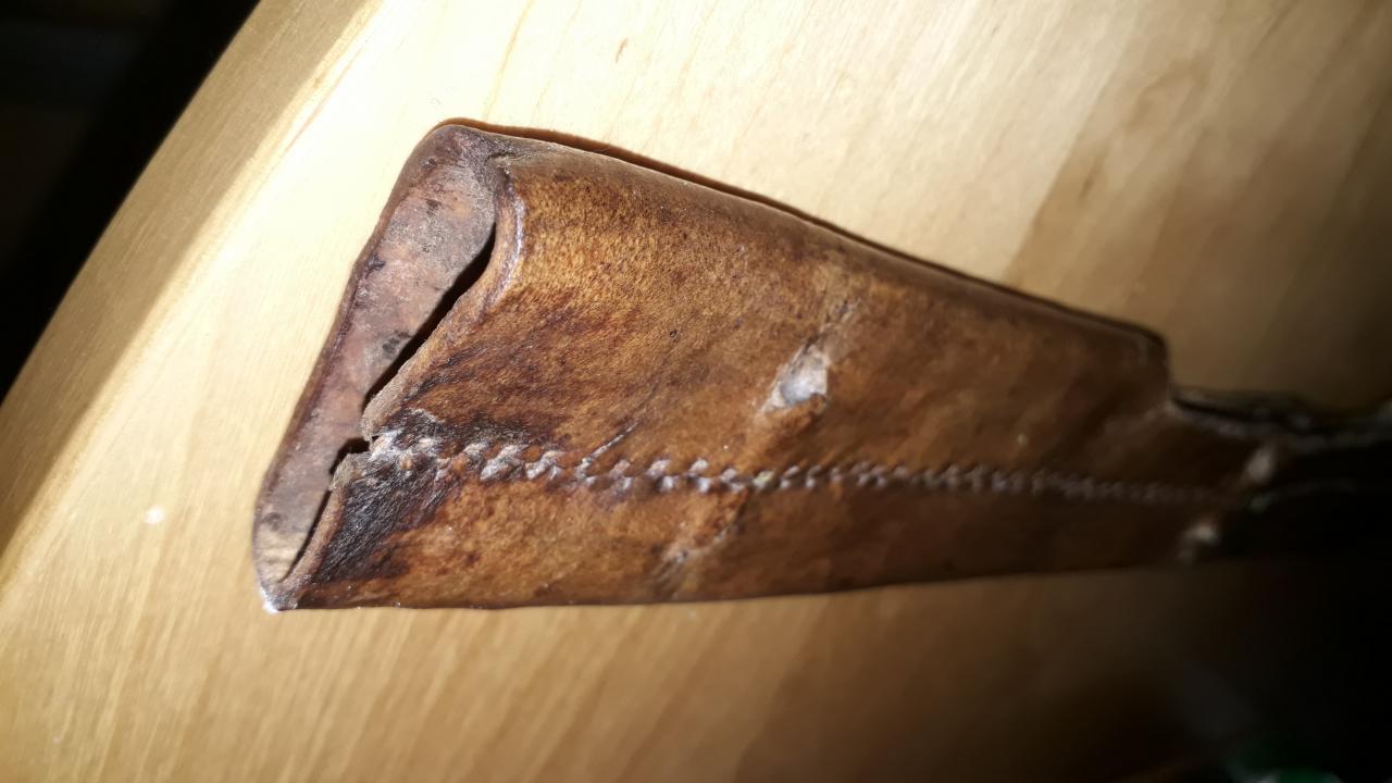

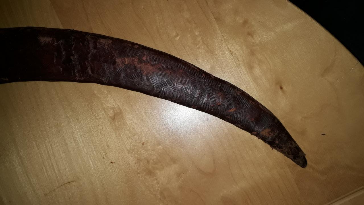

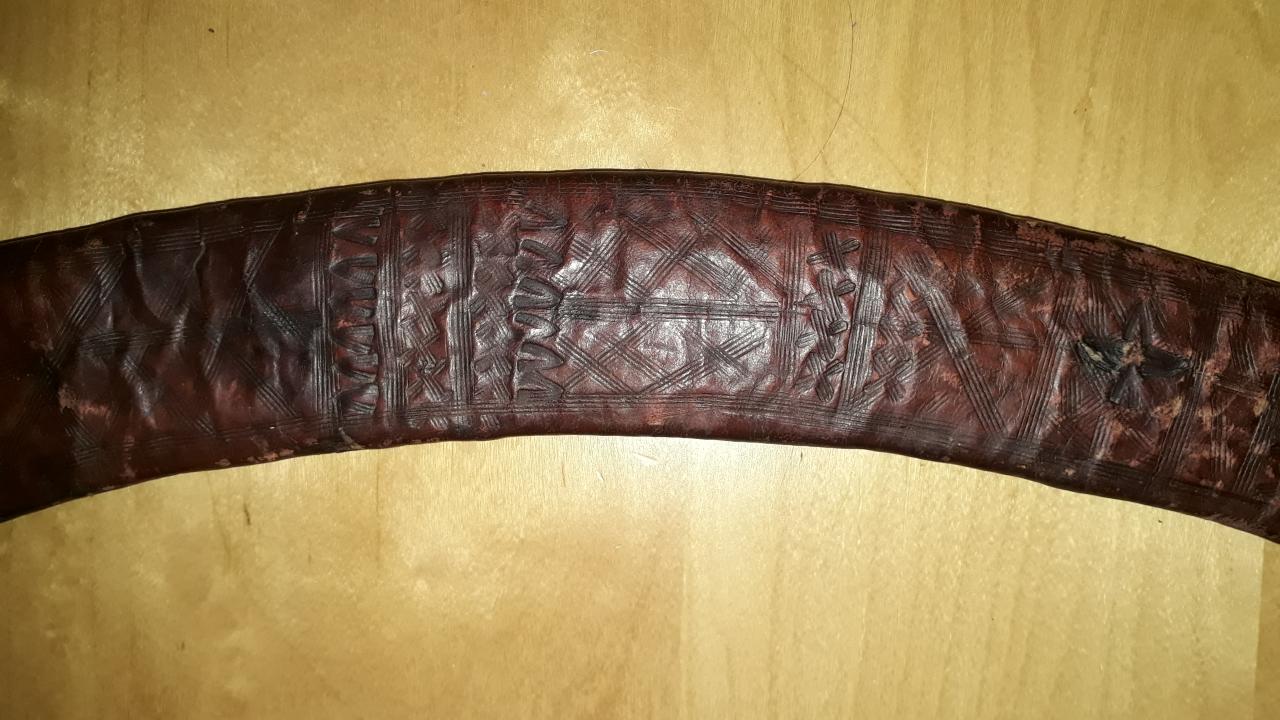

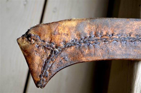

Shotel's scabbard. This one has some decorations.

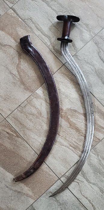

Oh, and as to how these handle: they are pretty front heavy (the grip is of course quite light) and they both feel to me with my limited experience a lot like draw cutting swords like tulwars and shamshirs, as if they want to be pulled around or along the body from the shoulder and elbow in a long slicing motion, if that makes sense. My guess is you wouldn't really do a western saber style moulinet with it (at least not with the shotel). The pommel reinforces that impression. But I could be wrong of course, as I don't know much about HAMA. The point on the shotel is a little terrifying to me when I carefully swing it around (which ever way I hold it). I've tried to indicate the approximate point of balance in this picture (red lines). In both cases it's about a third of the way up the blade. And with the shotel the point of gravity is significantly in front of the hand (making it feel more like a forward curved blade like a yataghan), whereas with the gurade it is of course slightly behind the hand like a saber.

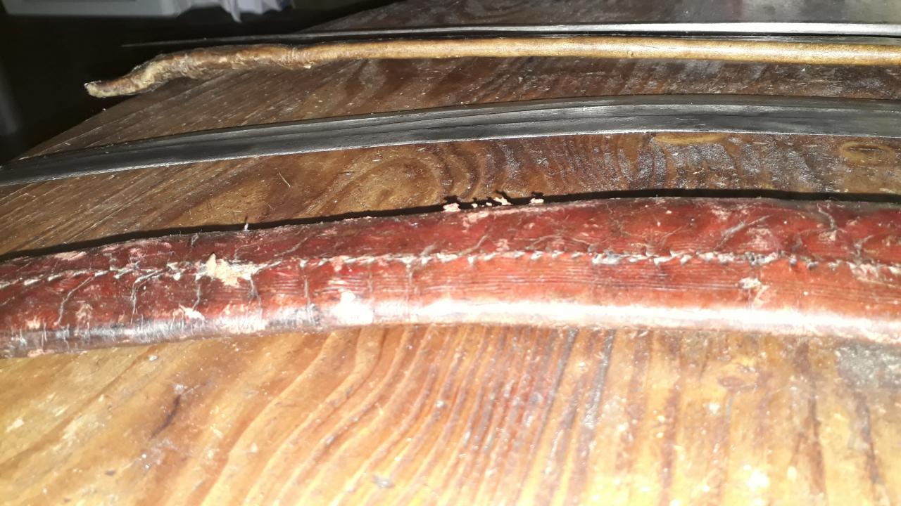

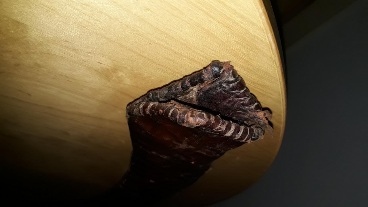

Hi, The hole on the sheath of Gorade was dug by mice. You can clearly see the tooth marks. It's common in Ethiopia.
The rawhide sheath can be shaped and stretched by maceration in pure ethanol. The advantage is that it doesn't shrink to its original size, as when soaked in water.
Old 21st October 2022, 09:45 PM   #30
Martin Lubojacky
Join Date: May 2008
Location: Czech Republic
Posts: 862
One more thing about the ethanol maceration: I wouldn't do that with a shotel sheath. This sheath probably consists of two layers. The rawhide scabbard is covered with a fine leather with an embossed pattern, and that could get ruined.
