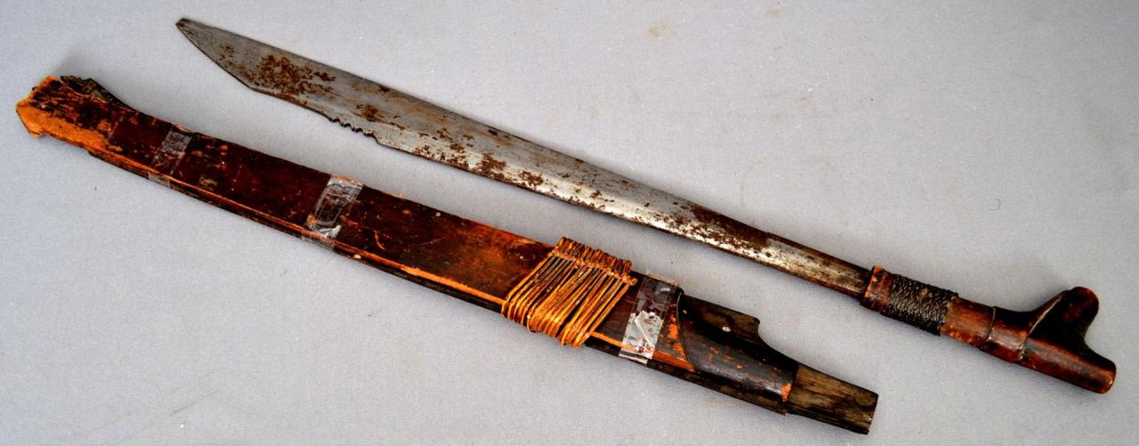

I came across this mandau with some faults, the tip of the blade is broken and the scabbard back piece is incomplete.
But the front piece of the scabbard is unbroken and shows in up a very nice and deep carving and the blade is very hefty.
I want to share it here specially for the very nice carving on the scabbard's front piece and maybe someone will be able to tell me from which Dayak group this piece is coming. All comments are very welcome.
The sword is 61 cm long, blade is still 47,5 cm long and 9,3 mm thick behind the handle.

Hello Detlef,
That is an unusual carving indeed.
I have no idea.
The bottom part of the scabbard with the upward angle looks like what we see in the kutai region. Often this is combined with a rottan strip on the scabbard.
Nice piece

Very nice carving, and interesting hilt. I was wondering as well if a bamboo edge protector was missing.

And yes Charles, one side seems to have once a reinforcing of some sort.
The scabbard is in bad condition, only the front from ebony (?), a very hard wood is nearly undamaged. Only the now too wide upper rotan binding holds the parts together. But you can see where the from Willem mentioned further fine rotan bindings once where situated. The remaining binding at the handle is very brittle.
The blade is well used, several edge nicks are visible, the overall patination shows great use and age.
Attached are some improved pictures.

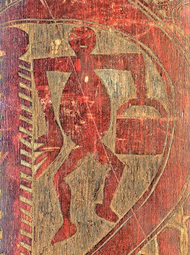

Posts: 9,677
Has someone seen these "arm" carvings before somewhere?
No, I have never seen anything like it.
It makes me think of celtic decorations. An interesting cross cultural link
If you compare the blade with the carved inside of the scabbard, is it a perfect fit ? Sometimes the exact outlines of the blade are followed on the inside of the scabbard.
How stupid I am sometimes! I don't compared it until now and it's not a match, so I think that the scabbard don't belong to the blade.

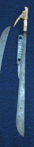

Detlef, I bet that bamboo reinforcement at the edge can be restored. I am sure Arjan would know.
Old 15th April 2022, 01:02 PM   #13
Posts: 9,677
Hello Charles,
First is the backside of the scabbard in very bad shape and since blade and scabbard don't belong together I am unsure what I will do with the parts!?
Make a nice display for the front panel? Would mean to destroy the rotan binding.
To restore the scabbard is a challenge in my eyes, and no fitting blade? I am more as unsure.

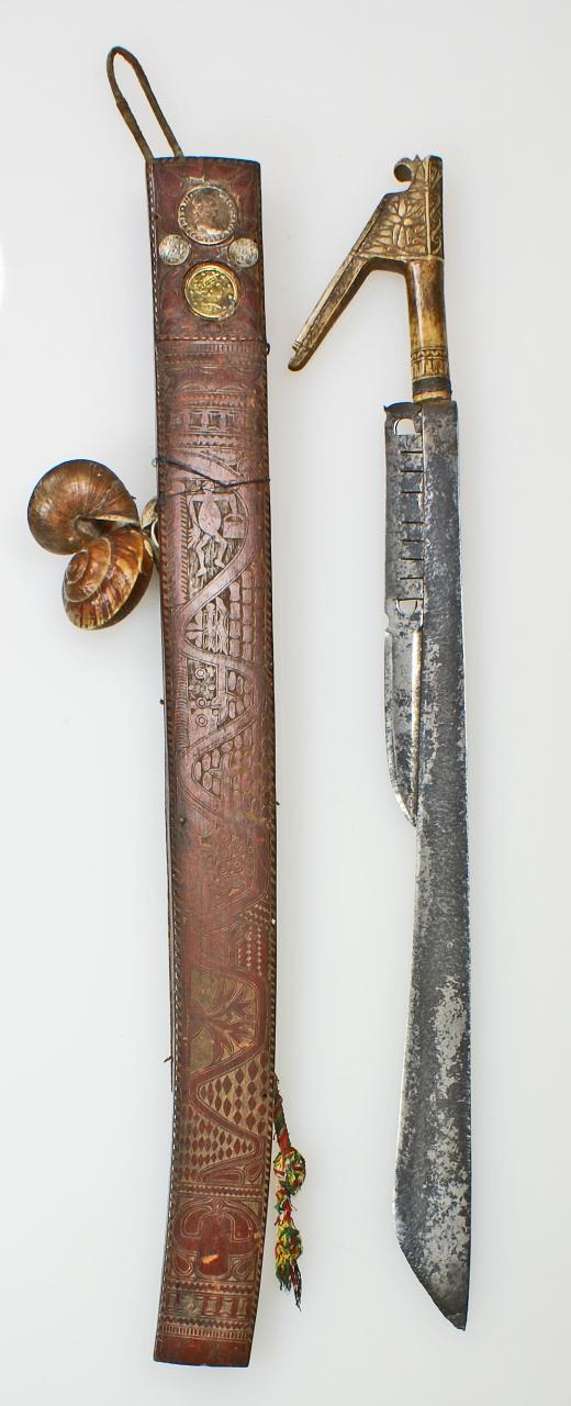

On the scabbard of a penopah andai a human figure is depicted with a similar arm and hand with four fingers.

What you call penopah andai, is it a sword like in the picture? I ask since our member Amuk, from whom I borrowed the picture, calls it in this thread: http://www.vikingsword.com/vb/showth...ghlight=borneo as isaw.
When you look close you will see that the thumb rests in the palm by the carving from the piece in question.

Hello Albert,
A photo of the complete sword.
Featured in: 'Traditionele Wapens van Borneo. De uitrusting van de koppensnellers. Deel III, Zwaarden en messen.'
['Traditional weapons of Borneo. The attire of the head-hunters. Volume III, Swords and knives.']

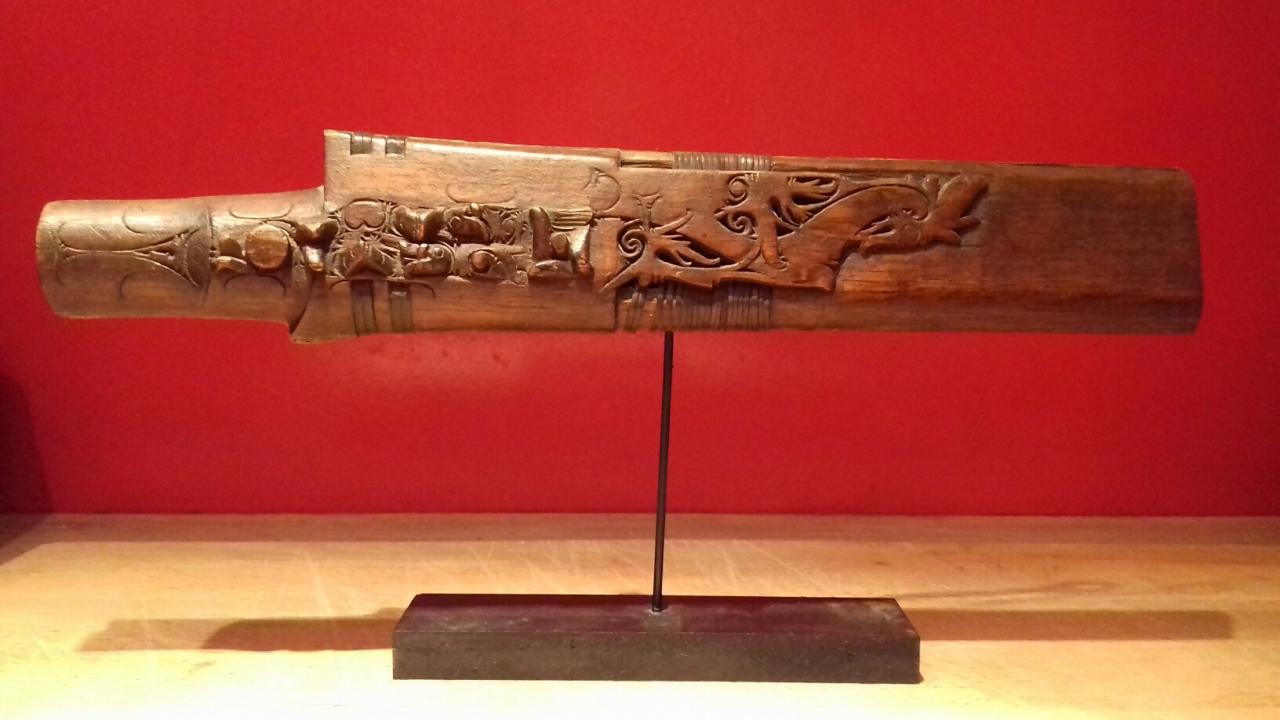

I once bought a relatively small scabbard with heavily damaged lower section and no blade. It ended up like this.
