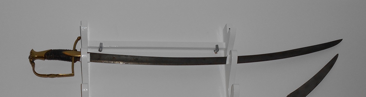

Bit of an odd question, but does anyone have a tested profile shape I can use for a custom sword rack? Many of the ones I see online are for Japanese swords and I'm concerned they would not accommodate differing shapes/widths per a broad ethnographic collection. The top photo is what I've been using, it is actually a silk spool holder used for Khmer ikat weaving. I find it works well for narrower blades but wide blades like a Kachin tool dao won't sit right, in fact the Lepcha ban in the photo just barely seats without tipping forward. I've also attached a random internet grab of a sword rack as reference. I can certainly come up with a profile by eyeball but I'm curious if someone here may have played around with different designs and have a profile they recommend.

... I've also attached a random internet grab of a sword rack as reference...

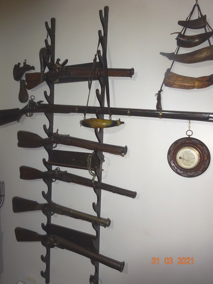

Amazing; i bought a used stand from a shop of fake weapons, which had been emptied, just like the one you show but with the rack in both sides. I split it in two halves, nailed to wall one on top of the other and got myself a good rack for my antique firearms. The round wooden hooks are more fit for guns, i must say; swords may turn down and not sit in the right position.

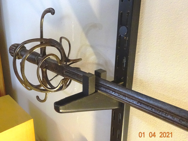

I made my own. More photo's later, but this is the weapon stand in the corner of my living room.

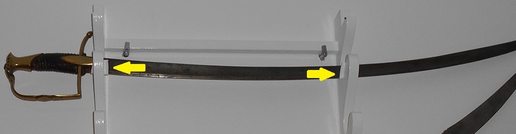

I have this problem even with standard sword stands (as I display most of my swords unsheathed, with the scabbards underneath) but I use some pieces of black isoprene to prop the swords within the hooks/cutouts of the stands.

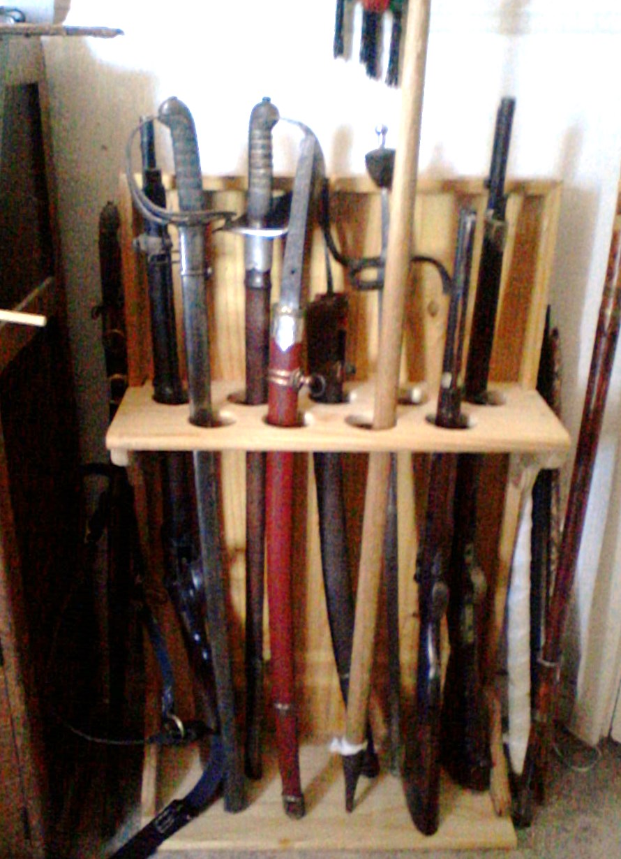

My rack for the swords ... and a solution to keep them right.

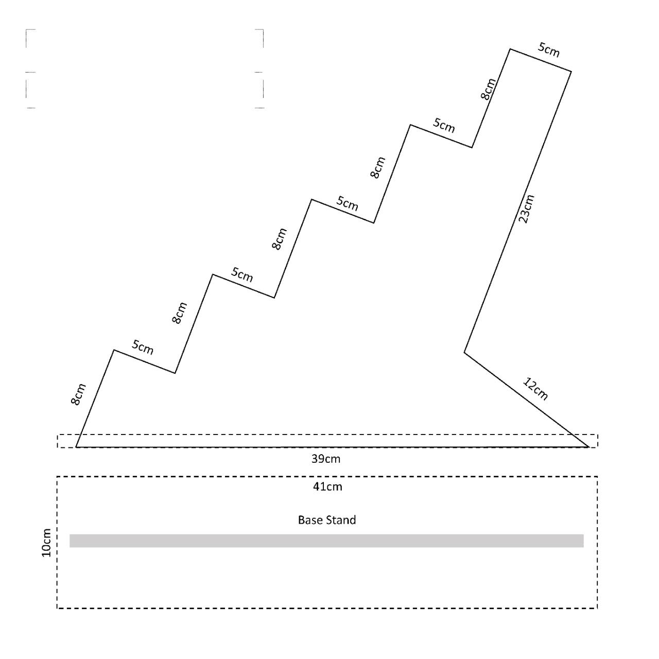

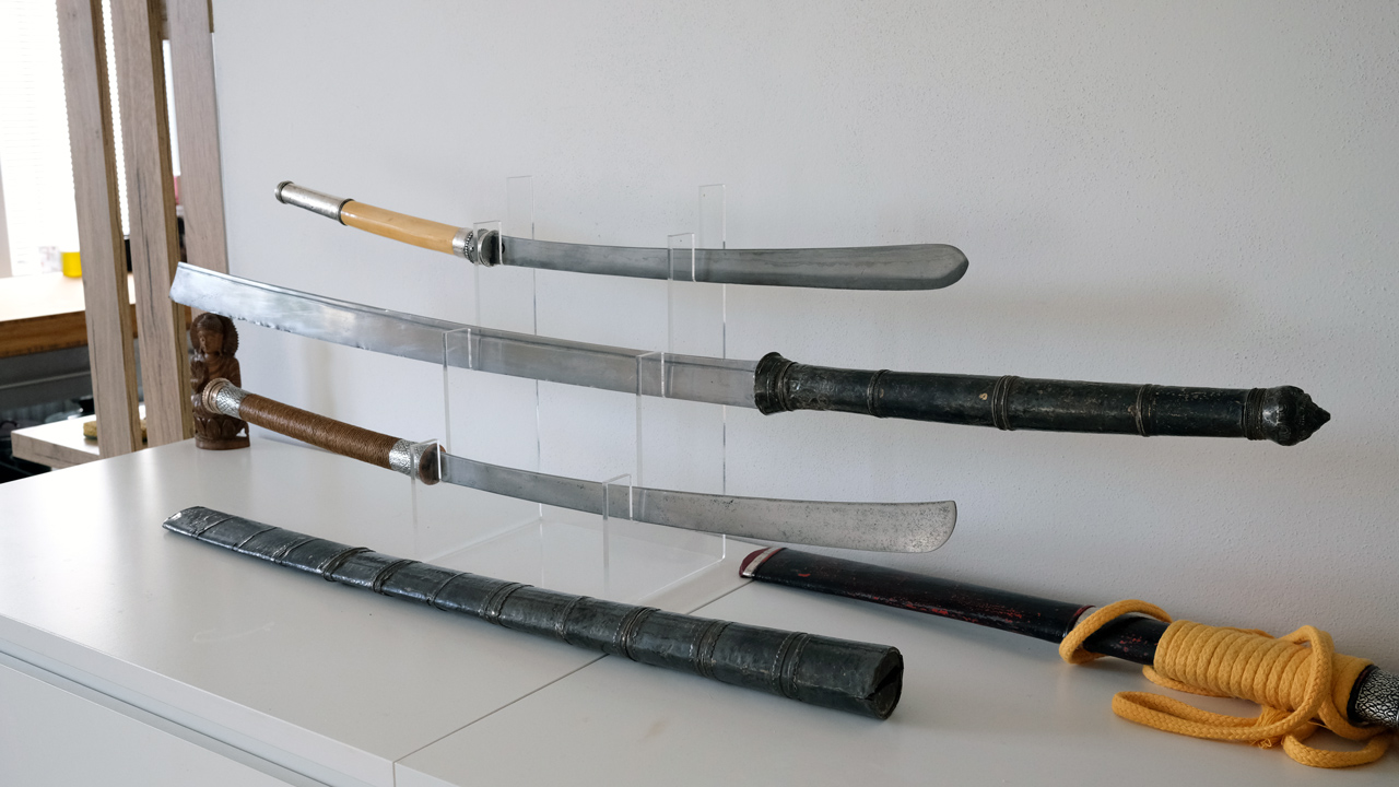

I'm a fan of clear plastic, I had these custom made a while ago. relatively narrow slots.

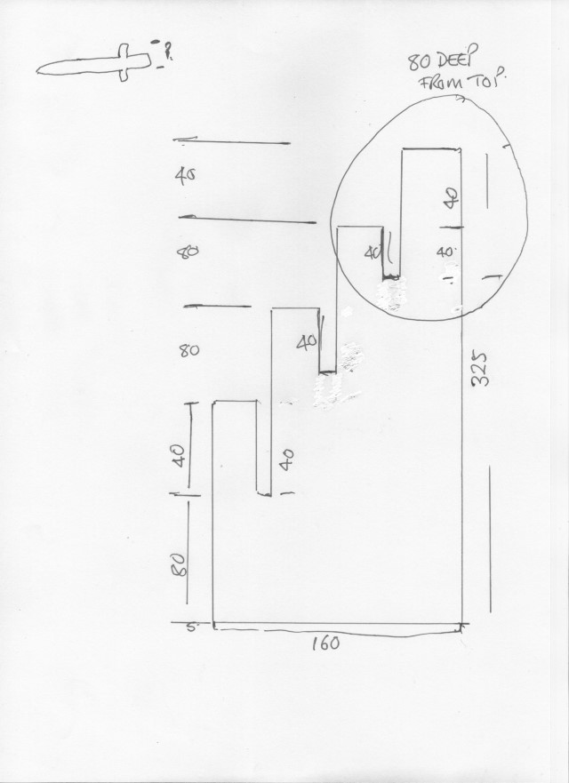

I agree storing in scabbards long term is not ideal. I am including a sketch with the dimensions in mm of my racks. Any shop that works with acrylic would manage it easily I think.

Good stuff, and thank you Iain for sharing the schematic.

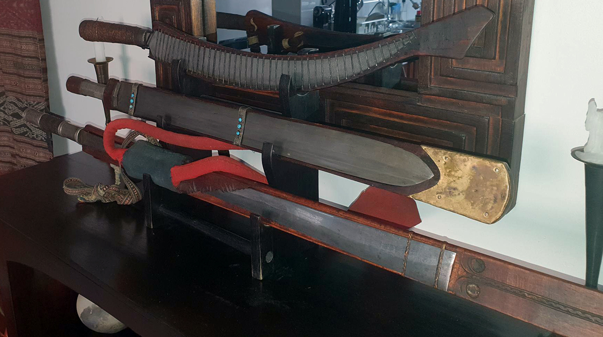

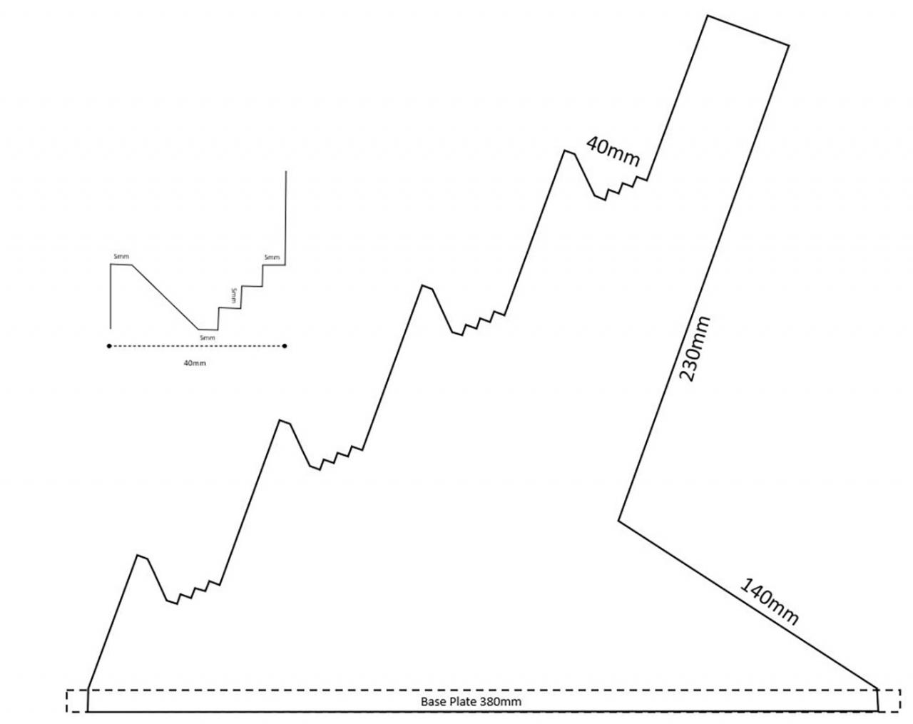

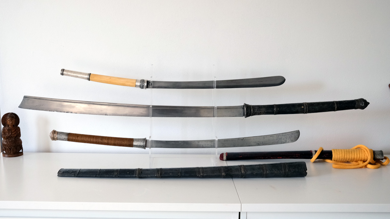

Inspired by Iain I had some racks custom made from acrylic. The first one (bottom shelf in photo) uses simple sloped levels to hold the sword/sheath. I found that blades with a strong change in width (e.g. klewang) would sit at sloped angles. The second design (top shelf) allows more adjustment using small steps so the blade can be leveled somewhat by using different steps for the different widths. This also allows you to adjust the vertical angle to better match field of view. I've included the diagrams of first and second designs. I need two more sets for my display cabinet so will play with the design a bit more.

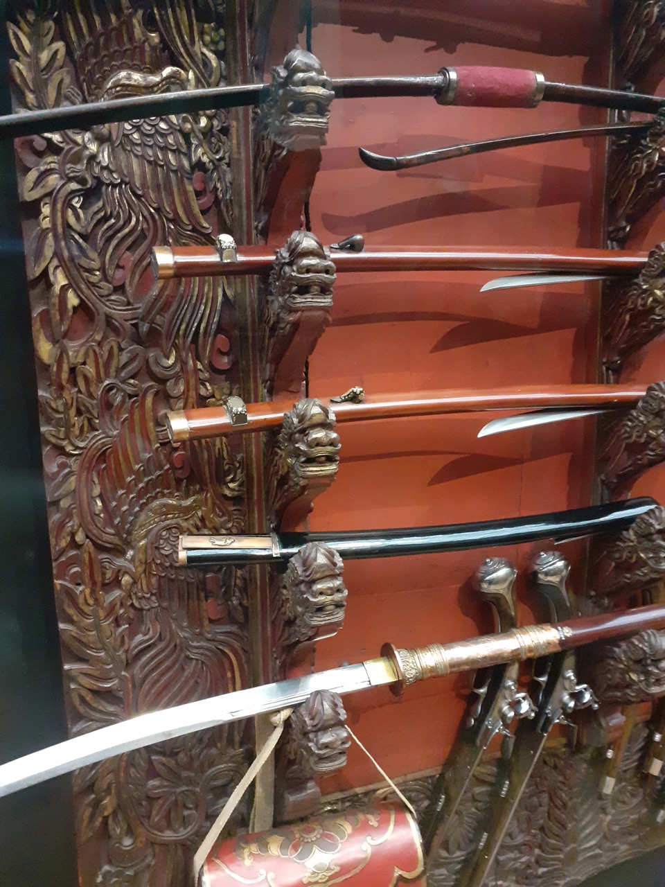

Here the wonderful weapon rack of Cornelis Tromp ,
an Admiral of the VOC
Pictures taken visitng the Rijks Museum in Amsterdam.
I would take all back home
( bit I hadn't place enough in my luggage )
