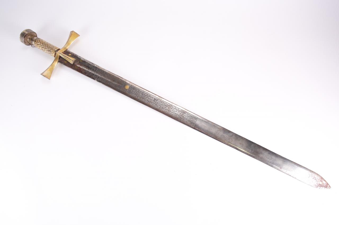

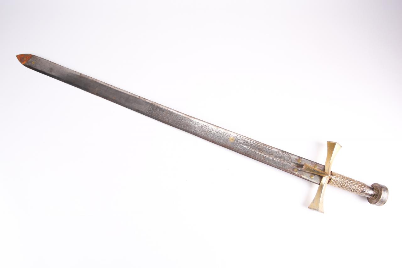

This recently sold at auction in the UK for £8,200.00. With premium that's nearly £10,500.00.
Old 30th October 2021, 06:44 PM   #2
My run-of-the-mill one cost considerably less - well under $100 with scabbard. Unless this belonged to the Mahdi, I think somebody with more money than sense got carried away during the bidding. Maybe the etchings will reveal a worthy provenance that justifies the cost!
Old 1st November 2021, 08:09 PM   #3
TVV
TVV's Avatar
Location: Bay Area
Posts: 1,769
To be fair, this is a very nice kaskara, with a silver gilt pommel and a very high quality crossguard that also looks like it has been gilded. The blade looks like a 19th century European import and the brass (?) dot inserts are unusual. It is definitely a sword that belonged to someone of high status and could have been one of the many swords Ali Dinar owned.
To get to a high price at auction you need to have at least 2 people bidding on a sword, so more than 1 person must have put a lot of value on this particular kaskara.

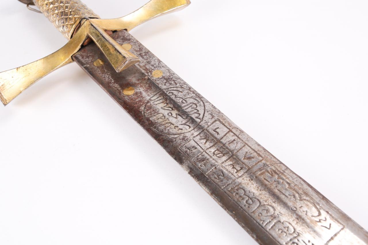

Default Darfur kaskara at auction
I liked the look of this kaskara except for the goldish/brass dots which I thought looked crude and unappealing to the point that I wondered if they were a later edition to ''flash'' up the blade or to differentiate it from the many similar.

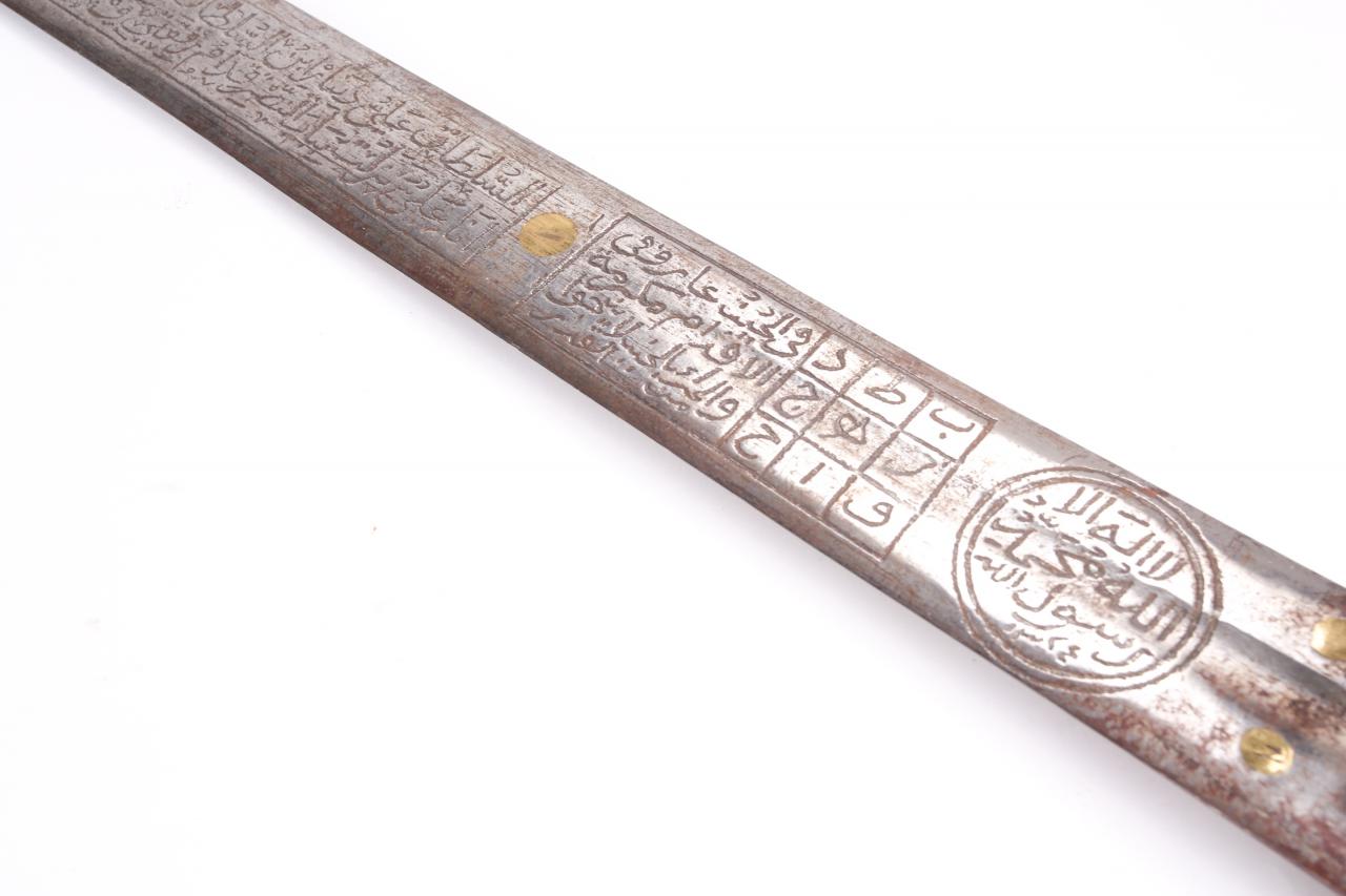

According to the auctioneer the dots are a 'gold alloy'.
Richard
Old 6th November 2021, 06:52 PM   #10
Posts: 10,862
regarding the posts about only needing 2 bidders(I also collect ancient coins) a Naxos tetradrachm recently achieved approximately $740,000NZD at auction(I only kept a note after converting to NZ dollars),the coin is rare but the sale price is insane
regards
Andrew Freeston
Gold or gold metal filled dots have certain significance on Islamic blades as described in Yucel ("Islamic Swords and Swordsmiths", 2001). These appeared in varied groupings and numbers, however seem to have usually been situated toward to blade tip. I have seen certain cases where some kaskara, otherwise quite plain, have had such 'dots' near the blade tip, but were most likely brass filled.
In Islamic symbolism and allegory it seems numbers are key, so it is hard to say what specifically these dots might mean, but they are likely placed there to augment the inscriptions and invocations on the blade.
The five dots can mean the Five Pillars of Islam.
The second interpretation of the five points is the family of Muhammad: Muhammad himself, his daughter Fatimah, his son-in-law Ali, his grandchildren Hasan and Husayn.
In favor of the second version, I think it will be that a separately located point is larger than the others (Probably a langet prevented it from being placed in the center of a square of four points).
Perhaps translating text between dots can help (excluding the "magic square").
On one of the photos there appear to be two more dots towards the tip of the blade, so it might be 7 instead of 5 dots altogether. A reference to the seven sleepers? We probably will not know for sure, but it is fun to speculate.
Teodor
Thank you, Teodor. I didn't see these two dots before.
Without these dots, I had another beautiful interpretation of the five dots:
the hand of the owner of the sword is led by Muhammad himself, followed by his family and only then by the humble owner of the sword, modestly fulfilling the will of the Prophet.
But now I'm at a loss. Who are the two at the tip of the blade?

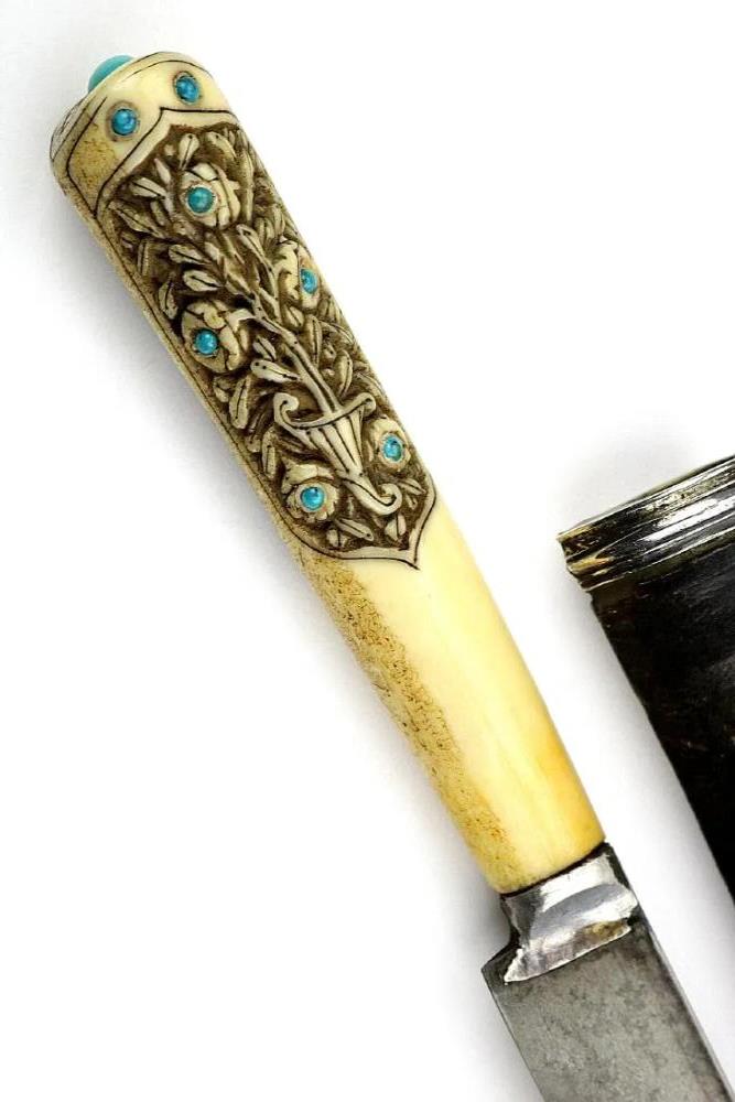

Teodor
In the Islamic tradition, there would be eight names. Kitmir, their dog, was also with the youths.
I also think that in this case the dots would be located in one block.
But look at the photo below. Recently, Marius showed his Ottoman kard.
On its handle is a Tree of Immortality with the same arrangement of five dots. And two separately outside the composition.
I think they should also be considered separately on the sword blade.
Most likely, this is a metaphor of spiritual ascent through the observance of religious precepts, or Sufi practices.
Something similar in meaning to the drawing "the Prophet's ladder" (Kirk Narduban) on the blades.
In the Ottoman tradition, the image of a tree may probably have another meaning (the famous dream of Osman I about a tree growing out of him),
but in this case I think the same "message" is on the kard and the kaskara.
