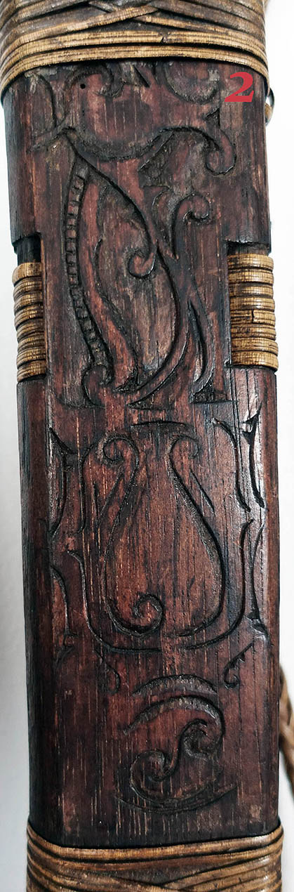

And Nr-2 is a Mandau of the Kayan also late 19th,c.
This blade exhibits considerably more wear and might have been collected later; I'd also guess the scabbard is a later replacement during the 20th c. as it often happens with blades in active service.

Photo-2 is either just decoration or a stylized image of something. But of what.
Certainly not "just" decor - pretty much anything has a connotation...
Some motifs (aso, leeches) tend to be quite obvious while others can be much more challenging to discern. Especially the floral elements can sometimes hide larger motifs - these are often only visible with extensive experience, i.e. training of the eye.
That's why I joined this club, in the hope that experts can tell me a bit more about it
When looking into these details, I'd strongly suggest to look a lot into all kind of "Dayak" carvings, inked decor on tolor, tattoos, etc. Some motifs seem to be very widespread while others may be much more restricted in space and/or time. Considering the wide geographic scope, vast ethnic diversity, and extensive cultural evolution over time, such an extremely valuable project would be a really huge task! What have you been able to glean from the long-time collectors so far?
