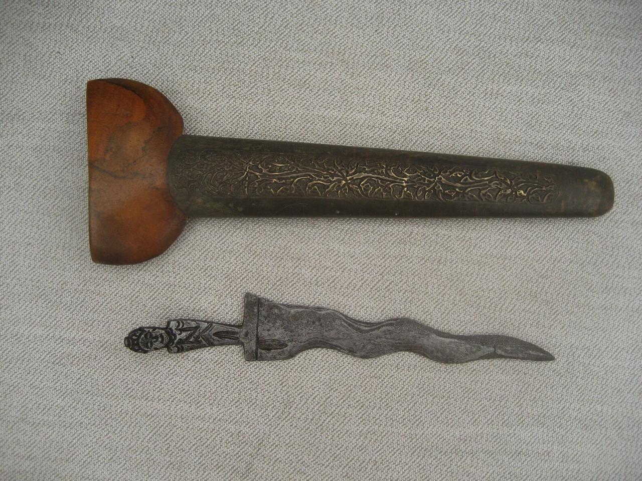

I am awaiting delivery. Can send more details pics once they arrive.
Most are reportedly from 1960s-1980s, the unhilted ones might be older.
Please give thoughts? Are they all recent madura mass produced replicas or truly well crafted? I didn't pay much per keris.

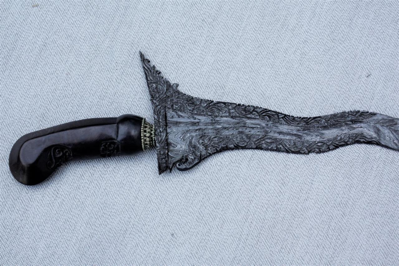

You only posted two of them and the details of the photos are not that clear, but my initial feeling about both of these is that they are indeed modern era (kamardikan) keris.
The keris sajen is always a difficult one to judge age on as the form has not changed much over the centuries and the form is always somewhat rough so it is harder to use details and quality of forging as a guide. However, the depiction of the figure on the hilt is not just simplistic and would be expected, but a bit cartoonish.
I can't tell too much about the age of the other keris from these photos, but suspect it is a newer blade. It doesn't seem to be too badly executed, though the quality of the carving is difficult to see. And it does have a more complex and desirable pamor pattern. Usually a keris will be carved like this preparing it to receive kinatah (gold decoration), but i don't see any evidence any was ever applied. The Yogyakarta gayaman dress does seems to be older though and of a decent quality and it appears to be an older mendak. You will have to check the inside of the opening in the sheath to see if the dark wood shown on the outside of the sheath extends all the way through the to the inside. Often they will fake pelet wood by painting or dying the outside, but if it extends through it is real pelet and that is a desirable trait. The reprousse work on the pendok also looks fairly good.

The sajen is recent, but more likely to be Javanese than Sumenep.
The Jogja keris blade is recent, but it appears to be a pretty decent keris, definitely Sumenep, Madura. The dress is older. This combination of older dress with young blade is just as common as older blade with younger dress.
I have a feeling that at least the Jogja keris might have come from me.
The pelet markings of Timoho do not always penetrate the wood, in fact when a Timoho atasan is re-finished the m'ranggi needs to be careful not to polish out the dark patches. But with a kendit it is often the case that the dark belt will penetrate.

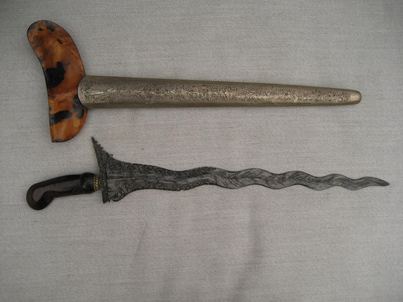

Default more
keris

That additional keris you posted a pic of is recent Sumenep too, all recent, recent dress, recent blade. I probably supplied this one too. I think I know the collection these keris came from. The gentleman who had it passed away some years ago. It was a pretty big collection, I did not supply most of the Philippine items, in fact I might not have supplied any, but I most probably did supply all, or at the very least, most of the keris.
