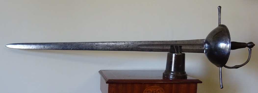

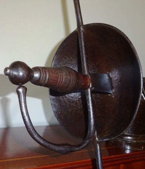

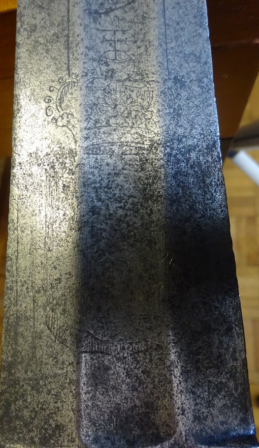

Why have i acquired this one, despite current austerity days ?

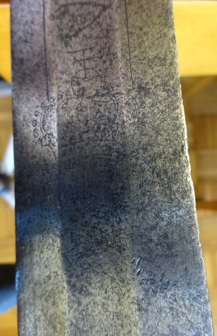

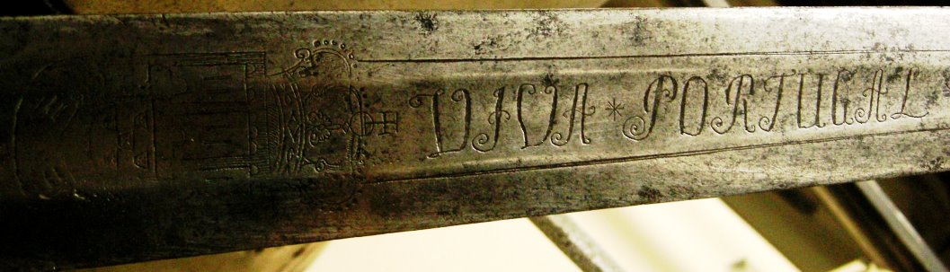

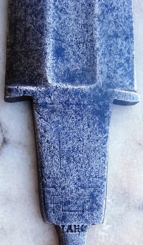

Besides the patriotic inscription on the blade VIVA PORTUGAL, a Royal crest which, despite its faded condition, would implicitly be that of a Portuguese monarch.

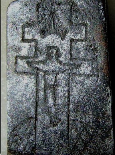

The also (faded) patriarcal cross in the tang would have once shown a crucified Jesus, a symbol used by a few smiths, probably inspired by Toledan master Pedro Hernandez.

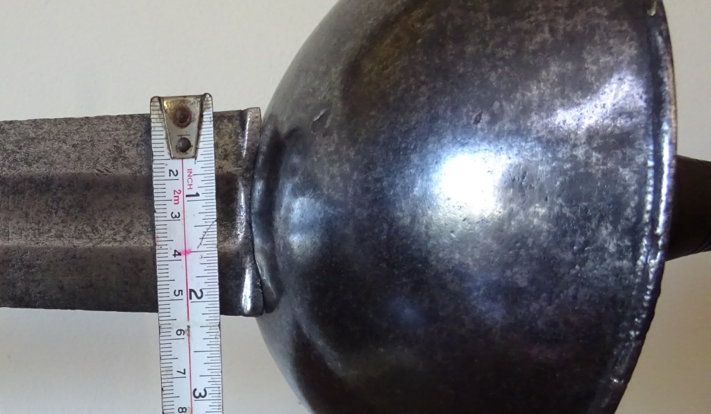

And last but not least, this blade width, which is really impressive; one that i have never seen and certainly neither many of you guys, i guess; over 5 cms. (2 inches).

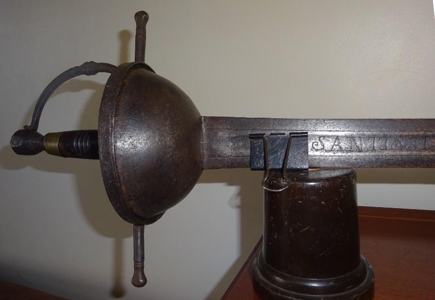

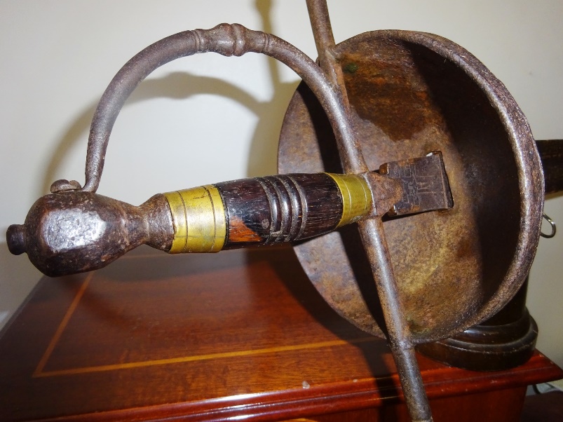

The guard is easily dismountable; the pommel turns off rather smootly.
The grip; turned horn.

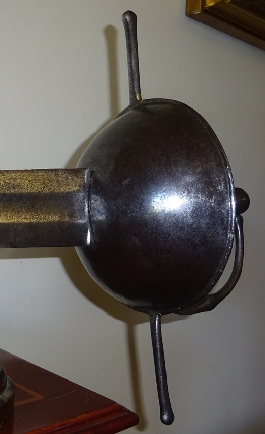

Cup bowl diameter: 15 cms. (also impressive).

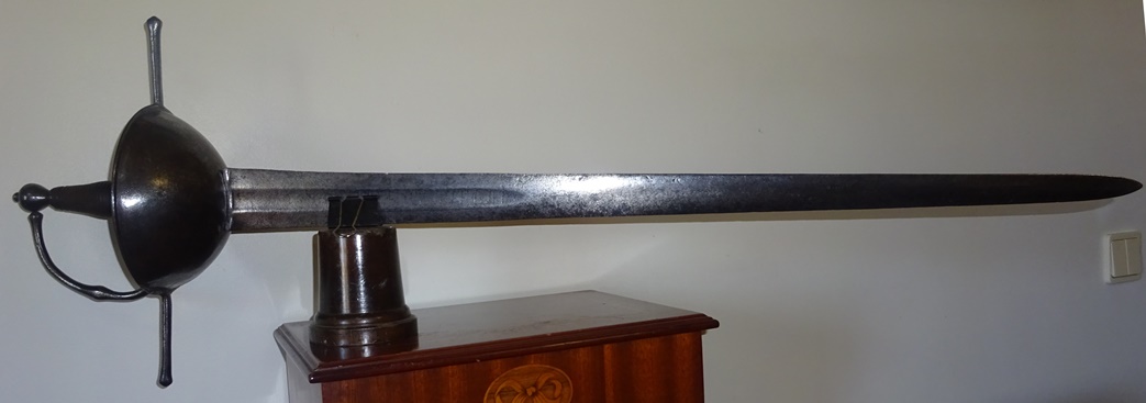

Quillons span: 31 cms.
Blade length: 76 cms. (infantry).
Total length: 95 cms.
Weigth: 1187 grams.
Comments will be welcome.

Congratulations Fernando !
it is not just another cup hilt of this genre , it is exceptionally huge and there are the fine engravings , yes I would have bought it to if I had the chance.

A fine sword, an absolute beast. Great inscriptions and marks, which are always half the pleasure in researching and understanding the sword.

Fernando, you KNOW my weakness!!! cup hilts!
And with Dirk, I agree, this is a wonderful and most unusual example.
In the 18th century, Spain stubbornly held to its cup hilt traditions and Portugal of course also maintained their affinity for these fascinating hilts. Without more detailed research, I would think this is likely a colonial 'arming' version of the continued colonial versions of cup hilts from probably Brazilian context.
I have seen these heavy blades on various Spanish colonial swords of the 18th century it seems, and they are of course infantry officers weapons as I have understood. I am not sure of the Portuguese involvement in the Seven Years War in the Americas but it certainly seems possible this may have some connection there.
Thank you for the great pics, detailed description, and sharing a MOST unusual example of the cup hilt spectrum!

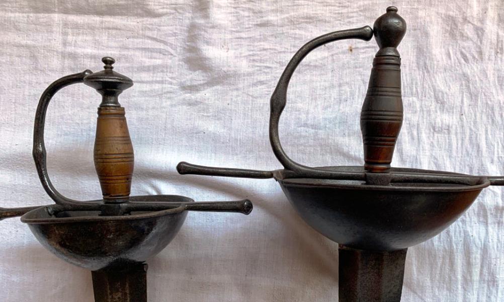

Indeed this is an unusual example in all its details. But soon as i posted it here, some acquaintance i have, dedicated to these matters, reminded me of a similar, almost equal, example in exhibition in the Portuguese army museum of Lisbon. In fact all details match, since the key clue VIVA PORTUGAL on the blade, a motto profusely used whilst the restoration of independence from the Spanish Filipes took place (1640-1668). The crown is no doubt that of Dom Joćo IV, who was then acclaimed King of Portugal.
Amazing that the length and profile of both swords is practically the same.
Even more exciting Fernando! and certainly this sword would easily place to that period as well. I am glad you were able to add this most vital data which more securely places the period, such as the royal crown which is key evidence.
The heavy and shorter than usual character of the blade was of course well suited for foot forces where the melee and close quarters would find such a sword favorable.
Uh, Mark, it is tempting to even consider maritime possibilities!!
I am not sure that swords of this heft would be confined to a certain unit, however, it is interesting that 'dragoons' were essentially mounted infantry, and dismounted for combat in those times. So perhaps a dragoon unit?
Magnificent and unusual sword!!!!

Hello Fernando and thank you for posting this fascinating sword.
In my novice oppinion the blade is much older than the hilt. I believe the blade may be 16th century while the hilt is early 18th century (or late 17th century at best).
So what do you think about that?
PS: The fact the hilt is easily dismountable points to the fact it is a later addition.

It often puzzled me how they could use rapiers (typically of course with long slender blades) aboard these vessels (no matter how easy Flynn and Fairbanks made it look).
These stout blades placed with the cup hilt (or bilbo guards) were essentially 'arming' swords made for these kinds of close in combat in my opinion.
I always wonder just how much actual combat there was aboard ships. Following of course the many cases of artwork and literature which lent well to movie material, it would seem extremely difficult for pitched battle of degree in such confined space. Obviously there were some occasions, but the 'Marine' concept of these forces aboard was that they were transporting to places of battle......much as 'dragoons' rode to battle then dismounted (until later becoming 'heavy cavalry' and fighting mounted).
PS....I agree with Marius, this does seem an earlier blade than the hilt.

Mark, i wouldn't hesitate to assume that these swords have gone to sea. You chose a reason; to equip the forces that complemented the ships personel (one part crew one part soldiers), other forces that were going aboard to replace those ending their commission in distant territories. There are also cargo manifests listing bundles of swords bein shipped. Surely and judging by the period, a great numbers of all such swords were cup hilted. By the way, in my modesty, i am a denialist of "bilbo" swords as a typology; but that is another story.
Marius (and Jim), i would not know how you conclude that the sword in discussion has a blade earlier than the cup bowl hilt; it takes some expertize i don't reach. But i can tell you that the other sword from where i have chosen mine, has the same type of blade (only 2" longer) and the same type of hilt; only that the engravings are even more faded than those in mine. Also the "far from modern" dismounting thread system is the same, only the other with a more unusual pommel.
Concerning the army unit, if we add to these two the example in the militar museum with similar characteristics we can infer that all three swords would have belonged to the same branch, probably a Royal detachment ?. I would not call them Dragons; don't think that army forces in these particular wars were organized with such names.

It seems clear by the motto as well as the patriarchal cross and the crown specifying Dom Joao IV that the blade was in use mid 17th to latter, so clearly a 17th c. type. The question then remains the hilt, which while a cup hilt style, its simplicity in character, quillon terminals non featured suggests later styling, as well as considering possible colonial involvement. However that assumption is not predicated on any sound evidence I could find.
In notes I did find a mention of a 17th c. cuphilt, with VERY wide blade, but no picture or other record
I am wondering if the 'Patriarchal cross' (Caravaca in Spain) might have association with military orders as it is so connected to religious and devotional motif of those times of Templars etc. I recall discussions many years back with MIN SINAL HES El SANTISSIMO CRUCIFIXIO ,

Yes ... the four arms cross, allegedly shown up in CARAVACA (Murcia), after some legendary story, is one more symbol used for mystic purposes, like MIN SENAL HES ... and others, like Christ in a crucified position but without the cross. At this contextual stage, i gather that they are no more than 'marketing' symbols to entice the believer's preference. The combination of the four arms cross with the crucified Christ in it, occurred to me due to a sword that i owned having such dual motif (pictures attached not pretending to divert from the original subject). Whether the blade in discussion, so as the other two in the same context, are connected to actual religious lobbies, is something i would humbly decline. Also to remember something that we often tend to forget is that, blades come from one maker (even country of origin) and hilts come from another ... this right counting from the sword's original production date.

This particular example is very much so, and regardless of where or when it was used, it is a remarkable sword.
Much as with many forms of swords, heirloom or trophy blades are often remounted into all manner of hilts, so seeing older blades in later hilts is not uncommon. I always think of Spanish colonial sabers which have the Spanish motto dragoon broadsword blades (usually c. 1820s with three bar guards). Obviously it is strange to have a broadsword blade on a saber hilt.

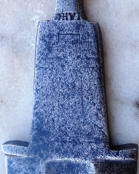

So what do the letters I A H I stand for?

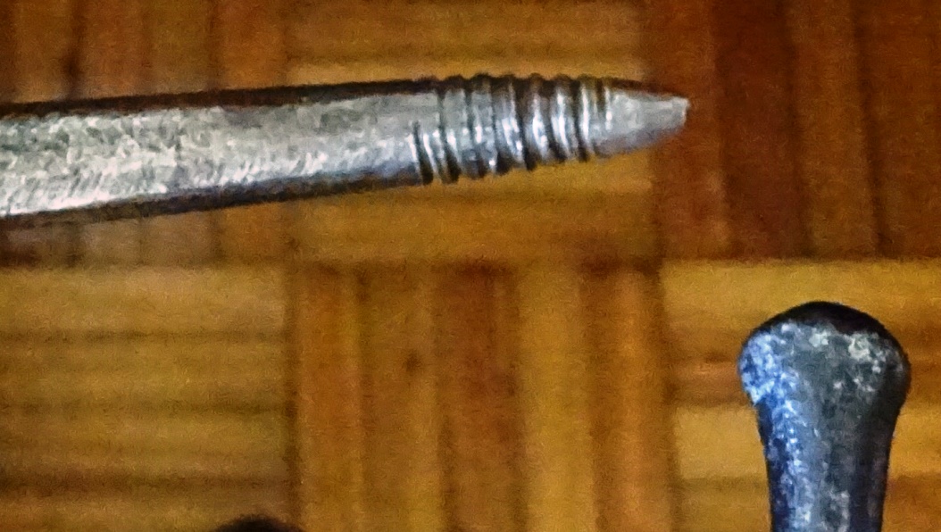

Where would people date threaded pommel nuts generally?
What’s the meaning of the ”double” patriarchal cross? Seems this cross originated in Byzance and spread to countries like Hungary, Russia and Lithuania. Why does it appear in Portugal (Byzantic connection)? The cross may have lost its meaning but for sure it had a meaning when it was put on the blade or the smith wouldn’t have bothered with the extra effort/expense.

Well, that would be the one million dollar question. Probably those of the smith; i wish someone would know !
I would not know when in time peened pommels evoluted to the threaded system, and if that took place in the various type of swords as in the different countries at same time; i bet there are members who are more familiar with that topic. But i could clearly define the "conic" manual section in which this specific tang thread is made as certainly much prior to the classic 'cilindric' system. I have also read that tapping and threading pommel fixations can be a later operation. Minding that the pommel of the other sword that was together with this one has a pommel of rather different shape, yet unscrews in the same manner.
Patriarchal cross, Lorena cross, Bizantine cross, Caravaca cross.There are those who join them all in one, fusing their simbology; some even say that the upper shorter arm represents the board where the Romans inscribed the letters INRI in the crucification cross of Jesus. Personaly i would not favor the conviction that these symbols in these swords are a rigid allegory to exoterism, like if they were medieval or free mason swords, as in my humble perspective these are more to entice their selling, naturally calling for a "just in case" religious appeal; notwithstanding the smith applying them with the intent for profit. On the other hand i know for sure that the VIVA PORTUGAL was (in the discussed period) a contextual asset commissioned by the customer.

So this explains the engraving of the cross on these swords tang/ricasso; as i view it, more a motivation of patriotism and authority rather than for religious purposes... or perhaps in great part.
Originally Posted by Victrix
... The archbishop of Toledo is the Primate of Spain since 1085 but the Archbishop of Braga in Portugal claims the Primacy of the whole peninsula and uses the double cross...
Yes sir, indeed.
