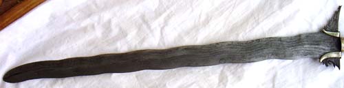

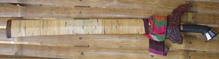

This first piece I consider my "find", iron and nickel, original scabbard with buffalo horn cap on the bottom which I had rewrapped by the local craftsmen, handle is also buffalo horn and mother pearl (not original) and the blade cleaned using the traditional process which I'll go into later.
Somebody help me out with the luuk count, no matter which way I count them I come up with 8?
Enjoy

Hey Dan !
Good to hear from you .
I believe I count 15 waves in this blade .
A shot of it from straight above against a lighter background would be helpful .
So would a close up of the gangya area .
Absolutely beautiful forging pattern .

Hi Dan:
Good to hear from you again. Was beginning to think you might have disappeared in the jungle.
Nice example of a Sulu kris. This one looks like an older blade in new dress. Hard to count the number of luk from the picture, and some of the early 20th C. blades had really shallow luk anyway. Just looking at the spacing of the curves along the blade, I would say it is probably a 13 or 15 luk example (always an odd number). A better picture would help.
What else you got to show us?

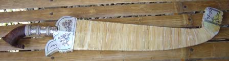

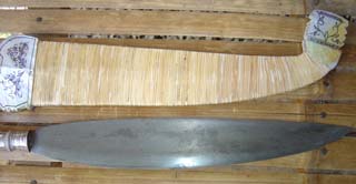

Gonna have to work on the size of those photos, but in the meantime while I still have the computer (2am here) I'll post the barong I picked up. It has the swollen edge (concave in the center of the blade) I had the braided cord on the handle replaced with braided silver wire and a new scabbard built for it (the one that came with it was new AND broken).

Default Nice barung too ...
Dan:
You are definitely developing a good eye for Moro weaponry. Is that a swollen edge on the barung?
Ian.

nice to hear from you again, dan. i'm envious in that you've already been in places i only dream of visiting one day...
i believe the barung does have a swollen edge.

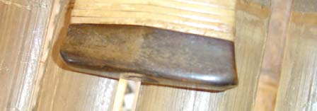

another thing is the wonderful MOP work on the tagub...

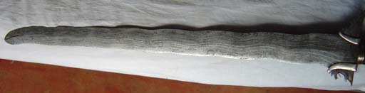

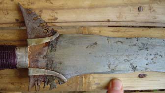

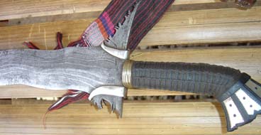

Default Better Pics
Better pics as requested.
Spunjer, glad to hear from you again and yes is it a swollen edge (that's why I pid so much for it).
Mabagani, always good to hear from you, but the Bud Dajo reference -OUCH! The Battle of the Clouds is not forgotten by those working here, but the younger generation here has no clue. The only rallies they had here were organized and attended by outsiders, the locals showed little interest. We did commemorate it here, as soldiers we appreciate and honor others of our kind that fight valiantly for that which they believe in. While many have tried to use it to drive a wedge we have tried to honor it and those that gave their lives while still focusing on the future and the development we're trying to create, instead of living in the past. The Tausug here are people of extremes they either love you or hate you, a completely misunderstood and misperceived people. We are working hard to insure that all from Manila to DC see the potential of this absolutely georgous, but still dangerous island and insure the resources they need to take their rightful place are not misdirected. And of course on a personal note I've tried to re-educate some on their weapons, their crafts and the market possibilities of their exquisite artwork. We have an initiative started and I've linked up some old craftsmen with their Barangay captains and the schools where we put internet in to try to get small internet busineses started. Just wish I could have made contact with that old blacksmith, but I will leave behind 90+ projects for school renovation, water distribution, health clinics, livelihood programs, etc. for my successors to implement.

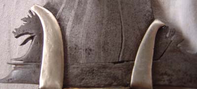

i counted 15 waves, dan. also, is the gangya separated?

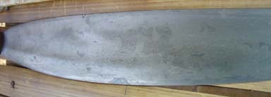

Yes Spunjer it is definately a seperated two piece construction and the blade itself had many small seperations along the nickel iron lines, one especially large at the tip. I had thought that this type of seperation came with age when these two metals were mixed. Additionally while my photos aren't the greatest the luk are quite worn down apparently from sharpening.
The wood on the scabbard is brittle with age and must be handled carefully, the water buffalo end cap on the scabbard has turned a bleached brown with age and I'm told here (heresay from locals) that the carving pattern is of an old variety (I'll post some other pieces with what they claim is a newer variety, before they went to shaved tortoise shell and mother of pearl.
All that said and the reaction I get here when I show it, I would've thought that this piece would have been mid-19th century.

Now as for the cleaning I've added some shots of how we did, literally you wouldn't recognize some of these blades after we finished. My thanks to COL Alamia who just retired to Lugos island for his help in explaining the old ways.
First off a good soak in Cabulan, which the fluid left over after making coconut oil. Hollowed out a length of bamboo poured in the cabulan and SOAK! Some blades took 2 days, some took 4, most showed whether they were sandwich laminated or folded after about 24-36 hours. The dirt and rust was just gone when we pulled them out only a wipe reqiured. We reused the cabulan on all the blades we had as cabulan is not for sale here, you have to wait till someone makes a batch of coconut oil out in the country and ask them to save it. I think it loses some of its efficacy after a few blades and it definately starts to stink and mold after two weeks!
Getting the gangya soaked posed a problem as even the widest bamboo couldn't fit the gangya. We improvished a cut-off bleach bottle with gasket seal across the bottom and pushed the sword through the bottom. Second time we rubber banded a plastic bag of cabulan around the gangya, neither was an optimum solution aas both leaked and the area around my bunk stinks After the soak it left the blade a dirty white which was easily removed. Now the traditional way was to then rub it with calamanci (small green citrus) while this does keep it from rusting, we found after time that it continued to etch the blade and turn it blacker. We used Break -free, our all purpose lubricant that we use on our guns and got much better results. The blade seemed to suck up the first heavy coat and then the second sucked it up till it left a dull shine without affecting the lamination.

the kris blade does look older. never seen where it's actually separated along the blade. pretty cool dan.

Wow, Dan - fascinating post and nice swords. There are many here with more experienced opinions than mine, but while clearly in 20th C dress, the blades look 19th C to me and nice ones at that. I haven't seen a kris blade with piled construction quite like yours. Neat story, too, about those blades cycling back out of the past to connect their heritage with the new, and hopefully eager, generation of Joloanos.
