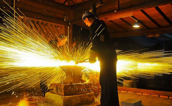

Simply put, the initial stack of iron-pamor-iron-pamor for making a 'gebingan' for keris blade was first made of 32 layers. Heating it and melding it, then hammered to 36 cm in length. Divided by 3, then stacked. (According to “Bab Pandameling Duwung”, divided 6 and then piled five. One for making ganja. But we made the ganja separately, with same material). So here the first melded 96 layers.
The stack of 96 layers was heated and melded again and hammered it up to 36 cm long (we call the process of heating up and then hammering to make it longer, ‘dionjot’), then cut in three more to be stacked the second time. Be 288 layers.
As the previous process, then the stack of 288 layers was heated and melded, hammered up to 36 cm long, then cut three more. So be a stack of 864 layers. Heated and melded again up to 36 cm. Then, a ‘gebingan’ of 864 layers was ready for making a keris ‘kodhokan’.

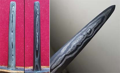

The 864 layers gebingan was bent in two, melded and hammered until 36 cm and 4 cm in width. Actually, the total layer of keris is 1,728 plus one layer of slorok, be a ‘kodhokan’ of keris with 1729 layers.

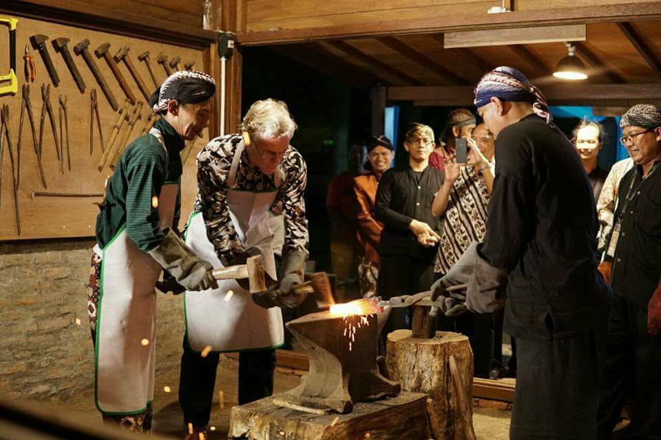

* The photo of GBPH Yudaningrat (wears brown jacket), the younger brother of Sultan Hamengku Buwana X of Yogyakarta, visiting and commenting on GuloKlopo process of making keris.
