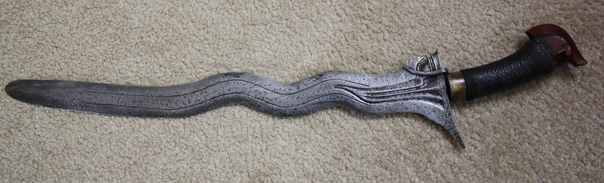

chiefheadknocker
Join Date: Dec 2014
Posts: 143
Originally Posted by Ian
Hi chief:
I would go with what you feel comfortable with.
Just to back up what Jose said about the absence of twist core on one of his archaic kris, attached is a picture of mine that was exhibited in the History of Steel Exhibition, Macao in 2006-2007 and it also has no twist core down the middle. Twist core may have been reserved for higher end pieces.
Regard,
P.S. Dimensions of my kris are very similar to yours:
OAL = 55.7 cm
Blade = 43.5 cm
Hilt = 12.2 cm
Thanks for uploading the pic of your similar sword , i have cleaned mine a little more and etched a few times with vinegar ,as the outcome was a little patchy i then used a soft wire wool to give the blade a more even look , ive added a picture of the outcome which i think is ok even though one side is pitted more than the other

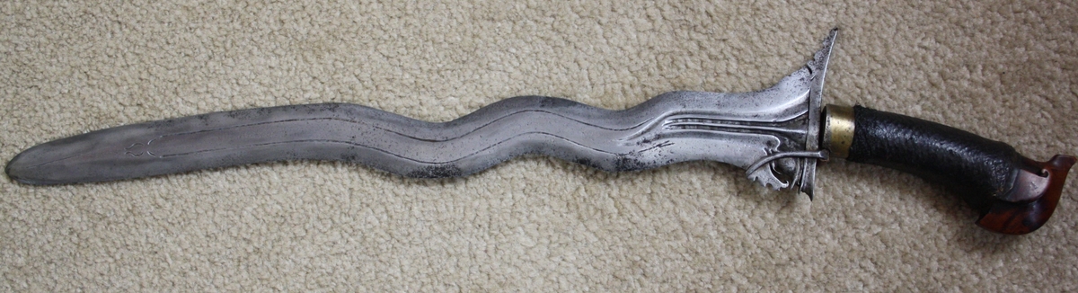

Originally Posted by kai
Hello Jose,
Could you please show us the kris you mentioned? I don’t think we have discussed it yet? Thanks a lot!
Sorry it took so long, but here are the pictures of the kris I was mentioning. If you need better pictures please let me know. The hilt is a restoration of a hilt in horrible condition and the pommel had been remounted several times in the past. Even the asang-asang clamp had been replaced several times. However the sea ivory pommel is original.
Notice that the blade does not even appear laminated, much less a twist core. I believe this kris is from Tawi-Tawi.
