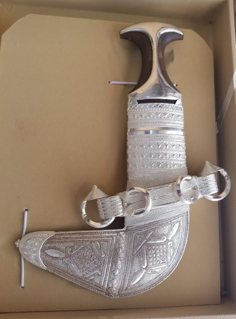

The picture recorded below shows an Omani hilt and khanjar blade .. the hilt of oddly named Zraff Hindi which is weird as india doesn't have these...but Africa does... and beside that a picture of an Okapi clearly of similar head shape to the adjoining shot of a Giraffe...and the two animals are even related by species although Okapi don't have big enough horns for a penknife let alone a batch of Khanjar hilts.
What is large enough is the giraffe or at least the male; rolling out as a 22 foot tall beast with 6 foot long legs capable of actually killing a lion by kicking off its head! The word game becomes complicated when you take the Arabic given name of the Rhino which is Zraff Afrique!
I think it wise to mention that all these animals are now on the endangered list thus caution is advised and as always when dealing with ethnographic weapons great sympathy and awareness is needed when covering such issues..
Therefor moving forward with this thread I will offer a series of never seen before examples of THE OMANI KHANJAR and hope members will come in with any questions and suggestions.

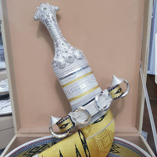

This one is difficult> The hilt is Yemeni which locals call Zraf Yemeni. It is old Rhino from a Yemeni Jambia with all original silver Yemeni silver furniture> It is an old hilt likely to be an heirloom. The man wearing it has a different pattern on his white Dishdash ...which is from the UAE. The scabbard is deeply cut/patterned on plate silver (not silver stitched).
I think this is a UAE Khanjar.

Here is an intricate design with zraf hindi hilt which is of course African Giraffe.
Old 10th March 2019, 10:28 PM   #300
Ibrahiim al Balooshi
Ibrahiim al Balooshi's Avatar
Join Date: Jul 2006
Posts: 4,408
Focusing on a little Ethnographics ...The Funun is the set of Traditions played out in Oman in dance music poetry and singing in a form of pantomime to rhythm and often an ancient musical score . In fact this entire set of Genres was the means by which traditional performance passed these performances down the generations so that in researching weapons the Sword or Khanjar dances can be traced far into the past. Please see https://www.youtube.com/watch?v=87h_...rt_radio=1#t=1 for the Bara'a The Khanjar Dance
