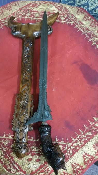

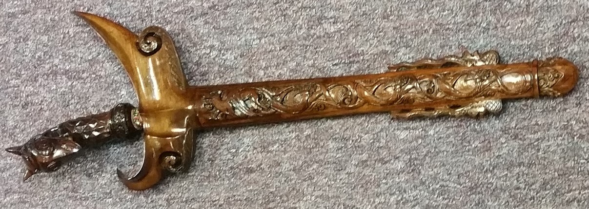

I just commissioned new sarung for a Javanese keris blade, which has carved Viking Norse Motifs.
All comments are welcome.

Welcome to the forum Alexish.
I can't say that i see the reasoning behind this particular kind of cross-culturalism, but it does seem to be technically and artistically well executed.
David is offline
Old 7th June 2017, 01:29 AM   #3
Posts: 7,228
Sumenep.
I feel that perhaps we will find that the keris itself is a rather recent one in an East Javanese style.
A. G. Maisey is offline

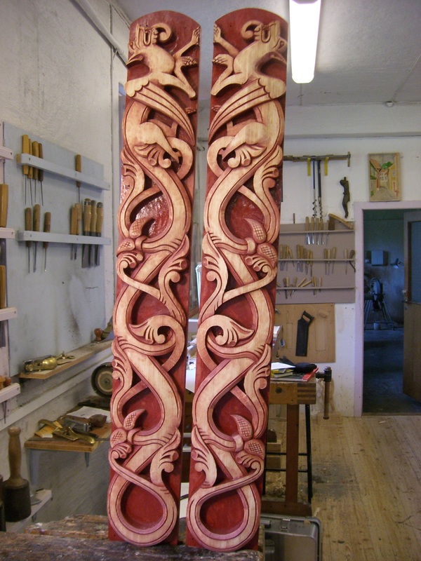

Default Viking Norse Keris - More pictures and inspiration
I attach more pictures of my Viking Norse Keris with blade, including pictures of the original Viking Norse designs that inspired me.

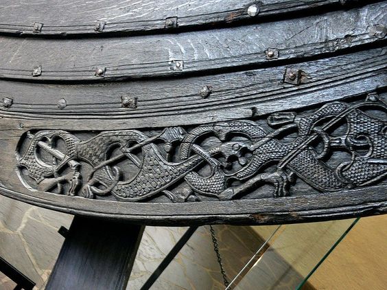

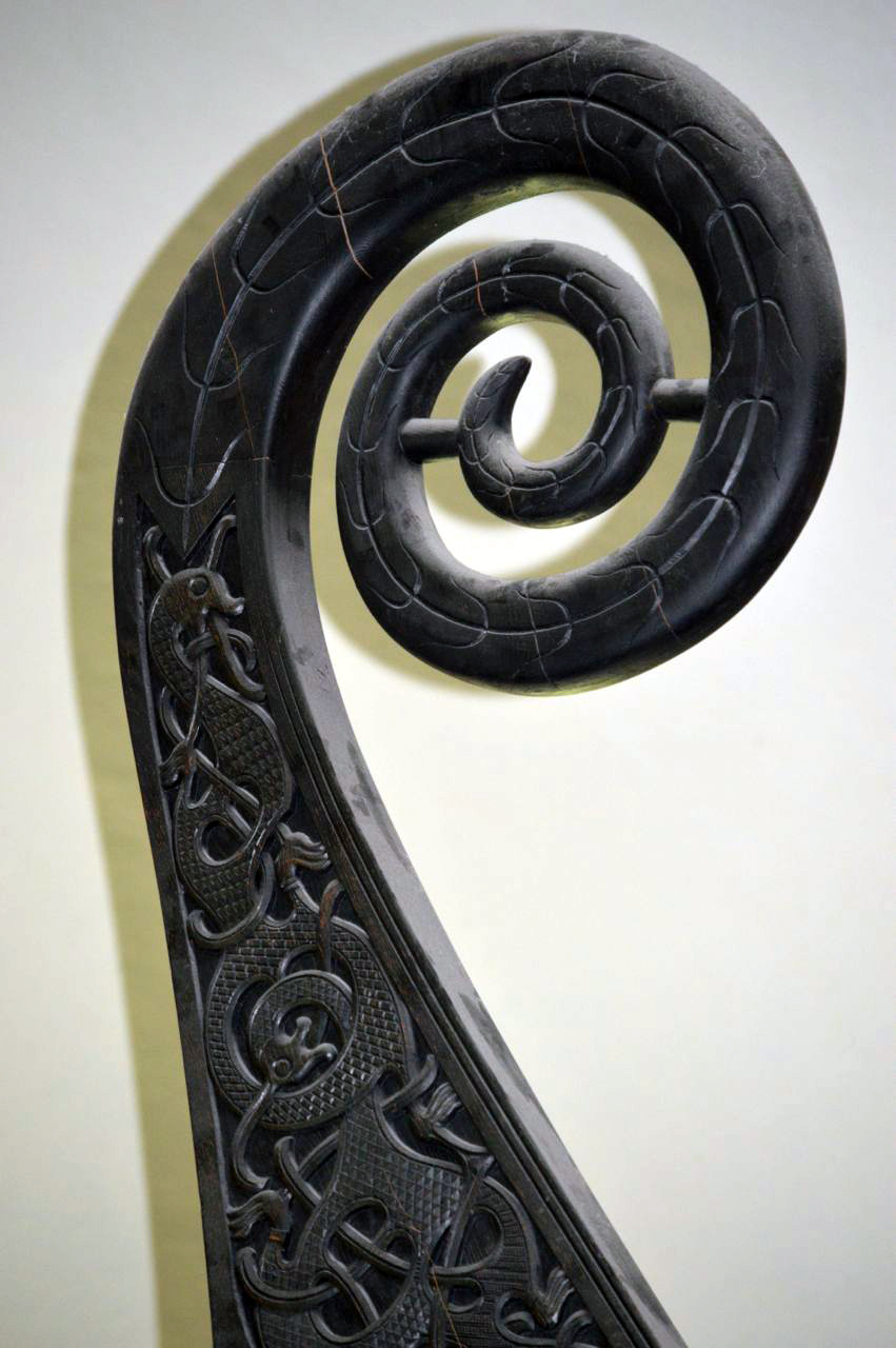

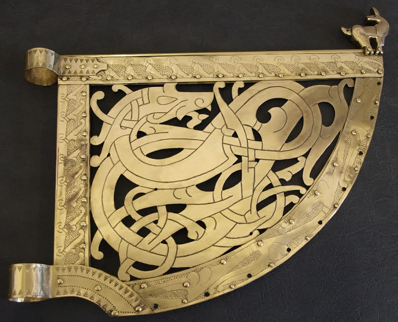

Here are additional pictures of the Viking Norse Keris, including pictures of the Oseberg Viking ship that inspired the Warangka.

Well Alexish, this is a contemporary creation and frankly it includes some features i have not encountered on keris before. Dhapur is a designation of specific pakem that applies to specific kratons (palaces) from various kingdoms such as you have mentioned so given the artistic license of this particular piece i am not sure exactly what dhapur name would apply.
Buying a keris in Jawa is no guarantee that the blade was actually made in Jawa, though it is possible. There are also centers of modern keris production of these forms in parts of Madura as well that could possibly produce a blade like this. Someone here may be better at recognizing these modern works stylistically and have a more definite answer for you as to what area this one comes.
Mystical properties are more usually connected to pamor pattern than with dhapur, though that can figure in as well. From the photos you display your keris seems to be without pamor (kelengan) so i can't offer much information there. However, i will say that modern keris from these keris making centers in Jawa and Madura tend more towards the artistic presentation of keris, not the mystical/magicak form. The vast majority of modern keris makers are not empus who still know the secret rites and rituals necessary to make mystically empowered blades. Perhaps others will have a different opinion.
David is offline

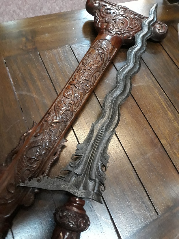

I agree with David's comments, and will add a little more.
This keris blade is post 1980 production, overall style is East Javanese, workmanship is the Sumenep Madura school, but it may have been made somewhere else in East Jawa, technically, Madura is a part of East Jawa.
The wrongko and hilt are workmanship attributable to the Sumenep school, but probably obtained through Pasar Turi in Surabaya.
This is a completely modern keris that is absolutely in line with the approach that treats the keris as a vehicle for craft/art expression. Yes, the interpretation of the carving motifs of the dress could be taken as Scandinavian, but exactly similar forms can be found in markets in Indonesia. There is nothing traditional about this keris either as a societal indicator or in a talismanic sense.

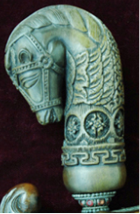

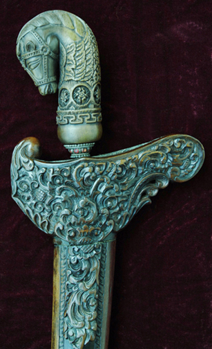

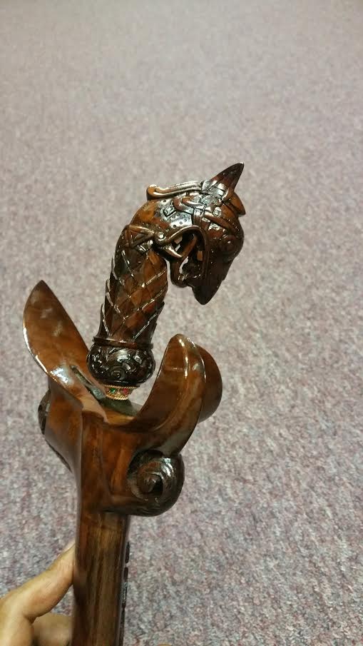

Alexish, if i am not mistaken the image you have posted of the horse head hilt is mine. This is a relatively recent hilt that was probably carved only about 25 years ago. Madurese carvings are known for incorporating numerous European motifs introduced by the Dutch during centuries of colonialism. But the winged horse, called Si Mega, is the regional emblem of Sumenep and has been a part of their iconography for some time and probably is not attitude to the close relationship between the Madurese and the Dutch. Si Mega is mentioned in the legend of Joko Tolè. While journeying to Majapahit to assist his stepfather named Empu Kelleng, Joko Tolè met with his uncle, Adirasa, who gave him the flying horse Si Mega and a whip, both of which had been entrusted to him by Adipoday.
The horse in this hilt is a stylized version of Si Mega.

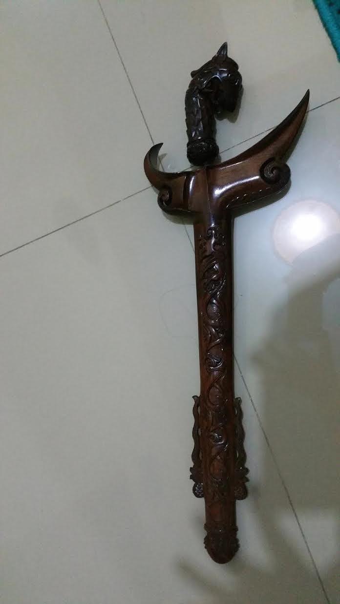

Alexis, the wrongko in post 13 is also recent, it probably post dates 1980, it certainly does not pre-date WWII.
There were some beautiful, and very inventive wrongkos produced in Madura, but I have never seen a ladrangan with this sort of spiral ornamentation that went back beyond the late 1970's.I've certainly never seen one with provenance that placed it any earlier than last quarter 20th century.

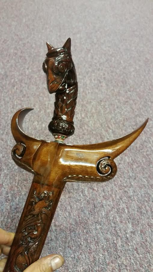

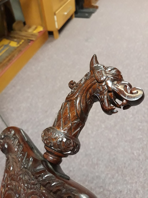

Default New keris in Madura style with Norse motifs
Dear collectors,
my sincerest apologies for re-opening this new thread on an old subject. For the sake of completeness, I just feel compelled to post pictures of my newly commissioned piece. Of course, it will be criticized for being a modern fantasy piece along the lines of the fantasy barbarian swords of the Kult of Athena. But, the point I want to make is how easily medieval Norse motifs can easily be mistaken as local Indonesian to the untrained eye, even by native Indonesians themselves. I have actually shown pictures of this new 'Norse' sarung to some local Indonesian collectors, and many of them seem to think of it as a variant of Madurese-style sarung. I think because the Norse and various Indonesian cultures are sea-faring, it is thus not surprising that there are many similarities in carved motifs of these cultures on opposite ends of the world.

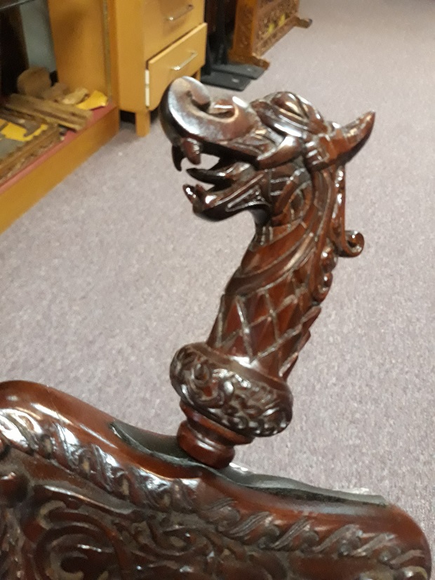

Default The hilt inspired by History channel's Dragonhead

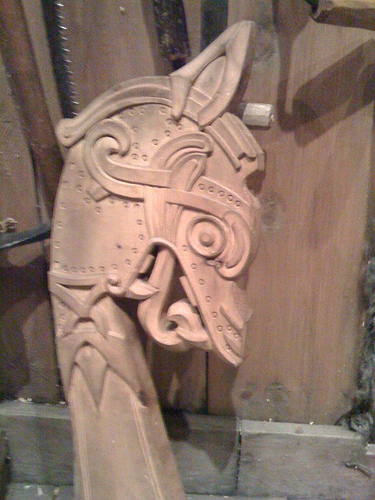

There is a popular TV series on History Channel 'Vikings'. Although not 100% historically accurate, I believe that the producers have at least made some attempt to keep a degree of authenticity to the costumes and prop, for example, the absence of horned helmets, as in popular culture. I therefore believe that the dragonhead prop of the protangonist's (Ragnar Lothbrok) Viking ship is actually inspired by genuine Norse motifs, even though it was never based on an actual archeological artifact. Hence, I utilized this as a model for my hilt, rather than genuine archeological artifacts such as the Oseberg ship dragonhead (which shape incidentally was not suited for a keris hilt).

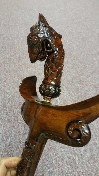

Default The wrongko and pendok

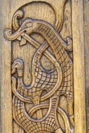

For the pendok, I utilized motifs from the Oseberg ship, which is a genuine archeological artifact. For the carved motif of the wrongko, I utilized a Dragon motif found on a Scandinavian weather vane.
alexish is offline

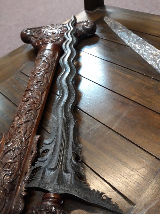

Default Blade
The blade is however based on a Kemardikan pakem.
alexish is offline
Old 19th April 2018, 12:35 PM   #26
Hello Alexis,
AFAIK there have been no additions to the pakem during the kemardikan period yet (neither by the Solo kraton nor Yogya). Thus, it would be rather out-of-pakem as most modern keris art. Not a bad thing per se, just saying...

<SIGH> I'm sorry you have felt so "compelled" Alexis. I don't know how many times and how many ways i need to tell you that this is not what we do here. You will not be told again.
I am also not surprised that you have met Indonesians who believe this is a variant Madurese style. There are Americans (far too many in fact) that also know little of their past culture and this country is less than 250 years old. Despite what we as keris collectors know on the subject, keris is no longer in the forefront of the Indonesian mindset. Ignorant and uninformed people live in all cultures. That you have confused a few Indonesians with this is not at all surprising, but it validates nothing. But i believe it is our responsibility to keep keris culture alive and increase the wealth and knowledge of this wonderful cultural icon, not to confuse the issue and pollute the field with nonsensical cultural appropriations.
