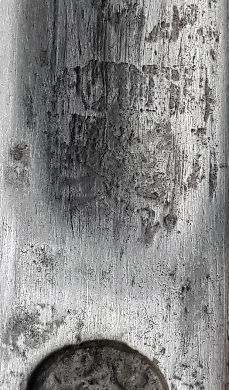

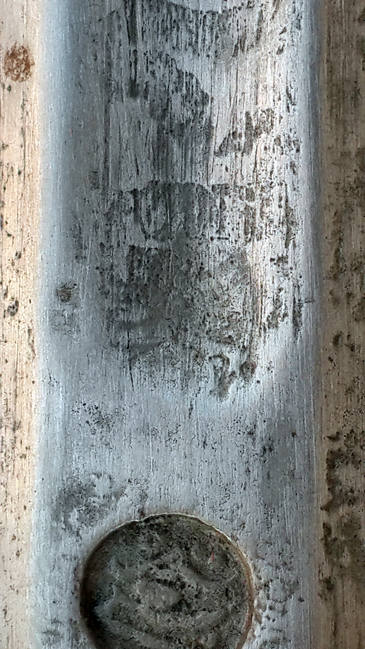

This is one of my old relics, which I am going to restore (and of course will share after the restoration). I wanted to share it and have your opinions (if you provide ), before the hilt, scabbard, etc... is completed. You will find the detailed measures below, in the figures.
Please note that the grip is not symmetrical, has 3 mm width on the holding side, which I think most "kindjal people" are familiar. The thickness of the blade is 5,5 mm, and has a distal taper, 3 mm where the fulers end, and 1,5 mm at the very point.
There is an acid etching on the blade, on the strong part, which I thought it was an inscription before, however, apparently nothing but for decoration. I could not find any parallels for years.
Although it is quite a thick blade, it has lost its temper, or never had a proper temper, for it is a sturdy beast, but can be bent and not recover its form, if enough force is applied - I was nearly going to bend it, before I realized this May be it is because of the way it is forged. I know very little about this, but I add the photos, may be you can say something.
I know it is so hard to provide an origin for these blades, but the mark does not seem to be one of the Georgian of Tbilisi ones. Maybe central Caucasus? I do not think it is Circassian, since it is inherited in a Circassian family.
Any comments on the blade, forging, shape, the signature, and even for the decoration style for the restoration is welcome. I am inclined to decorate it in the Circassian style, if it fits
Thank you all in advance. Best.
