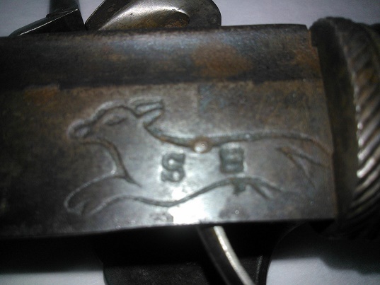

It seems that the Shotley Bridge hangers were marked as previously noted and with running wolf.
If you could provide a photo and details perhaps we might better determine the plausibility of it being of that provenance.

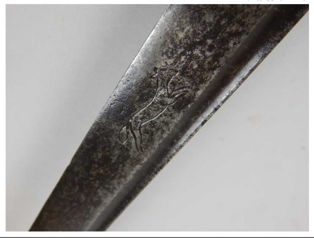

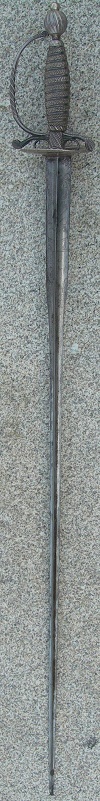

Hello Folks, and thank-you for the warm welcome.
Because I live a mere 40 minutes from Shotley Bridge, you would have expected me – and this applies to almost everyone here on Tyneside and its environs – to have known at least a little about the sword-makers. However, it was only when I came across a local-history publication, regarding the SB Smiths, about twenty years ago, that my attention was alerted. The book, published in 1973, and written by David Richardson – the grandson of Mary Oley (the penultimate resident extant of the Solingen immigrants) had been the go-to source of information until David Atkinson brought things up to date in 1987. This book was subsequently revised and updated by John G. Bygate at the turn of this century (isn't it strange to have to specify which century is turning?); and until Richard H. Bezdek brought fresh knowledge and insight to the history in his book 'Swords and Sword Makers of England and Scotland' there was precious little else other than spurious articles here and there such as were mentioned by your own Ibrahiim al Balooshi.
Consequently, further investigations were confined to simply keeping an ear cocked until a friend, who works around the area giving talks on local history and heritage, asked me for any subjects she might pursue, and I suggested the SB sword-makers, little realising that she expected me to present her with all the salient facts and etc (story of my life).
As I began to refresh and update my knowledge of the subject I realised there was a great deal missing and a great deal in error (the business of Mohll and Mole being a perfect example) that demanded diligent research.
I've been at it, off and on, for most of this year now; found an SB sword (I hope); learned, by osmosis, much that is of interest but not necessarily pertinent; and realised there was sufficient material for a new book; although, we are talking about a self-published, local-history booklet here, such as I have successfully achieved before on alternative subjects.
Obviously, I can't begin to detail all the material I have accumulated this far, but one thing keeps cropping-up again and again that has led me to suspect we may have all been the subjects of a gigantic ruse, and that is the total absence of an SB made trefoil short-sword to date. However, "The Smallsword in England", James Aylward, 1945, may change my mind once I have acquired said book – thank-you Jim – so I am about to buy a copy forthwith. That aside, has anyone ever seen one?
OK: hopefully, this is the beginning of a beautiful friendship.
Best Regards, Keith.
ps. Just to whet your appetites, I have attached an exceptional couple of pictures.
[IMG]
Old 20th September 2017, 10:19 PM   #8
urbanspaceman
Join Date: Sep 2017
Posts: 736
Default Daily Addendum
You were writing your last post as I was mine Jim; however, being a newbie, my post awaits moderation. Thank-you, I can see we have much to discuss.

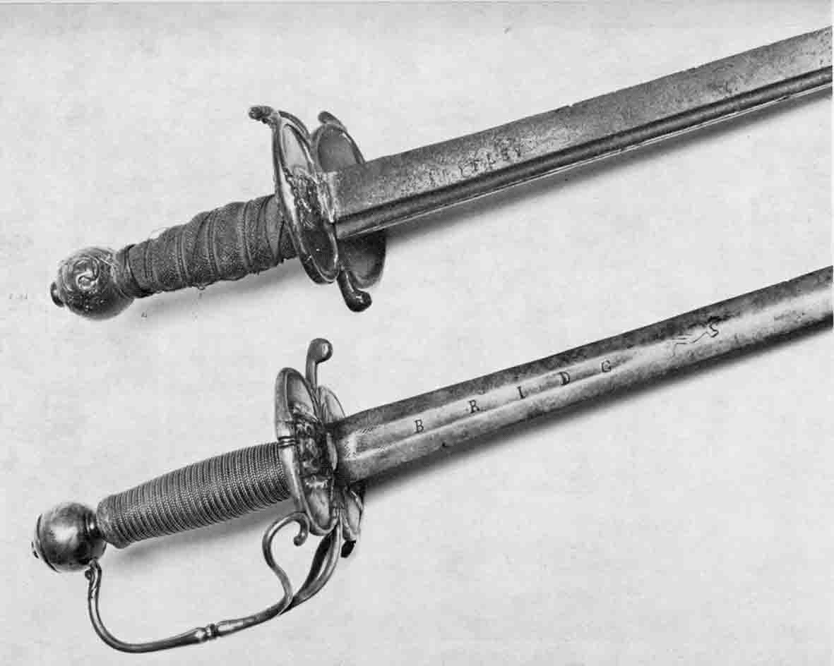

This post is by way of explaining what the pictures are that I attached to my previous post: the picture of Joseph Oley c.1880 shows the very last sword-smith to operate in SB; he quit in 1840 and became an auctioneer (and grew vegetables). The other picture is of Nicholas Oley, his grandson, who died in 1964 (in SB) holding the last ever blade made by his grandfather.
I suspect that blade was sold by auction here in England last year but I have yet to confirm that. The auctioneer told me that it was submitted by a one-time resident of SB who assured him it was made by Oley; I am waiting to speak to the vendor.

Thank you for your post ...Can you outline which details are spurious although you probably refer to notes in the references perhaps also linked to the secretive nature of the German originators...?
What is your description of the two photographs please?
One or both is Nicholas Oley last surviving member of the Swordmakers from http://www.geocities.ws/lacbillj/shotley.html oh I see your post above... OK.
Below are some other ethnographics...The Children actually standing on the Shotley Bridge..The Swordmakers house on wood street visible from the Bridge...with what is the old flour mill behind it.

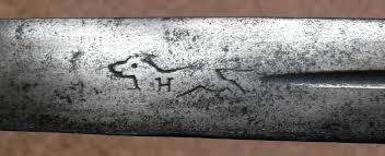

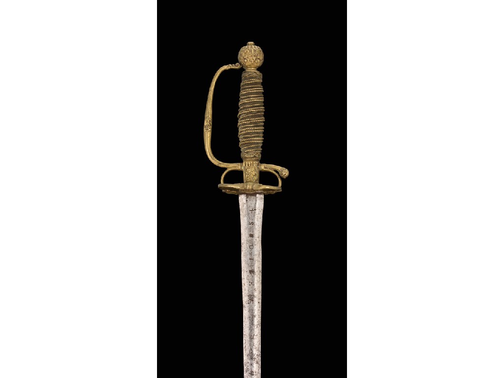

It does not seem that the small sword blades were marked to Shotley, or anyone else as they were imported either finished or ground there.
It also seems that small swords were primarily furbished by jewelers or such outfitters who obtained blades at these kinds of outlets.

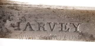

I am curious now that I think of it, of the Birmingham maker Samuel Harvey who produced hangers and sword blades around mid 18th c. He used a running wolf with the initials SH enclosed as a blade mark. It seems some have suggested 'SH' (= Shotley?) or more plausibly his own initials.
Interesting though.......the running wolf used at Hounslow and by the Shotley Bridge makers......though not seen after 17th c. maybe this was to recall those makers in a spurious application?

As I mentioned Samuel Harvey using the fox/wolf, I find that many of his swords are simply marked HARVEY or SH, without fox. In those times about mid 18th c. there were only several makers producing swords for the govt. and they were in Birmingham. By the 1780s and into the early years of the 19th there were what became known as the 'sword scandals' concerning the quality of British blades and profound import of German blades. The key proponents were Thomas Gill; James Wooley and Henry Osborne. Until 1790s there were few other blade makers, and JJ Runkel was a German importing blades there in London.
It seems possible that small sword blades were either produced or finished at Shotley Bridge, but although Aylward names makers there, it seems odd more is not mentioned. In checking "The Rapier and Smallsword 1400-1820" AVB Norman, there is entirely no mention of Shotley Bridge nor Hollow Sword Blade Co.; also in "Schools and Masters of Fence" by Egerton Castle, 1885, no mention of any of these.

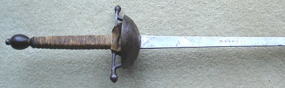

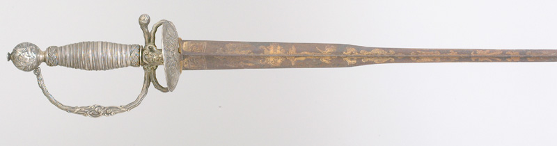

I begin to have my doubts on some of the supposed Shotley Swords ...or claimed as Shotley swords...such as from~
https://collection.maas.museum/object/241752
Although it would fit very nicely into my suggestion that since the hotel/public house; ...The Crown and Crossed Swords was part of the Sword makers estate; ...that if the emblem was Two English basket swords crossed below a crown;...that swords of the Basket variety would have been made there?...see below.
On reflection the sword dates seem somewhat odd...perhaps a typing error....since if Shotley didn't start making swords til 1685 how can a sword with 1596 be slated here as from there?... Would it not simply be a Solingen sword?

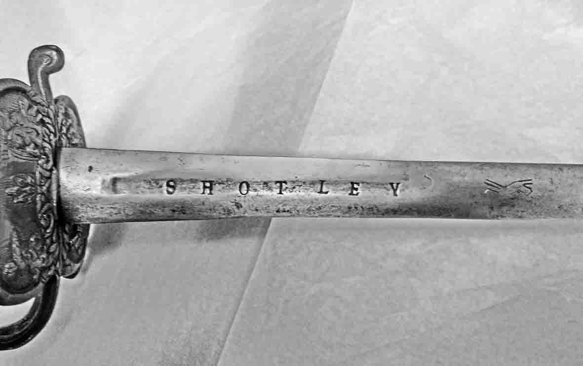

What of this one ? ~ It seems genuine especially with Shotley Bridge inscribed down the blade in capital letters....
Write up by Thomas Del Mare on this sold item...
Quote"AN ENGLISH BRASS-HILTED SMALL-SWORD, CIRCA 1740
inscribed 'Shotley Bridge' and incised with the running fox, brass hilt cast in low relief, comprising double shell-guard with moulded brim interrupted on each side by a panel of scrolls centring on a grotesque, each face divided into a six-petalled flower incorporating allegorical figures and a pair of classical profile masks, globular quillon, near rectangular knuckle-guard, and ovoid pommel decorated with tendrils issuant from a grotesque mask, and the grip bound with plaited wire and 'Turks' heads'
72.5cm; 28 1/2in blade.'' Unquote.

With further regard to the use of the fox: Samuel Harvey commandeered the image of the fox to bestow prestige and quality on his blades. No doubt the dreadful reputation of Birmingham blades, back when he was starting out, persuaded him to purloin it. He always had initials in the outline however, so there's no doubt they are not SB blades; although a lot of reputable dealers in this country will tell you they are. I have even seen the H for Harvey altered to look like a B (not hard is it?).
Oleys in later years (1750s onwards) were using a distinctly singular fox impression: an auction last year sold just such a blade on behalf of an ex. SB resident who had first-hand knowledge of its provenance and indicated it was made by the Oleys.

Samuel Harvey needs to be observed to see where he fits into this ever revolving equation and I note he signed basket hilts seen at https://books.google.com.om/books?id...0maker&f=false page 36 where two cases are recorded for research although many more exist. Harveys work becomes slightly tangled with the Shotley factory and here it can be more clearly separated out...
In addition Samuel Harvey is noted with the SH ... stamp. I have also noted HAR...with VEY under in a square stamp format below.. and Harvey on various different parts of the weapon. Also below the first English cuphilt by Harvey...
The H in some weapons has been changed as you note earlier to a B in a forlorn attempt to try to show Shotley Bridge as the centre of origin..This is usually done inside the running fox...There is no such blademark as SB. Most Harvey examples shown are from his factory in Birmingham.
See Below.

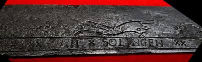

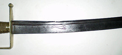

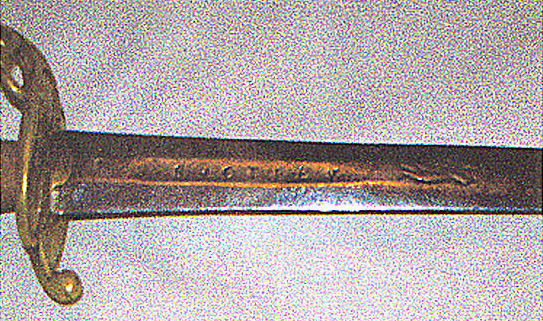

1. It is clear that there is a difference between the running wolf of Solingen and the running fox with its bushy tail.
2. Often as you note the SH (Samuel Harvey) is altered to read SB ..
3. I suspect the sword with roughly applied SHOTLEY in capitals is a Solingen blade with lettering added later ... the wolf perhaps genuine. This could be an heirloom sword.
4. A probable Solingen sword appears with the talimanic 1414 Date and running wolf.

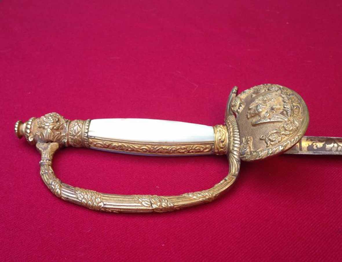

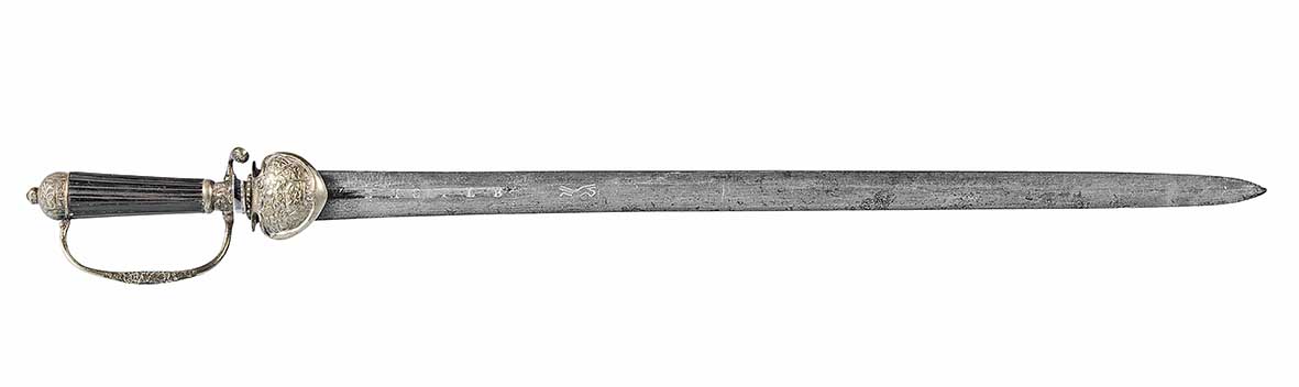

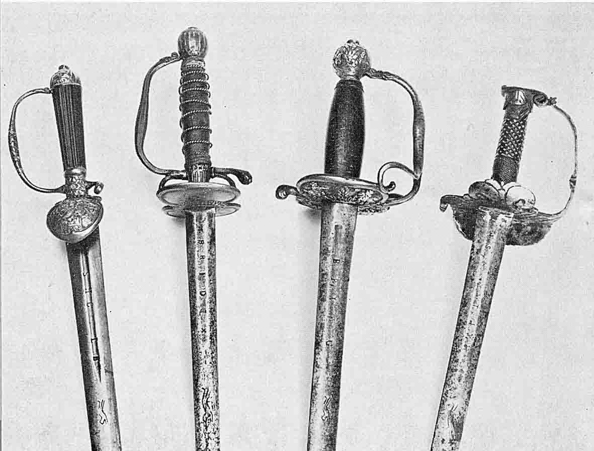

Hello Ibrahiim. I thought it unlikely you would venture to the depths of the industrial North; and, as I said, nothing is to be learned from visiting the place (unless you want to buy the Methodist Church which I noticed is for sale £245k... just joking).
Here are some photos from my local museum and from the Royal Armouries at Leeds.
[IMG]
Old 25th September 2017, 01:51 PM   #29
urbanspaceman
Join Date: Sep 2017
Posts: 736
Default Reivers
ps

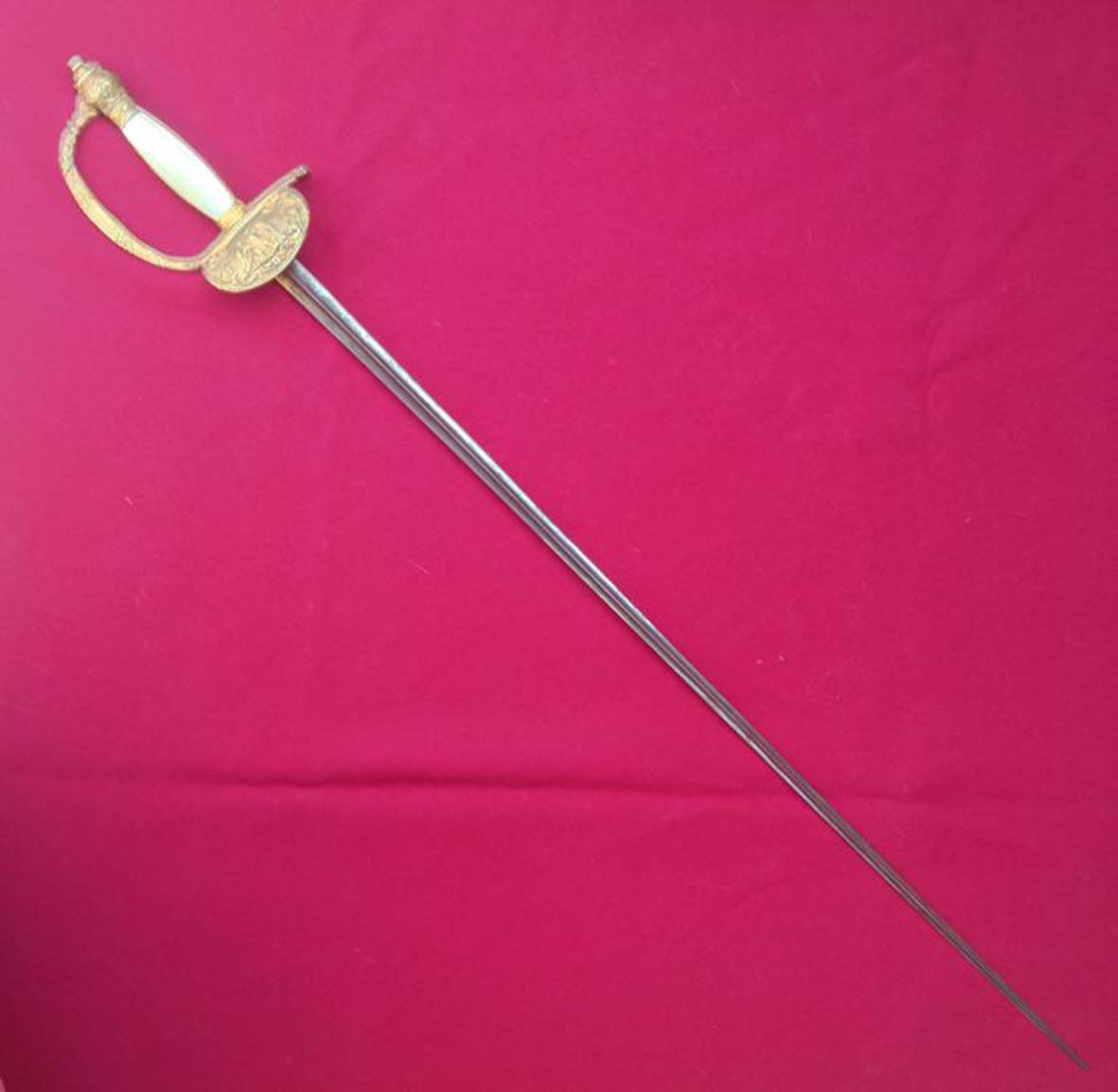

Speaking of Reivers Ibrahiim: my mother's side of the family are Grahams, the most notorious of them all. We were generally over on the west side (Cumberland) unless we were stealing cattle and sheep, then we might pop over to Newcastle for the night.

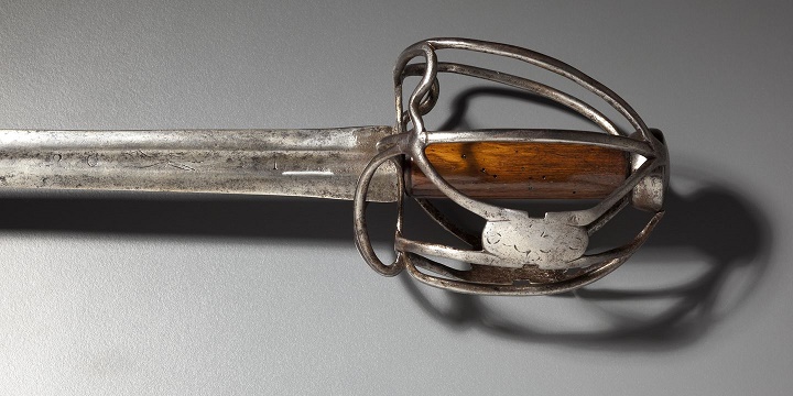

It is most vexing, the lack of SB tri-form blades; all the evidence points to there being an abundance yet not a single example seems to have surfaced.
Are there many early English-made short-swords with Colichmarde or triangular blades? I've just bought a pretty mid 1800s French officer's sword made at Klingenthal, simply so I have an example of what it was all about. I would have much preferred - at least - an English example but I haven't seen anything accessible to date.
[IMG]

According to Wiki Quote"The Colichemarde blade configuration is widely thought to have been an invention of Graf von Königsmark, due to the similarity in pronunciation of their names. However, the first blades of this type date from before the Count's lifetime. The colichemarde first appeared about 1680 and was popular during the next 40 years at the royal European courts. It was especially popular with the officers of the French and Indian War period. George Washington was presented with one during his inauguration.
The widespread misapprehension that the colichemarde quickly ceased to be produced after 1720 dates to the opinion given by Sir Richard Burton in his "The Book of the Sword" dating to 1884. However, many securely dated colichemarde swords from as late as the 1770s can be found in collections.
This sword appeared at about the same time as the foil. However the foil was created for practicing fencing at court, while the colichemarde was created for dueling. It made frequent appearances in the duels of New Orleans. A descendant of the colichemarde is the épée, a modern fencing weapon. "Unquote.
see Hollow-Ground or "Colichemarde" Blades at https://www.militariahub.com/the-his...ritish-swords/
and http://swordscollection.blogspot.com...-xviii-th.html
See below ~Hollow Ground Colichemarde form...
