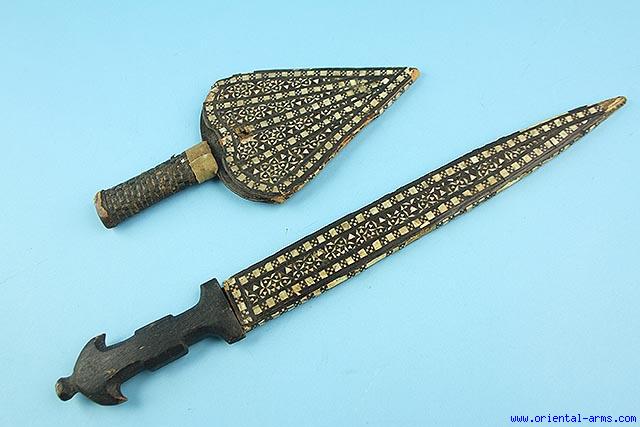

Thanks, on another look at the pictures I think I see a ricasso at the base of the blade as well...
Old 5th September 2017, 07:17 PM   #11
colin henshaw
Join Date: Jan 2008
Posts: 1,431
Here is something similar from the internet...
Old 5th September 2017, 07:28 PM   #12
Iain
Iain's Avatar
Join Date: Mar 2010
Location: Olomouc
Posts: 1,720
Perfect, I knew I'd seen that style of work before but wasn't coming up with anything in my notes.
I'd be curious if there are any firmly dated examples or bring backs exhibiting this type of work that can be used to establish a baseline.
A check on the British Museum and Pitts River Museum collections didn't turn up anything.

Friend of mine had a look and said it was a typical Koranic verse, "Victory from God"

Thank's for your picts Collin ! Kubur was right
Thank's Iain for the translation !
