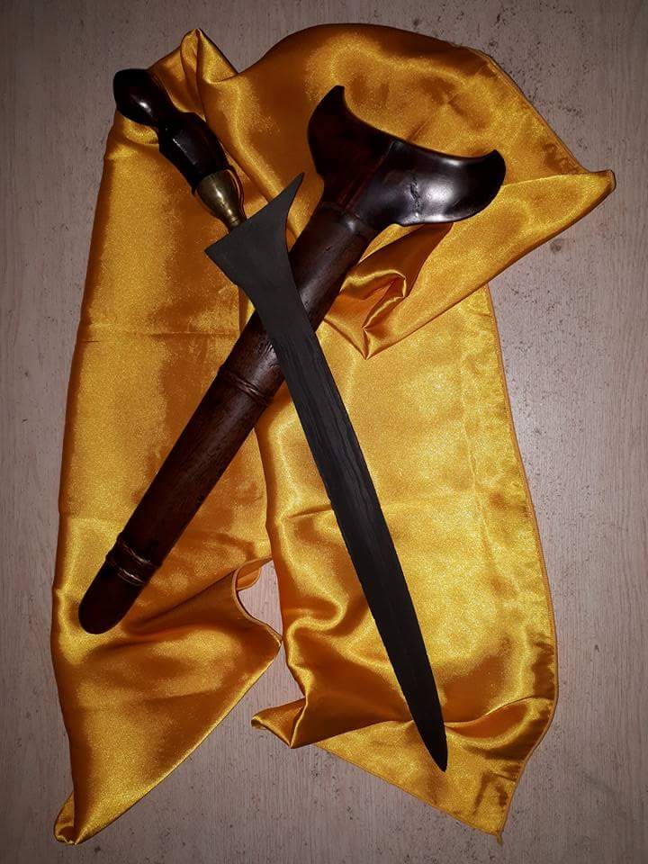

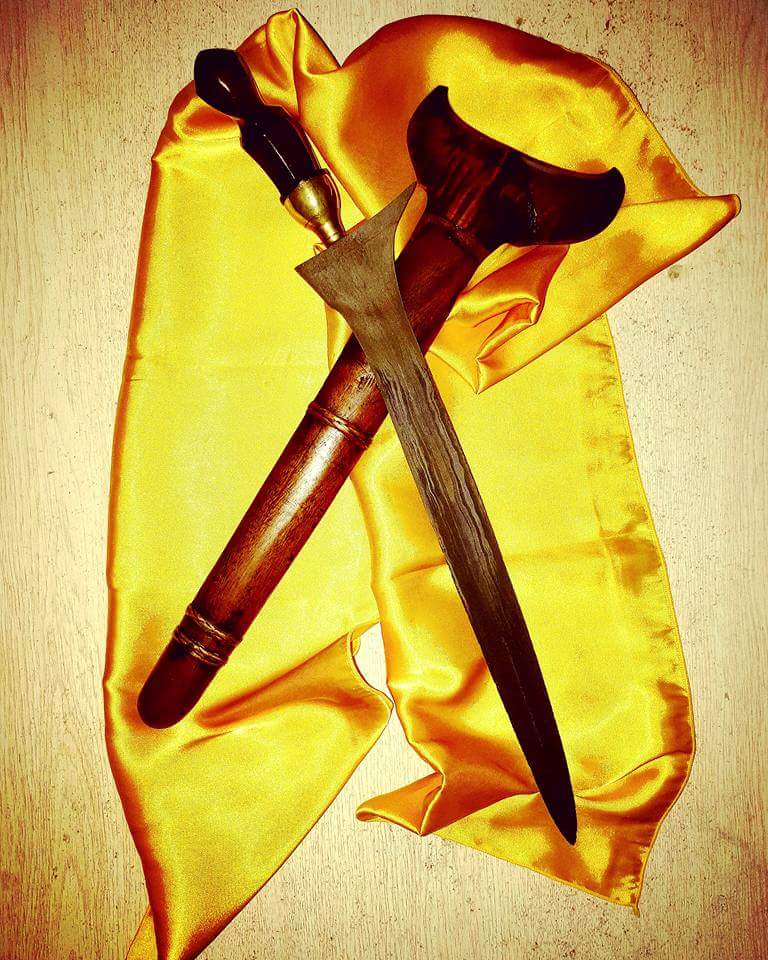

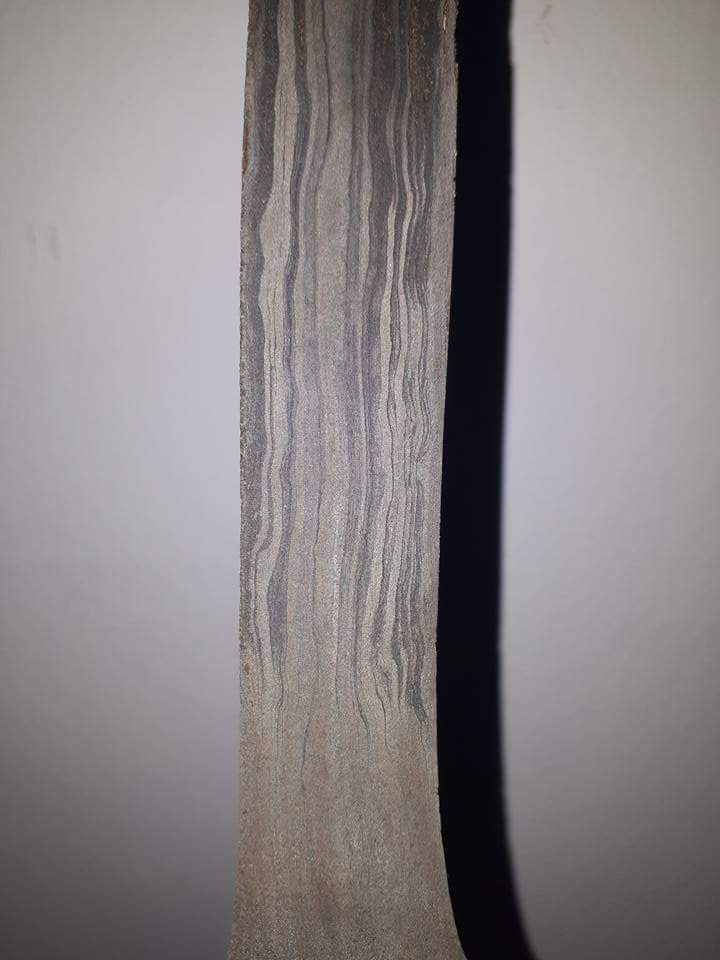

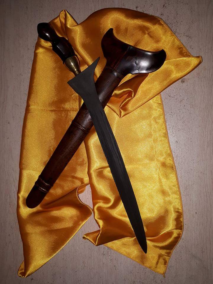

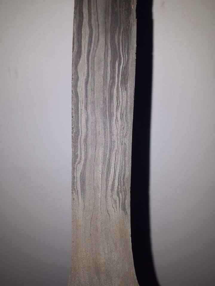

A few months ago, I got this one keris originated from Pagaralam, South Sumatera.
When I received it, the sor soran part partially covered in rust, so I decided to soak it in coconut water to remove the rust. After a few hours, I took it out and clean it with lime juice. Then I notice something peculiar.. the lime juice that dripped from above the sor soran to the pointed tip is changed to black color, almost look like the ink from a squid.
Indeed there is noticeable difference in the blade itself, from the base of the ganja to above the sor soran, it is plain grey. But there is pattern like striped black and grey ribbon from above the sor soran to the middle of the blade length. Then from the middle to tip, it is colored almost completely black.
A keris expert told me that it is actually a poisoned blade.
Is there really such keris? If so, how dangerous is the poison and how is it made? Because opinion has been varied from wether the way iron is forged which created poisonous blade or certain poison from another source was added in the making of the blade. I would also like to get opinion about the tangguh of this keris.
Attached, I send you some picture of the keris.

Better lit pictures are needed.
I doubt it is poisoned metal; it looks more like from the tip to halfway up the blade it has been hardened.

Hi Oracle. Welcome to the forum.
What you are seeing on your keris has nothing to do with it being a "poison keris". It is merely the pamor pattern which is being revealed by the use of lime after you cleaned the blade with coconut water. Generally speaking, after cleaning a blade like this it would be stained with warangan (arsenic and lime) to completely reveal the pamor pattern that was forged into the blade which would should extend over the entire length of the blade. While arsenic is indeed poisonous, its intended purpose is not to "poison" the blade, but rather to raise the pamor pattern and make it visible since arsenic blackens iron while leaving the nickelous material in the pamor relative untouched and creates a contrast in the colors of the different metals. But i would seriously question the validity of any keris ahli who would claim this was some kind of special "poison keris".
Tangguh is a method of classification generally reserved for high level Javanese keris. It was never intended to be used to classify common keris like this one and certainly not keris outside of Javanese keris culture. But even if this keris could be classified according to this method it would be very difficult to nearly impossible to give a good assessment based merely upon a few internet photos. Here is some more information on the Tangguh system that you might find helpful.
http://www.kerisattosanaji.com/keristangguh.html
That said, this appears to be a nice Sumatran keris in old, well preserved dress that would benefit from a real warangan treatment. Given that you seem to live in Jawa it should not be difficult to find someone who can do this for you at a reasonable cost. I would love to see more photos of it if you decide to follow that route.

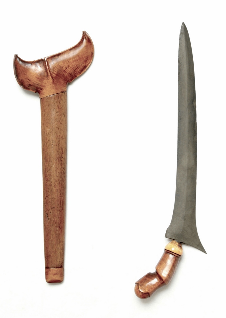

I attach the pic of a similar kris, the blade was cleaned and lightly treated with warangan in Solo, it has no apparent pamor pattern so the color is dark grey.
