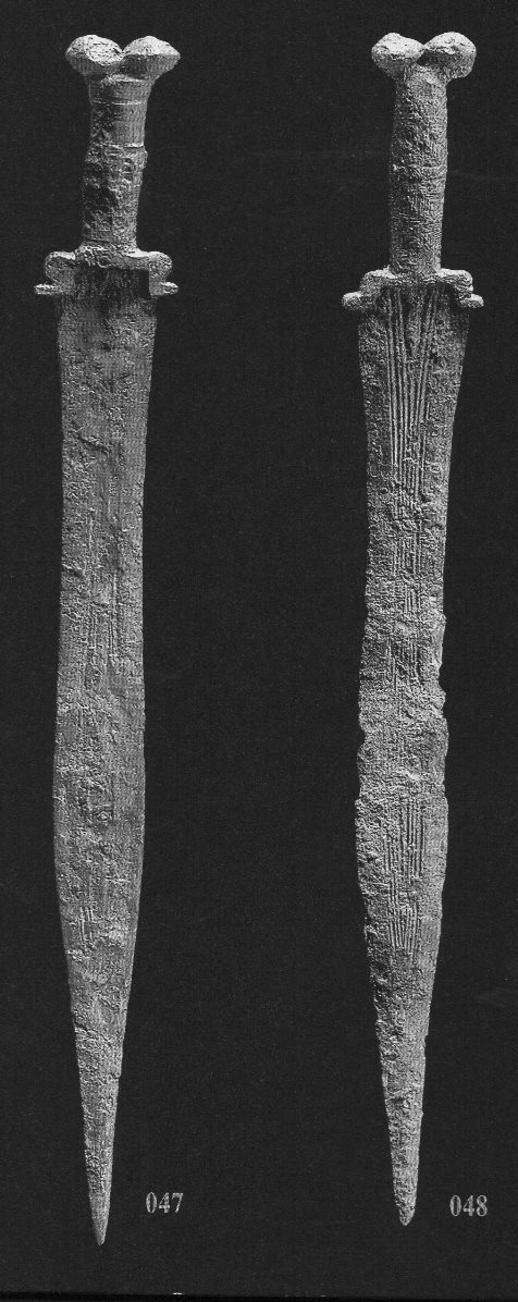

Although not at all a scholar, i have had my dosis of search on the so called Falcata Iberica, called Machaera Hispania by the Romans (as cited by Homero), and potentially descendent of the Helenic Kopis.
By the away, you are surely aware that the name Falcata was ony attributed in the XIX century. What it is not known, according to experts, is how Lusitanians called this sword... but this doesn't mean that they didn't used it. On the contrary, if Celtiberians made them (or copied them), we may realize that they passed on to their following breeds. It is not because early examples were recently found that original models didn't have their inheritance and evolution throughout time.

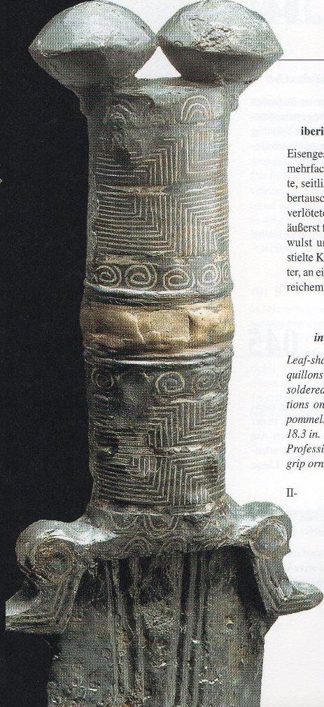

Originally Posted by Gonzalo G

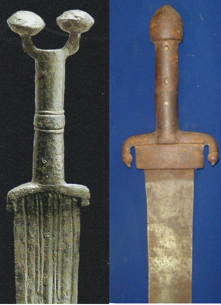

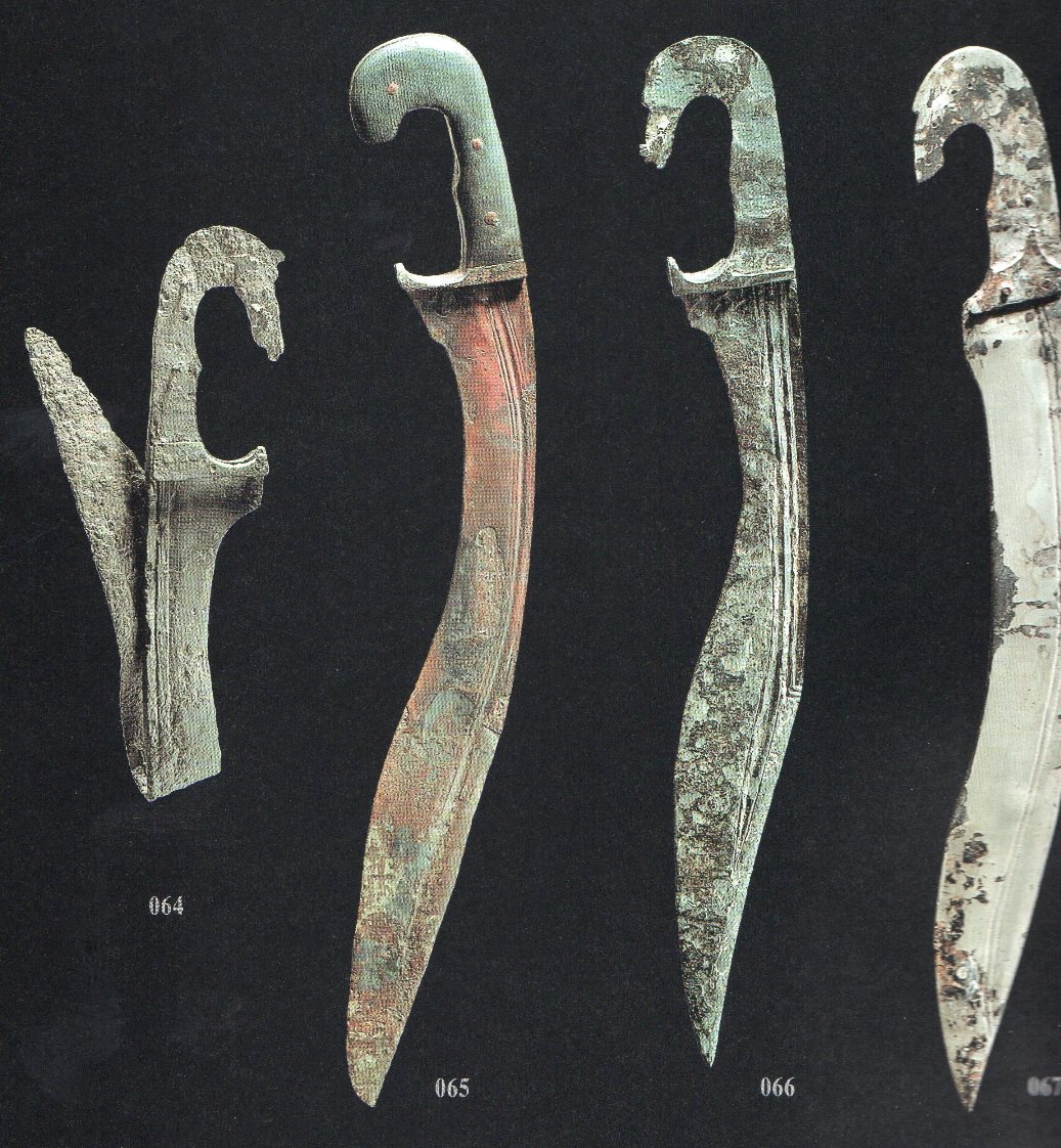

... Numerous findings of falcatas with horse-head hilts were also made in the actual territory of Spain...

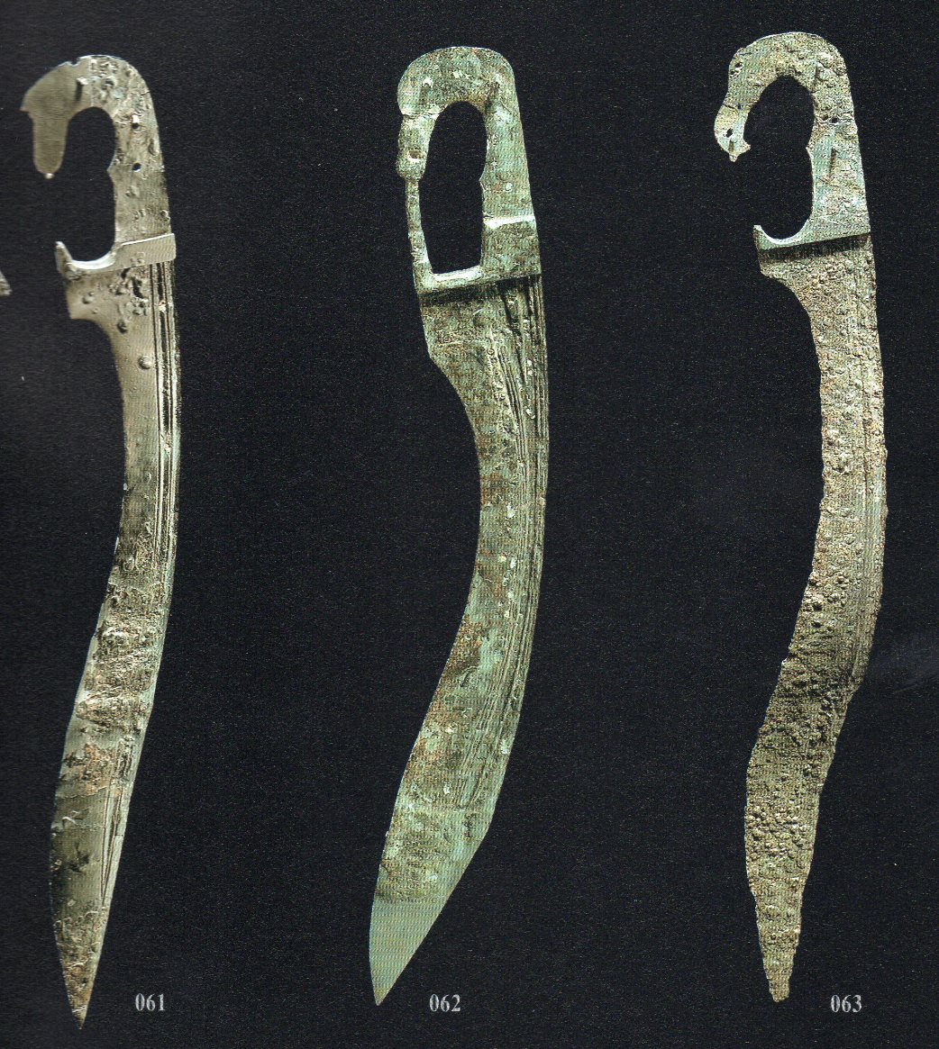

Horse head, bird head, undetermined grip, 'rectangular' grip without head ... Not only in Spain but in the whole Peninsula; there are currently dozens of sites with an excavated panoplia of these weapons and their paralel tipologies; i have seen (and saved) papers with enlightening charts.

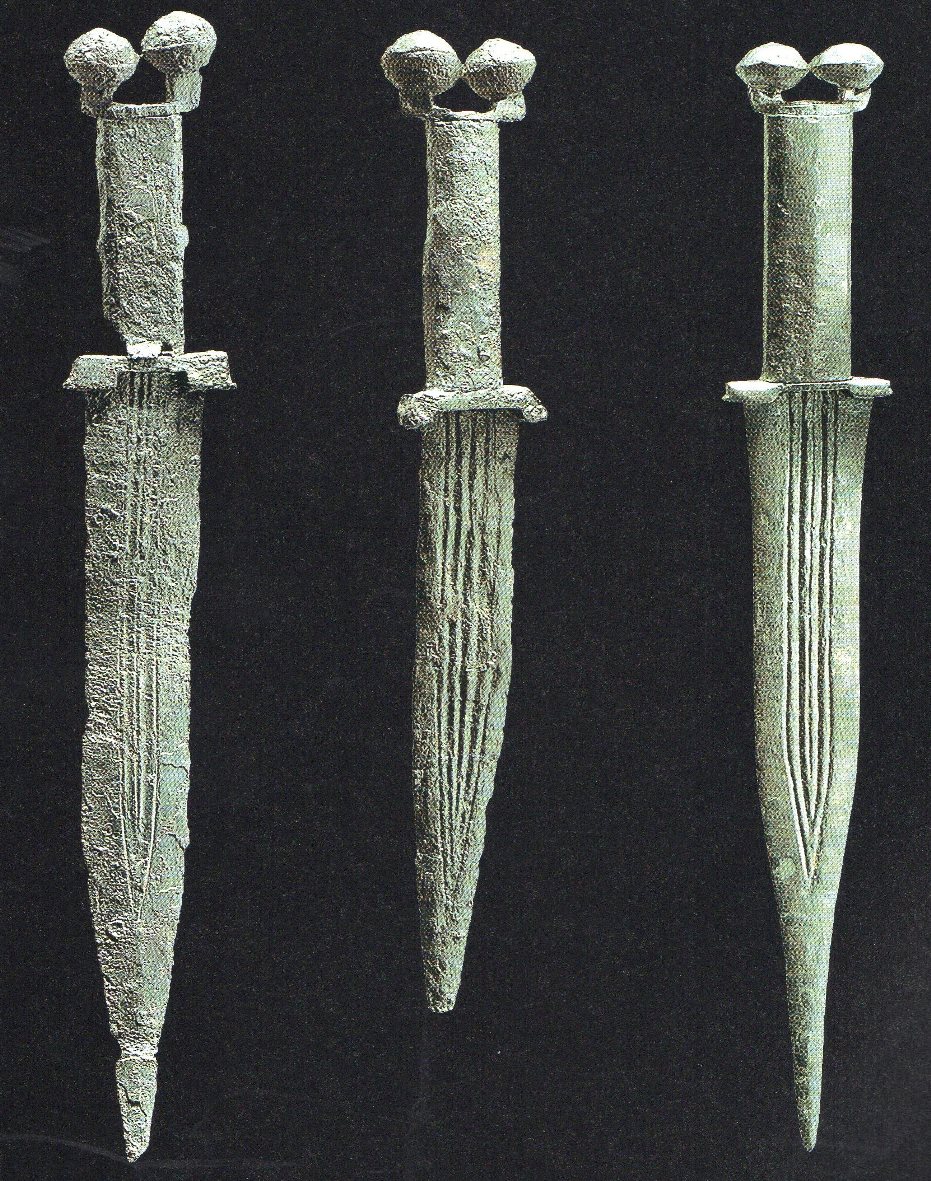

... And i happen to have been offered a catalogue of a collection auctioned in 2003 with an outstanding set of these swords in exceptional conditions.

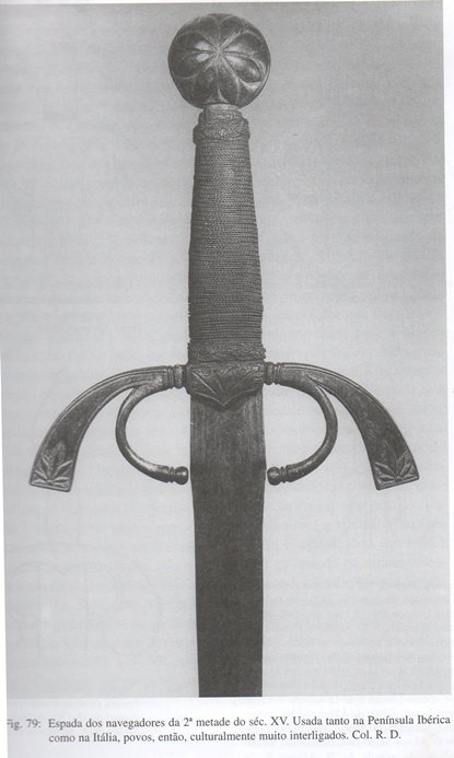

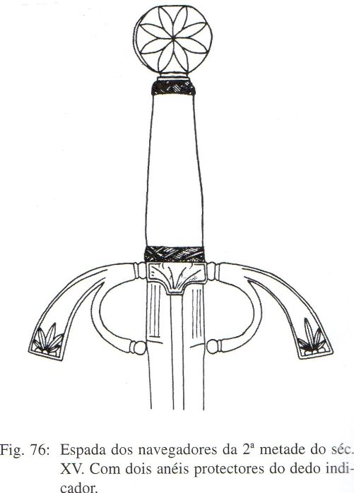

...I lack of bibliography on Portuguese swords. I would like to see those with knuckleguards from the first half of the 16th Century, could you provide some examples?
Apart from the book i have been quoting, HOMENS ESPADAS E TOMATES, which is not only about such swords, and with all possible tagging implausibilities, i only know of another one called AS ARMAS E OS BARÕES by Eduardo Nobre, where also attributions may be discussable, on what touches the origin of swords being either Portuguese or Spanish; a common imprecision due to both countries interculture, namely or specially on what touches these weapons. That's why some authors prefer to attribute these swords the title of Iberian.
If you browse the search button of the forum under AS ARMAS E OS BARÕES it could be that you find a few pictures i posted of Eduardo Nobre's collection with contextual detail references.
... Plus the details i have already passed you on my half dozen examples. Did i also pass you their pictures ?
Agree. M. Fulgosio invented the name in 1872. Of course, also Lusitanians used the falcata. Though I am more adept to the explanation about their origin given by Fernando Quesada Sanz in his book on the subject. I personally don't believe in the Greek origin.

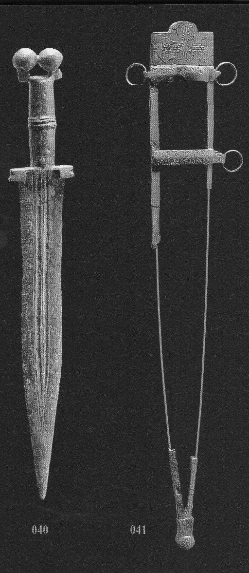

I am happy for you!!! I never thought that you were ignorant on this matter, neither tried to imply it. If I gave you this impression, please accept my apologies.
I only have the book from Quesada and some articles. You should share!!

What I meant is not that the Lusitanians didn't use or had knowledge of the falcatas, but that the Portuguese in the 16th Century didn't even know the falcatas, since they were buried for more than 1,300 years. So, how it was possible that the hilt features of the falcatas were passed by the Portuguese to North Africa in the 16th Century or the 17th-18th Century!!!
Thank you for the references. I have Hombres, Espadas y Tomates (only text, no images), but not the other book. As you know, I was absent from the forum and many interesting threads are unknown to me. I will search inmediately. But of what pictures are you talking about? Do you mean the photos from the book above and from Antonio's Page?

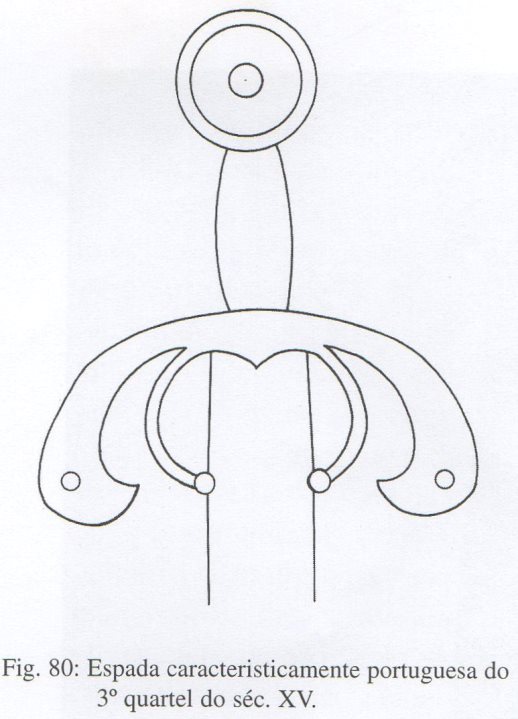

Details from photos of paintings of Nuno Gonçalves (court Portuguese painter, 15th Century). The swords seem more akin to the Spanish ones. I wonder if the black sword, more differentiated, was exclusive of the colonial enterprise. Or if the differences were because one was a dressing sword and the other a fighting sword, or just because one evolved in time into the other. The details come from the portrait of Saint Paul and the Saint Vincent Panels:

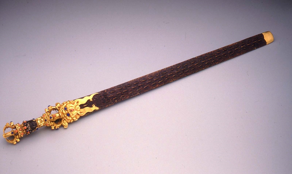

It all appoints to my eyes that, Captain (Pinhão?) is holding a military Portuguese sword. Some 'hollow' in the upper section of the guard in the faded carving (or picture), impeaches to even guess it is a military cup hilted one.
Yes indeed however the sword I bring notice to is lying on the ground straddled by the Portuguese Officer but I welcome your remark upon the Portuguese weapon. Regarding the other sword ...on the ground... which is I suggest the battle version of the KASTANE though without quilons and with a straight guard and no knuckleguard ; a few points.

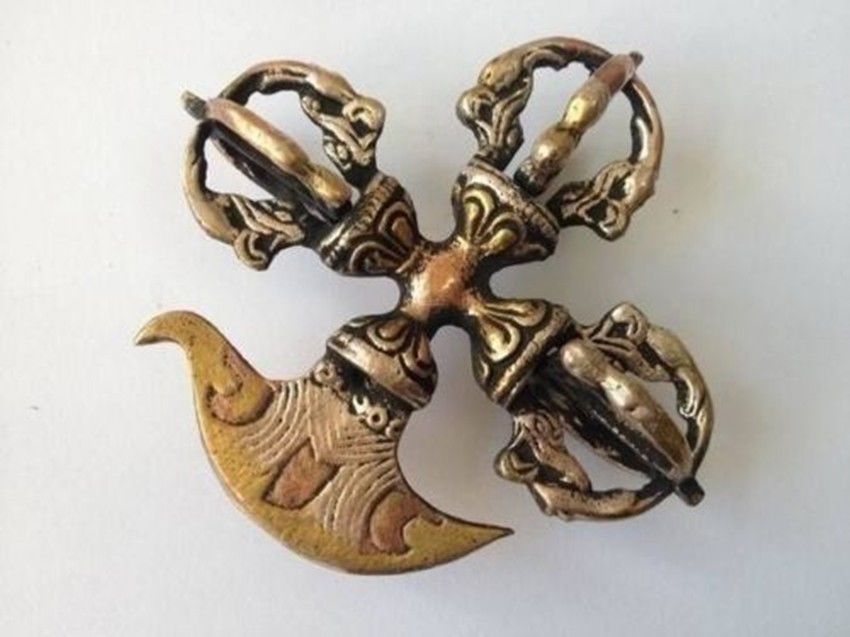

My question to you is why would a battlefield weapon, then, have the style of quilon seen in later Kastane? ...Swords which were clearly weak bladed and which had no fighting practicality but were in fact badge of office tokens... or Icons awash with Buddhist designs..
Surely a religious Icon like the hilt, the peacock tail rain-guard, the other zoomorphic creatures and the very important religious architecture of the misnomered "quilons" or thunderbolts..."the Vajra" ...be placed on a battlesword when they were so revered in Buddhism from the very beginning... The Great Buddha himself carried the Vajra to Tibet; It would not be placed on a blade...on a battlesword... Thus I point to the Kastane Quilons in the bling badge of office version as misplaced and misnamed by European experts ...but very real as religious architecture.

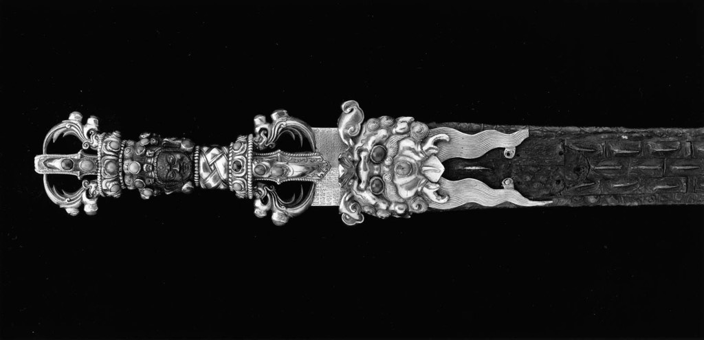

To be precise I would have to show an earlier Tibettan sword with Vajra Quilon architecture illustrating my point.
For that I refer to the Boston Museum of Fine Art for the 14th Century Khadya Tibetto-Chinese sword with Vajra styled Quilons acting as they are designed ... as thunderbolts ...and in the pure sense as religious Icons.
Please see http://sword-site.com/thread/1018/tibetan-sword-khadya
See also http://www.vikingsword.com/vb/showth...680#post218680 where I have updated details in that thread and for comments.
and below with a reminder of the Vajra cutting device added;

But now, this more military-style men carry the more classic black swords (same panel):

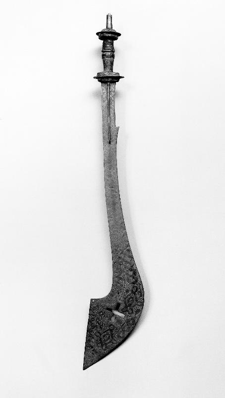

Hoping that Ariel doesn't get upset for this diverting on his "Jineta/nimcha/kattara" topic ... .
This one, from the same collection, reads:
"Sword of a Benin sovereign, in the Costa da Mina, XVI-XVII centuries. The iron blade, with the brass inserted christian cross, has a classic shape, already seen in Pharaonic tumbs. The guard is of Portuguese influence, with two protection rings for the index finger, forming a protection bridge decorated with the face of a Portuguese. The grip shows infuence of Cingalese armoury, certainly brought by the Portuguese fleets ".
The sword basic form is Benin African tribal see below and at http://www.egyptsearch.com/forums/ul...c;f=8;t=008949 probably with a Storta hilt... I can see how this may have been rehilted by the Portuguese dominant in the region but I think it premature to link the hilt with the Sri Lankan examples on Kastanes... On your reference this is a European Lion.
Benin Sword below.

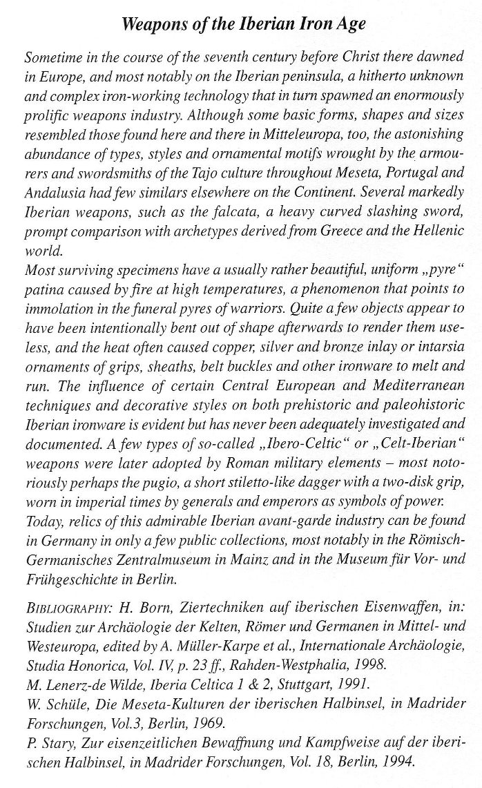

... Agree. M. Fulgosio invented the name in 1872. Of course, also Lusitanians used the falcata. Though I am more adept to the explanation about their origin given by Fernando Quesada Sanz in his book on the subject. I personally don't believe in the Greek origin...

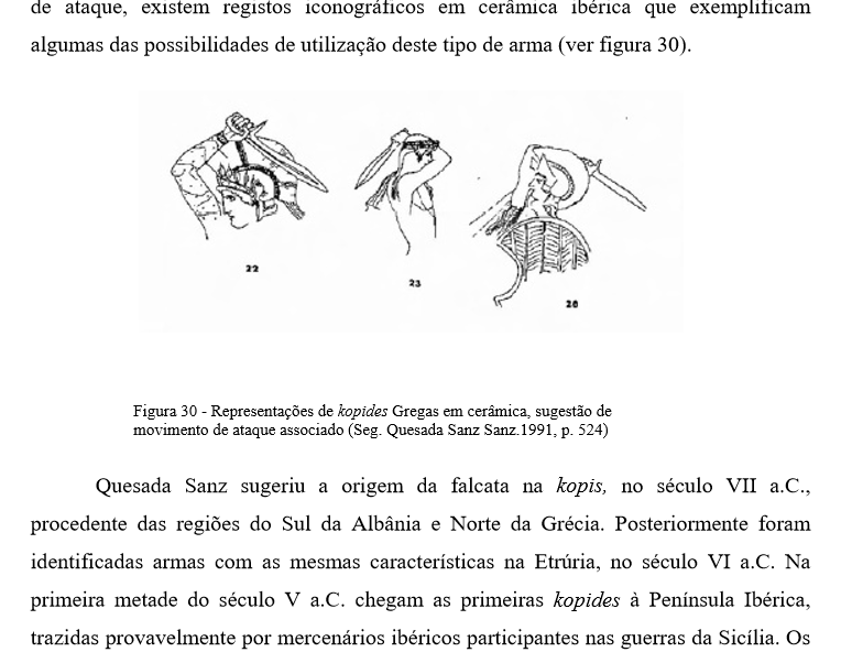

This article i have by Leandro Saudan Tristão is largely supported by Quesada Sainz works. I have not read of any evidence other than that of his Greek origin theory. He is so keen in illustrating Greeks handling Kopides and mentioning their introduction in the Iberian Peninsula (V AC), brought by mercenaries who have participated in the Sicilian wars. But of course i don't make a case, my knowledge is residual.

... I only have the book from Quesada and some articles. You should share!!...
Try https://run.unl.pt/bitstream/10362/7...insular%20.pdf.

Old 1st August 2017, 02:53 PM   #76
... The sword basic form is Benin African tribal ... I can see how this may have been rehilted by the Portuguese dominant in the region but I think it premature to link the hilt with the Sri Lankan examples on Kastanes... On your reference this is a European Lion...
Benin origin as said by the author. My imagination drives me to realize that, following the practice had with the ivory and bronze objects from Benin, seen in the best musems out there ( Met ... British ...), in that those speechless artifacts were ordered by Portuguese navigators to bring home to those interested noble and wealthy, it could well be that such sword blade was hilted (not necessarily rehilted) by a local smith under Portuguese 'customer' instrutions and the setup brought directly home. I fail to see the logic of the loop Around Ceilão, as suggeste by the author/owner. The face of a Portuguese in the bridge is rather plausible, as entire Portuguese soldiers, with crossbow, musket and all, were featured in bronze miniatures and ivory salt cellars.
Quesada mention another origin, based on a Italian-Mediterranean model, anthough he analyses the Greek hypothesis. Please see Fernando Quesada Sanz, Arma y Símbolo: La Falcata Ibérica, Instituto Alicantino de Cultura Juan Gil-Albert, España, 1992. I have only a photocopy that a friend from Spain sent me. You can also download this two pdf's by Quesada Sanz:
En Torno al Orígen y Procedencia de la Falcata Ibérica
Máchaira, Kopis, Falcata

I confess that, reading this document i posted and the fraction i uploaded with a ceramic work in which Greeks are rehearsing an atack with swords visibly the type of the Kopides, my non scholar interest was satisfied. Needless to say that the Helenic origin theory is also embraced by other sources; i don't know if inspired by Quesada Sanz. In any case and quoting again the work i linked, we may read that Sanz mentions also as origin Souhern Albania and the Etruscan lands, here spotted a century later. Whether this type of weapon originated in Northern Greece and travelled to those other places, after all no so distant from eachother, is a riddle i will leave for academics endeavour.
... BTW ... perhaps is time to pack bags and leave this thread follow its original path . .
It is true that this thread was launched in 2008; it continued with its original topic being discussed untill 2011; and then it went frozen untill now. Perhaps it is no crime to give it a new stretch, even admiting that the intrinsic sense of the original topic may expand to a determined liberty ... which we may baptize as "side topic" material.
I will start by uploading pictures of the falcatas from that catalogue i have previously mentioned (and as already requested by Gonzalo) and later will add to this post some considerations introduced in such catalogue, about the Weapons of the Iberian Iron Age, written by authors other than those quoted by Gonzalo, but which approach, even admitedly outdated, seems to be worth to consider.
In a next post, i will upload further pictures of the same catalogue, in order to help me raise some empirical crazy questions about the turned quillon saga.

As i see it written out there, the falcata Iberica may not go without its counterpart, the La Tene type sword, an inheritance of the Halstadt period, with its 'antena' grip evolution. It appears that either style found its location in different parts of the Peninsula, apparently due to their distinct migration directions.
When discussing which of these two types was used by the famous Viriato, a Lusitanian tribal warrior that dared to confrontate and managed to significantly delay the Roman invasion, conclusion would be that he used mainly the La Tene (a model with a straight blade in opposition to sickle shaped falcata), a style that pleased the Romans, to the extent that they adopted it for his weaponry equipment, calling it Gladius Hispaniensis (they called Hispania to the whole Peninsula).
We know that all this is of common knowledge, even boring for a connoisseur like Gonzalo; however my reach atempt is another, one that goes beyond common sense, that still i dare put things in a different angle; not academic or scholar, only empirical, certainly closer to insanity. When i collected coins i acquired a couple ancient Indian coins, dating back to many centuries before Christ. This took me to browse on the origin of money currency; well i found two locations running in the same championship, the author saying that maybe one didn't copy or picked the idea from the other. They happened to simultaneousy felt such necessity, and so they went ahead minting coins, one not knowing about the other. I don't recall the exact details, but the moral of the story is what matters here. Sword guards, quillons, curved quillons, extremely curved quillons; what precisely were they for ... blade catchers, finger defences, adornments, religious symbols, scabbard adjustment implements ? And why have they been necessarily copied from the neighborhood or remote domains ? I know this is a subject that gives reason of existance to scholars, but for those who fancy simpler explanations, perspectives arise that switch another kind of complicometer, that of an ignarus. Look at these Iberian antena swords from the Hallstatl period, VI to V century BC. Aren't those quillons on their guards ... even down turned, although of reduced dimensions ? And, for a couple seconds, compare them with those of the Omani Kattara. I know i must be out of my mind, but ... how in hell those Iberians (whoever) cared to apply such things in their sword guards ?
