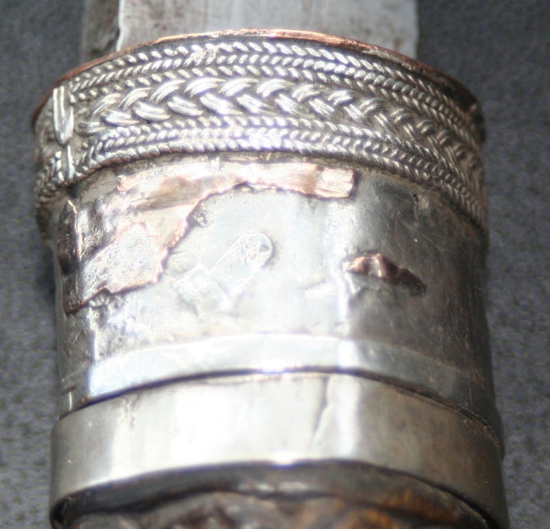

Old 31st July 2017, 09:15 AM   #2

Posts: 445
Default close ups
Kai, here you are. Not the best photos in the world but I think you will see whay I say there has been some "removal". I am sure there are traces of suassa remaining.
Roy

Old 3rd August 2017, 06:28 PM   #18
Hello Roy,
Thanks for the close-ups!
Yes, it looks like a band of suasa that mostly got rubbed off, indeed.
There also has been some patching of the silver underneath and I was wondering whether also the suasa was patching: Looks more like an additional band though - possibly a quite early upgrade.
