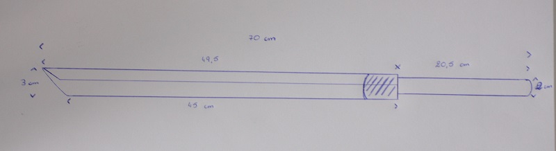

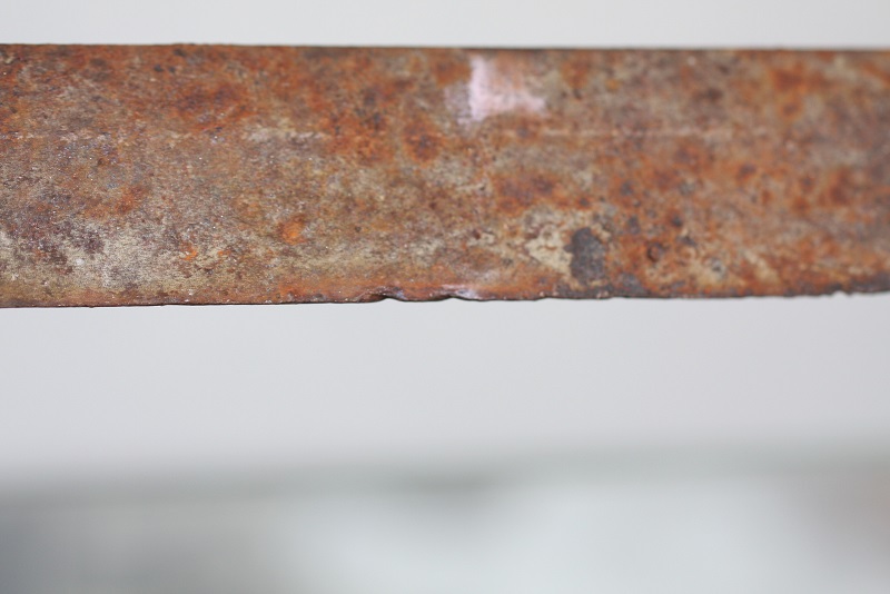

Hello everyone,
recently acquired this japanese blade (I guess), if you have any info about it cause it's clearly not my chosen field. From seller this blade come from Indochina and bring back his grand father in early 1950's.
I join schema of the blade with any measure of the blade.
70cm: 27,55 inch
49.5cm: 19,29 inch
20.5cm: 7,87 inch
3cm: 1,18 inch
2cm: 0,78 inch
45cm: 17,71 inch
Clement

It does not look Japanese to me. While it does have some Japanese characteristics like the habaki the straightness of it and the geometry of the blade look like it may have been made in imitation of Japanese swords. This is not to say it is a fake, just influenced by Japanese swords. I have been told by people who are knowledgeable on these subjects that Japan exported a lot of swords so perhaps someone copied from that.

I dont know what thinking about this blade, don't have the mekugi ana , no yokote !?! But curiously I got a good feeling, I think it's not recent copy .

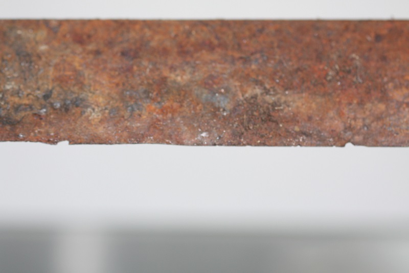

Bonsoir Clement,
this blade is in pretty bad shape and definitely needs lots of TLC (tender loving care)! With all the details hidden under thick, active rust, hardly anything can be commented on...
The Japanese sword tradition is very picky regarding the condition of the blades; I believe this one is beyond rescue and will fall into the relic category after any restoration. OTOH, this means that you can hardly make any serious mistake with any gentle restoration attempts. While sword tangs usually never get cleaned, I'd suggest that you clean the whole piece - any remaining rust is likely to compromise future preservation.
It is well possible that this is a local imitation - there were Japanese expat communities (especially traders and mercenaries) in Viet Nam and many other SE Asian countries.

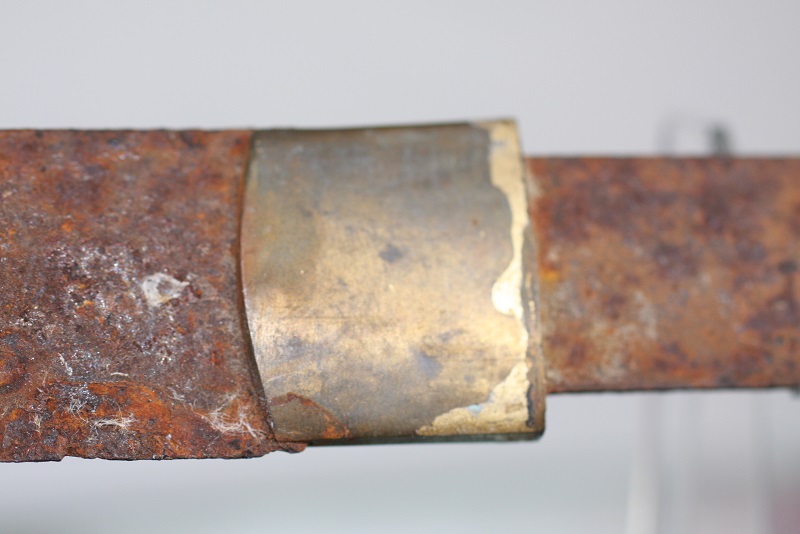

P.P.S.: Try to separate the habaki from the iron blade as soon as possible and process them separately afterwards...

In the close up of the habaki it looks as though the blade lower edge at the hamachi runs into a slot in the habaki rather than being coned by it and resting on the machigane inside the habaki. Not conclusive but does point to a non traditional Japanese blade.

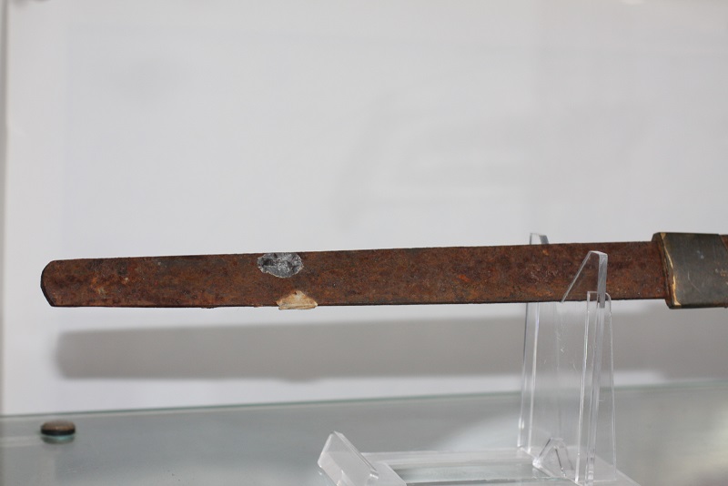

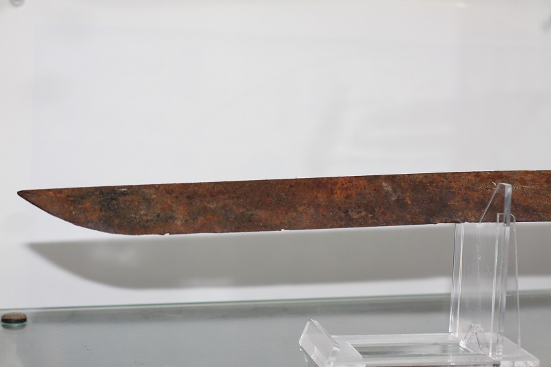

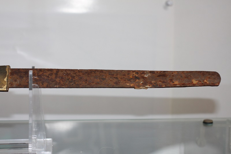

Superficially, it looks like a modern Chinese-made "ninja sword". Straight, 20"/50cm blade, tang a suitable length for mounting with a 12" tsuka/hilt. The habaki looks very much like those used on modern Chinese-made katana (and ninja swords).
However, if it's from the 1950s, this isn't what it is. Also, the details of the tip are not like the modern Chinese-made ninja swords.
The tang has no hole for a pin, so it hasn't been mounted Japanese-style. It's either been left as a bare blade or was mounted with the tang glued-in, SE Asian style rather than Japanese-style (pinned). If it was mounted, why is the rust so uniform? So maybe never mounted.
So, some speculations:
  • Modern Chinese-made ninja sword blade, never mounted, artificially aged - unusual for the tip to be modified in this kind of fakery
  • Old SE Asian ninja sword made for tourist sale c. 1950 - the habaki looks very modern in style; the old SE Asian (mostly Indonesian?) replicas/fakes used different styles of habaki
  • Old SE Asian imitation-Japanese cane/stick sword, c. 1950 - habaki is still a bit of a mystery
  • Old Japanese cane/stick sword, age inconnu - AFAIK, these would usually have been pinned. Maybe some were glued.

Unfortunately I think Timo said all about this blade, this is probably a copy !

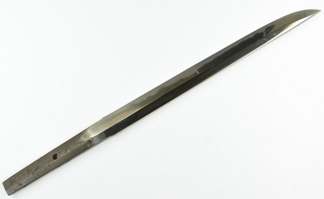

I agree, definitely not a real nihonto (Japanese sword).
For comparison, a picture of the blade of a 14th century Kikuchi Yari, greatly shortened to be mounted as a tanto (dagger).
