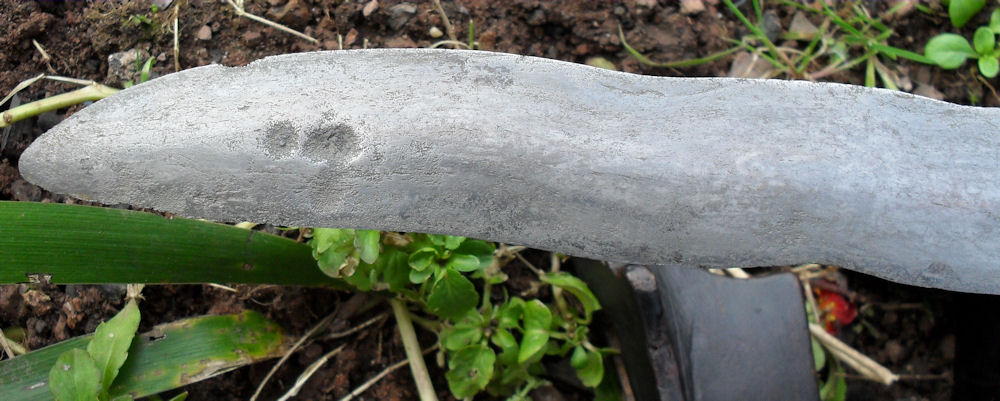

It is know as Keris Picit when dealing with keris. AFAIK this is a genuine technique that was used a relatively select few keris of talismanic nature. It is also an often faked technique and i am afraid that in the end, after we make all the educated guess that we can make, it ultimately comes down to a matter of faith as to whether or not we believe that these impression were made with bare hands. Personally i believe that i have a few actual examples of the technique in my collection. However, it does not seem to be a particularly superhuman feat. After all, the fingers don't need to be held to the hot, soft metal for very long and i would imaging that well calloused fingertips, possibly with some sauve applied, could do the job without much actual damage to the hand. Think about fire walkers who walk through a field of hot coals. This also isn't magick, just quick movement and a bit of faith in one's self.
I can't say i have seen any contemporary attempts at this, unless they are ones made to be aged to deceive. I believe all my examples are later than Mojopahit and are not in the Buda form. Probably more likely 16th and 17th century.
I am afraid that my damnable logic and common sense demands that i relegate the Mpu Sombro story to that of legend, as intriguing and engaging a story as it might be...

These pijit marks do not, in my experience, occur on keris buda or keris majapahit (keris sajen) forms, they occur most times in keris sombro, and very, very occasionally in normal keris.
I cannot recall having seen picit marks in anything other than keris.

Richard, you're 100% correct about never being able to see it.Keris pijit that are accepted as genuine all come from the very distant past.
I've seen genuine things in Jawa that are totally inexplicable, not parlour tricks, but manifestations of powers that cannot be explained with reason, nor logic.
Bear this in mind:- by profession, I'm an auditor. Not a bean counting auditor, but an auditor who deals in areas involving subterfuge, confidence tricks, and other rather interesting things. By nature I'm a sceptic, and better than 50 years in my profession has made me even more sceptical.
Knowing Javanese culture as I do, I am prepared to accept that keris picit could have in some cases been made in a similar way to the way I experimented with. The ones that we accept as genuine are in all cases paper thin sombros, or similar.
I do not believe that it would be possible to actually forge a blade by finger pressure, or by hitting with the hand. I see this as the mixture of myth and reality that is perfectly normal in Jawa. It may be culturally real, but that does not make it fact.
The empus of the distant past were akin to shamans.
They were in some cases, nothing like the current crop of people who can make keris.
Rick:- yes, of course, and the vast bulk of "keris pijit" are the result of coming into contact with something like a ball pein hammer. But there are a very few that we do accept as most probably real.
However, nobody needs to believe that they're real. Its all a matter of how you measure something based upon experience.

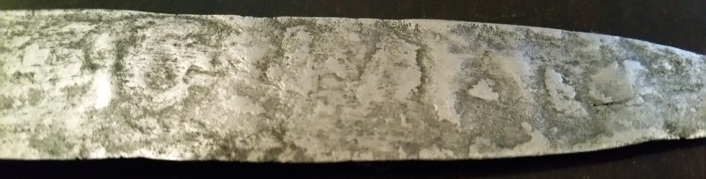

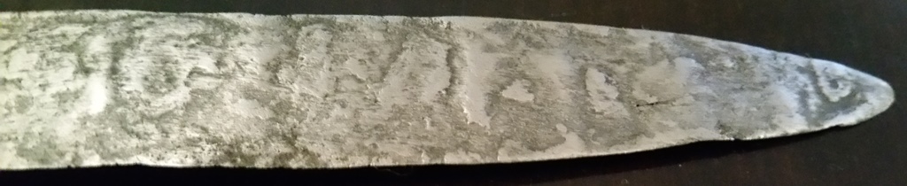

Old 5th March 2012, 11:18 PM   #11
IN THE KRIS MYSTIC WEAPON OF THE MALAY WORLD BY EDWARD FREY PAGE 10 ARE SOME PICTURES OF FIGURE D AND FIGURE E. THEY MAY BE EXAMPLES OF THIS TECKNIQUE BOTH ARE ARCHAIC KERIS.
I INCLUDE TWO PICTURES OF THE MORO KRIS BLADE THAT GAVE ME THE IDEA OF ASKING IF THERE WAS ANY KNOWLEGE OF THIS TECKNIQUE / STORY APPLYING TO ANY OTHER WEAPONS BESIDES THE KERIS. THESE MAY BE PITS BUT THEY APPEAR TOO UNIFORM AND THE REMAINDER OF THE BLADE LOOKS CLEAN . I WAITED TO USE THE PICTURES UNTIL THE TRANSACTION WAS FINISHED IN THE SWAP FORUM.
FROM WHAT HAS BEEN SAID BY THOSE OF YOU WHO HAVE FORGED AND EVEN ATTEMPTED THIS TECKNIQUE IT WOULD APPEAR LIKELY A TOOL IS USED PERHAPS SHAPED LIKE A FINGER. IT DOES MAKE ONE WONDER WHEN THE STORY CAME INTO BEING.
Old 6th March 2012, 12:23 AM   #12
Posts: 7,303
Barry, i saw this kris up for sale, but never for a second thought these indentations were formed at the forging. Their placement does not give that impression. I would be more likely to buy into a story of possible damage from bullets before i would think the former.
As for the possibility of this technique being possible with the fingers i have little doubt, though obviously many examples that we see are not done that way.

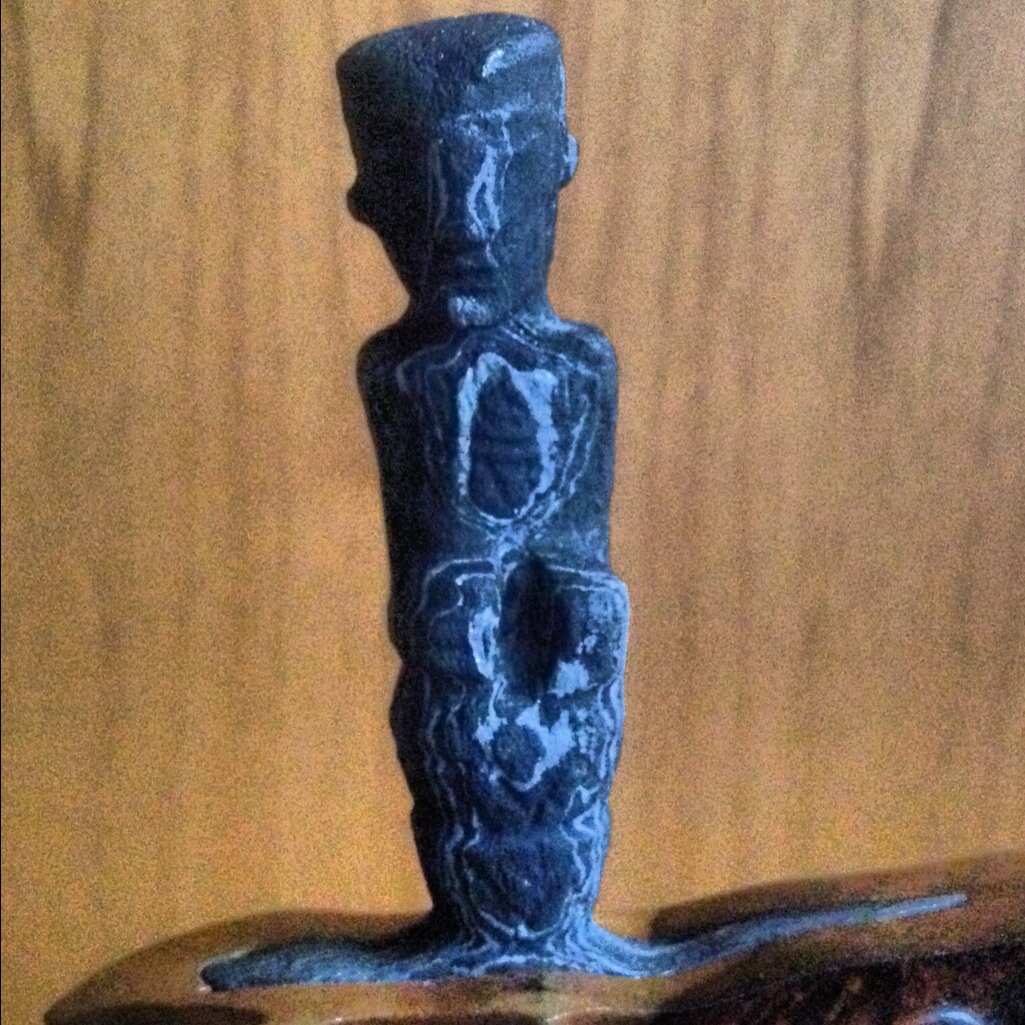

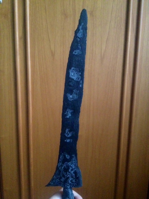

Genuine paper thin blades with finger pressure markings or what we call Sombro nowadays should have 9 finger pressure marking, no more no less. Most of blades are supposed as tangguh Segaluh and Pajajaran have 9 luk, I myself do not know why should be 9, Anybody know about it? I share some photos of keris Puthut with 9 finger pressure markings. Indentation from pressure markings occured on every pamor wulan-wulan and also Puthut figure seems very artistic, it was as though the pamor gives the detail appearance of Puthut itself.
Karttikeya is offline   Reply With Quote
Old 14th March 2012, 03:56 PM   #14
Posts: 7,303
Interesting keris Karttikeya. I am somewhat confused by you use of terminology. I have never heard this type of keris called "puthut". AFAIK that term is reserved for keris where the figure is at the gandik, not the hilt. I would probably call this a keris sajen or perhaps simply a talismanic keris. Also, AFAIK, not all keris Sombro display pijit, finger indentations. They also do not have an integral figural iron hilt like your example. I am also confused about your claim that "genuine" keris pijit all have 9 indentation marks. I have at least two examples which i would consider to be genuine. One is a what i know as a keris puthut, the other is what i know as a keris Sombro. The Puthut has 5 indentations, the Sombro has 3. I cannot see the indentations on the photo of your example due to the angle of your shot. I have a hard time, though, picturing 9 indentations on what are generally very short blades.

Well Karttikeya, that's something new I've learnt!
I rather think a lot of people don't know this information.

I understand your confusion. In the old days this kind of keris would be called "keris sajen" or "keris majapahit", but I reckon recently a new terminology arise and call it as "puthut sajen" or "puthut" in sort, due to it's figural, one piece handle. Another term is "puthut cundrik" to call this kind of keris with dhapur cundrik (a kind of pedhang suduk shape). Sometimes it's confused with sombro.
An 'old school boy' like you may get "lost in terminology" nowdays in Java keris world

This is undoubtable true and i certainly make no claims to be up on the latest keris lingo in the Jawa keris world. Not sure that is really possible from half way around the world though.
So if the above type of keris is nowadays referred to as Puthut Sajen, so be it. I am curious what the actual meaning of the word "puthut" is. Can anyone assist there. I have always understood it as a praying figure while i have looked upon the sajen hilts as ancestral figures, which may or may not be the same thing.
Still, i am doubtful that even the current keris world in Jawa would call Karttikeya's keris a Sombro, would they? And i still question that a keris pijit need have 9 indentations to be considered genuine.

[QUOTE=A. G. Maisey]
In Jawa there are consistent legends about forging a blade by use of hands alone. I think these are legends, but the legend comes close to reality with the talismanic keris pijit, usually these are keris sombro with paper thin blades and they show indentations where supposedly they have been squeezed and indented by finger pressure.
Alan, I am curious to know if you would consider this keris as pijit. The blade is very thin and flexible towards the point. You can see indentations on both sides.
Dominique is offline   Reply With Quote
Old 19th May 2017, 07:25 PM   #26
Posts: 7,303
[QUOTE=Dominique]
Interesting subject.
Dominique, that is an interesting keris. And i very much like the hilt.
A keris picit (pijit, pecit, whatever spelling ) is so-called based upon what appear to be impressions of finger tip in the blade. You say there are indentations on both sides of this blade, but honestly i cannot see them in these photographs. maybe Alan's eyes are better than mine.
Maybe you could try a different angle for your shot. The high-relief pamor pattern on this blade does not make it easy to assess indentations if they are there.

I know, it doesn't look like finger tips, but there are slight indentations, the blade is not flat. I would need to make a pic of the blade profile.

Difficult to make good picture, but you might see with these pictures that the blade is slightly ondulated.
Old 22nd May 2017, 01:56 AM   #30
Posts: 6,441
Can we see the blade photographed edge on to see how it looks with that view?
