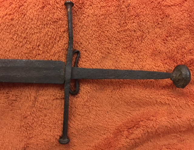

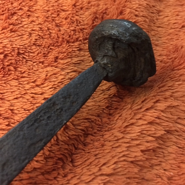

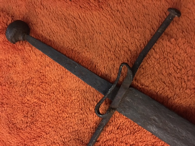

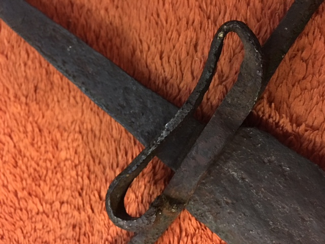

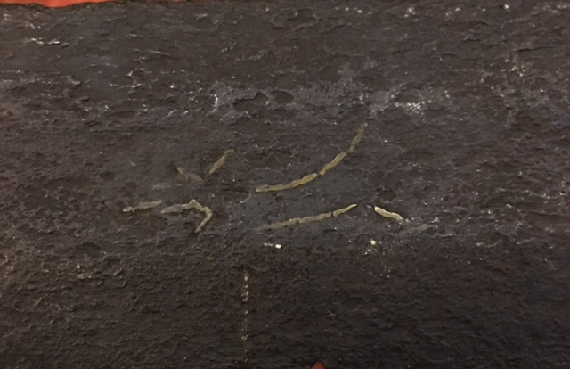

Hi I have not been here for ages ... recently got new sword or something what it was... any ideas on markings, Passau? This is not my area, but I know this item for many years and maybe I will get it for my collection... any comments

any photos of the whole thing? dimensions would be nice too. looks german side sword-ish.
bit of elbow grease and a new grip and she'll be almost good as new

Almost seven years, Damian. I was worried something wrong happened with you. Welcome back .
Probably one of our knowledged members will say something definite about your sword. Pictures of the whole thing would be important, as suggested by Wayne.

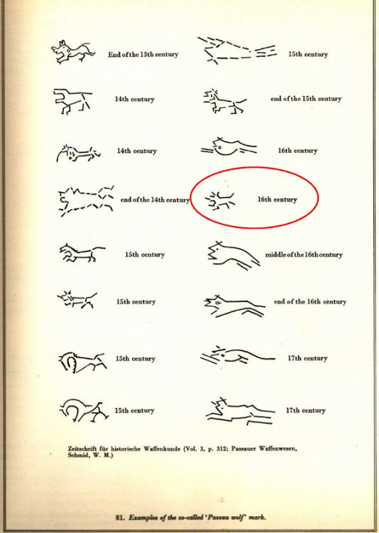

It looks like a great specimen! I agree that it is German, and might date to around 1530ish. The wolf-mark originates from Passau, but was already being copied elsewhere I think - in Solingen for example. There are two similar swords in Zurich that have a fairly similar "forked-cross" mark (but no wolf-mark).

Mark Thank You Very Very Much for reply and information, wolf is on one side while "forked-cross" on both. I will try to place some more pics tomorrow. The sword is in rusty condition and was at least 24 years on my friends wall (this is when I first time saw it) and inlays seems to be in gold while still a bit shiny.

Husar, great to have you back!!! It does not seem you were gone that long as I remember your avatar and name clearly.
Looks like a fantastic example, and even more so that it has been static for so long in a collection you know.
The latten markings are outstanding, and excellent input there Mark, with the chart and excerpts of examples!
This of the period being suggested by Mark in my opinion, and the running wolf is of course a Solingen issue of the Passau established marking. The chart from Eduard Wagner (1967) showing the running wolf variations is of course not a chronological development study, but exemplars Wagner had noted from various weapons he had examined and their approximate period.
The forked cross also appears a Solingen issue of similar markings used in Milan (usually with letter beneath) and paired with the wolf as quality or other imbuement.

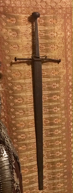

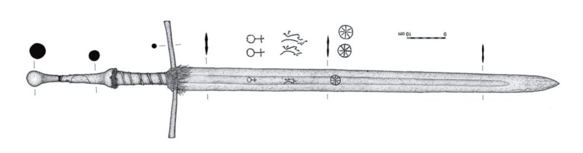

Finally I have found few minutes to take pic of whole sword, sorry not the best one I will try to make some in daylight tomorrow

Old 25th February 2017, 10:44 PM   #10
Reventlov
Join Date: Mar 2016
Posts: 146
Thanks for the photo!

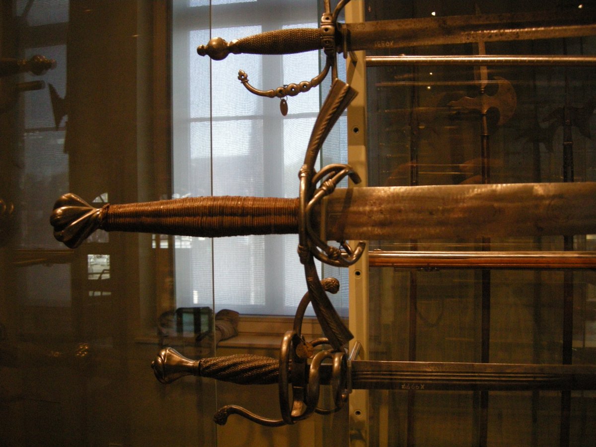

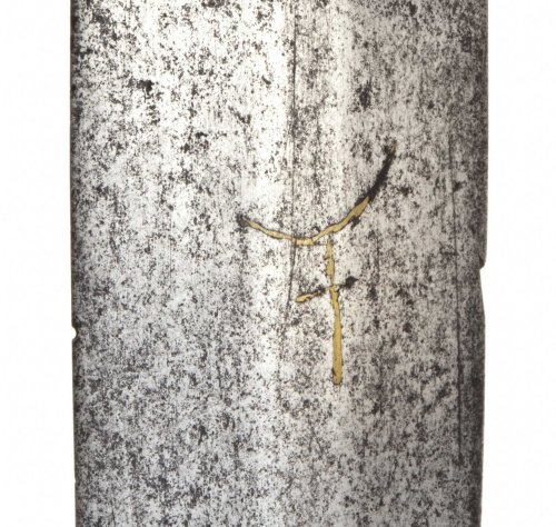

I've found another example of a "forked-cross" type mark for comparison, with a more curved shape that may be a little closer to your mark. The wolf appears again and is quite similar, along with an additional cross potent. This sword is in the Slavicin museum in the Czech Republic.
Hi mark,
can you tell where you get this Picture from, very nice T-pommel sword.
Iam not sure if the "forked cross" with the round base displays a splitted cross or a monstrance.
sword of post 1, it looks as though the blade is 50-100 years older as the hilt.

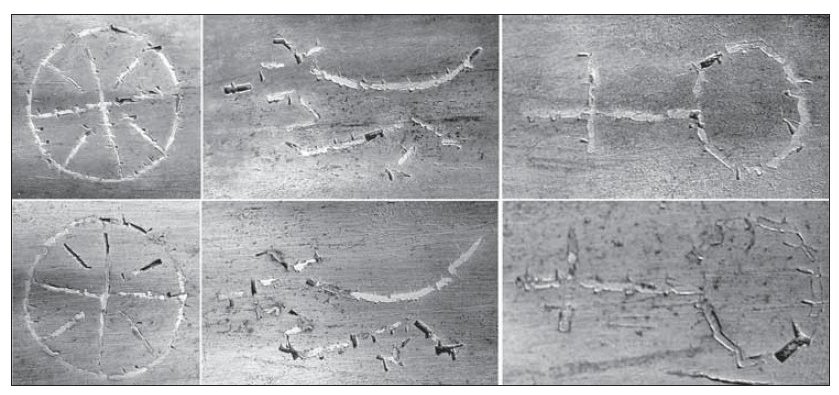

Hi Jasper, you are right - it is not really the same mark as the split cross. Have you seen a monstrance represented this way elsewhere?

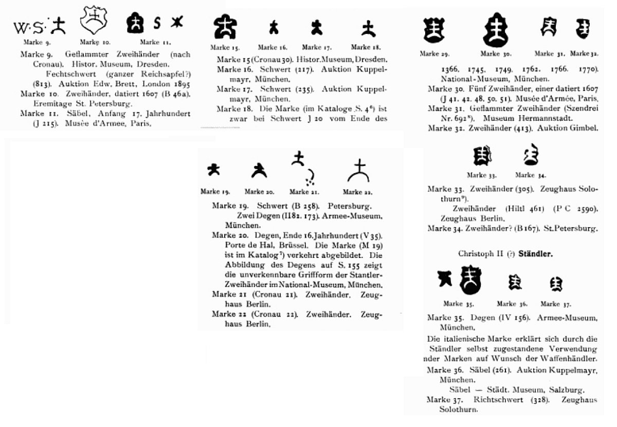

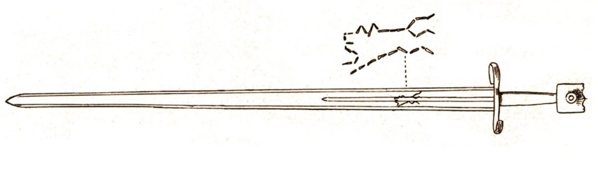

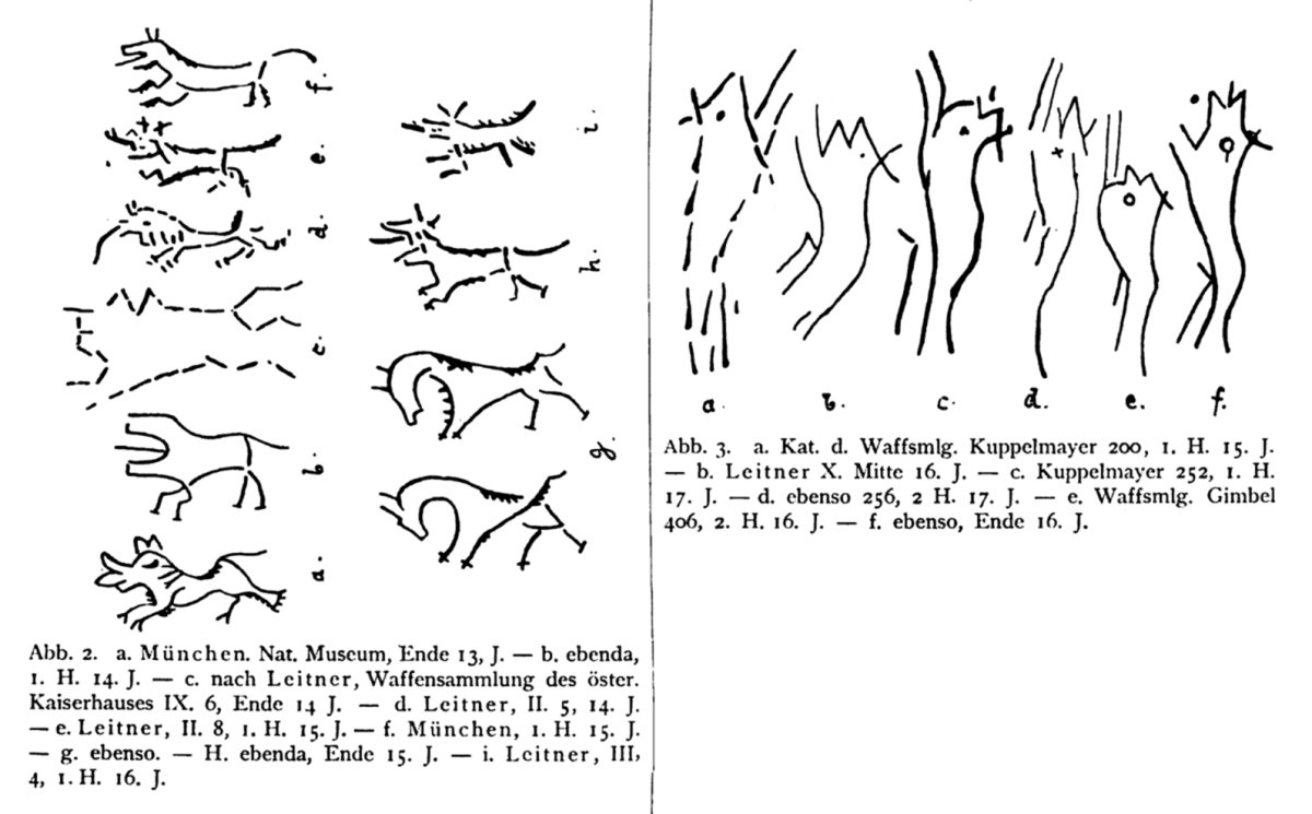

That illustration comes from an article by Petr Zakovsky, "Marked High- and Late-Medieval Longswords from the Collections of the Municipal Museum, Broumov", it should be available online. The text is in Czech, but there are other photos of swords with interesting markings.

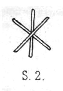

I've found an article in volume V of Zeitschrift für Historische Waffenkunde with many examples and variants of the mark, ascribed to members of the Stantler family. In the same series of articles I also came across what looks to be the original source for Wagner's table of wolf marks - but with more details as to location.
Finally, another example was sold by Hermann Historica, who erroneously describe the mark as an "imperial orb" while repeating the attribution to the Stantlers.
http://www.hermann-historica.de/en/s...6&currentpos=2

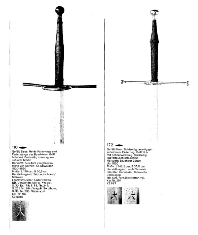

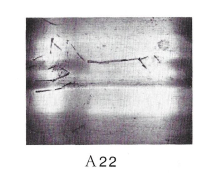

In checking Boccia & Coelho (1975) examples 320 and 321 are apparently marked with virtually the same running wolf, both are from Venice (but not the early schiavonas) and both c. 1535-50. As you have found this mark on blades from Venice , but period we may presume mid to late 16th, it does seem that a number of these blades had come into Venice in this period.
At this time I believe the Passau wolf (as it became known) had still been in use there (the Boccia & Coelho reference cite it as the Passau Wolf) in these times, and perhaps a number of blades had entered the Venice context.
It does seem that about this time, the wolf had become spuriously used in Solingen and these blades may also have been from there.
Whatever the case, the running wolf mark was not as far as I have found, copied in Italy, though other inscriptions and names may have been. Most important is to find a group of these typically loosely applied marks (many almost indiscernible) which are virtually consistent in form and in the same period and regional context.
Hi Jim,
Thanks for finding this, it is a very interesting example! I hadn't though to check this source since of course it focuses on Italian-made weapons. It looks like this is only one sword though, which is shown in the two photos #320 and #321. From what little can be seen in the photos, and from Boccia's description, I would not be surprised if the marked blade is at least somewhat older than the given date, which should refer specifically to the hilt only. The date range is no doubt correct for the latter - it is very similar to several swords owned by the emperor Charles V.
Boccia also illustrates one of the four schiavonas I was referring to: #167 in Venice. Two more are in Vienna, and then the illustrated sword above is (or was) in Budapest. These four have marks that are very, very similar. This new example in Naples (Boccia's #320/321) and a third schiavona in Vienna seem to have marks that are quite similar in style and technique, though less of a "perfect" match than the first four.
I agree! I've started finding some other examples that are more or less similar - but still the closest similarity seems to remain among this small group. So it seems believable to me that we are seeing the products from a common source, even a specific artisan or workshop, quite possibly in Passau, that arrived in Italy sometime around 1500 or shortly thereafter.

Here's another example of the wolf and monstrance marks appearing together on a sword in Frankfurt - very similar in style to the sword in the first post. I'm curious as to other members' opinions on the authenticity of the hilt however...
https://www.flickr.com/photos/980156...th/9244609491/
The wolf and the mark of a star are similar to those that appear on one of the other swords shown in the Czech article I mentioned. There seems to be another group that can be made here where the wolves are all very similar in form and technique, and appear in some combination with a small number of other recurring marks: the star, the monstrance, the orb, and possibly one or two others.
The wolf and star appear on sword number J.16 in the Musée de l'Armée, though I haven't been able to locate a photo of this one, or determine if the wolf is similar to the others. Does anyone know anything more about this sword?
