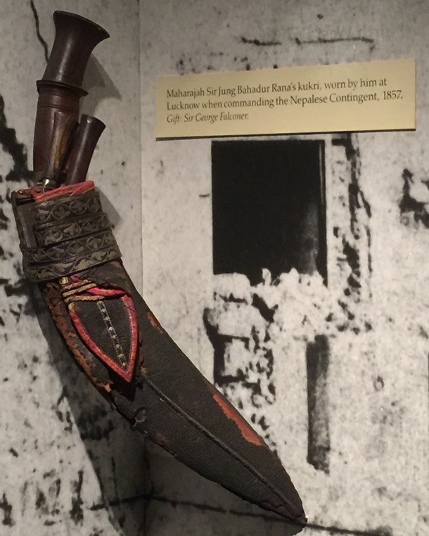

And the Hanshee/Goorkhali fighting kukri were undoubtedly used in battle, an example is Jung Bahadur Rana's kukri
