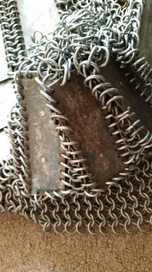

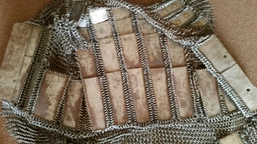

Ok guys wanred to share my newest aquisition to you! A full steel/iron moro armor! First time I've ever seen or heard one ever existed! Too bad it has been clean loosing the patina but impressive non the less. Weighs at 26.7 lbs. Have any of you guys come upon or heard of similar armor existing? Anyway thank you in advance for you opinions and enjoy! Ps underneath the upper shoulder plate I saw the original darkish rust patina I olso fold traces of carbon powder? Old casting?

Very interesting and thanks for sharing these pictures.
As you say, the armor has been thoroughly cleaned but shows relatively little pitting or damage from rust over the years. Unusually pristine and complete. How old do you think it may be?
Must have been quite burdensome to fight in at that weight.

I wonder if it might not be white brass rather than steel.

I'm thinking early 20th century. I'm thinking it's has been kept well away from the elements thus the minimal pittings. Forgot to show the front so here it is. As being wHite brass possible but the plates rust, so do some of the ring. I really am not 100% sure of the composition of the metAL but looks steel to me.

I think this was recently made, the Philippines is a very humid collection of Islands and just like Japan were they had to lacquer their armor to keep it from rusting away, there is a reason that Moro armor was made from horn and brass, to keep it from rusting away as well. I do not see any corrosion at all. I would not mind being proved wrong but even the seller does not describe it as being an antique. I have many images of these armors on my Pinterest site but none like this one. https://www.pinterest.com/worldantiq...d-surrounding/
Old Philippine Moro Heavy Chain Mail & Metal Plate Filipino Armor Philippines. vintage Philippine Moro Chain Mail Vest with Metal armour plates. As far as history I picked up this piece some years back at a local Southern California auction.

I am inclined to agree with your age assessment. The holes in the iron plates through which the chain mail is attached show no irregularity in shape as one would expect from corrosion over time--the holes are crisp circles. Also, the mail rings are remarkably uniform and free from corrosion. All this suggests recent manufacture to me.

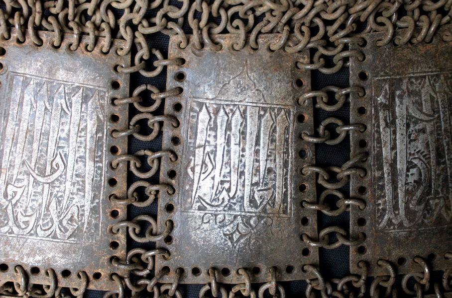

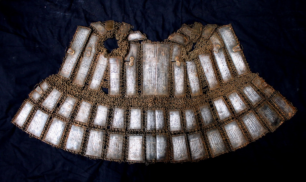

This is an intriguing example I came across some months ago, but Moro not being my an area of particular expertise I wasn't sure if it was truly Moro or not, especially with the iron construction.
ArmsAndAntiques is offline   Reply With Quote
A very interesting, non conforming armor, I have never seen a Moro armor with buckles and inscriptions like that, it shows real wear and age in my opinion. Possible a neighboring Muslim country like Indonesia, Malaysia etc.

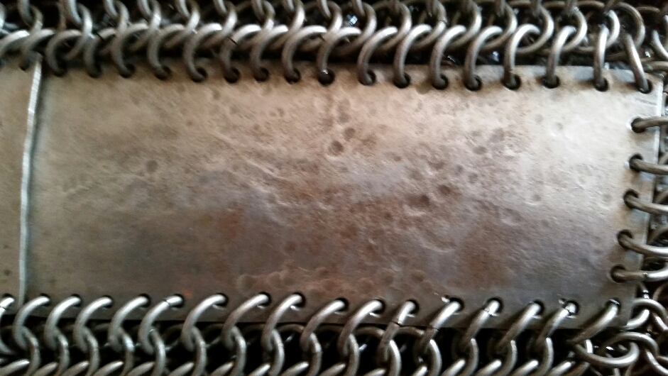

Looking at Bathala's Moro cuirass again, I'm wondering why some of the plates do look pristine whereas others are visibly pitted. And the pitting not consistent with corrosion, but rather impact-caused, with so many round dimples reminiscent of what a person could inflict using a ball peen hammer with blows of varying intensity. Çan't help but notice, also, that those chain-mail rings look like they were made of machine-drawn wire, way too "industrial" in appearance, and free of wear or any past corrosion. Isn't this a bit incongruous for an ethnographic object made by hand with rudimentary tools, in a damp tropical milieu in which ferrous alloys corrode readily over time?
Old 7th September 2016, 09:52 AM   #11
Posts: 4,281
...and they appear to be butted rings.
biting the bullet to expose the elephant in the room, it looks very new. cool tho.

The perfect consistency of the wire rings and identically round holes without wear on either component alone tell me that this is not very old.
But the "pitting" on the plates is hammered texture.
Regardless of age, a fair amount of handwork went into putting this together. It just is not very old.

I lean toward modern made to look more like Maranao style.

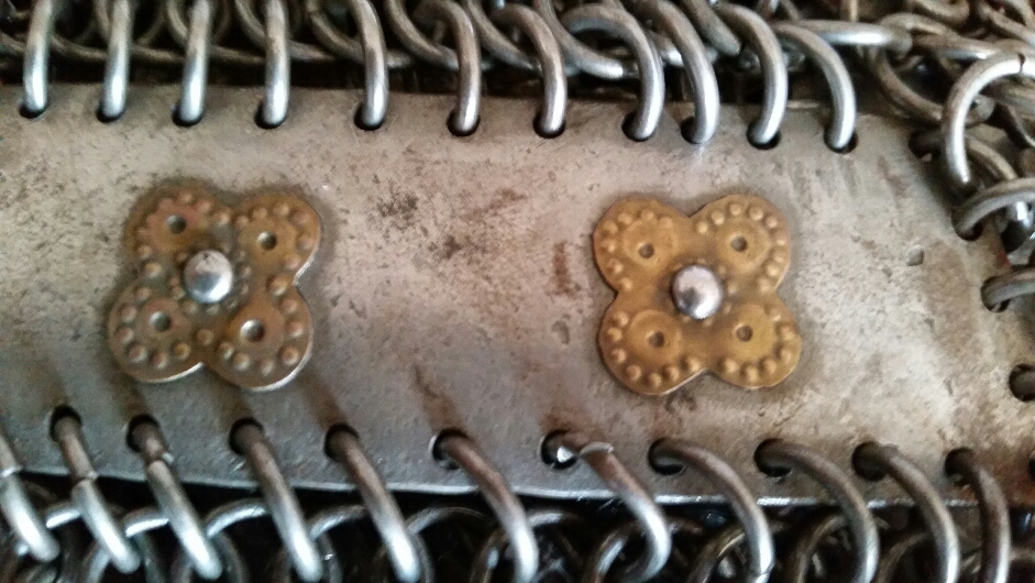

In addition to issues already made, I noticed that the decorations on the copper plates are in more Luzon style, not Moro.
Also the catches are not traditional or correct for traditional Moro work.
Great modern work though!

I think you are hearing consensus that this is an interesting, non-traditional set of Moro iron armor, with copper alloy (brass?) embellishments, that likely dates from the second half of the 20th C. Battara has pointed to features that might suggest multicultural (including non-Moro) input into its construction, and shakethetrees has given a good account of how the plates were likely made.
A simple magnet test should tell your whether or not the plates and/or rings are steel or iron.
