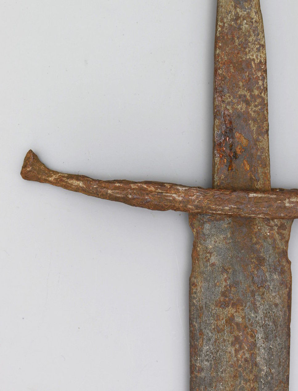

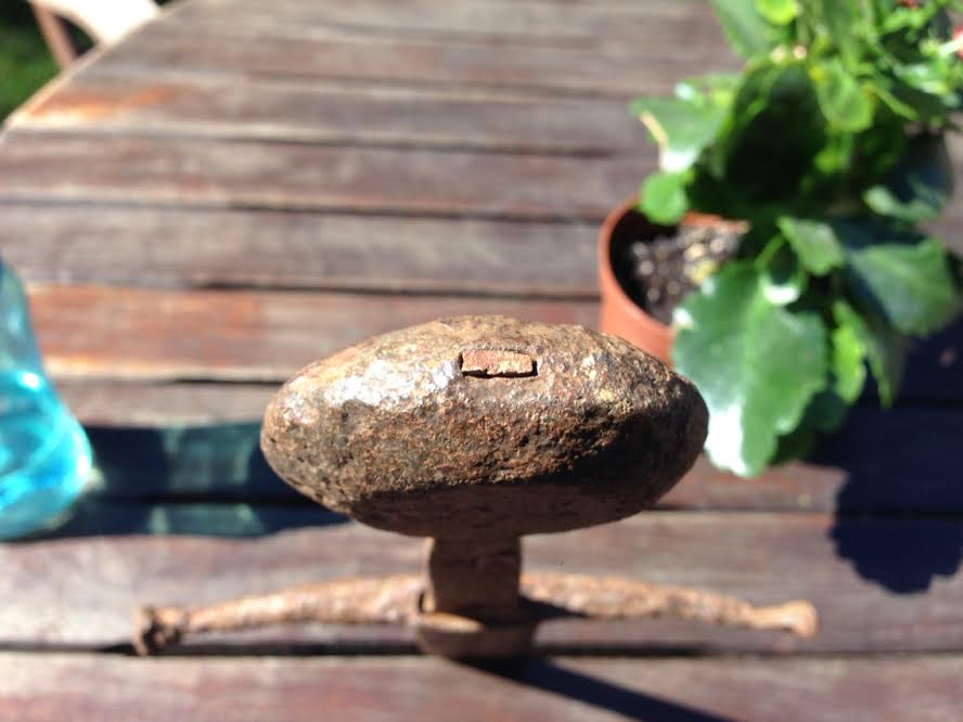

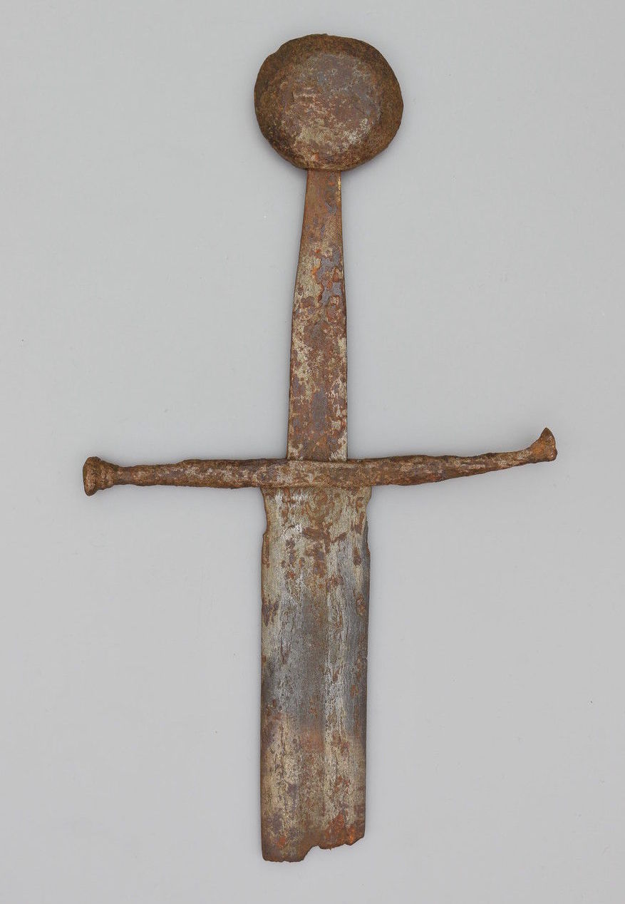

dear all,
I need to have your opinions on this piece concerning authenticity.
the dimensions are: total length 33 cm, pommel across 6 cm, cross guard 19 cm long. the cross guard is slightly decorated at its ends.
Would be great if you can give me some ideas!
thanks and best regards
andreas

I notice that the fuller extends a bit down onto the tang. The grain is tight, fine and wave like. The Tang is tapered enough to end in being peened. Can you get a picture of the end of the pommel?
Helleri is offline   Reply With Quote

Hi Andreas,
Im sure this is an Original, it looks that it has been chemically cleaned before and now it has rusted again.
kind regards
Ulfberth

It seems to be (from whats left of it) very inline with the dimensions, form and features of an arming sword. And if it were an arming sword and European (that it could be is speculative). You might want to use Oakshott typology to help classify it. I may be wrong but that looks like a type H pommel and type 11 guard. I don't think the blade itself could be fairly categorized.
I completely agree. It is very likely an original, but the surface has been badly damaged, probably by electrolysis or some sort of acid.

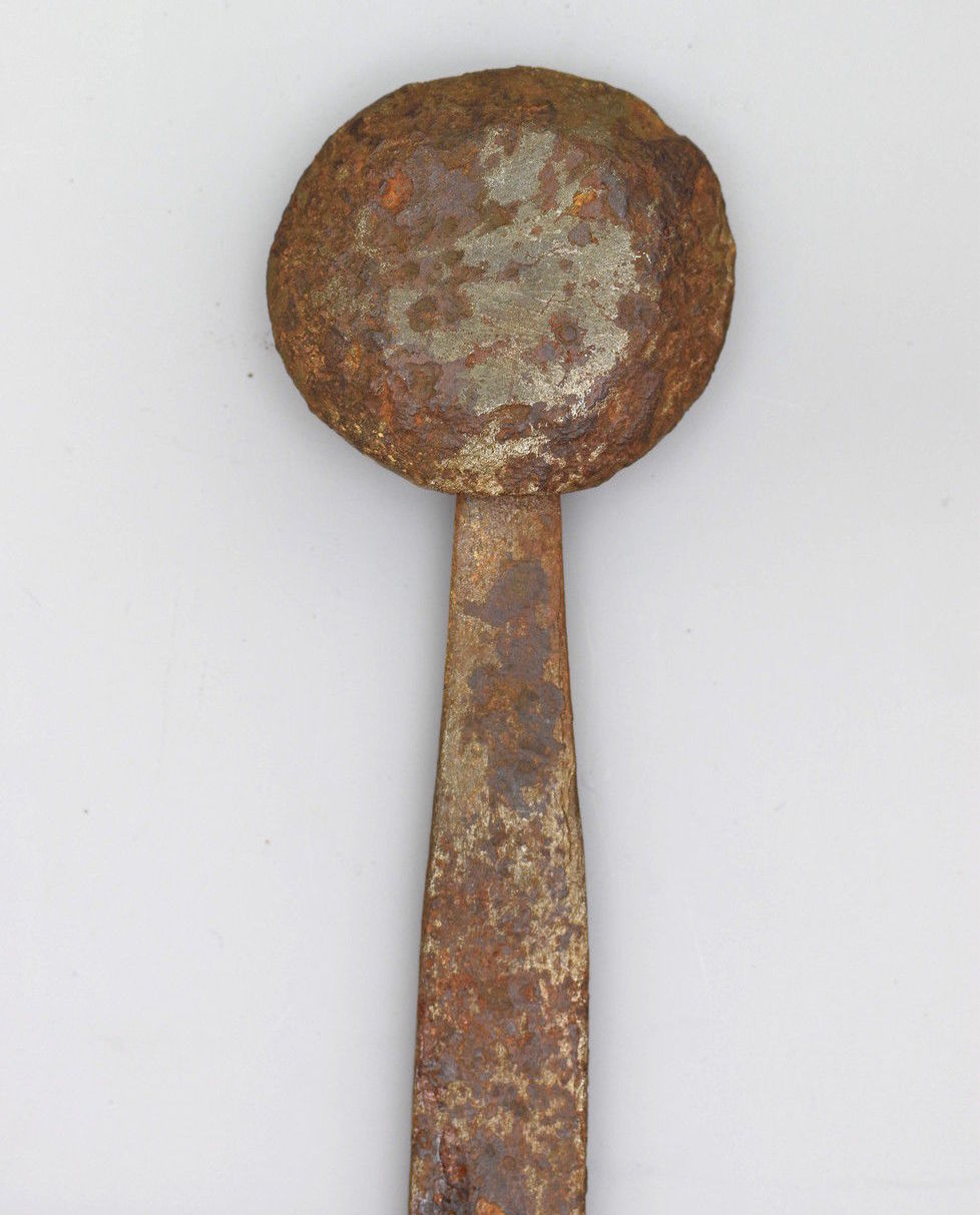

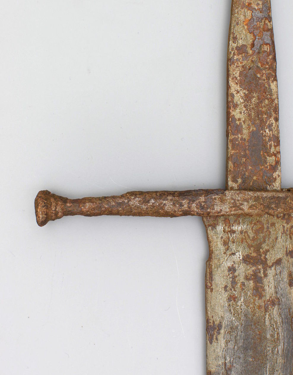

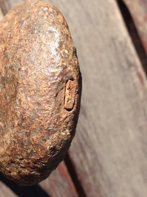

thanks for the replies, stekemest and helleri. will have some investigation in this direction.
here are some pics of the end of the pommel. the little pin / rivet is missing, probably broken off or rusted away.
best regards
andreas

Old 19th July 2016, 12:06 PM   #8
stekemest
stekemest's Avatar
Location: Heidelberg, Germany
Posts: 187
The new pictures convince me it is an original. Congratulations.
stekemest is offline   Reply With Quote

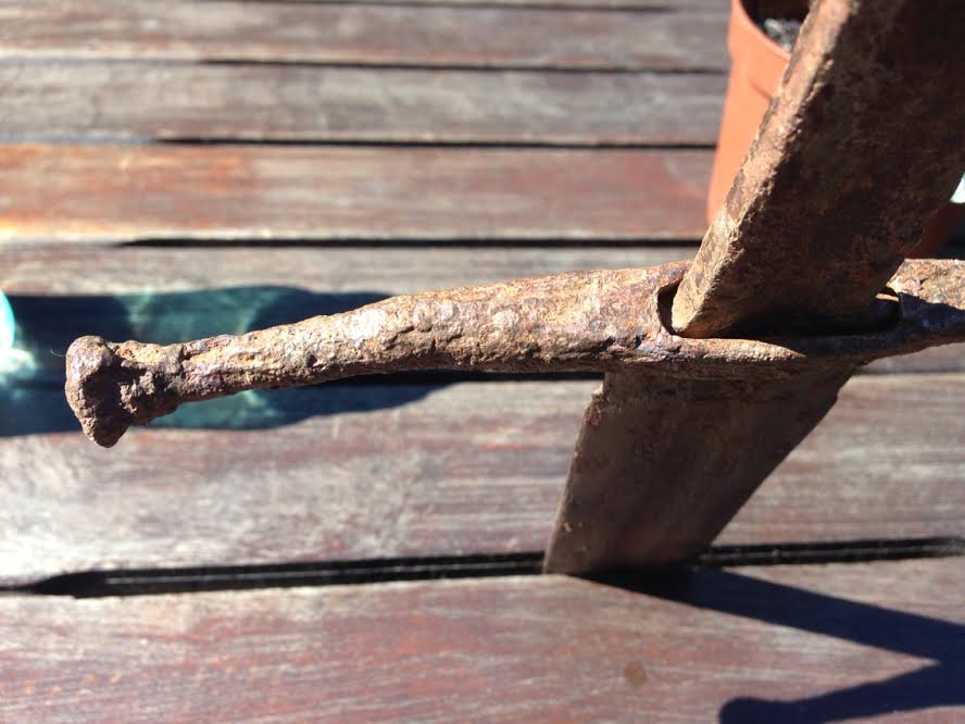

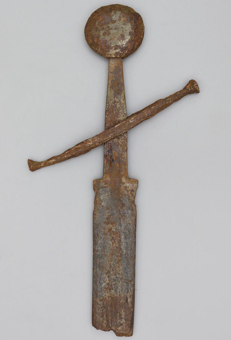

Dear all,
after this sword fragment did find its way back to me yesterday, I´d love to find out more about its age and geographic background. Any opinions warmly appreciated.
To complete the dimensions: The blade is 43mm wide.
Kind regards
Andreas

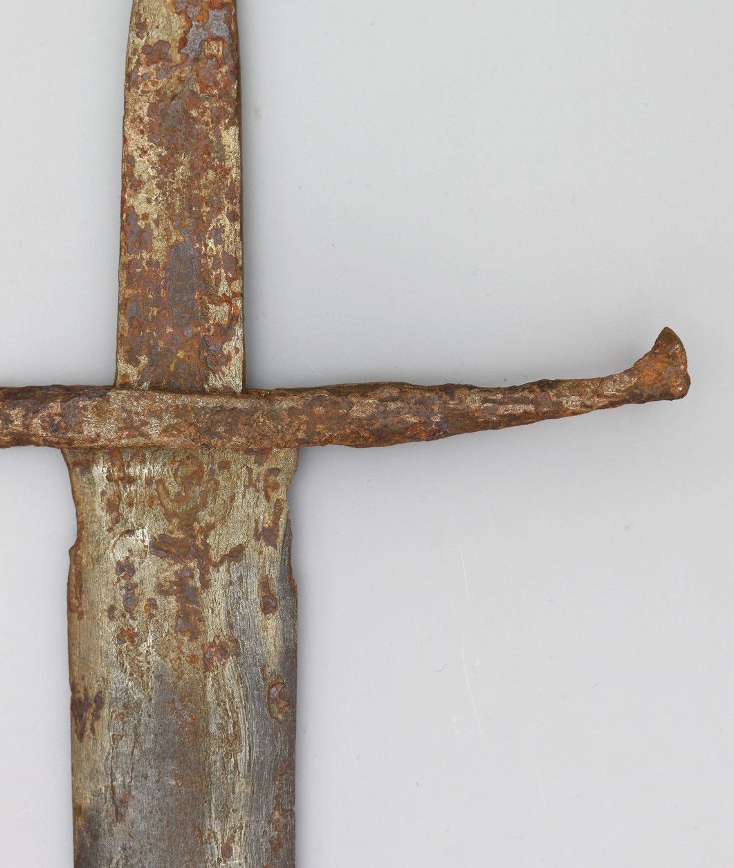

The break in the blade appears to have been done under stress and not from corrosion, battle damage? How will you display it, in a block of clear plexiglass or driftwood or? I find the partial broken blade interesting.

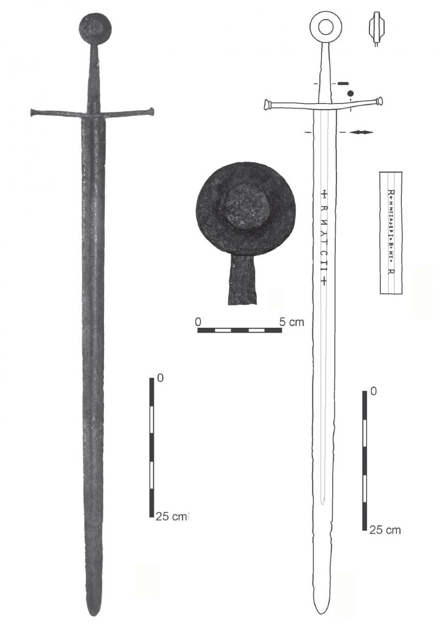

Hi Andreas,
The typology of your sword (type H/I disk pommel, type 2 cross) is very similar to a family with some famous members, like the swords from the River Witham and Whittlesea Mere, which have elaborate inscriptions. Examples are widely scattered around Europe, and I would guess their age overall as around 1200-1250.

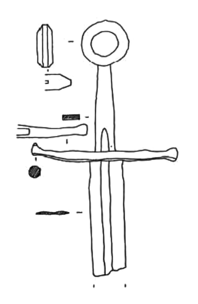

While looking in my files for some examples to share, I think I have actually stumbled upon your sword itself! It was found in Slovakia, in 1971. I will copy below the description published in Aleksic's Swords from Southeastern Europe. Notice that the length corresponds to your measurement. More information and the illustration are in a recent thesis, Chladné zbrane 10. – 16. storočia pochádzajúce z rieky Váh, by Michal Labuda.
54. Dead backwater of r. Váh, site Pasínek, near Šoporňa, western Slovakia, chance find. Type: I, ?, 2.
L= 33.4*; BL= 15.7*; HL= 18.2; CL= 18.7; BW= 4.5; PH= 5.5; PW= 6; TL= 11.5. Dat.: around 2/2
XIII – beg.of XIV c. Lit.: Katkin 1996, 106.
Mark
Reventlov is offline   Reply With Quote

Originally Posted by Reventlov View Post
Hi Andreas,
Mark
Woooooow Mark!! You are kiddding me. How cool is that! Thank you very much mate!
@Will: Yes, it is definetely broken and not rusted away. I guess battle damaged. I was planning to put it on an acryl stand, but now thinking about putting it into a wooden frame on the wall.
Best regards
Andreas

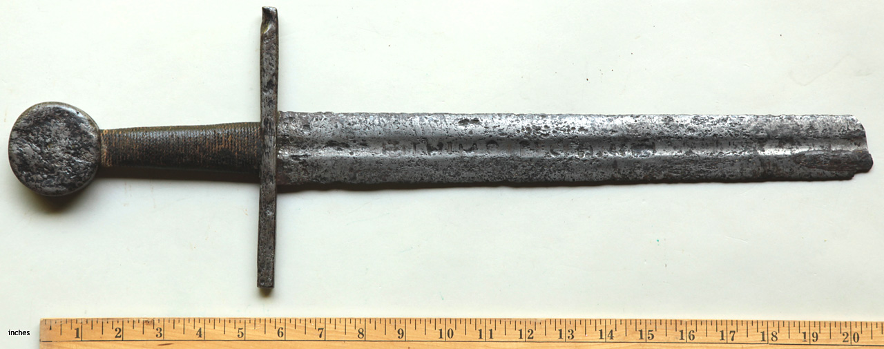

Unhappy Another sword likely broke in use
Nothing is better than having a publicly published picture from before the current plague of forgeries as provenance and to also know from where the example originated. Good work Reventlov! The irregular broken end is, as has been said before above, absolutely characteristic of a fracture from use.
Below is an image of another broken sword of similar age and form showing a similar fracture break.

You are welcome, and thank you Lee. Labuda's thesis can be downloaded here, there is a little discussion of the sword and the circumstances of its finding, but text is all in Slovakian:
https://is.muni.cz/th/aviae/

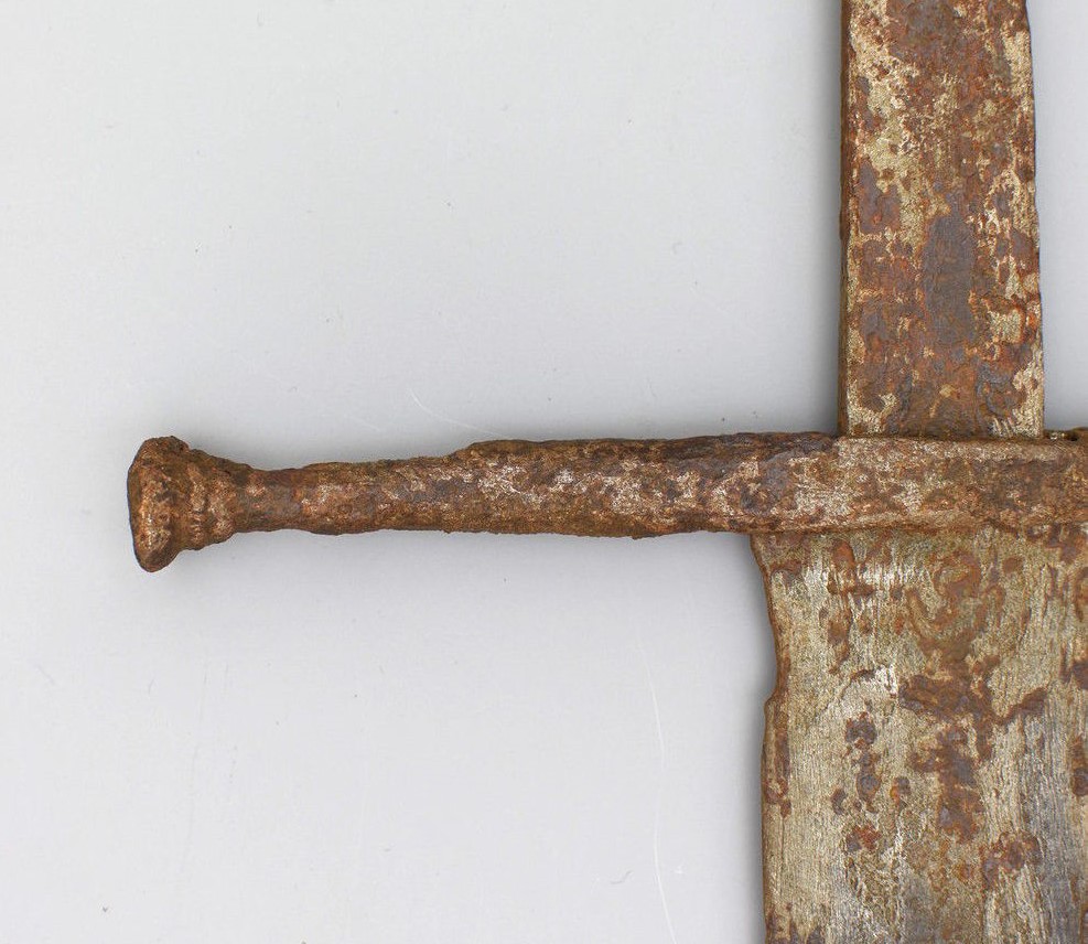

Of course you are right regerading the frame / stand. On the other hand: also on a stand one can only see one side. Maybe I´ll do both and change from time to time I will show you images, once it is done.
The corrusion seems different on the images. It is old rust / patina, which was partly remvoved. There is no new rust, even if it appears so on the images.

Originally Posted by AHorsa View Post
Can you tell what is written on the blade?
It is an iron inlaid, typically misspelt, "In nomine Domini" without spaces and between crosses potent.

I assume, that the fragment was,t cleaned in 1996, when Katkin did the drawin from #11. This would explain, why the detail of the quillon stepped in three parts wasn´t mentioned. I browsed many pictures of swords but couldn´t find an example with a similar parrier rod / quillons. Does anyone have an example of such?
Thanks and kind regards
Andreas

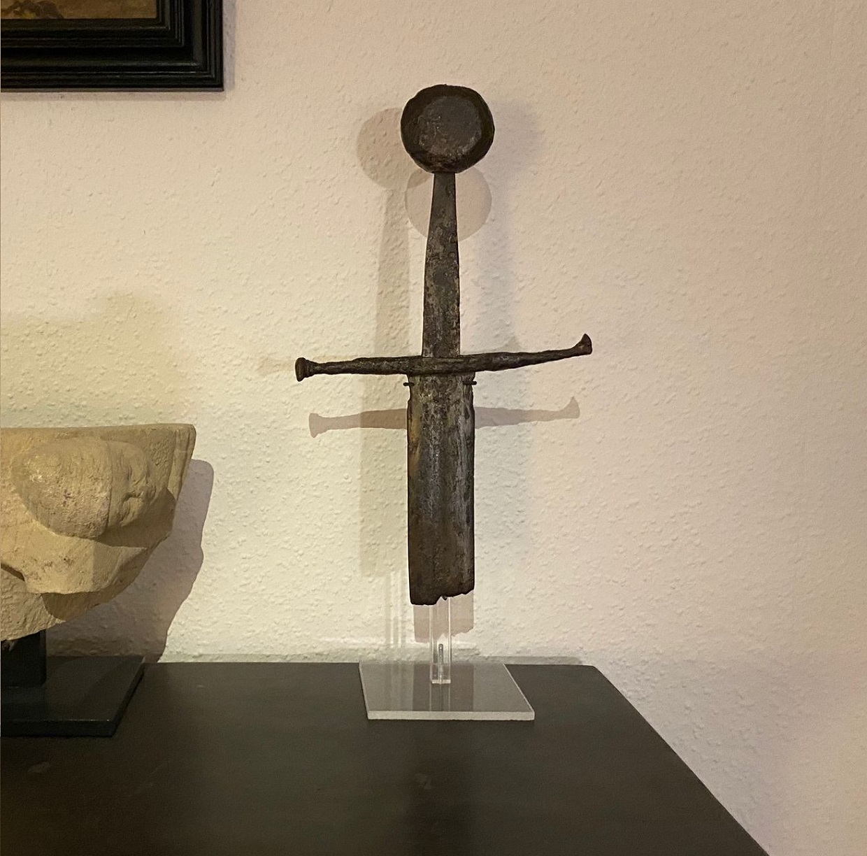

Here´s a picture of the sword with its acryl stand.
Kind regards
Andreas

Old 29th December 2022, 05:42 PM   #20
Merenti
Join Date: Aug 2021
Location: Germany
Posts: 72
looks very good! some museums can take an example.
