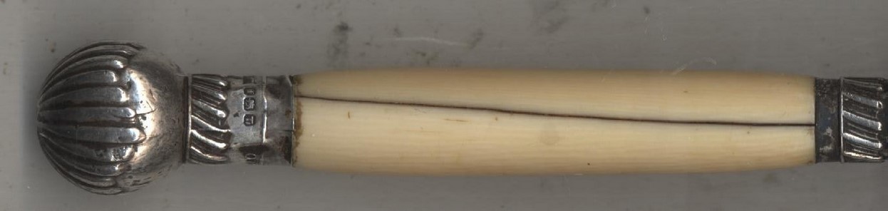

Any opinions on this knife handle as to the material. The silver mounts are Sheffield hallmarked for 1886 .

Posts: 1,435
Ivory
Old 20th June 2016, 02:52 PM   #3
thinreadline
thinreadline's Avatar
Join Date: Nov 2010
Location: Wirral
Posts: 1,204
Ivory
Thank you Colin .... may I ask how one tells ?

Colin refer to the Schreger lines. But I've seen a similar dagger with an early sort of plastic which imitates this Schreger lines. Can you use the hot needle test at an unvisible place?
Thanks Detlef , tried that and no its not plastic ... I didnt think they would use silver hallmarked mounts on a plastic grip , but you never know of course .

Posts: 2,238
Ivorine, as used on kitchenknifes, can look very much like this.
Sometimes including the lines.
However, I think that ivorine would not crack like this handle
Willem

I looked at two replacement substances for Ivory... Ivorine which was invented in 1899 thus too late for this..and Bakelite also a later invention... I have to say I think Ivory in this case... I cannot see the full stamps thus unable to say who the maker may be ...
Salaams Ibrahiim , the maker is Henry Wigful of Sheffield

I don't think this is ivory. Some translucence along the edges of cracks, dings, and scratches causes ivory to typically show hotter coloration there (red and orange, not black as is shown here). I think the grain is also too strait (with no intersection) and uninterrupted. Have you done the rub test?
What is the rub test ?

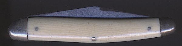

The regularly alternating dark and light lines are characteristic of the type of celluloid known as “French ivory”, first made in the 1860s and often found in knife handles.
(Shown is a knife with French ivory scales made by George Wostenholm of Sheffield).
Impossible to say what environmental or traumatic effects caused the longitudinal fracture. With as much certainty as possible from merely photographic evidence, I vote “not ivory”.
Berkley is offline   Reply With Quote

Posts: 1,204
All very interesting but wouldnt celluloid melt when a hot needle is applied ?

I don't think ivorine would crack like that, but ivory will. At least I've never seen cracks on table knives with such ivorine handles...

Posts: 257
A cursory Google search for “cracked celluloid” seems to indicate that it is a problem, at least among fountain pen collectors. However, thinreadline is certainly correct that a hot pin should have shown a positive reaction - in the case of celluloid, that could well be in the form of bursting into flames.
All of which reinforces the difficulty of identifying ivory from a photo on a computer monitor. Sadly, my own collection has several pieces where my optimism proved to be mere wishful thinking when the item was in hand.

I have seen a lot of both, and ivory is the only material that would crack like this.

Hi. Ivory vs bone is easy. Bone has tiny holes that you can see under magnification.
The "Hot wire" test is good for distinguishing between plastics and ivory though not all plastics will react clearly.
Barring fakery, I would bet on ivory. Also, Ivory cracks as an almost natural occurrence, plastic does not except under stress.
Ed is offline   Reply With Quote

I vaguely recall that one can rub suspect ivory until it is warmed, then smell it; a camphor odor would indicate that it was a man-made imitation. I don't have a reference for this, my failing memory will have to serve.

I think ivory's supposed to be cooler to the touch than plastic or bone, too. If you put the piece in a cold basement or cellar for awhile and then pick it up, it should feel cold like a piece of stone because of the higher mineral content.

A hot pin in bone smells like burning hair. A hot pin in ivory smells like burning cotton.
Celluloid and other early plastics go back to the third quarter of the 19th century. Ivorine...hmmm.,,,composites of ground scrap ivory and glue go back as far as well.
The Russian mastadon mined ivory of the earlier periods can fool you in some instances and has a somewhat different look than modern elephant. Especially if the mastadon stock was from the outer layers (imo).

I tried the hot needle on ivory, bone and some sort of fake ivory and NONE of them was affected in any way. So I can say this is definitely a more anecdotal than a working and reliable test.
Second, when polishing bone and ivory, I noticed they smell very similarly, like the dentist drilling a tooth, so the smell test can also be very misleading.
So I believe the most reliable way to identify ivory is by examining its structure under a magnifying glass.
