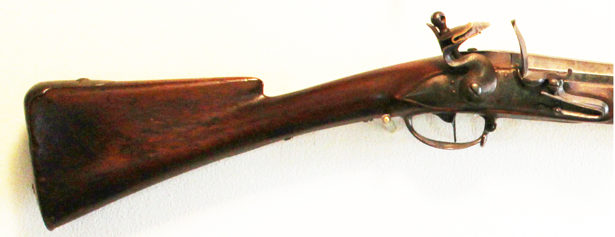

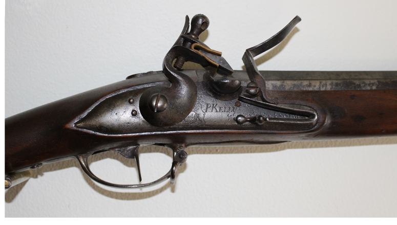

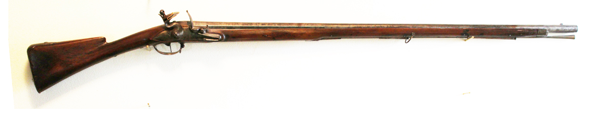

I have a flint musket on which I'd appreciate some insight. By the styling I have assumed it to be French. My father, Hugh Kelly. bought it about 1961 from the late Carlisle Smith, a Missouri archaeologist. Smith had brought it back from Europe, along with other antique guns. Mr. Smith had been certain that Dad would buy this one, as the single-bridle lock was engraved with "P.KELLY", and a standing bear. Right on, C. Smith! As there is corrosion over top of this engraving I assume it was done contemporary with the gun's use, if not manufacture. There are no other markings, no proof marks or numbers. I have not looked under the barrel.
By the bayonet lug, long entry thimble, sling swivels and caliber I assume it is a military gun. The a part-octagonal barrel being fastened with pins implies to me that It was made before French military guns were very well standardized. Perhaps before 1730? The barrel is just under 40" (1000mm, or roughly 3 pied 1 pouce), .70 or .71 (18mm) caliber. The breech end is octagonal for 13-1/2" (3430mm), tapering into round. The lock is 6-1/2" (165mm). The iron entry thimble is 6-1/4" (159mm) long, the middle thimble 3" (76mm) long. Trumpet ramrod looks too new to be original. The musket weighs 8lb 7 oz (3.83kg).
I saw nothing similar in Didier Bianchi's French Military Small Arms. I find some resemblance to an earlier musket on p35 of Kevin Gladysz' The French Trade Gun in North America. Neither The Military Arms of Canada, Historical Arms series No. 1, or The Fusil de Tulle in New France 1691 - 1741 are more help. Of course, this may reflect my limited knowledge of French arms in the first place, that I may not quite know what to look for. I have one more French book coming, i think it is somewhere over the Atlantic as I write. That is Jean Boutriot's Armes à feu françaises modèles réglemantaires 1717-1836 - Volume 1. I can only hope the illustrations may compensate somewhat for my ignorance of the language.
Well, this is as far as I think I know.

I don't know, the P. KELLY name on the lock plate; is that a bear next to it ?

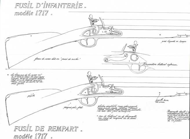

As you can see from the drawings of the first French infantry gun M 1717 your gun cannot be French. The lock is totally different and the following French version 1728 has iron barrel rings. I do at the moment not know to which country your piece belongs the less so since the name P.KELLY is not to be found in all reference books but I try to find it out

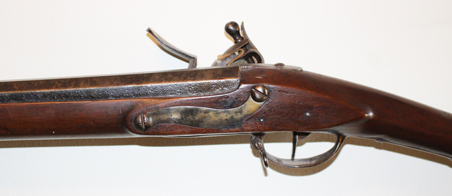

Ir would be interesting to see a picture of the lock with the hammer cocked, so that the 'beast' close to the name is fully shown.

OK, I erred. The PKELLY and standing bear do not have corrosion over the engraving. I would say this was a mid-2oth century addition As was the ramrod, using a 0. 235" steel rod. That is almost exactly 6mm (0.236"). In the USA standard small steel rods would be 6.35mm (0.250"). So the new ramrod was made in Europe, and it does appear that PKELLY and his bear are modern additions.

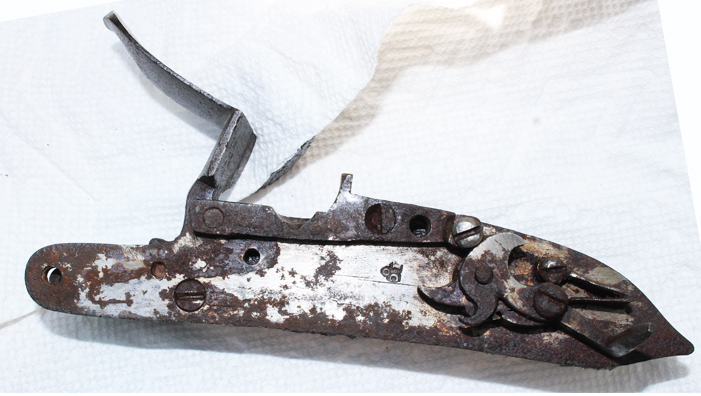

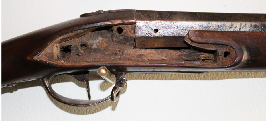

Right now the lock is partially disassembled in my basement. The rear lock bolt hole has an old bolt broken off in it. There is a new hole drilled and tapped for the current (rear) lock bolt. The stock is not drilled for the old lock bolt hole, but only for the more recent. The lock inlet appears to be cut for this particular lock.

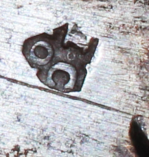

I did find one, and only one, marking, stamped inside the lock plate. Not clear to me what it is, I will have to experiment with lighting and maybe a smear of black paint to get a decent photo. Stay Tuned.

The lock recess looks like this was the original lock used. That is, the recess has not been recut.
There is a stamp on the inside of the lockplate. So far this is the only mark I have found on this musket.
I realize it does not match any standard French musket from Model 1717 on. 1717 was when the French more or less standardized their musket patterns.
Part octagon, part round barrels like on this musket were used on earlier guns.
My thought is that it was made some time between 1680 and 1720.
Well, any thoughts on what this lock mark might be?

I think it French as the trigger guard and side plate look like what we borrowed from them after our revolution

I think that the lock was made in the German town of SUHL, at least the marking on the inside is of SUHL origine. The tumbler is covered by a bridle what shows that this lock is far later as you assume, certainly not made about 1680! It would be really very helpful to know the markings of the barrel's underside

Hmmm....what a mystery. The butt stock design reminds me of someting that escapes me at the moment. Are the mounts all iron or brass or a combination?

Ahh, Mr Corrado26 so my "French" musket was likely made in Suhl? Might you share the reference you use for identifying this mark?

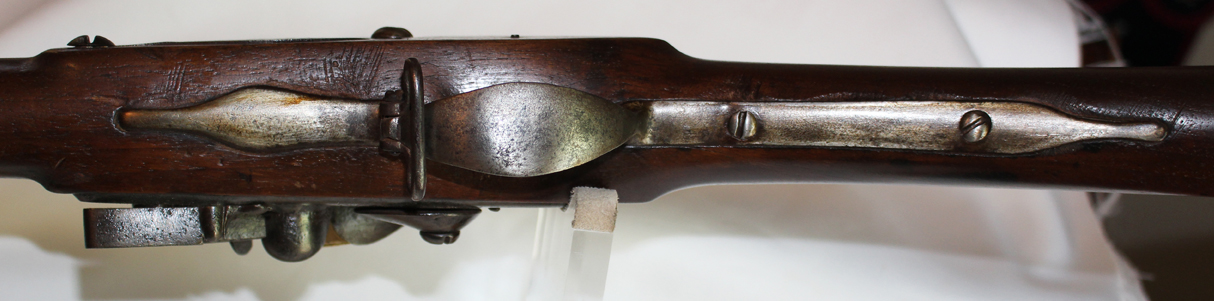

Also I think the side plate may have been replaced with some thin 20th century sheet steel.
All of the mountings are iron, no brass at all. The butt stock shape is one with which I am unfamiliar.
