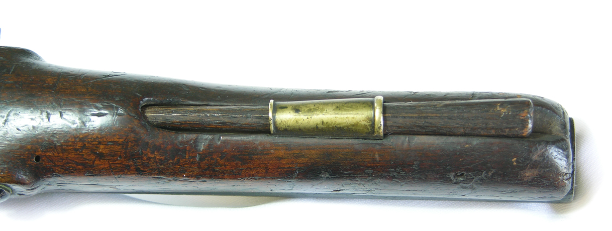

Default English Sea Service Pistol?

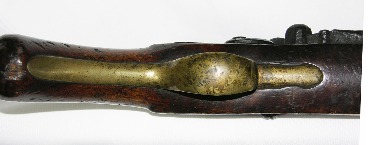

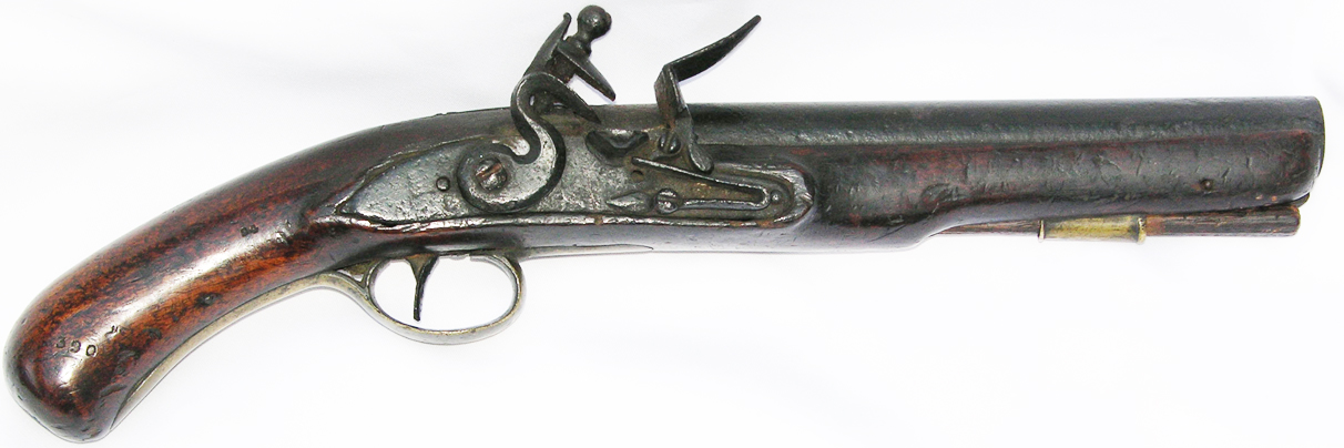

This plain pistol is of large caliber, 20mm, with a 230mm long barrel. The barrel is 30.3mm dia some 9-10mm ahead of the breech. This is identical to a British Light Dragoon pistol, marked Williams, in my Accumulation. By contrast, an India pattern Brown Bess of mine measures 33.9mm dia at similar location. By these measurements I assume the pistol barrel was intended to be 20mm caliber, and not a cut-down musket barrel. No visible proof marks. The lock and breech end of the barrel have some black paint, which might be consistent with sea service except it looks to have been applied after some corrosion and pitting had already taken place. The large bore permits a standard musket ball to be used.
I will probably go through life assuming that this is an English Sea Service pistol unless you gentlemen have other ideas.

It might have been to sea and a British person might have fired it but I don't think this is a British Sea Service Pistol. The angle of the grip/butt looks too straight. I don't think I have seen a Sea Service without a brass butt plate of some shape. The lock does not look British and the powder pan has a very strange shape?. Never have I seen any British service flintlock without very deep stamped proof marks. Most have military or naval markings ( Not all). Your pistol has numbers but they look rather recent and too small for any service stamp. My guess is that you either have a cut down rifle /carbine of some sort or something made up from parts. When of course is the real question. Was it made to use in the distant past or was it made to deceive? I look forward to reading what others think and I might have got it all wrong.

Of course, it is not a service weapon, by a
absence of proof punches and other inscriptions. In addition, the auction of lated. The hammer, although legitimate, does not correspond to the time the rest of the lock

It does appear old, but as already noted not Sea Service.

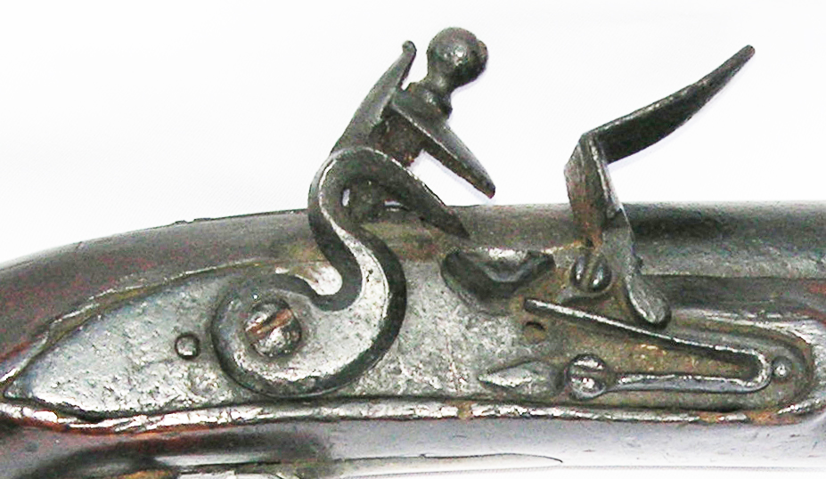

The lock with the faceted pan looks rather Germanic to me.

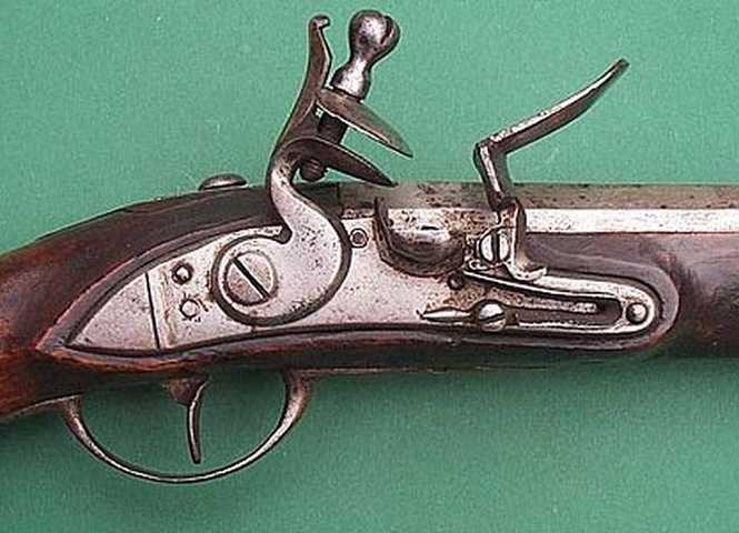

This lock with its battery spring ending left of the screw that fixes the lock to the butt is typical Austrian: It is the lock of the ordnance pistol M 1770. But the triggerguard and sideplate are of an other unknown but certainly European origin.

It looks old, except for the ramrod.
However the lock and trigger guard do not look like British issue.
It appears to me to have been assembled from various parts a long time ago. The stock looks like a cut down carbine or musket stock due to the profile. The lack of a buttcap also gives me pause.
It has a great patina and appears to have been legitimately used a long time ago, but any further attribution at this point (in my opinion), is strictly conjecture.

Numerous lock have the screw securing the lock to the stock right spring frizzen, so that is not a feature to define the origin of the lock, also other differences with the lock rise by corrado, as the auction of noticeable frizzen, a difference in the conformation of the gooseneck and the shape of "banana shape" of the plate of the lock and the pan is rounded and not facetted and depressed area at the end of the plate.

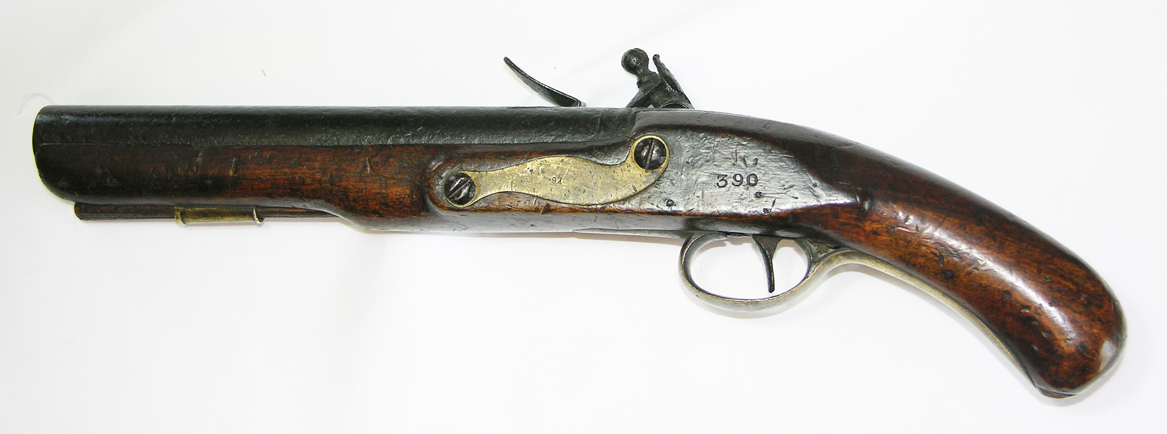

For what it's worth, the "390" is some manner of museum mark, not original to the pistol.
The pan is faceted, not round
Barrel measurements show that it is not a cut down musket. The profile is identical to a light dragoon pistol, not to a Brown Bess.
Otherwise, thank you, Gentlemen, for looking it over.

Sometime Irish registry marks are stamped similar to this. Seeing how guns were so highly restricted there going way back, it wouldn't surprise me that it could have been put together there.
I don't think the shape of the pommel, length of the grip and lack of a buttcap make this a candidate to be a light Dragoon pistol!

Ok, thank you, I forgot the Spanish flintlocks, but the lock of the pistol is certainly not a Spanish one

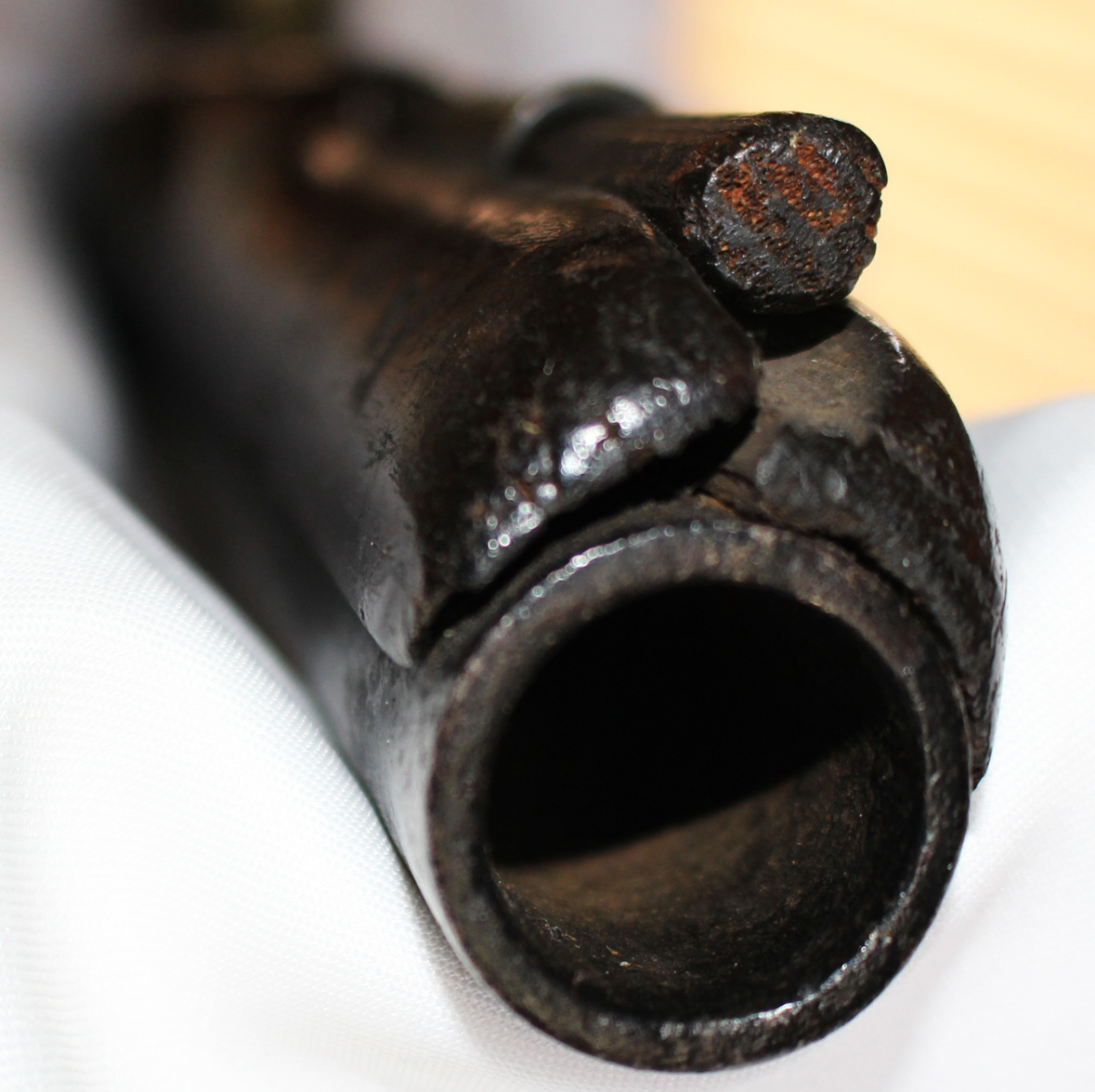

OK, to clarify. It is the outside dimensions of the BARREL that are about the same as my light dragoon pistol. Not the stock, not the hardware.
I noted this to confirm that, whatever is this pistol, it is NOT a cut down musket or carbine. At least, when I hold it in front of a Long Land and an India pattern Brown Bess it is clear that this pistol could not come out of that pattern wood, likewise the breech diameter of the musket is quite a bit larger..
The sideplate of the pistol in service is stamped 94, which corresponds to the 94 (not shown) stamped deeply into the wood, right side of grip. I might guess that this stood for 1794, much as 08 on a long dragoon pistol meant, I dare say, 1808. With quite a bit of imagination one might discern English proof marks near the breech. It was a kindness of someone to paint it black, as corrosion has taken its toll.
I have had the impression that the British used simpler, or older, patterns for the Sea Service. I suppose I got this from Battle Weapons of the American Revolution, George C. Neumann, ©1998. Specific examples that have features somewhat like my pistol are: page 34 (5) Circa 1750-1780, flat sea service lock . . . frizzen often squared; page 77 27.MM English Sea Service , . . the lock and furniture continued to follow early Queen Anne period styling . . . a rounded trigger guard front terminal. . .
You gentlemen have inspired me to do the homework I should have earlier. I really don't know much about English Sea Service firearms. I would be thankful if someone would point me to an appropriate reference book other than Neumann.

It would be interesting to see the inside of the lock. From the pictures the trigger screw can be seen but not any sign of a sear spring screw. Not an English lock type i have ever seen. Can you also show what you think might be some proof marks ?

With respect to the sear spring screw, it exists but is hidden by the cock. On Brown Bess muskets, for example, that long sear spring was used in the pattern 1756 lock. The pattern 1777 lock (terminology from Goldstein & Mowbray, The Brown Bess) used the shorter sear spring, and the screw does show in the lockplate behind the cock.

Just to confirm James' post above, the long scear spring was used in English locks until roughly 1765, then replaced by the shorter style.
This is just a generalization, as there was no immediate change over.
Having said that, the faceted pan is not seen usually on English locks and I still think the lock in question has a Germanic look to it, But, Germanic locks often had the pan screwed to the plate & a screw showed on the lock face between the breast of the cock and the pan.
We see no evidence of this on the lock in question.
Such screws can be seen above in poste 5 & 11.

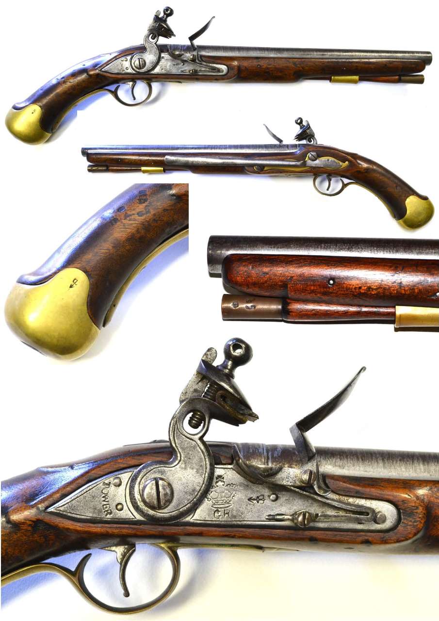

Default LONG SEA SERVICE PISTOL
Hi Guys
I agree that the pistol featured in this post is not a sea service. We have three of the long Sea Service pistols in our collection and they are very distinctive in design. The one I have included in this post is Circa 1800.
Dimensions: Overall 49.2 cm, 19.6 inches, Barrel 30.7 cm, 12 inches
Marks, etc.: George III cypher over "TOWER.", The stock behind the lock appears to be branded "1800" under a crown. There are additional issues stamps in the stock and under the ram rod including TP 4 GR. Belt hook has crown & 7.
Description
Sea service pistol with lock bearing the standard George III cypher over "TOWER." The .56-caliber barrel is 12" and marked at the breech with government view and proof stamps. The stock behind the lock appears to be branded "1800" under a crown. There are additional issues stamps in the stock and under the ram rod including TP 4 GR. The later style lock and a thicker stock immediately distinguish this early 19th-century pistol from the earlier 18th-century examples. Again, the overall length is 19" and it has a steel belt hook.
General Remarks
This basic form was adopted by the British Navy as its Patterns 1756. This example is Pattern 1756/1777 having an improved lock added at the later date (that is two screw ends visible behind the cock and no date below “TOWER” on the tail), plus a new rounded pan. The basic characteristics however remain the same as the original 1718 version of this design: a 12” pinned barrel (0.56 calibre); a flat lock with a ring cock; a narrow pan (no fence); the absence of both bridles; a single cast rammer pipe (wooden rod); the land service-type hazelnut trigger guard that adds a rear spur in the bow; a walnut stock providing beaver-tail carving at the barrel tang; a simple butt cap; and no nose band. A hole visible in the typical flat side plate tail anchored a stud on the belt hook’s base – held, in turn, by a lengthened rear side plate screw. A top screw secures the barrel tang; there is not trigger plate. Tower proofs are struck into the breach, while both “TOWER” and “crown/GR/broad arrow” are on the lock. These plain but sturdy pistols were often thrown or used as clubs after firing during close deck action.
References:
GILKERSON, William BOARDERS AWAY II: FIREARMS OF THE AGE OF FIGHTING SAIL pp248
HAWKINS, Peter THE PRICE GUIDE TO ANTIQUE GUNS & PISTOLS Pp238
MILLER, Martin THE COLLECTOR'S ILLUSTRATED GUIDE TO FIREARMS Pp92-93
NEUMANN, George G. BATTLE WEAPONS OF THE AMERICAN REVOLUTION Pp249
WILKINSON, Frederick SMALL ARMS 256p
Cheers Cathey and Rex
