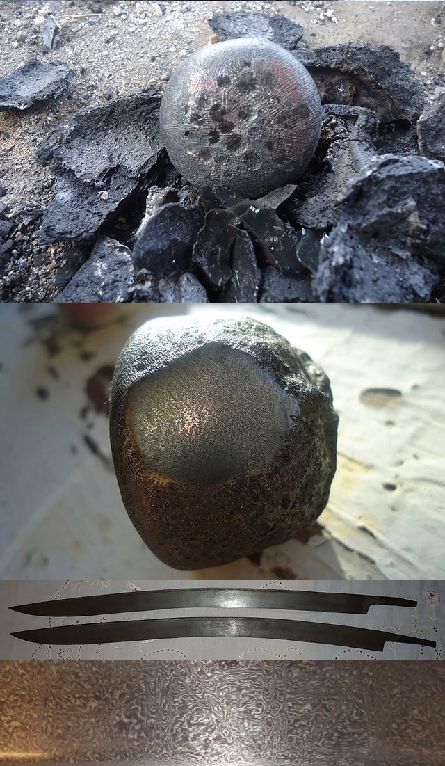

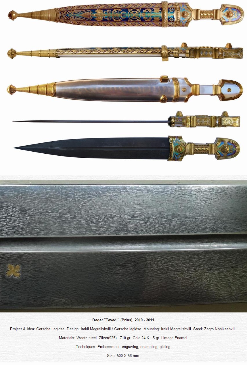

Dagger with wootz steel blade by Zaqro Nonikashvili.
estcrh is offline
Old 23rd February 2016, 04:56 PM   #152
ALEX
ALEX's Avatar
Posts: 936
Wootz is refferred as Bulat in Russian. I am not sure of definition of Bulat related to wootz, but in terms of clasical wootz - i'd not call this blade as such. I know some people would call wootz anything crucible. I am not going by process or components, but by visual pattern, and this is not wootz pattern to me.
Granted, some modern masters produce wootz blades, and of relatively decent pattern, but still lacking complexity and effect of old "twootz of legend".

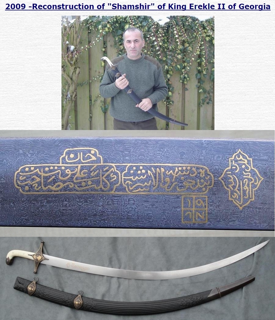

Alex,
King Erekle saber is a modern product with blade by Nonikashvili.
The "shams-y" bulat is, of course, on par with Anosov's. Nothing to write home about.

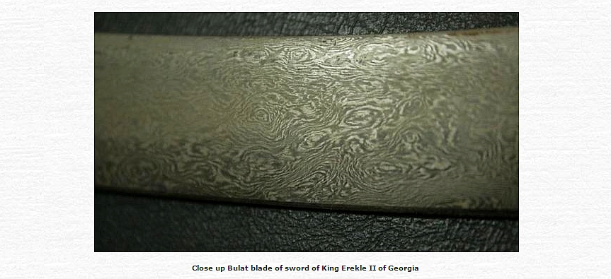

Ariel,
Is that closeup really of that "new" sword? I do not think so. I believe it is of old Persian blade on original saber or else. Also, how do we know the "new" blade is actually modern? Did he make several like this, or this is only one he made, or did he use old wootz blade, applied gold inscriptions and fittings and called: "I made it".
ALEX is offline

Originally Posted by ariel
Alex,
Here is the new replica sword by Studio Gotscha, 2009 and the original, the question is whether the second close up image is of the reproduction or the original, to me it appears to be a detailed image of the original.

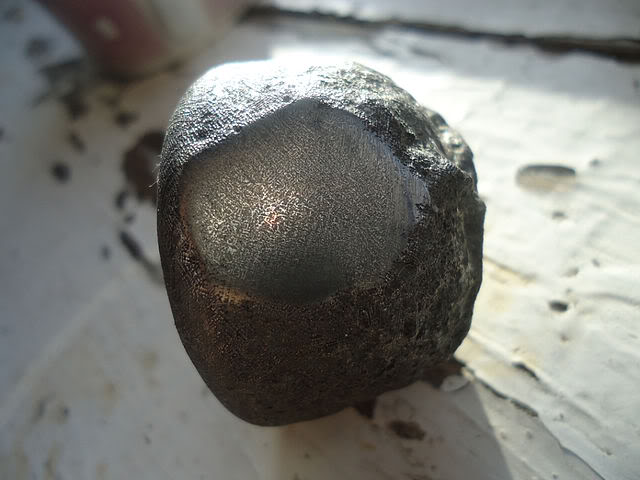

Have a read through what the fiery beards are saying on crucible steel :
http://www.bladesmithsforum.com/inde...howtopic=18364
And what I meant about the pattern visible in the cake, pre-forging out.

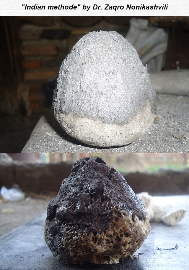

Emanual, there does seem to be a pattern there, heres what appears to be the whole process from crucible to ingot to yatagan blade with a detail view of the pattern created.
"Indian methode" by Dr. Zaqro Nonikashvili.
estcrh is offline
Old 25th February 2016, 02:27 AM   #160
Good example. His wootz patterns are unsurpassable.
Once again, it shows the importance of the forging process: minute and pretty "mechanical" dendrites of the ingot are transformed into a complex pattern easily comparable to the best Persian examples.
Obviously, Anosov lacked this ability.
ariel is offline

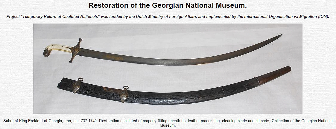

I can tell you with certainty, that Kirk-Narduban/Zig-Zag pattern is not newly made. The image is of genuine antique wootz blade.
I also saw these images on Internet bearing Zaqro Nonikashvili name, for whatever reasons: comparison, showing objects of restoration, etc. The same goes for another wootz pattern shown on the same panel, "mistakenly" attributing it to Mr. Nonikashvili. He's very good and talented restorer, and some images of wootz blades he restored got mixed with the notion that he forged them.
As for King Erekle shamshir, I am not convinced that the blade is newly made. I believe the old wootz blade was used, polished and inlaid, and the rest was skillfully recreated. Perhaps someone can prove me wrong.
Once again, it shows the importance of the forging process: minute and pretty "mechanical" dendrites of the ingot are transformed into a complex pattern...

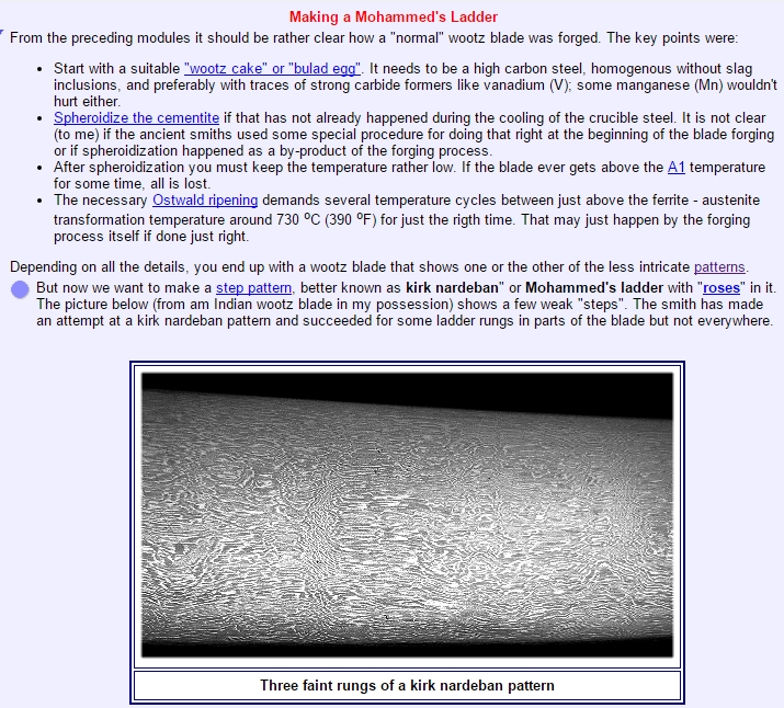

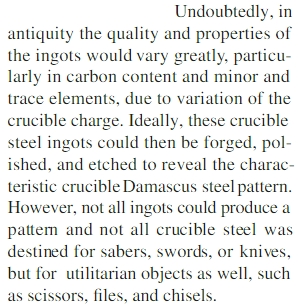

Other way around Ariel. The dendritic pattern is the chemical structure of the ingot right out of smelting. The Persian pattern is the result of mechanical stretching and deformation of the basis dendritic pattern.
Re-reading Jeff Pringle and other smiths, a lot of crucible steel-like material will exhibit the dendritic structure. it can be deformed and made to look like what we would call wootz. Recall the "mill ball" discussions.
Here is an excerpt from Jeff Pringle's explanation in that thread.
Originally Posted by Jeff Pringle
My definition of ‘wootz’ is: a simple carbon steel with over ~1.3% carbon, forged in such a way as to have banded carbide structures. (Others have slightly different definitions). This takes into account that we understand how to make wootz now, so the old definition is no longer sufficient. The classic ‘wootz’ pattern (how those old swords look) can be made from almost any dendritic steel, and perhaps in some cases from regular hi-carbon barstock, but with those materials the bands are not always saturated with iron carbides.
Emanuel is offline

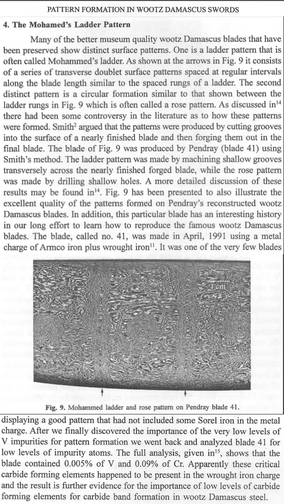

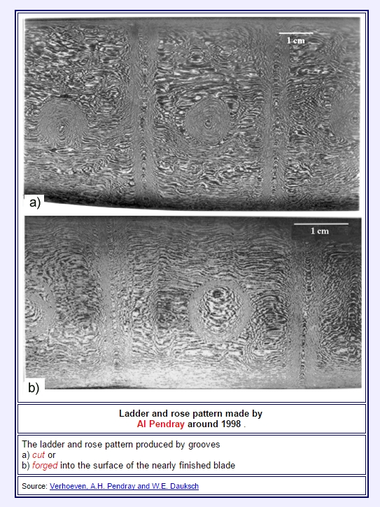

This shows that an ingot of crucible made in the proper manner had the necessary ingredients to forge a watered steel blade but Ann Feuerbach in "Crucible Damascus Steel: A Fascination for Almost 2,000 Years" says that not all ingots would necessarily produce a pattern.
Pattern formation in wootz damascus steel swords and blades - John Verhoeven

Cool thanks Eric.
Greg Obach followed this same process, producing a low-carbon rim around the high-carbon centre.
Metallurgy rocks!!!

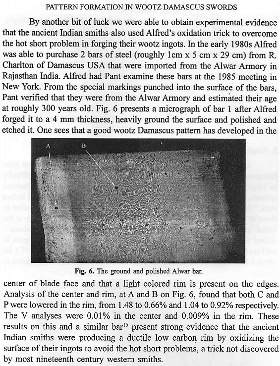

I have read several theories about how physical manipulation of the steel during the forging process such as cutting grooves in a crucible steel blade blank was the method used to create certain damascus patterns.

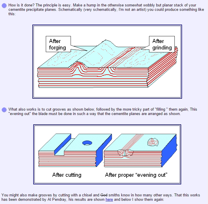

Another reference about creating a specific pattern by manipulating the crucible steel blade blank during forging.
