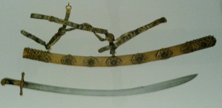

And here's a Persian sword of the 17th century. Not very much like a Shamshir familiar to us, does not it?
Sorry for the bad quality of the photo. But I think - the blade shape is clearly visible.

Old 24th February 2016, 09:16 PM   #51
Posts: 10,730
Originally Posted by mahratt
I propose to return to the "Asadula". As I understand it, there is no Persian manuscript of the 17th century, where they write that Assadula - a real person? Do I understand correctly? Maybe I missed some new articles on this topic?
I very much agree! and I think anyone here who is seriously interested in further understanding of the dilemma with the case of the Assad Allah blades should definitely read:
As I said earlier, the fact there are no documented Persian references from 17th century to a swordsmith called "Assdullah" has little if any relevance to the fact whether he existed or not.
Are there any Persian 17th century documents referring to other swordsmiths?! Sure there must have been many master swordsmiths in 17th century Persia but the fact their names are not mentioned in any document, doesn't mean they didn't exist.
As with respect to the photo you posted, it is simply one of the varieties of shapes that was used in 17th century Persia. However, this was not a typical shape for that period, since the archetypal Shamshir with its ample curvature and triangular cross-section was mostly prevalent.
On page 162 of "Arms and Armour from Iran," Mr. Khorasani gives several examples of 17th century shamshirs bearing the Assadullah name. There is even an example attributed to Shah Abbas dated 1583.
Asadula (if it was a real person) - this is not a simple wizard. If Assadula - a real person, a great master of the sword. This wizard necessarily had to fall into the manuscripts. But no manuscripts, where his name is mentioned.
Now Shamshir from the book "Arms and Armour from Iran," Mr. Khorasani . They have no 100% provenance. What Shamshir from the book "Arms and Armour from Iran," Mr. Khorasani are in the museum in Tehran - not guarantee that they are the 17th century. If I take wootz Shamshir 19th century, and write on it, "Shah Abbas", it becomes Shamshir 17th century? We do not know when and who wrote the inscription on the Shamshir from the book "Arms and Armour from Iran," Mr. Khorasani. But we know that the brand "Assadula" has generated a lot of fakes. Is not it?
Those Persian saber, which I say (and that shows in the pictures) - 100% 17 th century.

It does seem the sabre shown by Mahratt in the post with its scabbard has an indeed heavy blade which seems more like Central Asia type sabres of the 17th c. Naturally these were likely contemporary to these light bladed forms now visually associated with the term 'shamshir'.
It certainly seems to me , the more I read through these things that the cartouches as well as dates and allusions including what may be honorific titles must be added in a commemorative or traditional sense on these blades. Thus many of these are not of course 'fakes but genuinely quality blades with these inscriptions which have a certain talismanic imbuement .
