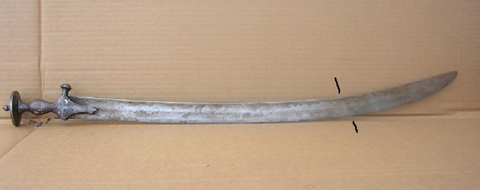

That's what I said at the top of this page.
Eric,
Here is a poor and old photo of the mended blade, the only photo I have at present. This is a very old mend, as all was covered with the same amount of rust.

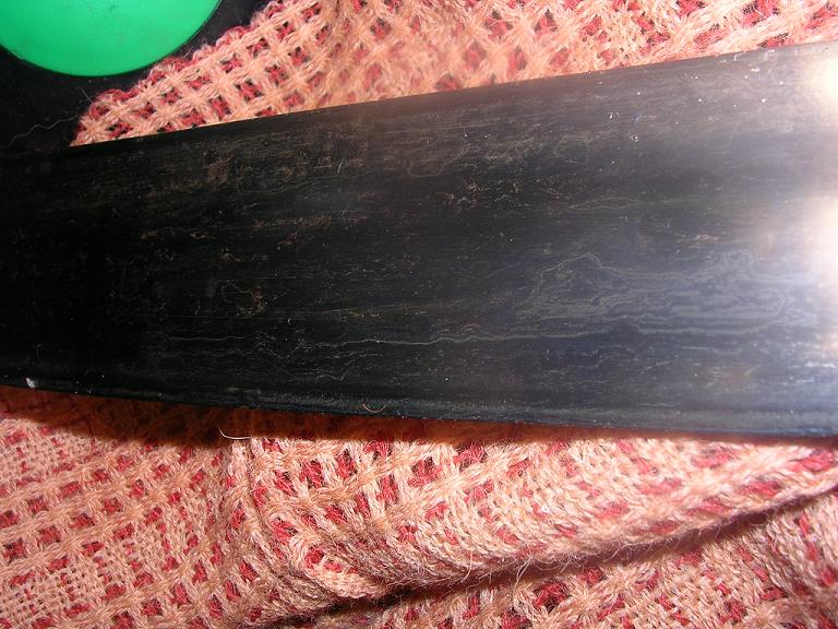

The second picture are of the laminations as they showed after cleaning, but these are Not of the break area.
If you wish a close-up of the break I will oblige in due course.
All the best,
Richard.
