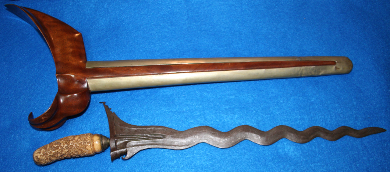

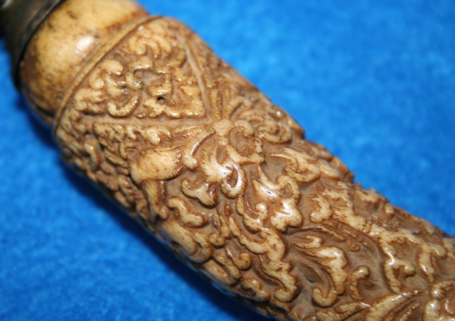

This is a Keris that I purchased from Ron over the holidays. Here is what I have been able to determine: the dress is Ladrang form, wooden Sarong with a plain brass Pendok. The Mendak is also brass and lightly decorated, the Wilah is 13 Dapor Lok with an interesting Pamor. The Ukiran is a mystery. Is it a whale's tooth? I've compared it side by side with two other knives that have stag horn handles and I am not convinced this is stag horn. Anyone know? TIA for any help!

Ivory?

It looks like bone to me, but photos can be deceptive.

Originally Posted by Henk
Ivory?
Maybe. Here is what professor Google says:
Thirty teeth of the sperm whale can be used for ivory. Each of these teeth, up to 8" long and 3" across, are hollow for the first half of their length. Sperm whale ivory is easily confused with walrus ivory, as both have two distinct layers. The inner layer of sperm whale ivory, however, is much larger.
I don't think it is bone, but I could be mistaken.
harrywagner is offline   Reply With Quote
Old 4th January 2016, 08:44 PM   #5
Posts: 6,441

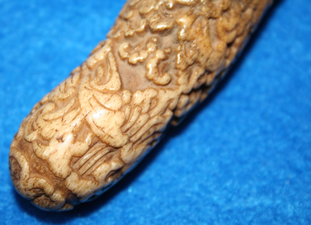

Bone.
Let's see the end of the handle.
The dentine of Walrus is very different from Sperm Whale dentine.
Old 4th January 2016, 08:53 PM   #6
MY BEST GUESS FROM THE PICTURES IS BONE OR ANTLER. SPERM WHALE TEETH DON'T HAVE PORES AND ARE USUALLY OF A UNIFORM SMOOTHNESS AND COLOR. KERIS HANDLES ARE OFTEN MADE FROM ANTLER OR BONE THOUGH IVORY IS SOMETIMES USED, MOST I HAVE SEEN AND COULD IDENTIFY WERE ELEPHANT IVORY. NICE REGARDLESS AND THESE DAYS ITS BETTER NOT TO RUN A-FOUL OF THE FOUL IVORY LAWS THAT BAN EVERYTHING REGARDLESS OF AGE AND ORIGIN.
Old 4th January 2016, 08:55 PM   #7
Posts: 7,258
Bone or de-natured antler. Not whales tooth.
A. G. Maisey is online now   Reply With Quote

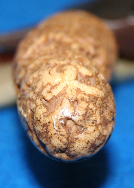

Originally Posted by Rick
Bone.
Hopefully this is good enough for a positive ID. The lighting in my home office is not very good. Thanks for the help!

Old 4th January 2016, 09:49 PM   #9
Posts: 6,441
If bone I'd expect to see a porous end on this handle. Of course these handles are sometimes capped with an insert, but I can't make one out.
Thank you for trying. I can't identify it either. The size and shape made me think it might be a tooth. Keep in mind that I would not know one if it bit me! I have only been collecting a couple of years and am reasonably certain I have never held a piece of ivory before. I won't rule bone out. It looks worn down and seems old. Any suggestions for an age? Thanks again for the help!

Posts: 7,421
Tooth of just about any animal does not have the type of striations that this has. These striations belong to bone. Some bone chosen does not have ends that are not so porous, depending upon the cut of bone.
Besides, whale tooth is grayer in color with layers.
My vote: bone (or less likely antler).
Many thanks to yourself, Vandoo, Rick and others. I will put this one down as bone. I appreciate the help, and am fine with it being bone. I like this one. The hilt is worn enough that it feels incredibly smooth. I am guessing it has some age. Do you think I would be way off to think it is early 20h?

My vote is bone, absolutely not tooth, antler, elephant or marine ivory.

The striations, small parallel lines visible all over the hilt, are the "scars" of the blood vessels when the bone was alive, part of a living creature.
In my opinion, this is the most important and reliable criterion to classify this material as bone.

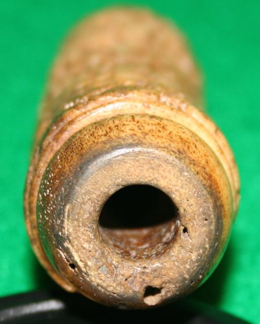

I would like to see the peksi hole (decaying/ pitting or not?) before giving a more definite opinion but would guess for either tanduk rusa (deer antller) or whale bone (not tooth). The origin of the piece is probably East Java and from the patina its age may be about 100 years indeed.

It is regular bone (probably water buffalo) - the (not shown) base of the upper side shows the exposed porous inner side.
Whale bone tends to be more porous, polishing less smoothly, and less resistant to wear.
Stag tends to be more homogenous if selected and worked well.
Well polished bone can be very smooth to begin with; this is obviously well worn, too.

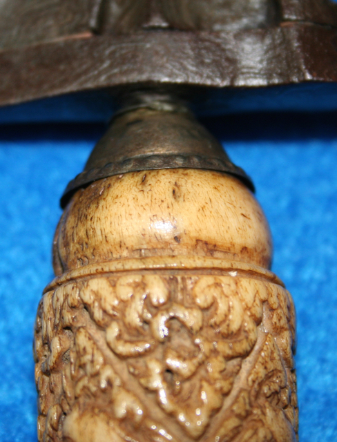

Default Peksi hole
The peksi hole. Thanks again for the help!

look like antler or indeed whalebone on your last picture, I would sort out other bone. It's sometimes very difficult to determine the exact origin of the used material, even elephant ivory can become very difficult when it's very worn.
And it's very awkward to get a decision without handling the material. So it's my best guess.
I'm afraid I don't see any notable hints for it being made from stag nor whalebone. Still looks like "generic" bone from a terrestrial mammal to me...
Agreed - just my 2 cents as well.

I just miss the porouness this material normally have. But like said, it's difficult to get a desicion without handling it.
