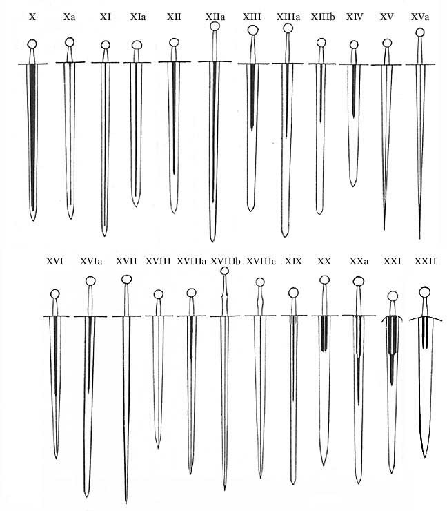

The blade look like the relics of an Oakshot XVIIIb type blade, the reason it looks a bit leaf shaped is due to rust and and deterioration.
The pommel and textile are of later date.
Kind regards
Ulfberth

I have to disagree. I'm sure that this blade is shaped by design rather than corrosion. I have a collection of medieval swords and really don't think it's medieval.
I also feel sure that the Pommel is original. I have seen ancient swords with this type of pommel but cannot think where I have seen them!
