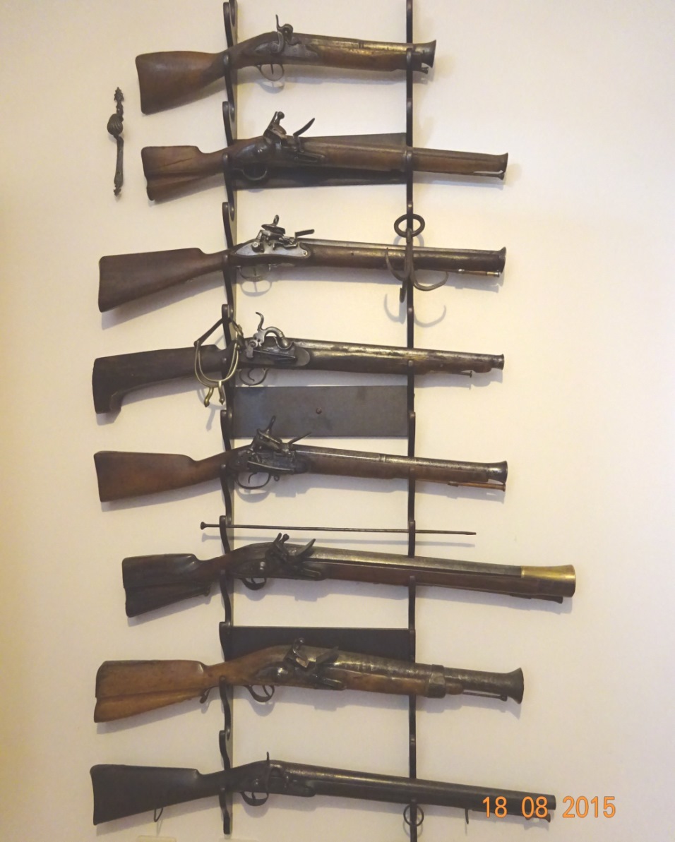

Hi
The wood graft is very good and a fantastic match
Was this all just staining wood to match or have you any secrets you would like to share
The toe in my opinion is a bit sharp and could be filed down a bit
Then I would take the obvious blue/black colour away with fine wire wool and then rust the metal back down
I do accelerated rusting by dipping the metal when hot into a nitric acid copper sulphate solution
I will be doing this process in a few weeks time and I will share a set of images
I find the problem in doing this work is always difficult as your eye is drawn to where the work was done and you can' t be objective
