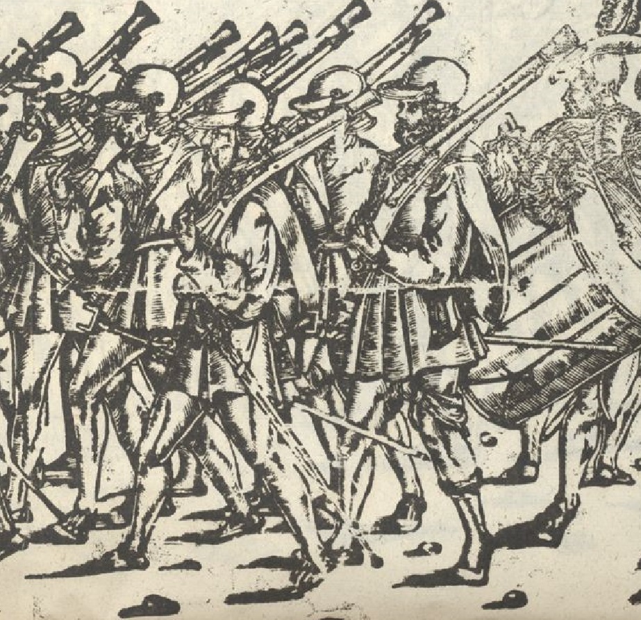

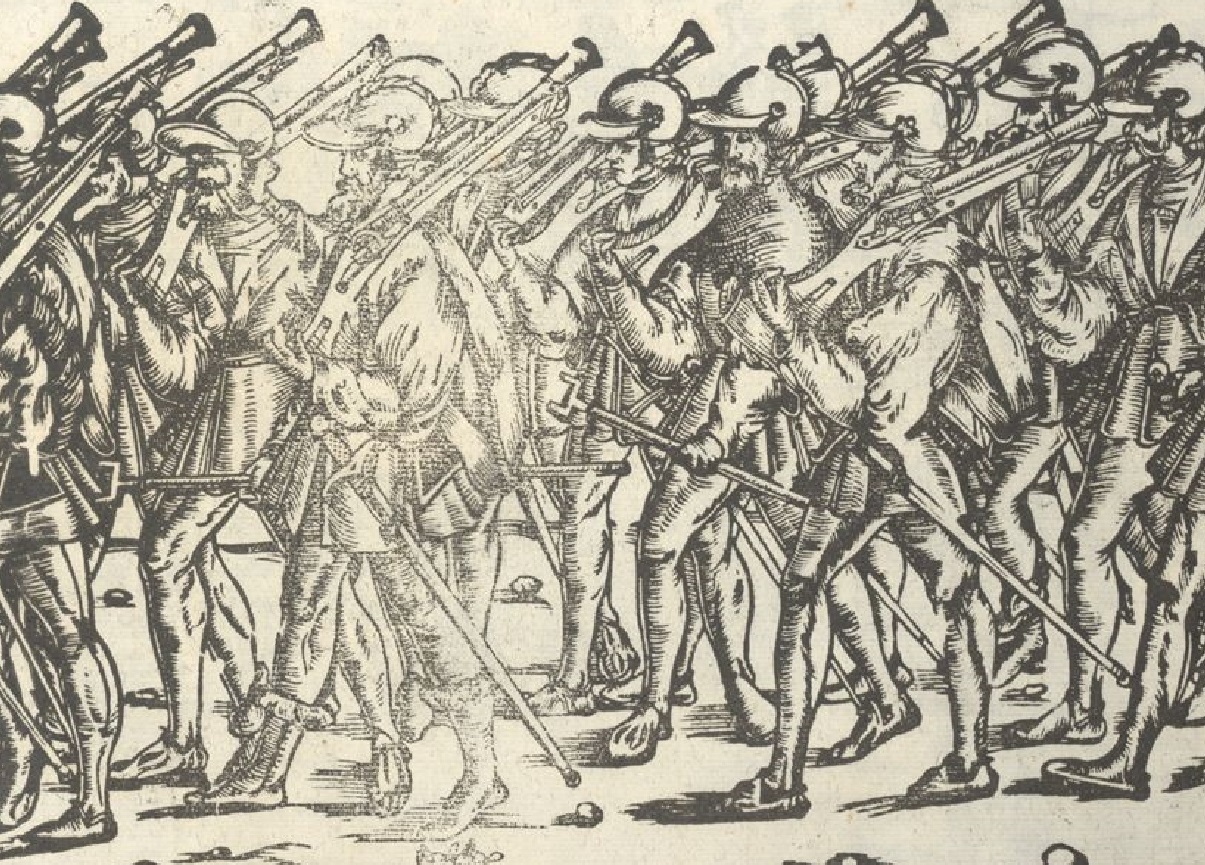

Hello guys, my English is quite poor, and I write using google translator, sorry.
I thought the arquebuses were light for use without fork, but I've seen in a pictorial representation which undoubtedly are spanish arquebusiers carrying arquebuses and forks.
La cavalcata dell'Imperator Carlo V nel suo ingresso in Bologna. Venice c.1530
http://special-1.bl.uk/treasures/fes...x?strFest=0092
The last two images from the Entry of Charles V into Bologna in 1529 to be crowned Holy Roman Emperor:
Italian text:
Nel ultimo sono venuti, 6, bandiere di
spagnoli li quali sono venuti co la ce-
sarea maestà p mare li qualli vien sti-
madi apresso 3000 , et veneno in or-
denanza a 5 a 5 ,a chavalo et a pede. Et
questo se fa notto a tutte le natione
Stampata in venetia a di p.º luio.
Spanish translation [by myself]:
En el último vienen 6 banderas [compañías] de
españoles, los cuales han venido con la
cesárea majestad por mar, los cuales son
estimados en unos 3000, y vienen
en orden de 5 en 5, a caballo y a pie.
Y esto "se hizo notar" a todas las naciones.
Estampada en Venecia a primero de julio
English google translation [sorry again]:
In the last [image] six spaniard flags [companies]
who have come with Caesarean Majesty by sea, which are
estimated at about 3000, and come
by 5 by 5, on horseback and on foot.
And this was pointed out to all nations.
Printed in Venice on July
http://special-1.bl.uk/treasures/fes...92&strPage=029
Notice that the German arquebusiers - lansquenetes - are represented with arquebuses without forks:
http://special-1.bl.uk/treasures/fes...92&strPage=009

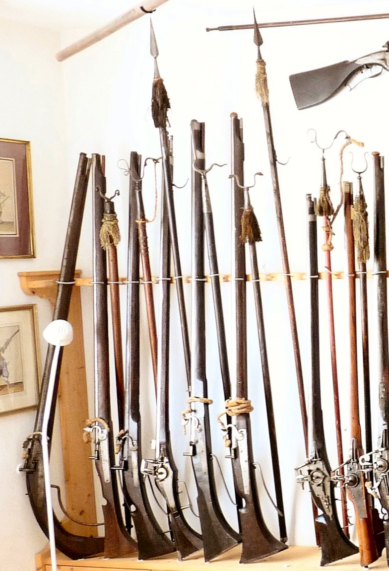

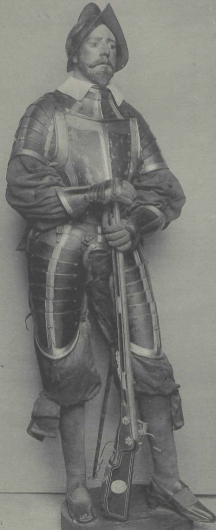

I guess it all depends on the period dimensions of the arcabuz or musket . Probably the ones that needed the rest (fork) came first and were rather long and heavy. Later versions, like the 'caliver', didn't need support.
I have just posted a picture of an arcabucero of the period of King Felipe II of Spain and apparently this style was already light enough to support without a fork.
I hope Michael (Matchlock) comes around to give you a full and competent information on this subject.

I had always read that the arquebuses were fired without suspension, so my astonishment to see the engravings. I believed that the muskets were first used in the 1560s, and that the very concept of musket supposed use with fork; and arquebuses that were light pieces that did not require fork. But I guess that your explanation that they had heavier pieces that required the use of forks is the logical explanation.
Thank you

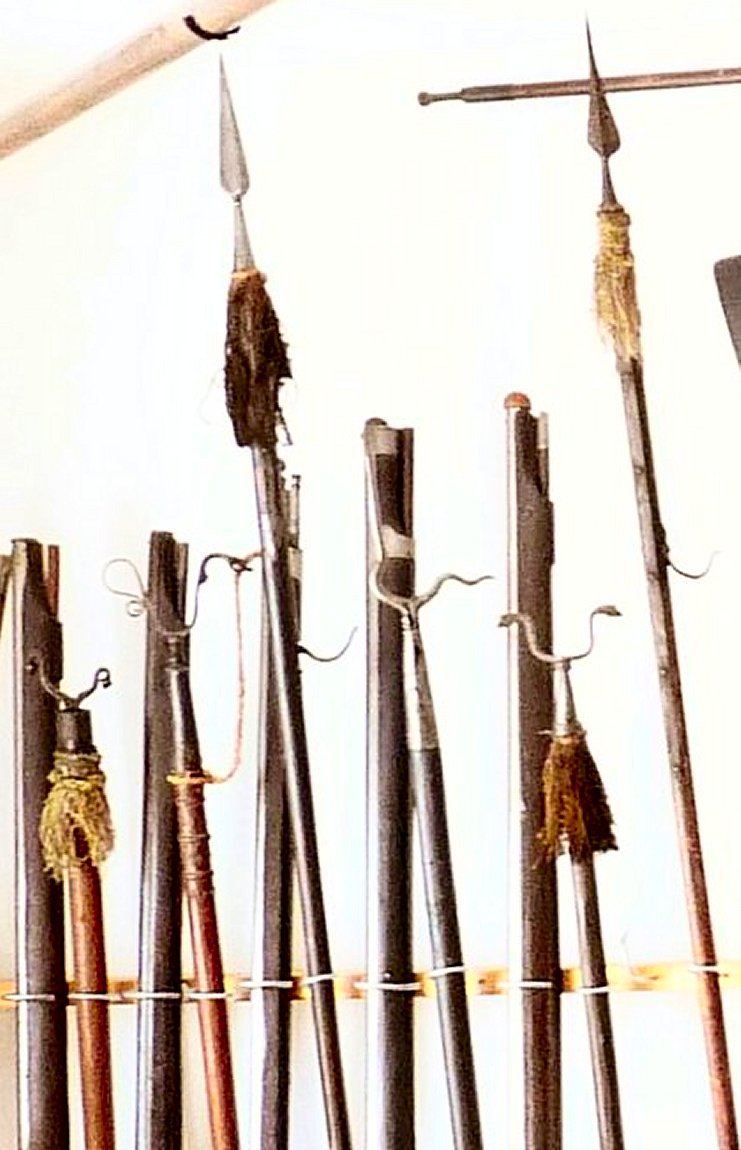

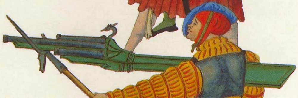

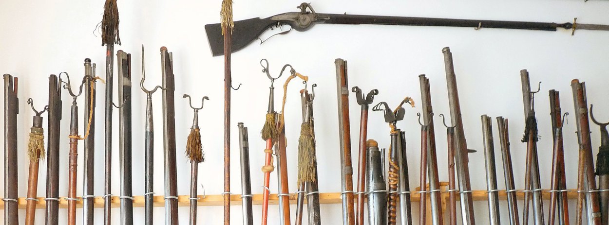

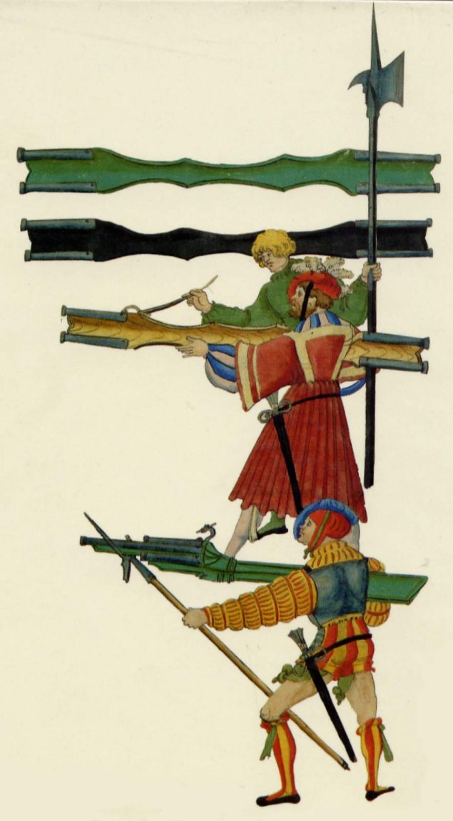

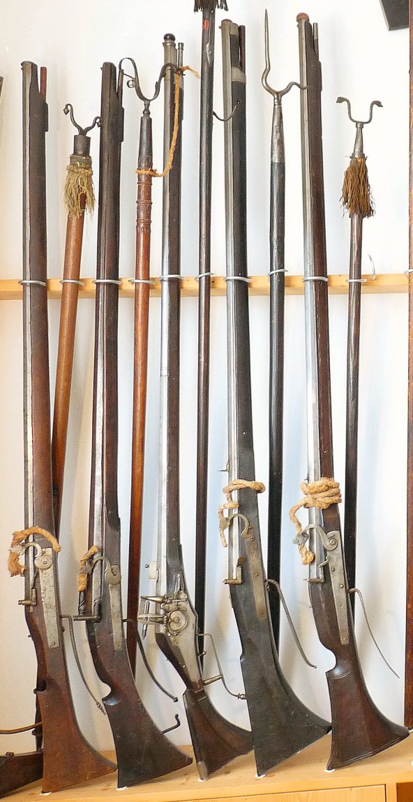

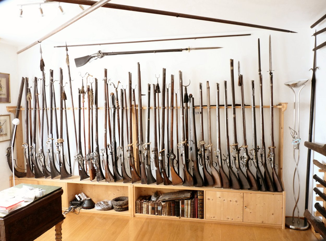

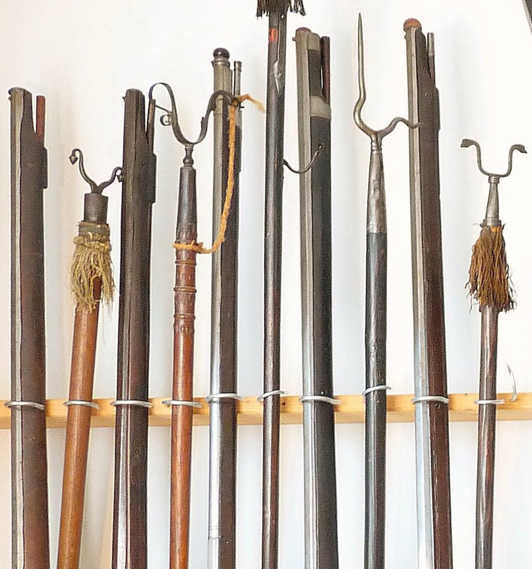

Hello, Cavalco,
And a great big WELCOME from me as well - especially as you made a real giant leap to land smashing here, by posting these highly valuable sources of historic illustrations.
Thank you so much!
Without any doubt, they are an important contemporary proof of the upcoming of gun rests in the early 16th century, and their wider use by ca. 1530.
For more information on gun rests/forks, please see my new thread
http://www.vikingsword.com/vb/showthread.php?t=19127

Please see my new thread on gun rests/forks:

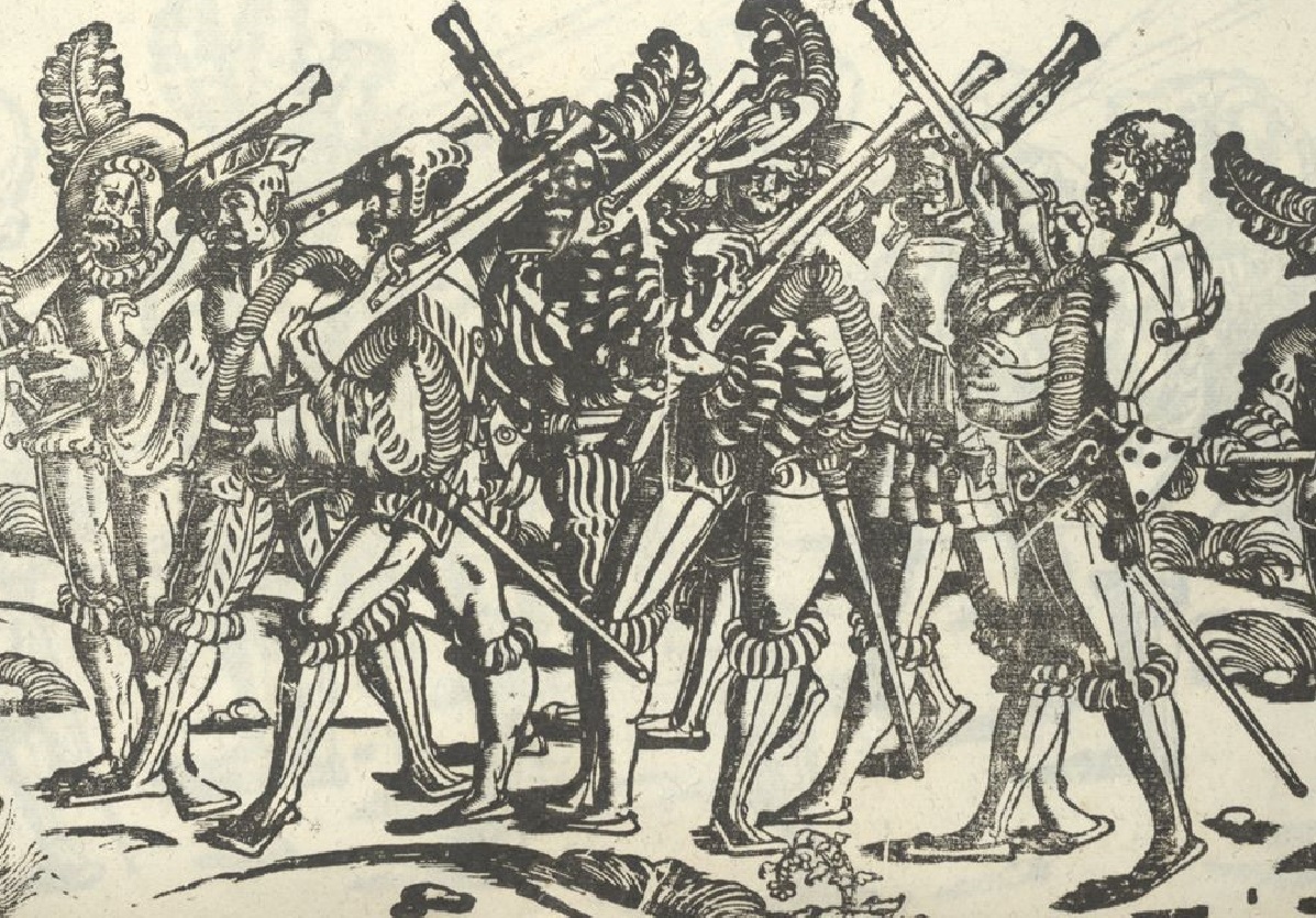

I add an image to display further details and questions. The arquebus red circle, has no key. Is it fired with fuse?
In the tails of the arquebuses with red circle you can see a piece. In the arquebuses of the German soldiers not appear

Sure, as it did not have a lock mechanism it had to be fired using either a fuse/match or an igniting iron.
As I said, and will show soon, those butts have a trap, a recess with a sliding wooden cover; it was NOT a "patchbox" but was used to keep small cleaning utensils, like a worm and scourer, and wadding for the load.
Please see an Italian arquebus of ca. 1525-30, with a butt trap on the underside of the buttstock in which the original cleaning tools are still preserved; in

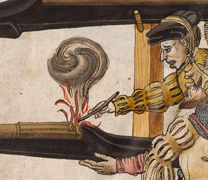

For earliest depictions of gun barrels, please also cf. my thread:
http://www.vikingsword.com/vb/showth...non+depictions
Nobody has, at least to my knowledge, assembled these up to now.
From top to bottom:
- 1326, Walter de Milemete: Holkham ms 458, British Library
- 1326-7, Walter de Milemete: Oxford Christ Church ms 2 (traditional term), now: Oxford Bodleian Library ms 92, fol. 70v
- ca. 1340, detail of a fresco at Eremo Lecceto Abbey, near Siena, Italy - the earliest known piece of artwork depicting a wooden "carriage", or a "stock"
- ca. 1343-5, and very similar to the foregoing, from Jan van Boendale:
Brabantsche Yeesten (Great Deeds of Brabant), Brussels, Royal Library, ms IV 684
As seen in the latter, in the earliest days of the gun, the charge of powder required was so large that the stone (!) ball was virtually located in the muzzle area (German: Steinbüchse).
