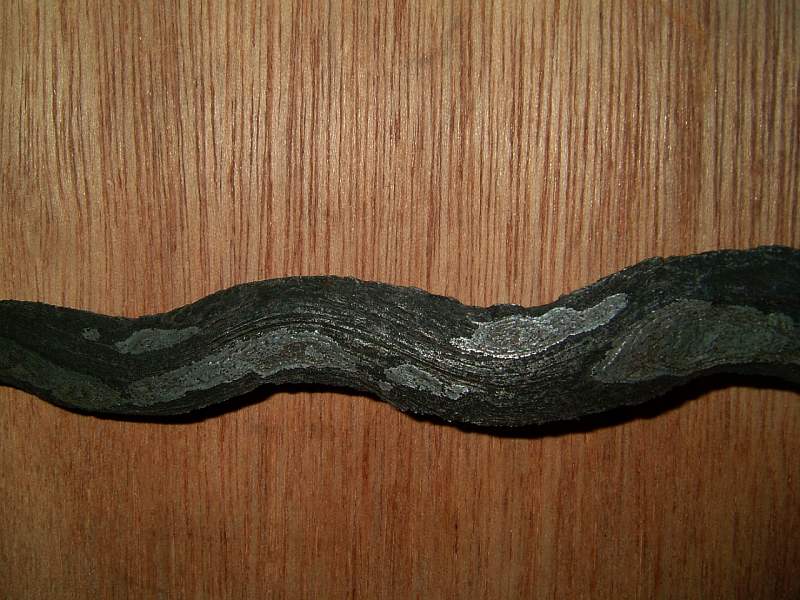

Your old keris is thinner because of repeated washings in Warangan during Muharram ; if it is centuries old then a lot of the original material has been lost due to this process .
Below is an example of the results of a few hundred years of washing ; the parallel lines running down the blade are strands of the base iron .
