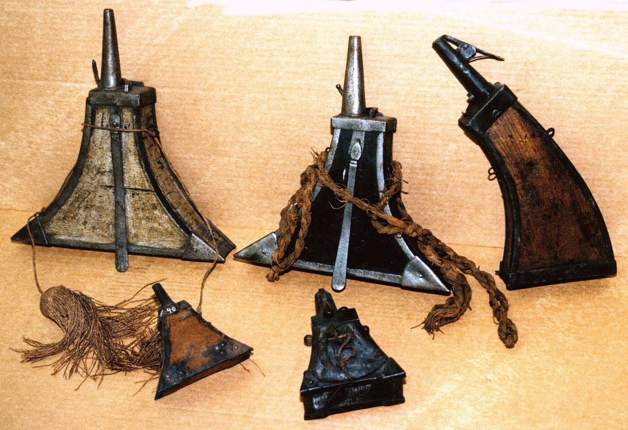

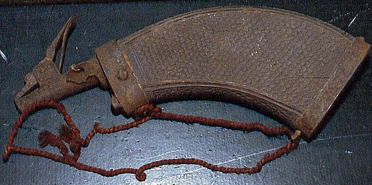

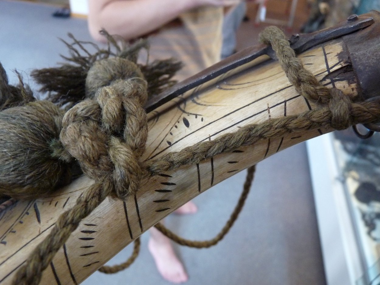

This finely made Nuremberg specimen I photographed at an auction viewing in 2009.
Please also note the close-ups of the original woollen tassels of another caliverman's flask.
m

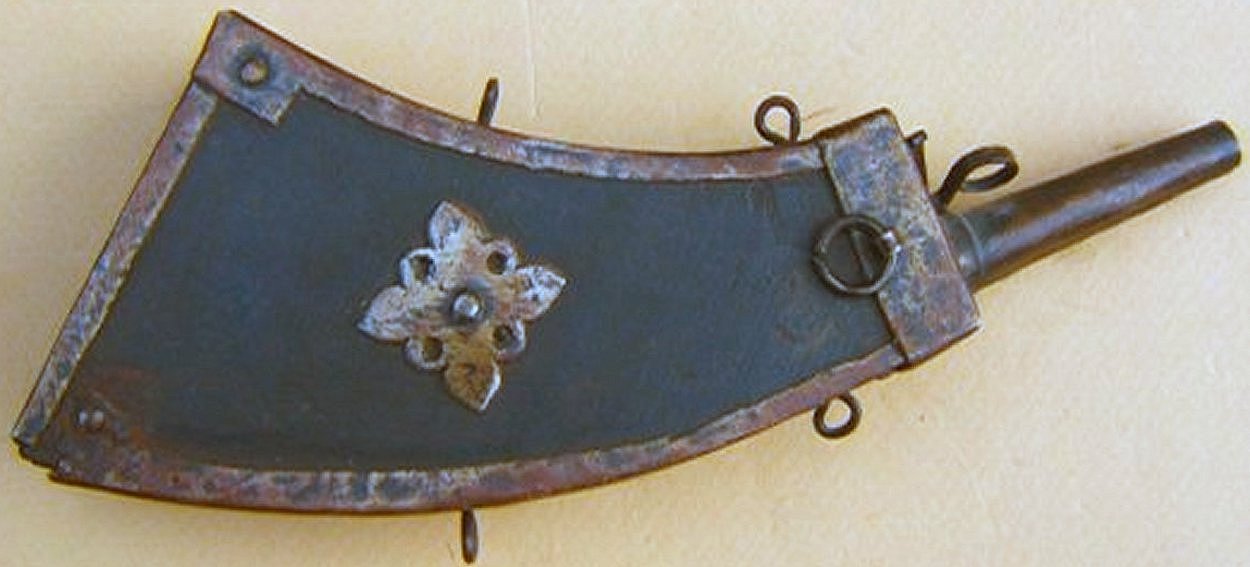

On the right is a caliverman's flask with plain wooden body, ca. 1580-1600, in the reserve collection of the City Museum of Köln (Cologne).
Author's photo, 1987.
For more on trapezoid flasks like those depicted in the photo, please see my thread
http://www.vikingsword.com/vb/showthread.php?t=15724

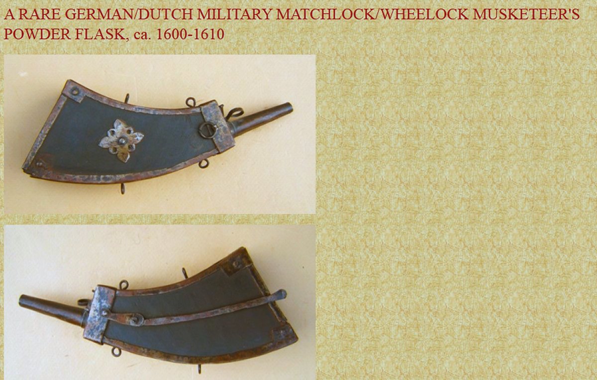

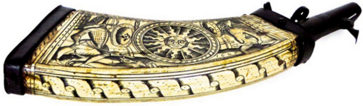

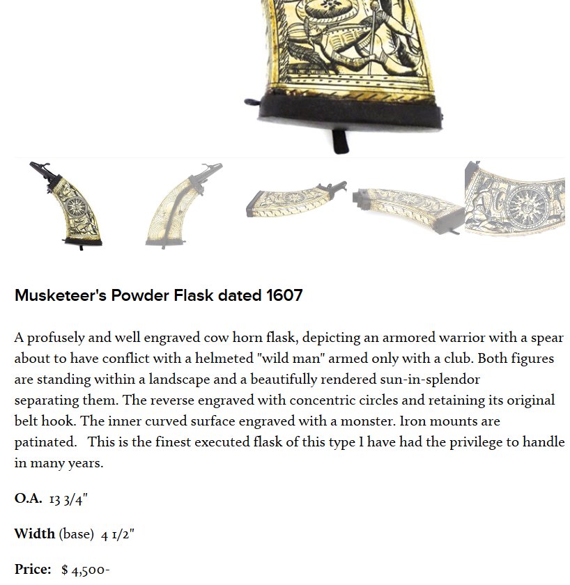

A characteristic Nuremberg made and engraved caliverman's flask of bleached cowhorn, retaining its originally blackened iron mounts and frog hook, the body dated 1607.
Please remember that, contrary to the dealer's assertion, this is NOT a musketeer's flask!
m

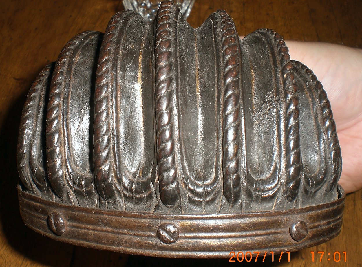

Was the North Italian cuir bouilli flask for presentation purposes or for a (mostlikely) wealthy person?
Their seems to be some remnants of gilding? And does this flask have a (screw) lid on top? I remember from one of your other threads that this was the case with some of these flasks.

Hi Marcus,
As the dealer's description does not mention otherwise I assume that what seems to be some gilding actually is a light reflection from the photo session.
Those flasks, like the one in discussion, are indeed characterized by having a number of screws, especially before ca. 1570. The basal plate of the top mount/lid is generally fixed by a transverse screw, as seems to be the case here.

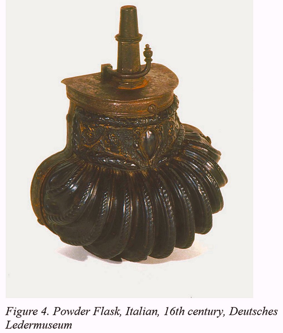

Very interesting! There is a very similar flask in the Deutsches Ledermuseum. A picture can be found in Rex Lingwood's discussion of cuir bouilli here: http://makersgallery.com/rexlingwood/waterer.html -> download the PDF available there.

Right,
Here it is, ca. 1560-70.
I also attached another, contemporary sample in a private collection (the belt hook missing from the reverse).

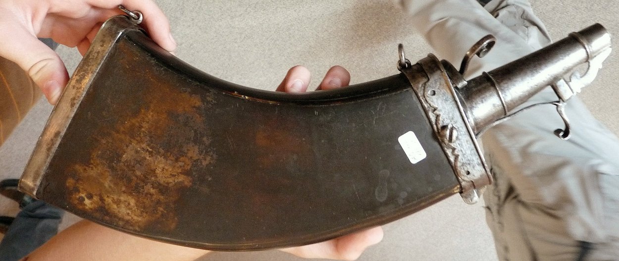

Not a musketeer's flask, as the dealer thought, but that of a caliverman, ca. 1590-1600, in nicely patinated condition, and retaining some bluing on the iron mounts.
m

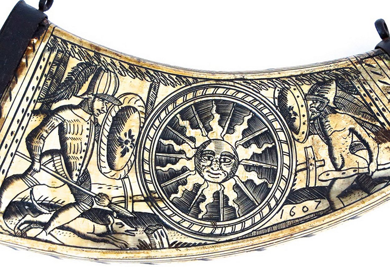

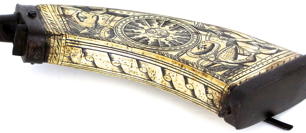

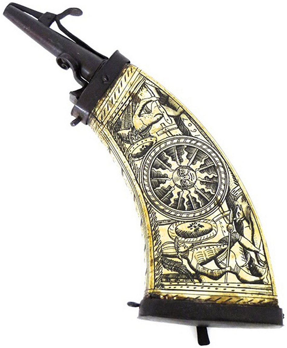

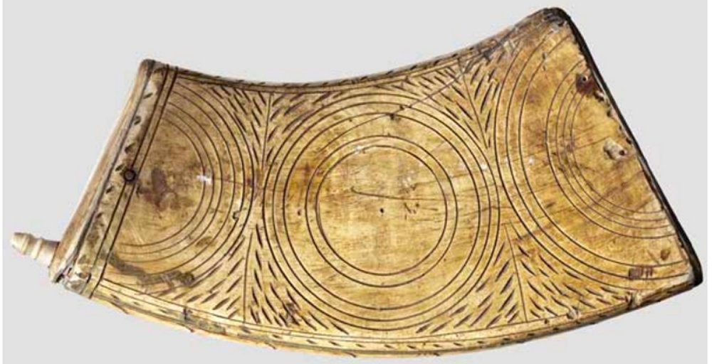

A Nuremberg made and engraved flask of flattened cowhorn, ca. 1600, sold Hermann Historica, Munich, 18 Oct 2006.
This decoration is the well-known intertwined foliage that all Nurembeg workshops used as a pattern.
The blackened mounts finely convey a nice contrast to the white horn body which of course the artist originally intended. This is why a flask from this series with its iron mounts polished bright has lost all its charms.

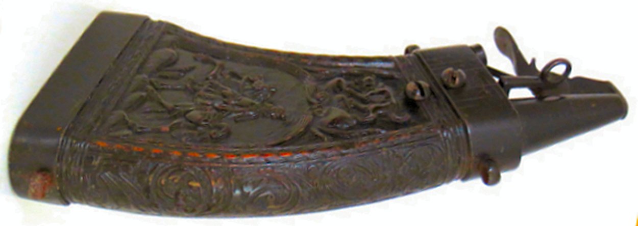

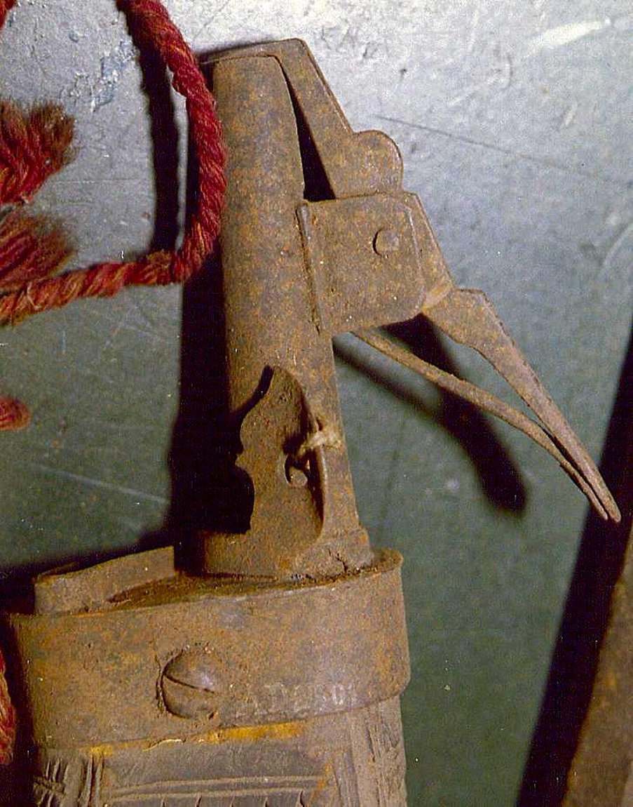

Here is a caliverman's flask I photographed 30 years ago in the reserve collection of the St.-Annen-Museum Lübeck, Lower Saxony, Germany.
The obverse and small sides of the wooden body are profusely carved with scales.
Following the usual formal criteria, a date of 'ca. 1600 to early 17th century' would seem appropriate. However, a 'military' wheellock musket, the lock struck with the Suhl proof mark SVL and the octagonal barrel retaining its original bluing, and the whole gun datable to ca. 1640, features a stock carved in exactly the same manner. It is preserved in the reserve collection of the Gäubodenmuseum of Straubing, Lower Bavaria, and would go perfectly well with the flask stylistically. Thus I am prone to assign the same date to this flask, making it the latest of its kind known to me, from the 'heyday' of the horrible Thirty Years War.
Michael
