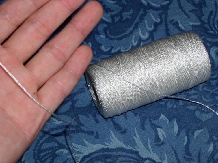

If your keris has a normally strong pesi, and if it Bali keris it probably will have, you should just use a pressure fit, as everybody else has already said.However, rather than use cloth I suggest that you use knitting wool.
Cloth does not compress very well, and if the handle too tight it might split.
